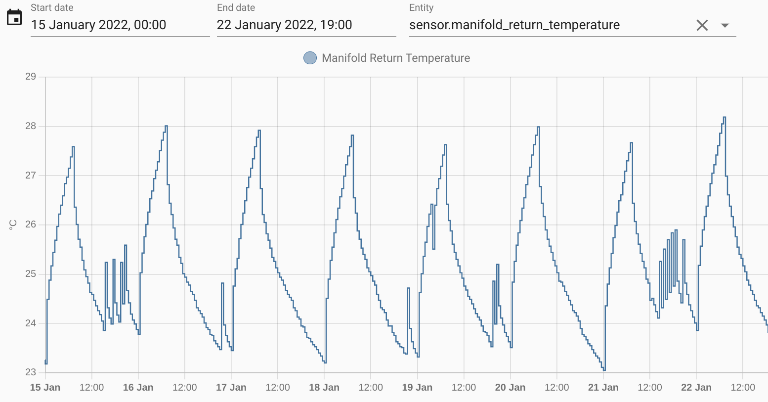

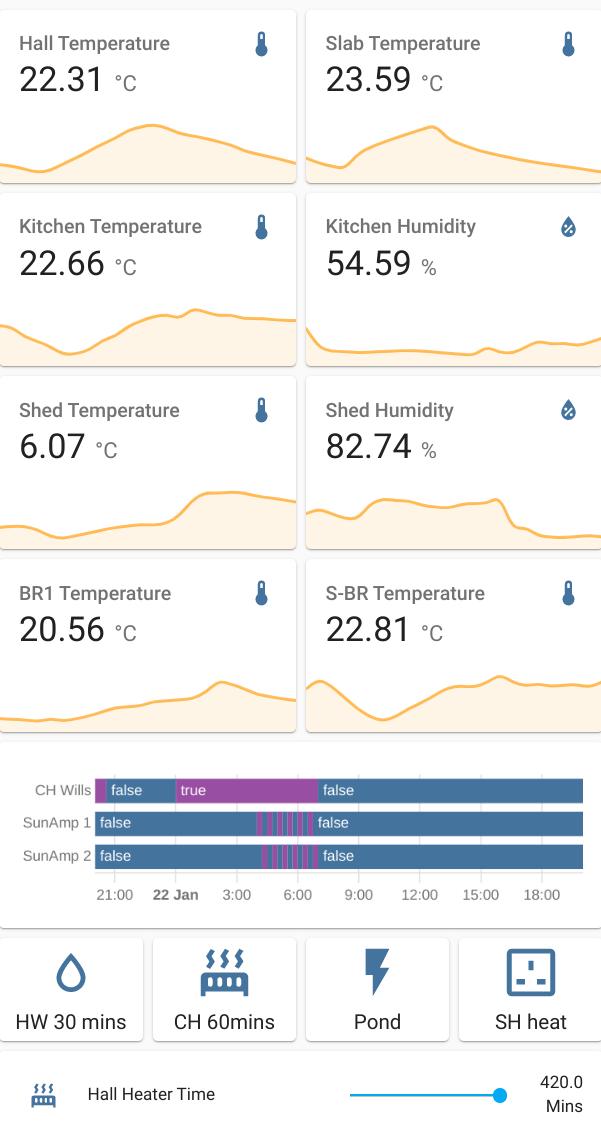

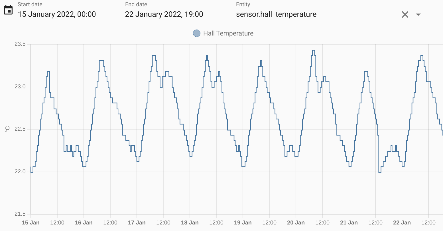

Here are two history outputs from HA showing some of the logged results.  The LH graph is the slab temperature over the last 7 days.  The general saw-tooth is identical from my 3-D heat flow modelling discussed in my earlier topic, Modelling the "Chunk" Heating of a Passive Slab.  The 7 hr off-peak heating raises overall slab temperature by ~4-5 °C; well within UFH design tolerances, and no need for any HW buffer tank: the slab is the buffer. The RH graph is the hall temperature.  Note the days where on-hour boosts were needed.  (Also note that the CH system only updates the MQTT temperature data half-hourly, hence the stepped curves.)
So the approach is fairly simple, and the system works robustly. ?  And here is a screenshot of my HA summary interface, which gives Jan the ability to control everything she needs from her mobile phone or tablet.
