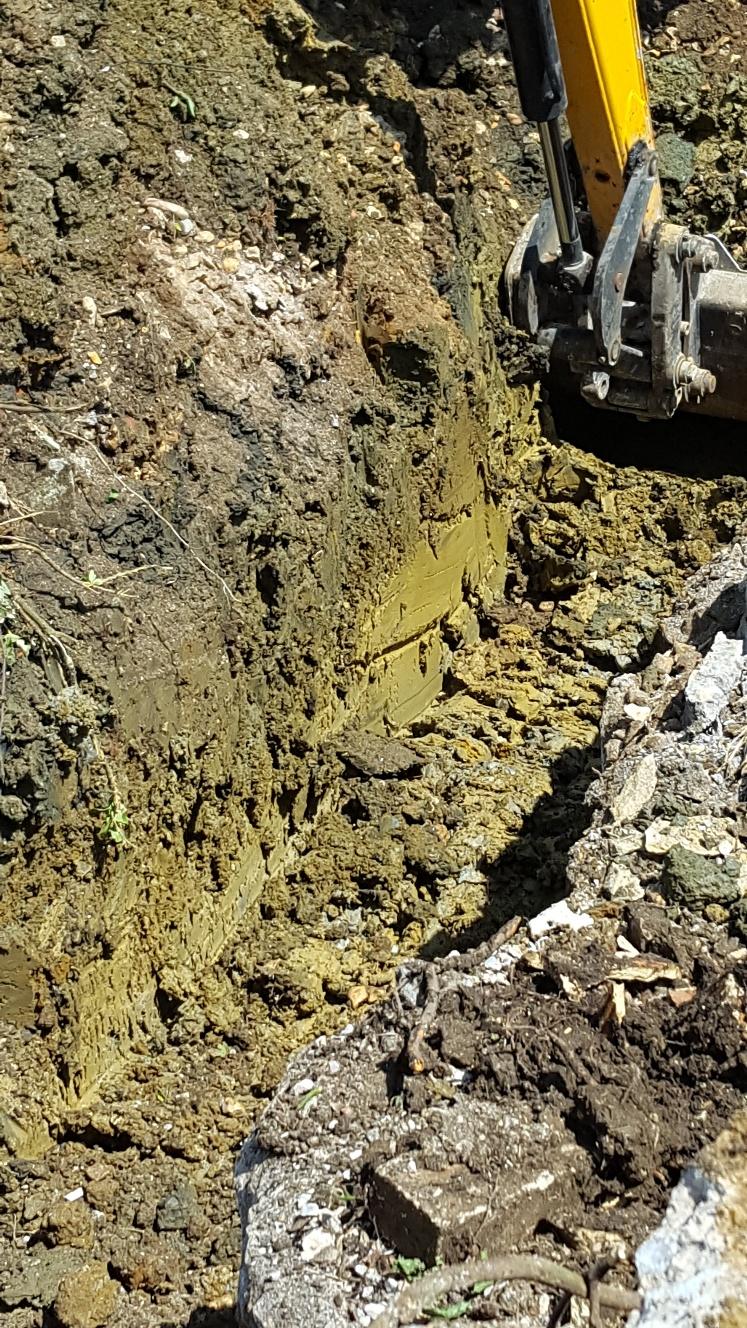

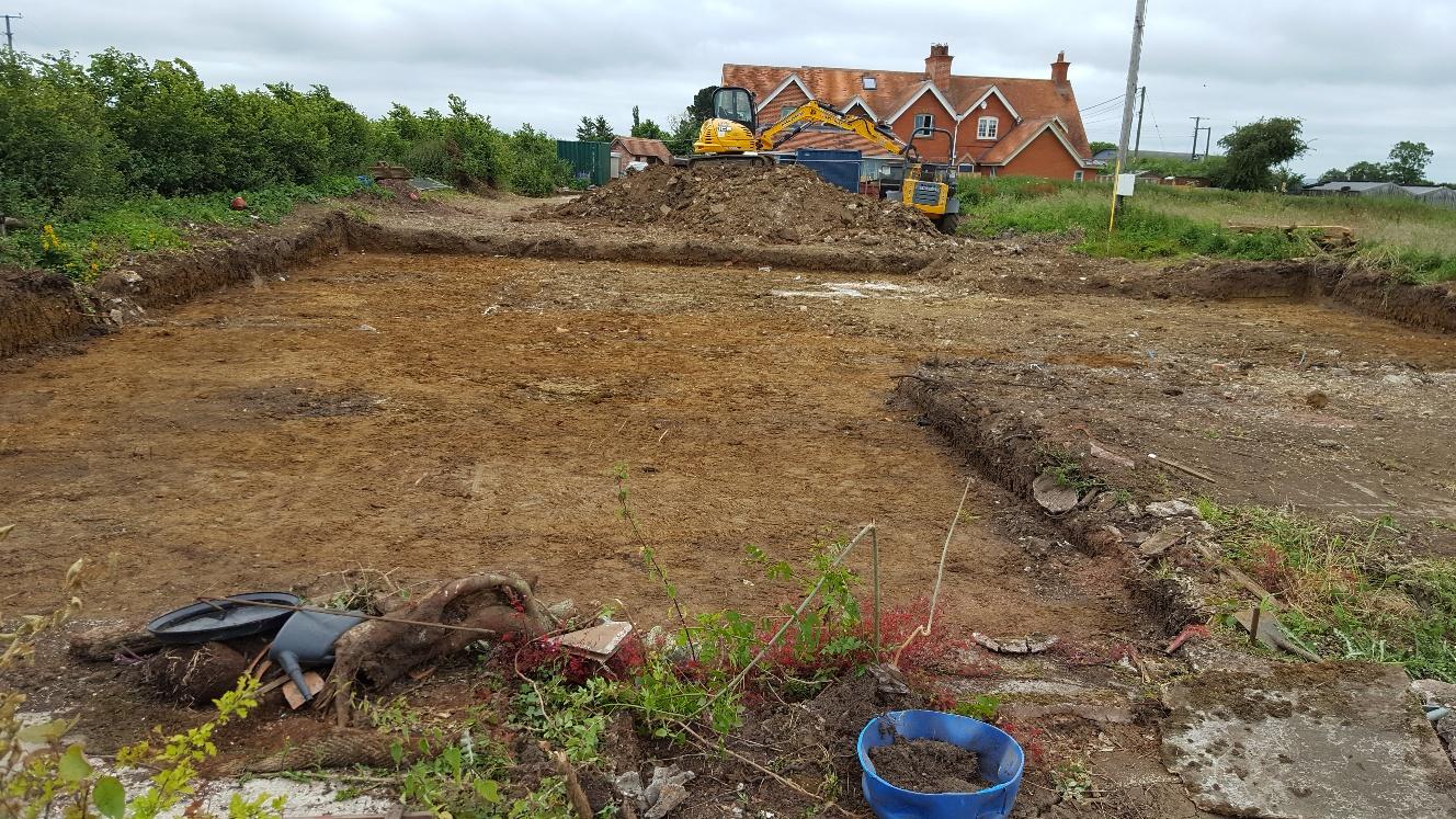

On with house matters.  Over the last 2 weeks, all the demolition has been completed and debris removed.  We kept plenty of the timber from the roof, which we will use to make raised beds for the kitchen garden - there's no way I'm going to dig that clay over, no-dig all the way for me!  We also salvaged some bricks that formed an outbuilding, but the rest is gone.  The concrete floor of the garage block formed a really useful hard standing area and that will stay pretty much until everything is done, including a lot of the landscaping.  Shortly after this, the portaloo and site cabin arrived, along with the security fencing.

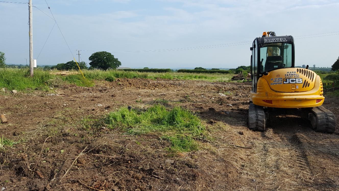

After the demolition, work started on reducing down.  We've gone down 800mm from a point set by the surveyor but this may need to change slightly as there is still some debate over what the finished floor level will actually be.  There are 3 different levels floating around at the moment, but this will be finalised once MBC have come back with the designed foundation.  In the end, I used a surveyor for setting out the levels then had a play around afterwards to see how everything works.  I'm glad that I used the surveyor as time was limited in getting the setting out done and it only took him a couple of hours once he had found the previous survey points; I'm pretty sure it would have taken me days and I would have lacked confidence in the final result, so it was money well spent, if only for the peace of mind.

A word here on piling, as I've had my final quote in for the mini piles, which stands at £14,870, all in.  Having done muckaway on a reduced dig of 800mm, I now have full knowledge of the cost of that, and were I to have gone down the route of a reduced dig to 2m (this was the depth MBC reckoned it would need to be to overcome my clay), I can confidently say that the option of piles is cheaper by a good few thousand for me.  Nobody wants my clay soil so the whole lot has to go to landfill and it ain't cheap!  There will be more spoil once we've dug the pond in the field, but I reckon I can lose most of that on the site.

Photo 1 - if you needed any visual proof that we have clay.
Photo 2 - demolition done, getting ready to reduce.
Photo 3 - reduced dig to 800mm from finished floor level.  Plus a view of the neighbours' cottages.
