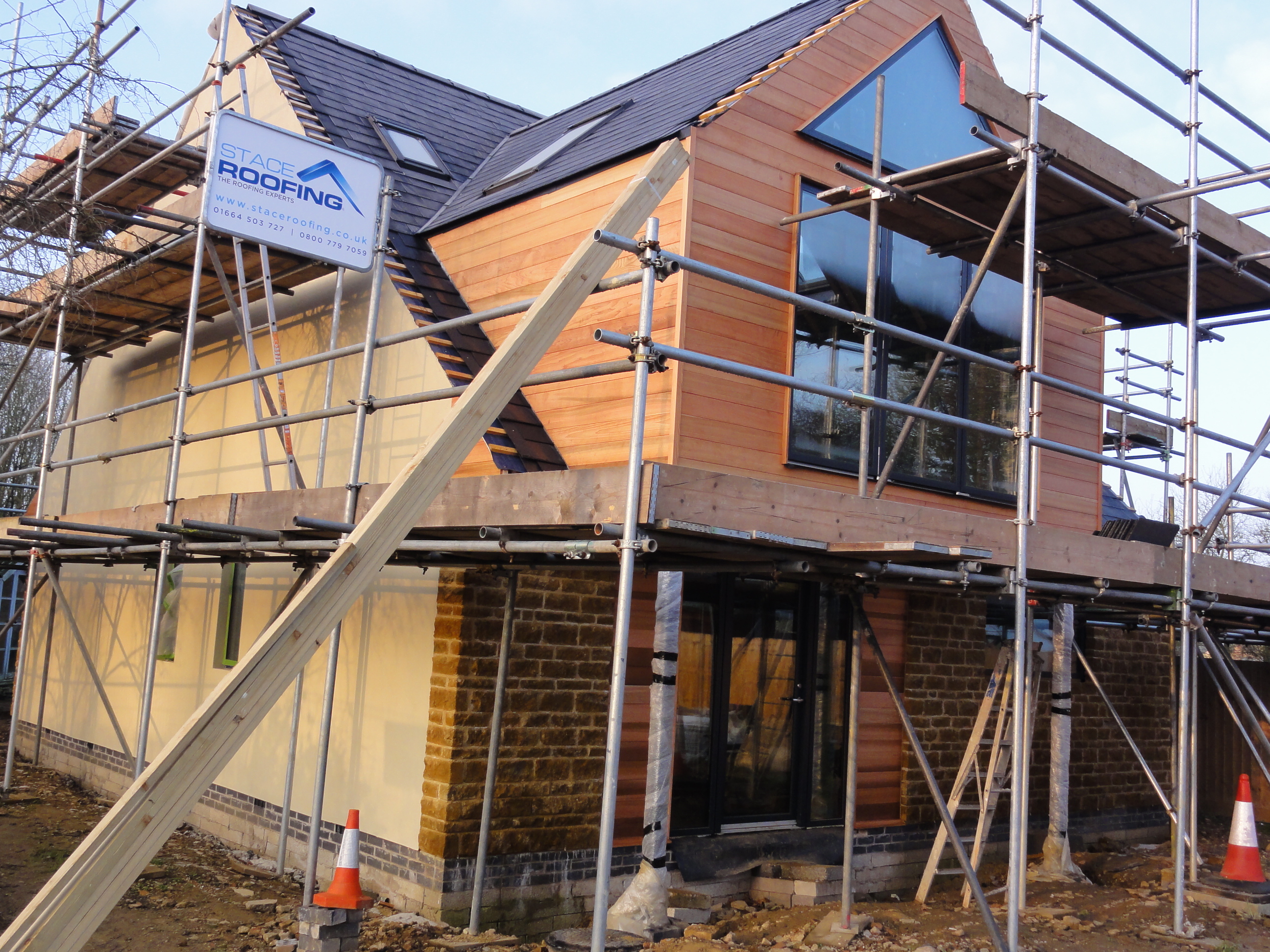

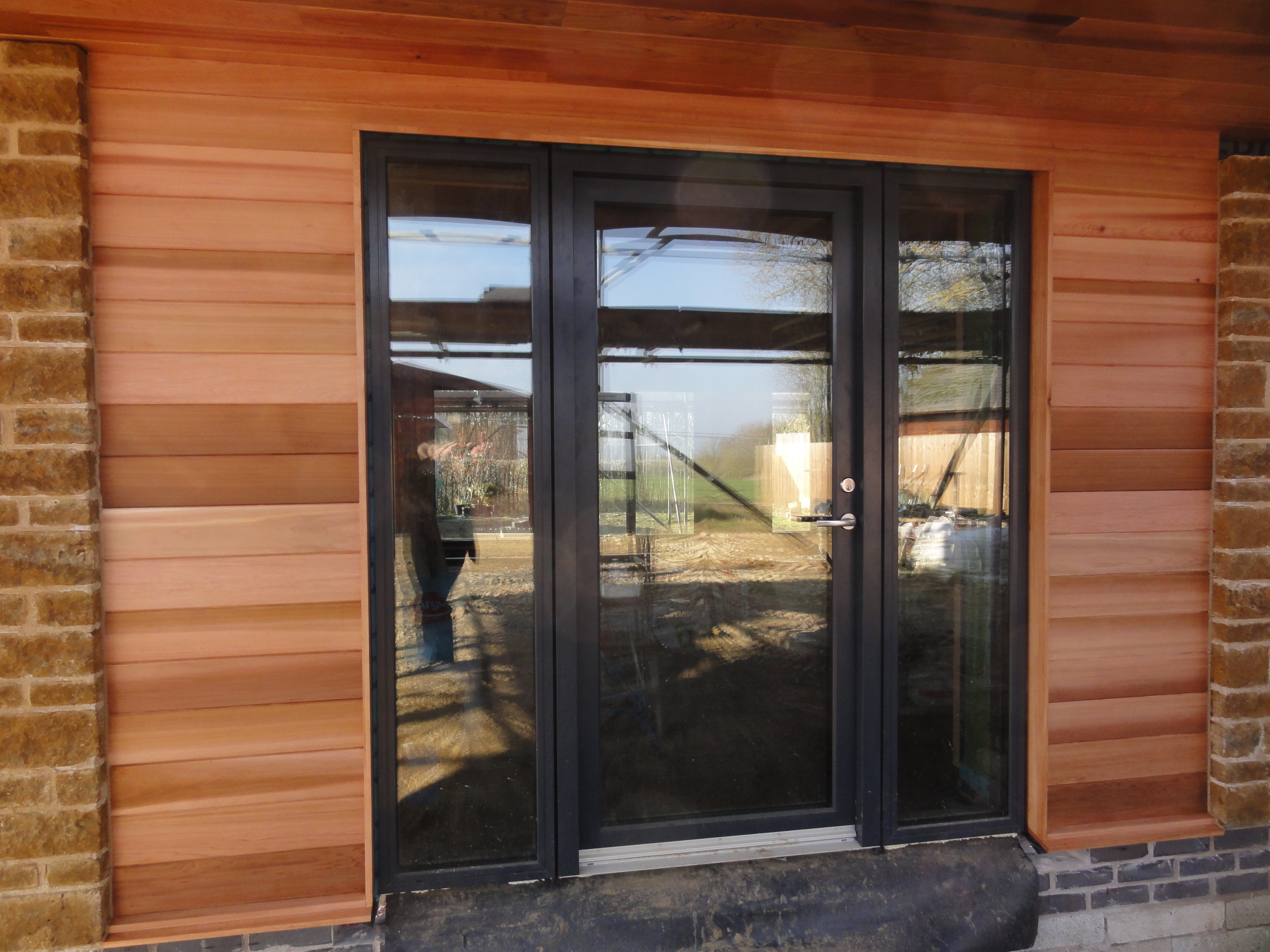

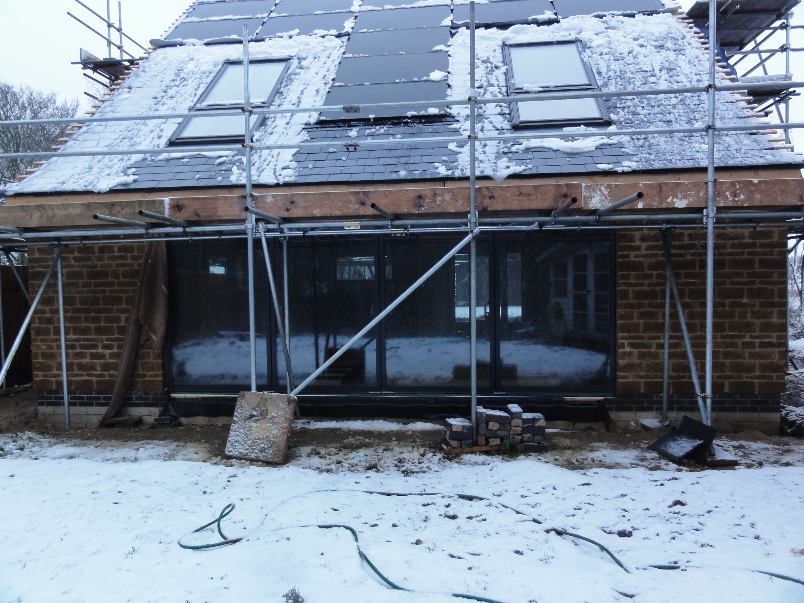

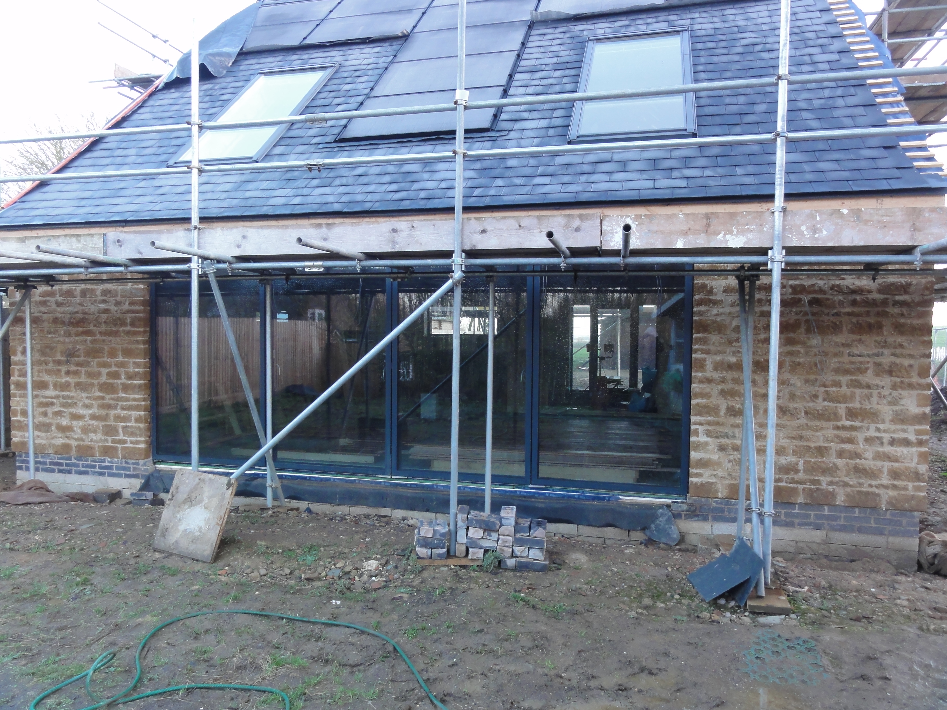

Thanks @Plumbersmateuk
I was just going to add my previous post.
Saved me looking for it.
@vivienz As above, just under £12k for the windows & doors & about £3k for the installation & cills, but of course this price included removing & re-fixing after the first b*lls up so would have been about £500 less. Cills have cost £380 because of minimum order.
Edited by Moira Niedzwiecka
  • Like 1
Link to comment
Lovely looking windows and doors, Moira.  I've requested another couple of quotes - any money saved on the windows can go towards my ever increasing kitchen budget!  Thanks for the pictures and info.
