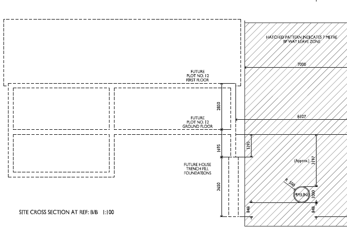

This sit map shows Plots 11 and 12.
Ours is Plot 12.
Whilst the existence of the pipeline and no-build zone was an obvious inconvenience, we’d spoken to the builder aligned to the plot, and because we had planning permission and because we were assured that good progress was being made on getting the foundation design approved by the pipeline owner, we were comforted in that respect. We trusted what we were told, But with the benefit of hindsight, that trust was misplaced.
However, from my hazy recollection of those discussions 2 years ago, it was actually the existence of the train line that was the ultimate decider in us not purchasing the plot at that time.  As far as we could ascertain, only 4 trains ran per week, but they were long, trundly, noisy trains, with carriages filled with coal, and this did not really appeal to us.

During these discussions we also got more information about the positioning of the pipeline in relation to the plot. This side elevation shows the run of the pipeline underground (though we've since organised a significant soil shift since this was created):
This drawing also showed the results of the discussions that had already taken place regarding the foundations for the approved house. The depth of the foundation, we were told, was to ensure that no load was put onto the pipeline. We had also met with the  architect who designed the house, and he explained that so long as there was a 45 degree angle between the bottom of the foundations and the bottom of the pipeline, then the pipe owners were happy.
We never knew at the time, but the foundation design is something that caused (and is still causing) much angst in our build process.

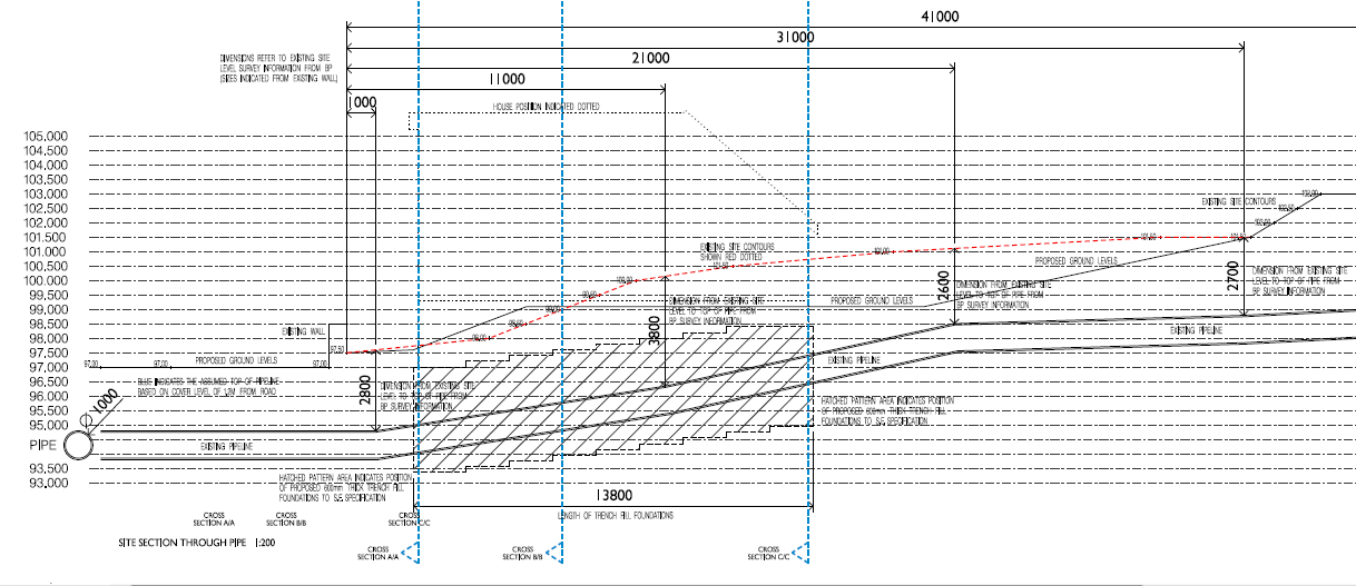

5 metre deep trench foundations. That's not for the faint hearted.  I assume it will be sheet steel piled to retain the soil then concrete poured, though I have a feeling you will be telling us all the details in the future.
Using the "45 degree rule" and allowing for the fact you are building 3 metres or more from the pipe, you can probably reasonably reduce that depth to a more manageable 3 metres with agreement from the pipeline owner?

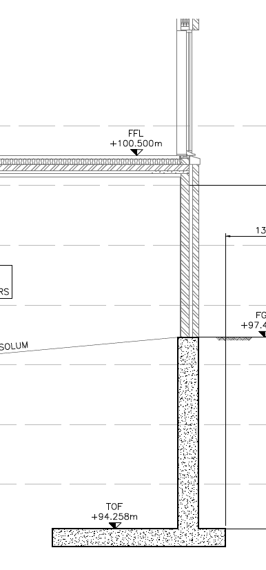

@ProDave Those were the initial founds - the latest founds aren't quite 5 meters - we've removed around 2000 tonnes of soil across our plot and the one next to us. However,   the foundation design that was approved by the pipe owner is actually more onerous (and expensive)  than the one  you see here, as they involved steelwork and this kind of foundation (strip foundation?):
58dab23f5dedd_Screenshot2017-03-2819_57_19.thumb.png.9c82e278e51a034ead123965973915f5.png
We weren't involved in the technicalities of the early plans (left that to the builder) but sheet piling was not part of the original design. However, adding sheet piling was later suggested after the plot next to ours started their dig and the sand (which the boring report identified) started giving away under the pipeline. But, the sheet piling introduced £10Ks of additional costs, although introducing sheet piling (and keeping it in place) would have meant we'd be able to reduce the trench depth and therefore concrete costs.
So, your second sentence about reducing the depth is exactly where we're at now. But just because we were told that the 45 degree angle and no load on the pipeline was all we needed, it does not mean that the pipeline owner agreed . Our responsibility with regards to the pipeline (as per the servitude) is not to damage it/put load onto it. But, unbeknown to us at the time (the SE was engaged via the builder, not sub-contracted by us), it seems the foundation design that was finally approved (require for planning consent) was effectively dictated to our SE by the pipeline owners SE, and everyone expected us to pick up the bill.
The pipeline is the same one that forced the moving of T In The Park, so we're not talking some local farmer here...
It'll definitely be the subject of future posts.

Yes, we have a TF house that's roughly square (11.5m x 10.5m) and decided to have a full basement under the house which acts as the foundations. Planning didn't blink so we got an additional 107m2 internal floor area, nearly 50% extra on the above ground element, which in the SE is worth quite a bit.
Architect was very wary (had no experience) but it was no problem to build and is one of the best features of the house. All the plant is down there in a dedicated room and we have four large (4mx5m) rooms each with light well for leisure use. Nice bright spaces, really pleased we went with it.
Cost wise, structure was £120k but that included the demo, clearance and plot services, so probably closer to £100k just for the basement - you could probably subtract a good chunk from that had we used a traditional raft slab.
Fit out was about another £15k, kind of got lost in the overall electrics / plastering / joinery / flooring budget. Aside from plant, there are no wet services and no heating required (we have 300mm insulation under the slab and 200mm outside the walls.
We used warrantied waterproof concrete (Sika) and no other internal tanking or external membrane as the water table is fairly low (6m). I see that you're near water so the situation may be different.
There are 3 recognised forms of waterproofing  - best practice is to use two but we got by with one (B).
A is external membrane  - needs very careful application and extreme care on backfilling, otherwise it can be compromised
B is waterproof concrete - we used a Sika system of admix and waterbars in the joins - was all recorded, inspected and signed off on site by a Sika rep who then issued the warranty.
C is internal membrane - applied to the internal walls and drains to a sump with a submerged pump (or two for redundancy). Quite common in London basements but has an ongoing maintenance cost wrt the pump.
About 30% of basement cost is muck away and a tight site with poor access will increase costs further. A good chunk of the remaining build cost is formwork labour (took 2-3 days to prep for each pour) so complicate designs will cost more to form, the actual concrete is not that significant a cost.
We were lucky with our design, location and conditions.
