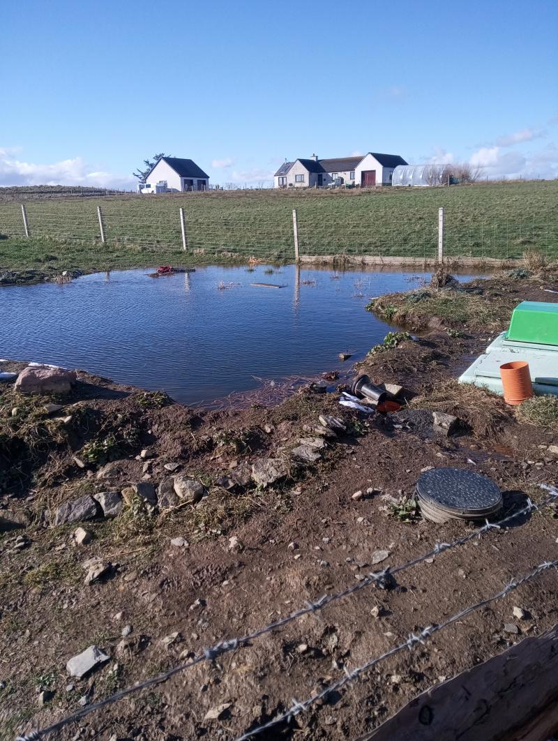

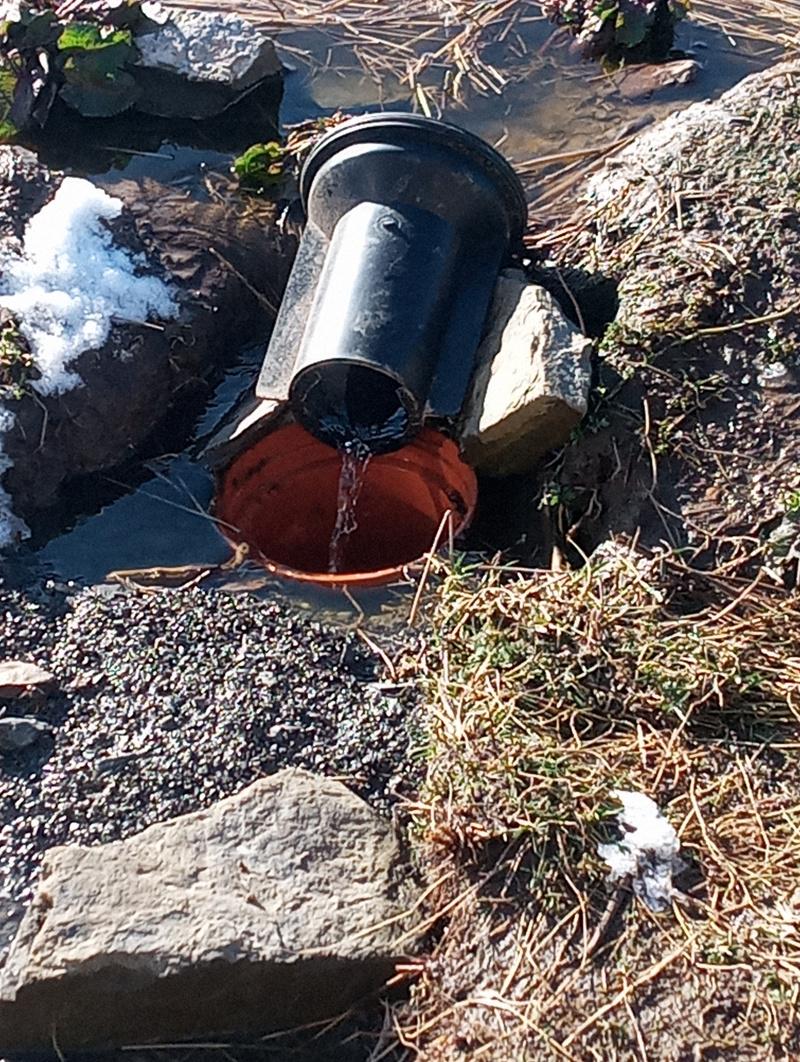

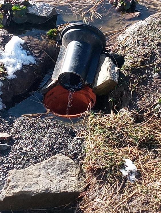

After some snow and heavy rain, I can see my design in action, physics doing what physics does.
This is the 1st pond that has now overflowed with run off. This level has raised about 400mm.
Although not finished. This has now overflowed into a gulley / pipe, that when it's finished will be concreted and form a better overflow outlet.

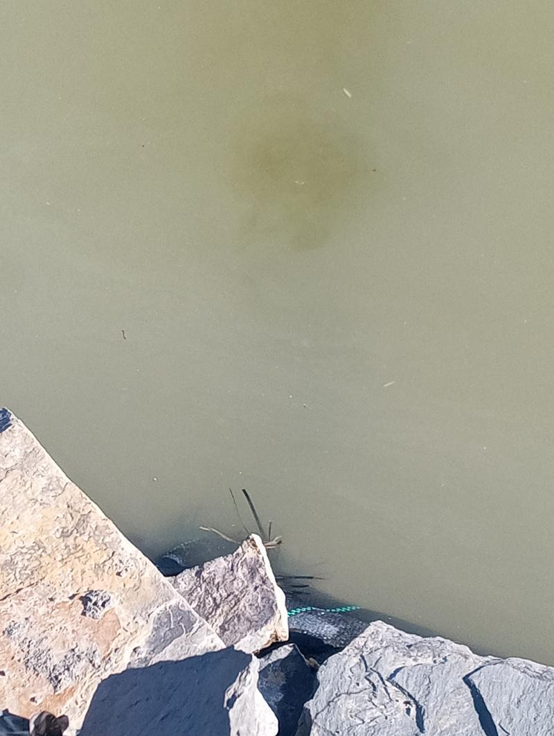

The last pic is the new pond and the darker green shade in the water is the overflow water entering the pond. The new pond rose around 150mm so around 1500l.
