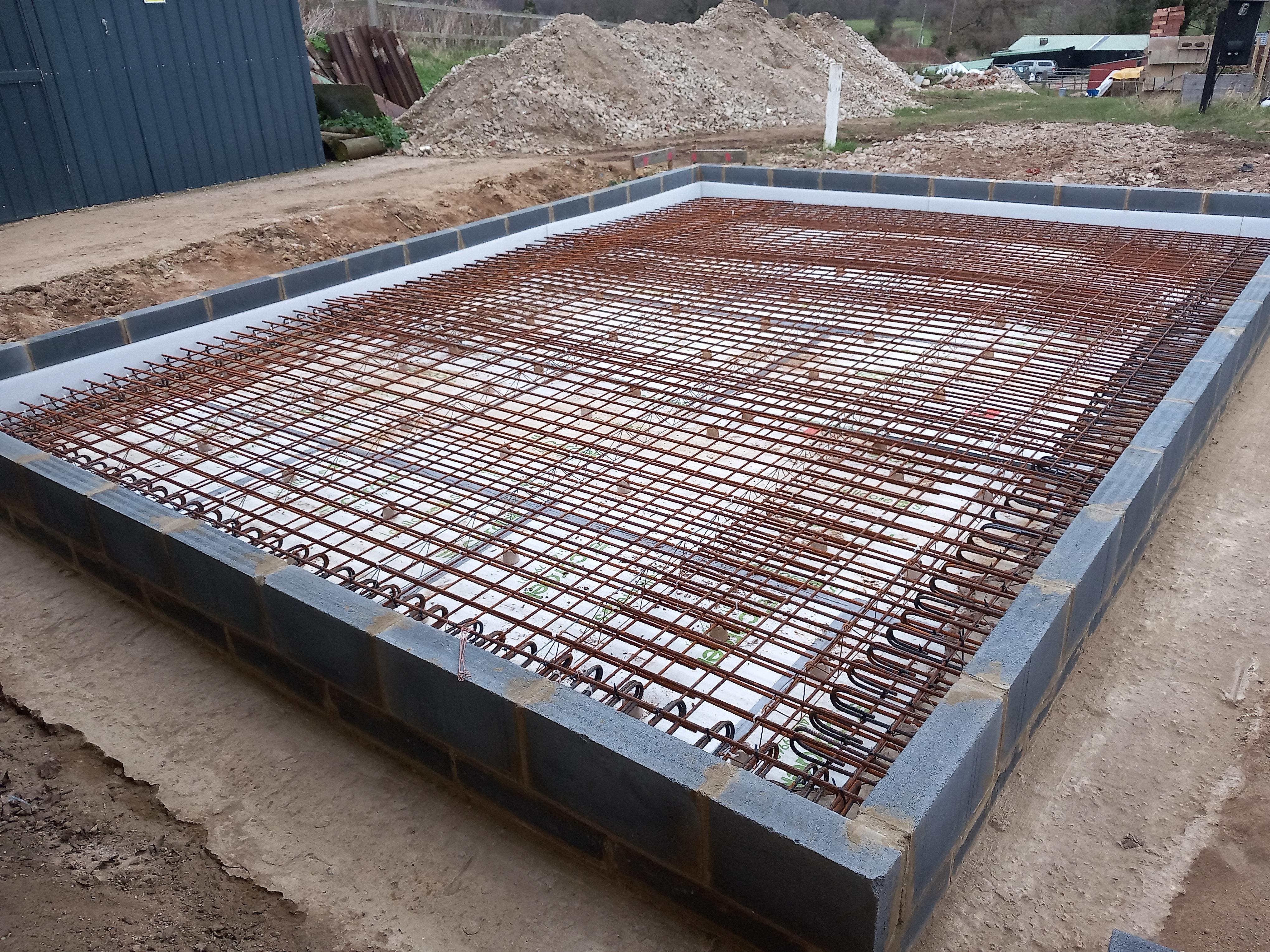

In December we had just got the details about our suspended floor.
It had to have a bearing of 130mm, plus 20mm expansion foam, plus shear links.
After much huffing and puffing it was prepped and ready for inspection.
The BCO came out and just said yes with no hassle and went on to talking about the other parts of the build and our future under pinning of the back wall.  He was really helpful and has even sent a message to the SE saying that he feels that 2.5m deep foundations is over the top with our sandy soil.  He wants us to dig two trial holes of 1.5m deep and then have a site meeting with BCO & SE to discuss what we really need.  He feels that the SE is being over cautious bearing in mind we are converting the barn into a single storey bungalow when there have been no issues with the existing barn over the last 70+ years.
This will all happen about March as hubby is going to build this 'room' first.  This will actually be our hall and snug.  The above is the inside wall of the cavity wall up to DPM.

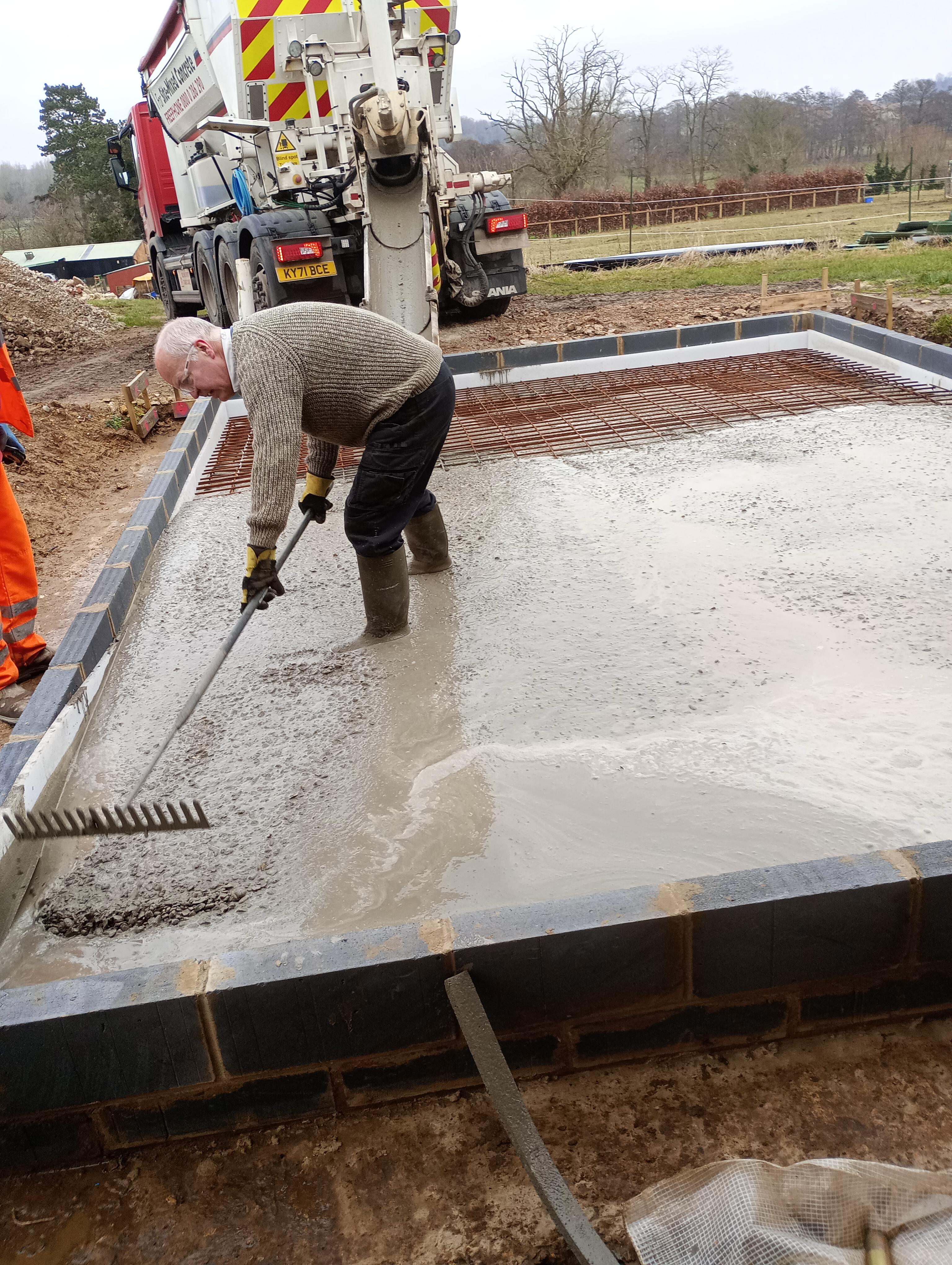

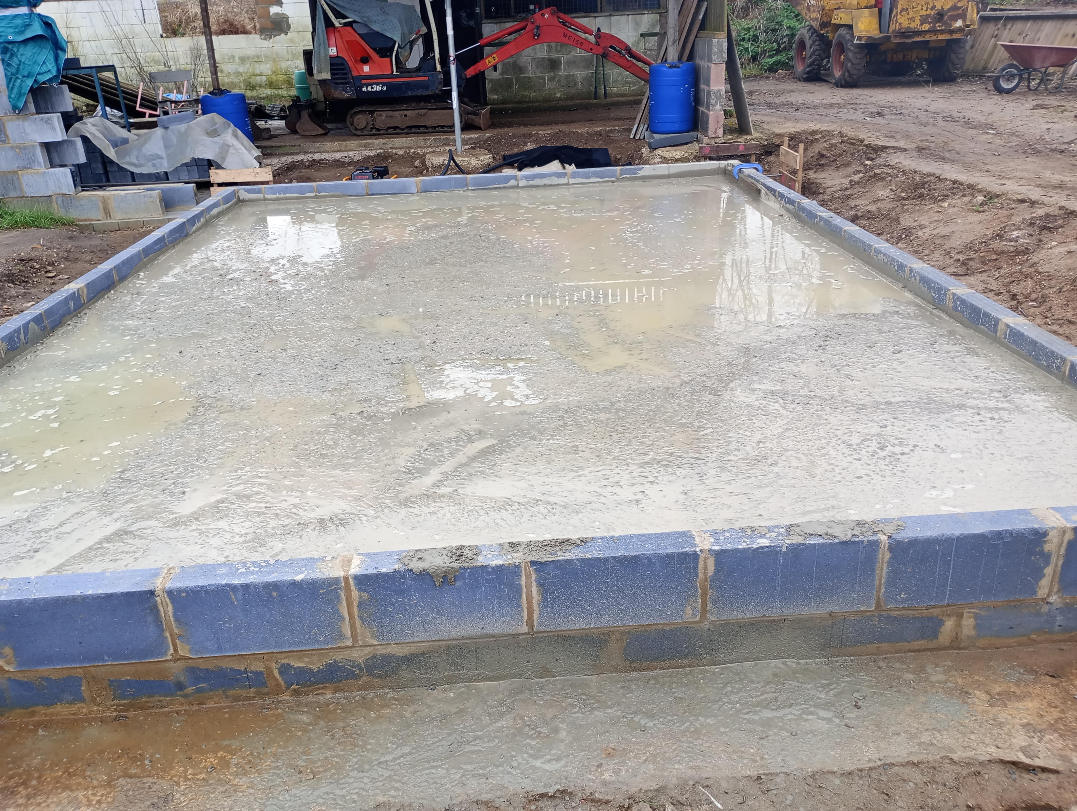

The long awaited concrete pour happened, at one point it looked like they might not make the slope as it was raining, but after a lot of slipping and sliding they got there.
bit of a wet day for it, but all dry now

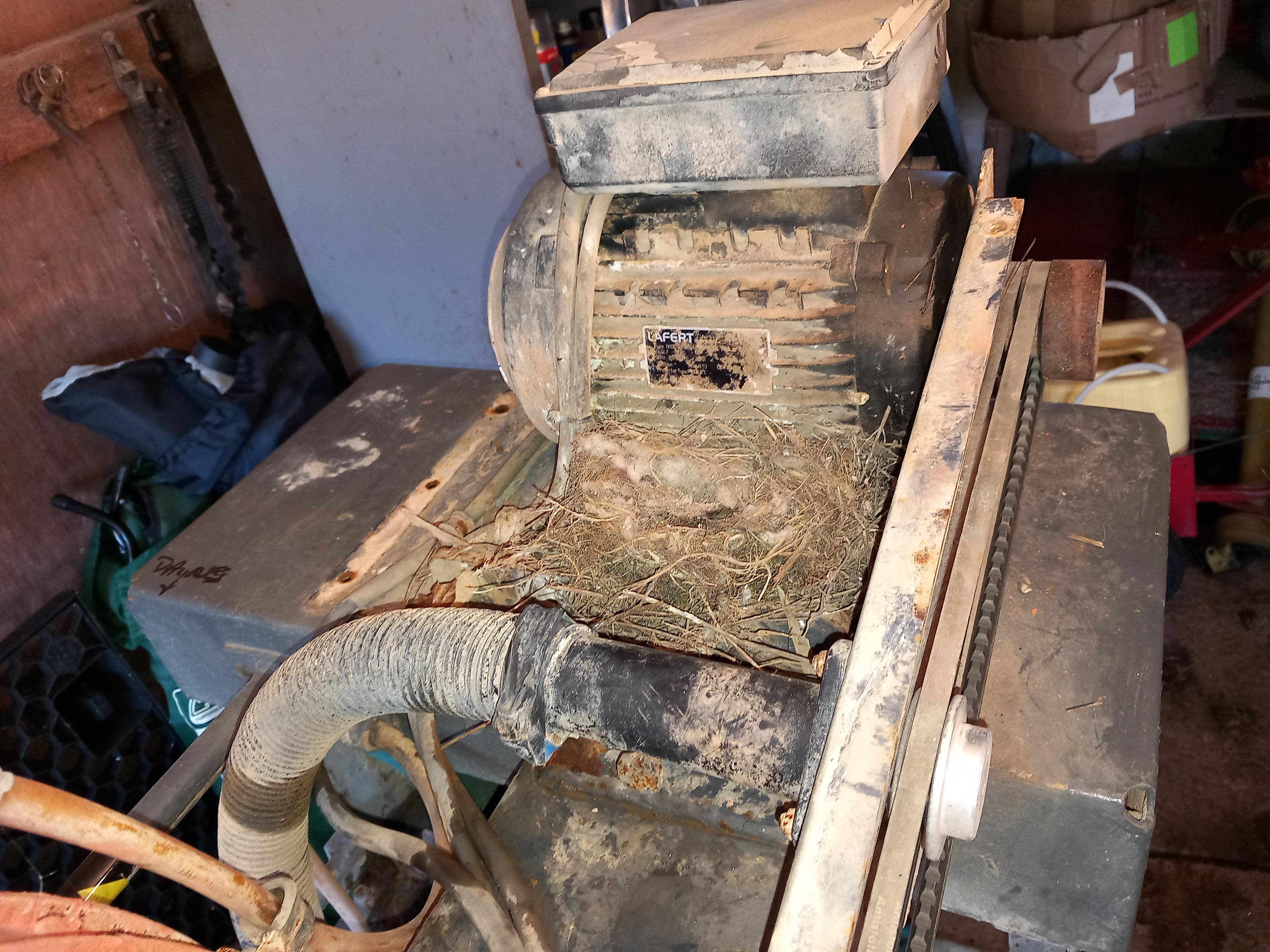

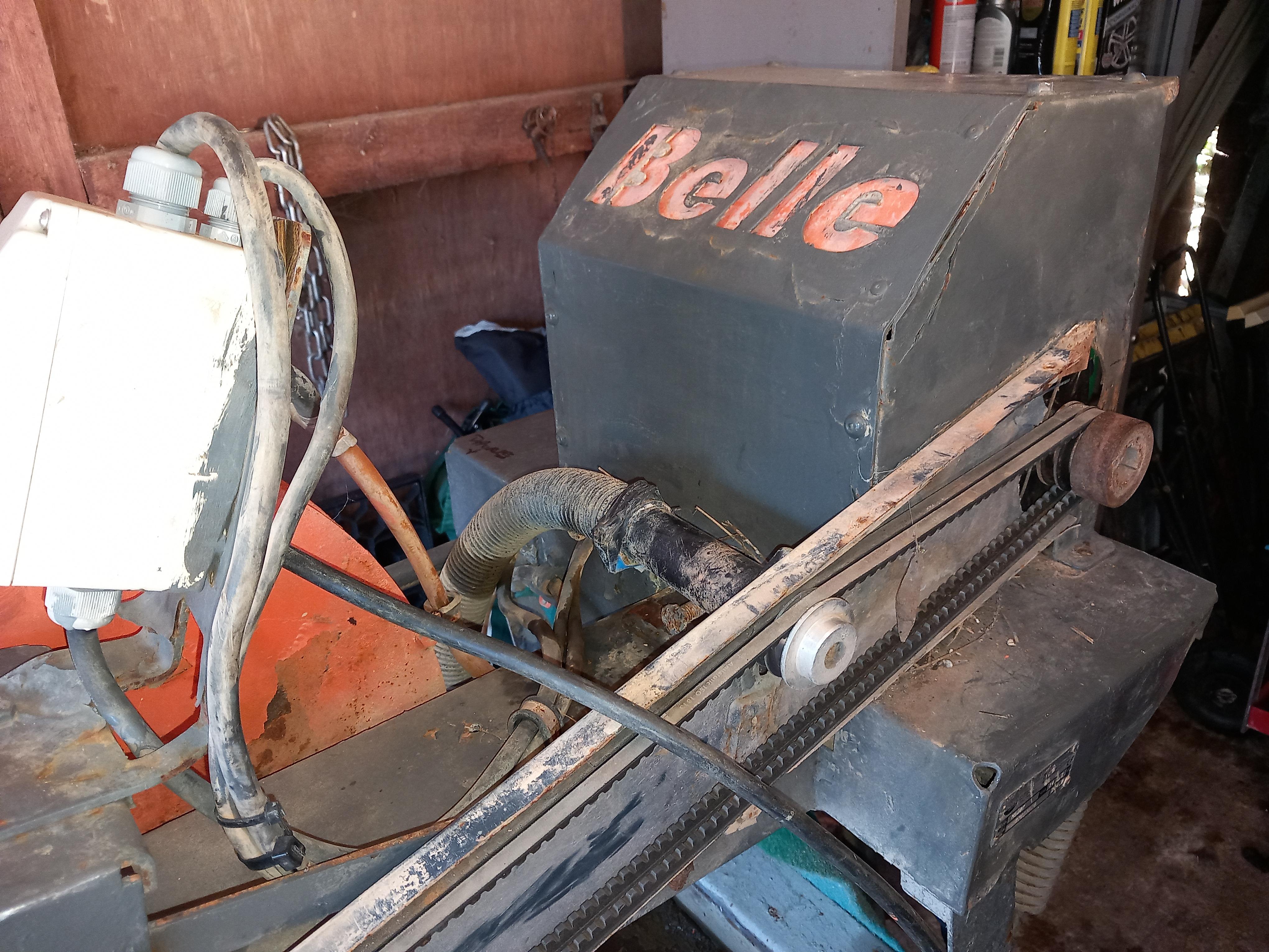

The only other thing we did this month was buy a block saw at auction (for not a lot of money), it needs a new engine as it's been stood outside for years, when hubby took off the old casing it was obvious just how long.
This is how it arrived
and this was what was under that casing.
I wonder how many years the birds were nesting.
We actually got 2 for the price of one, when we got to the auction to collect they said, oh there were 2 of these in a lot.
So, hopefully we can make a bit of money by cleaning, replacing the engines and servicing.  These beasts are seriously expensive to buy working at about £750.
Hubby has worked with a company in the paste who are going to do the work for us and refurbish so we should end up with at least one working machine for less than £250.
