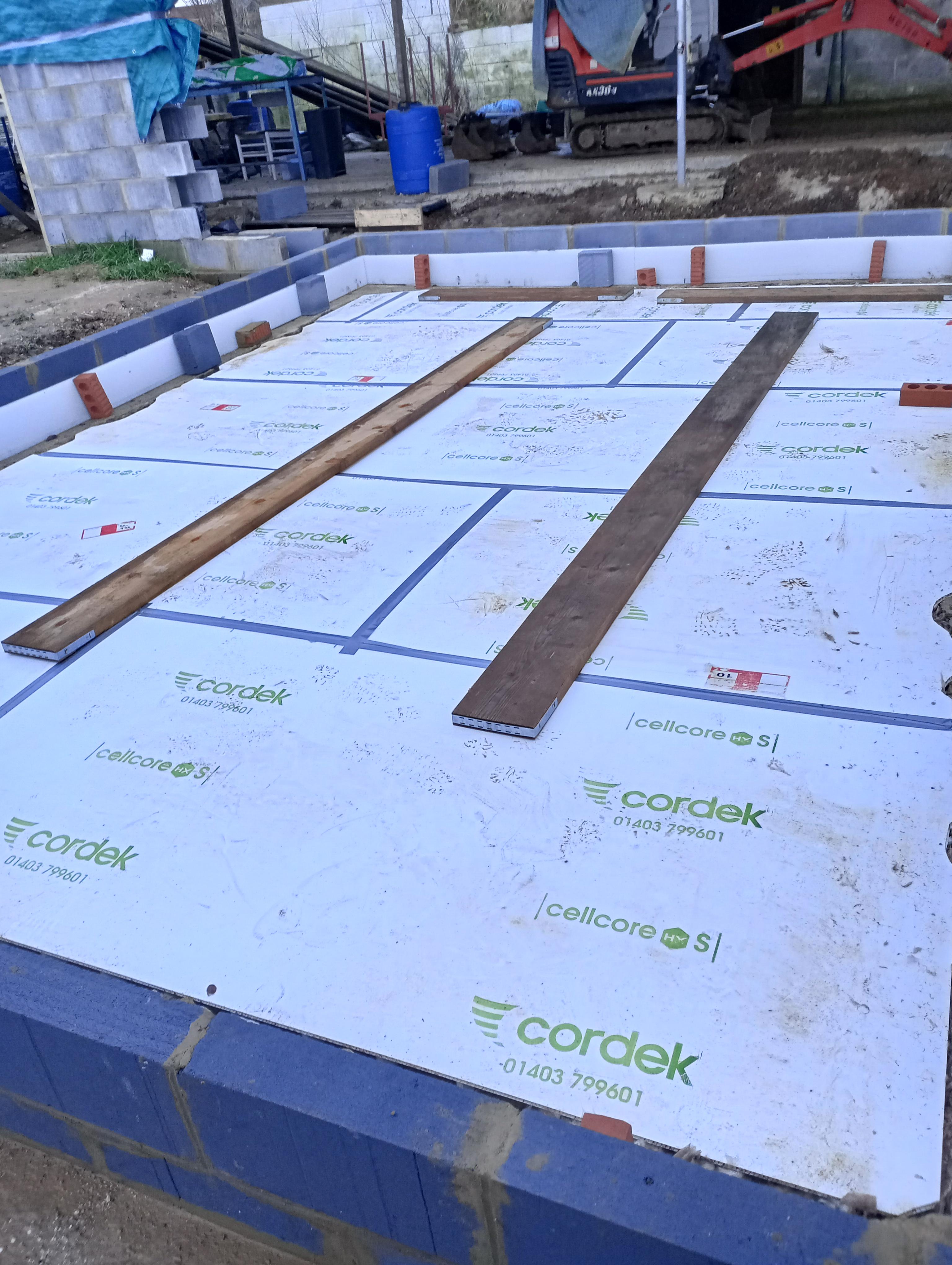

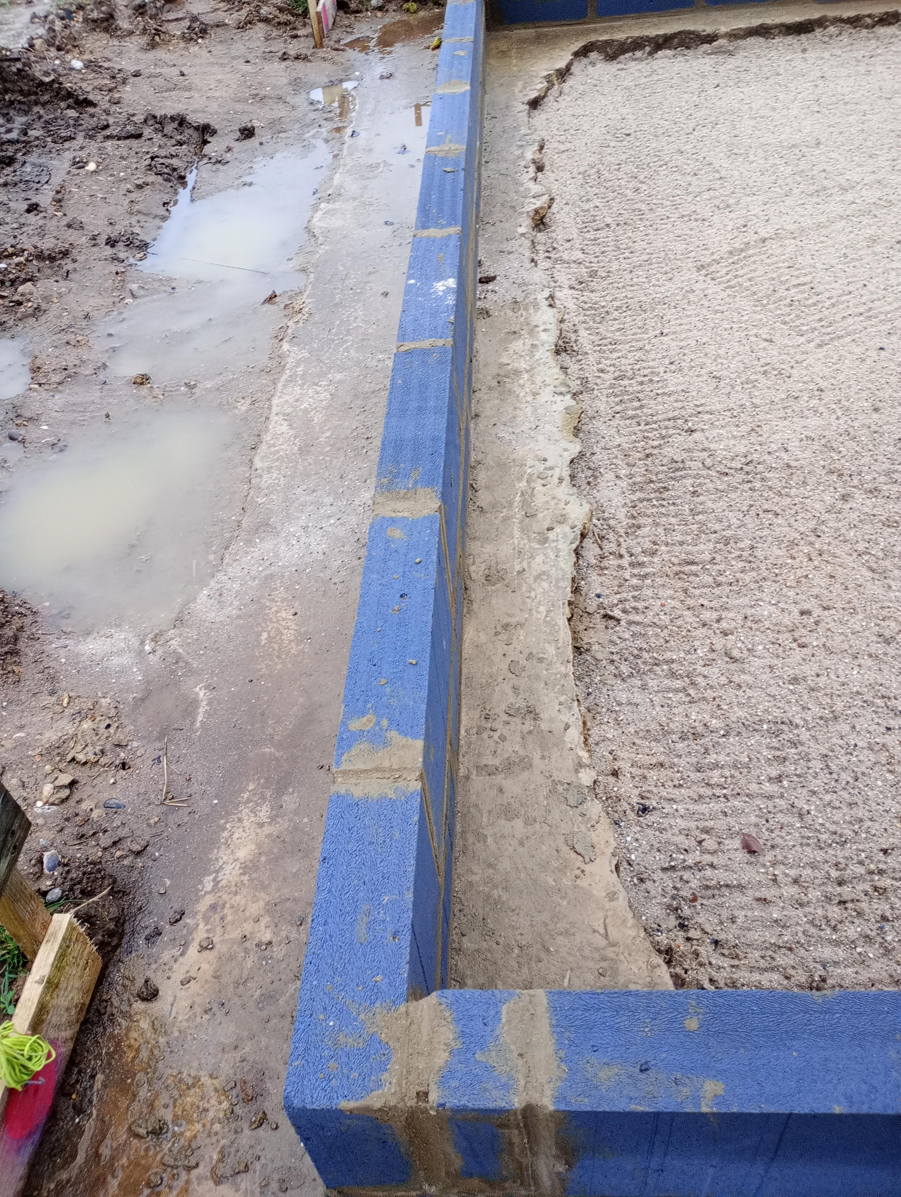

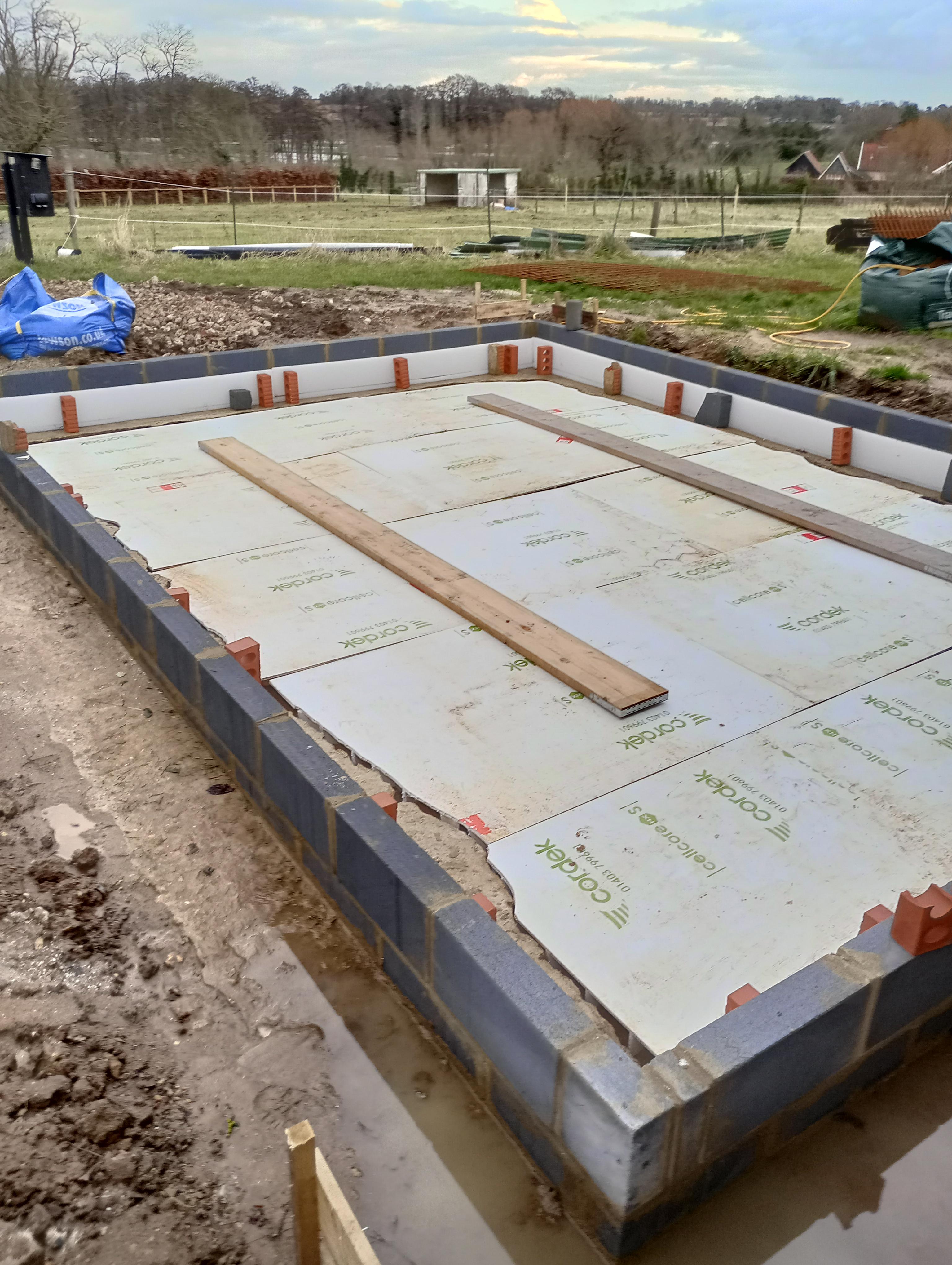

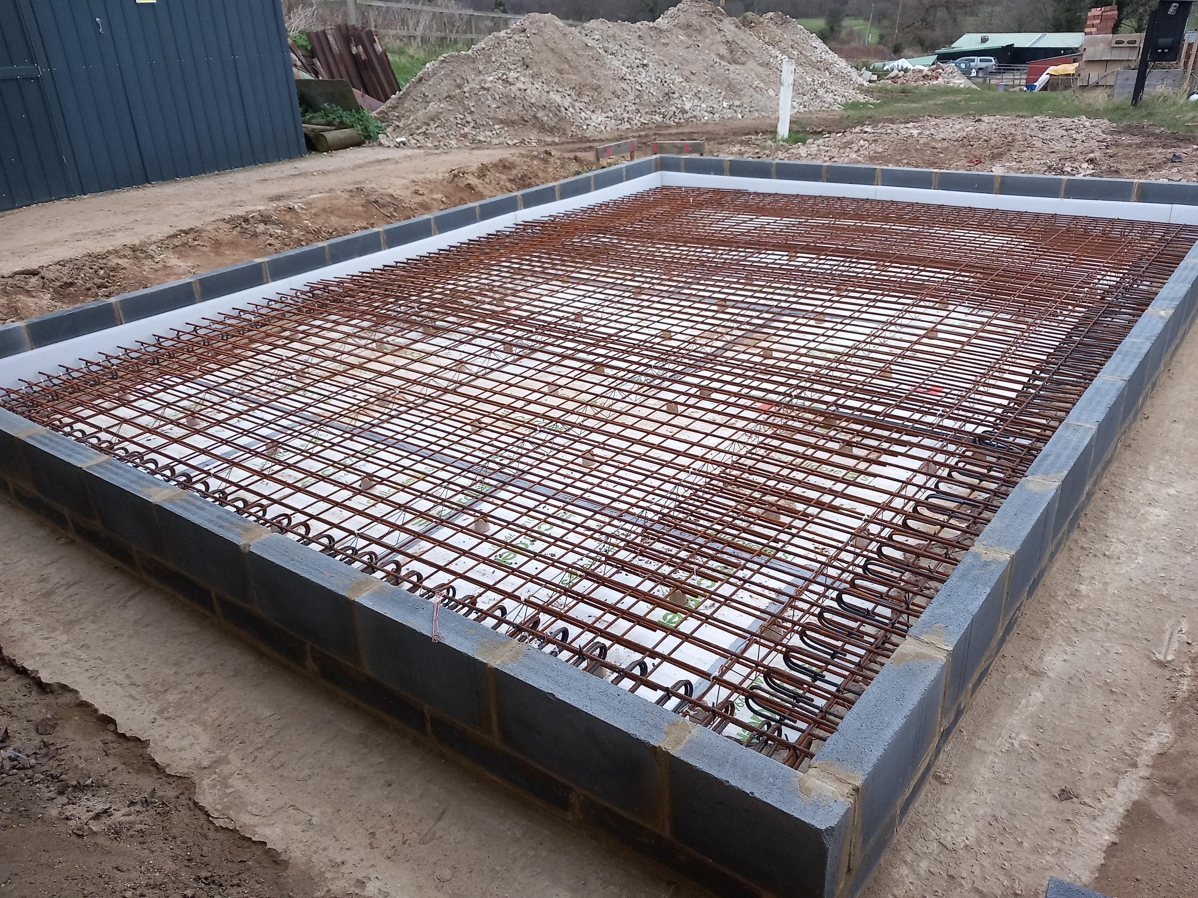

hardcore & binding (take 2 after previous issues)
now the expansion foam around the sides
The heave protection next
then taping

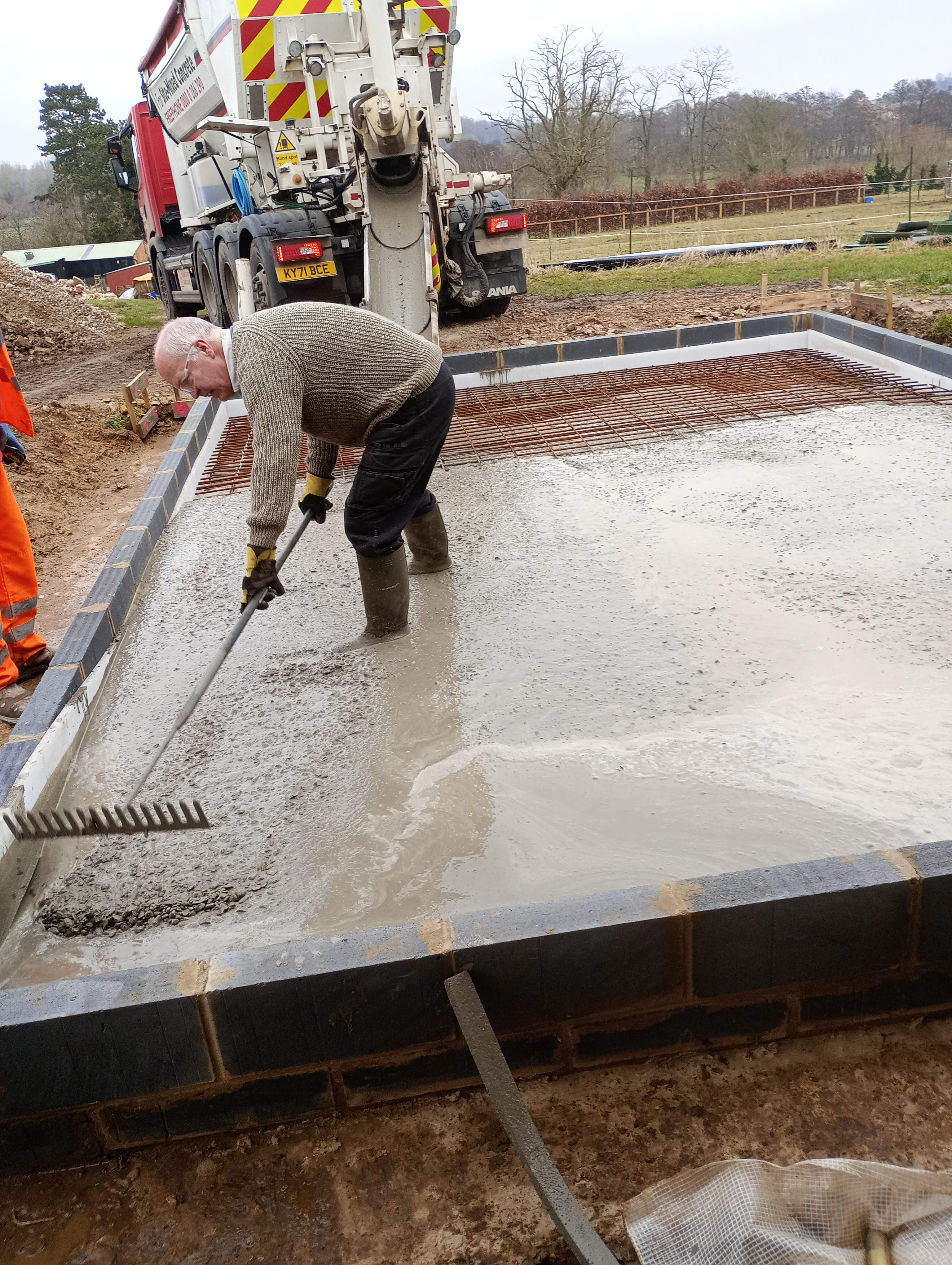

next was the rebar

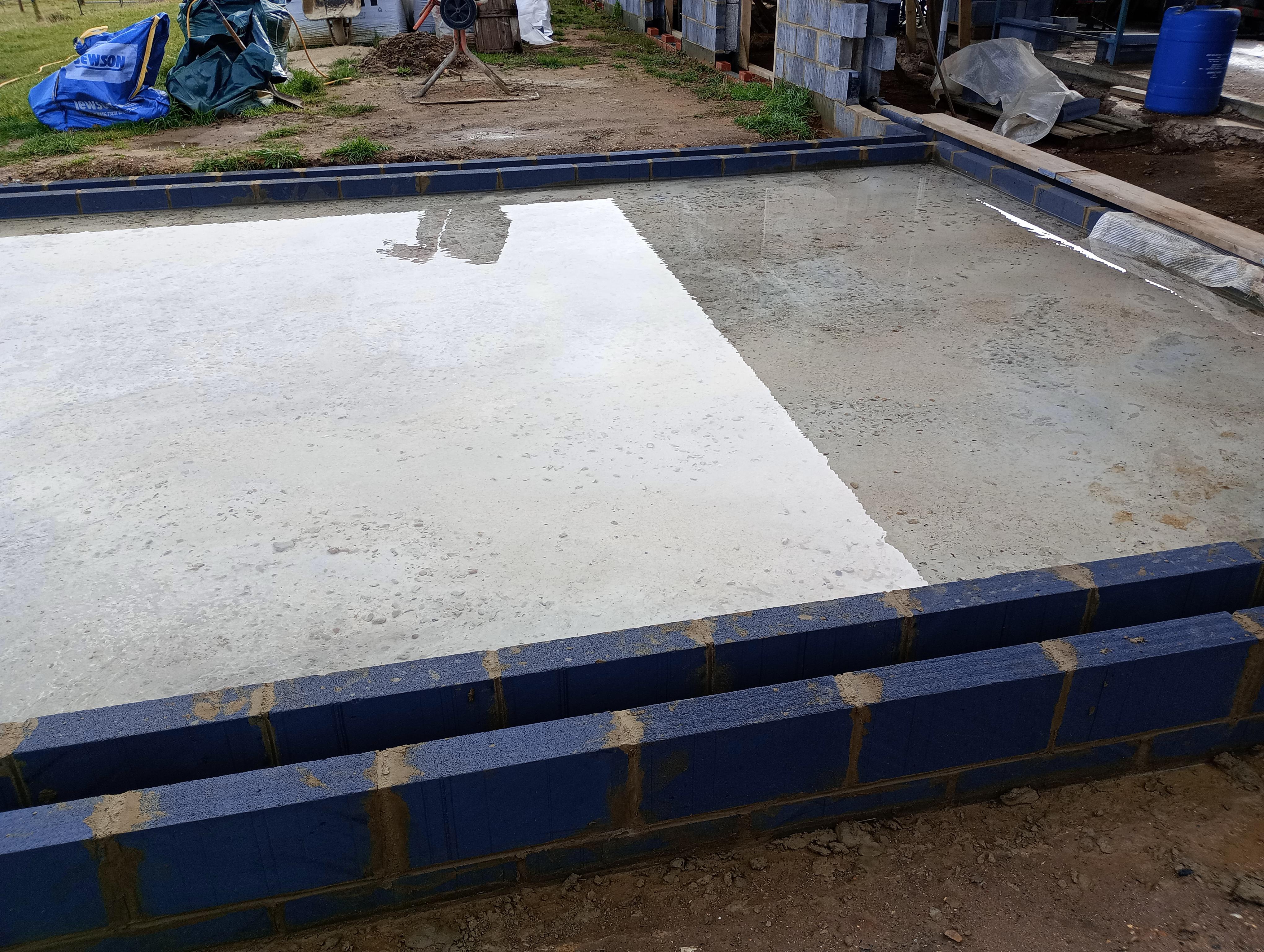

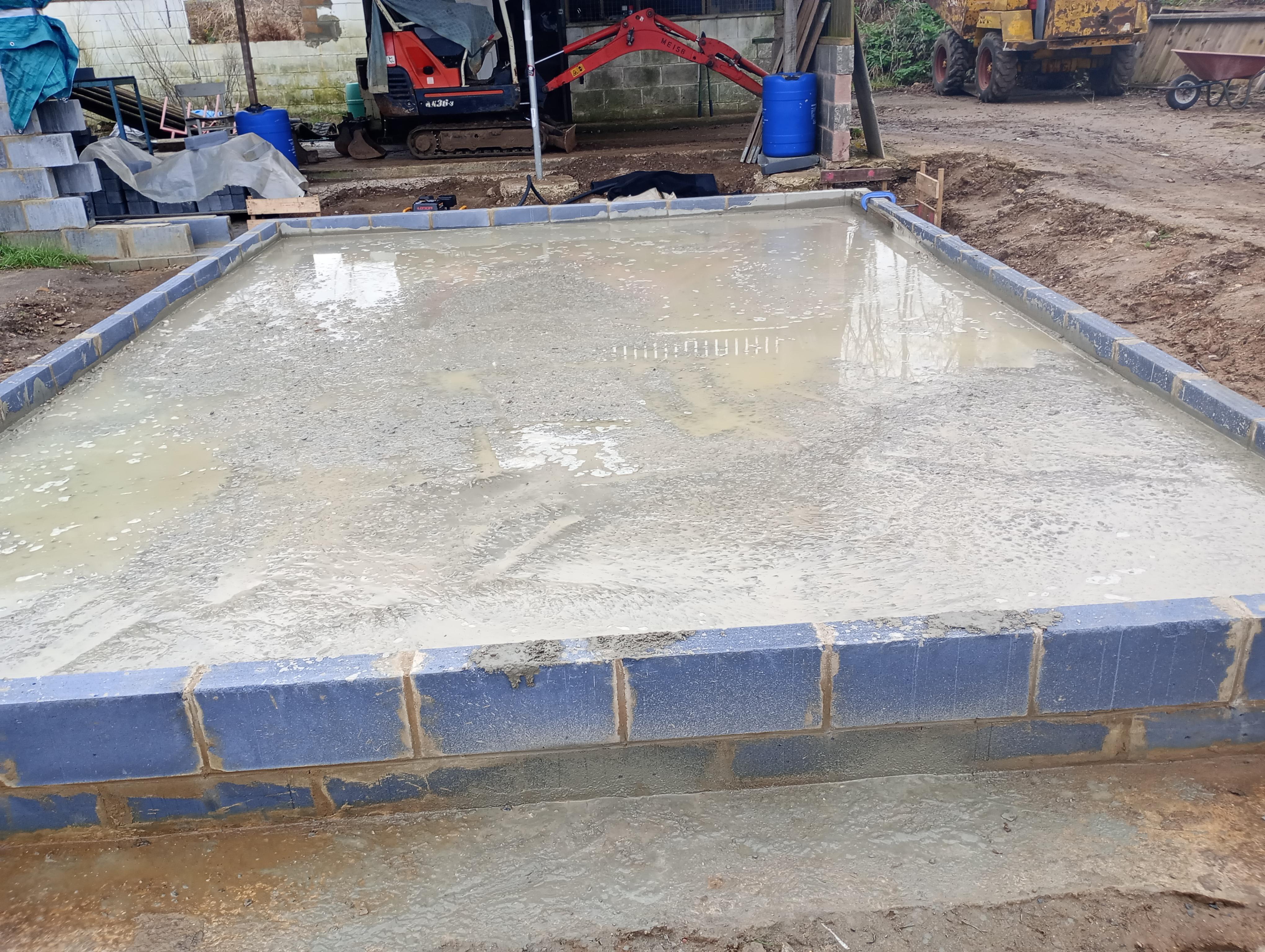

here is the pour on top of the rebar - 200mm
drying concrete slab with no hint of everything underneath, typical building, lots of expense and nothing to see.

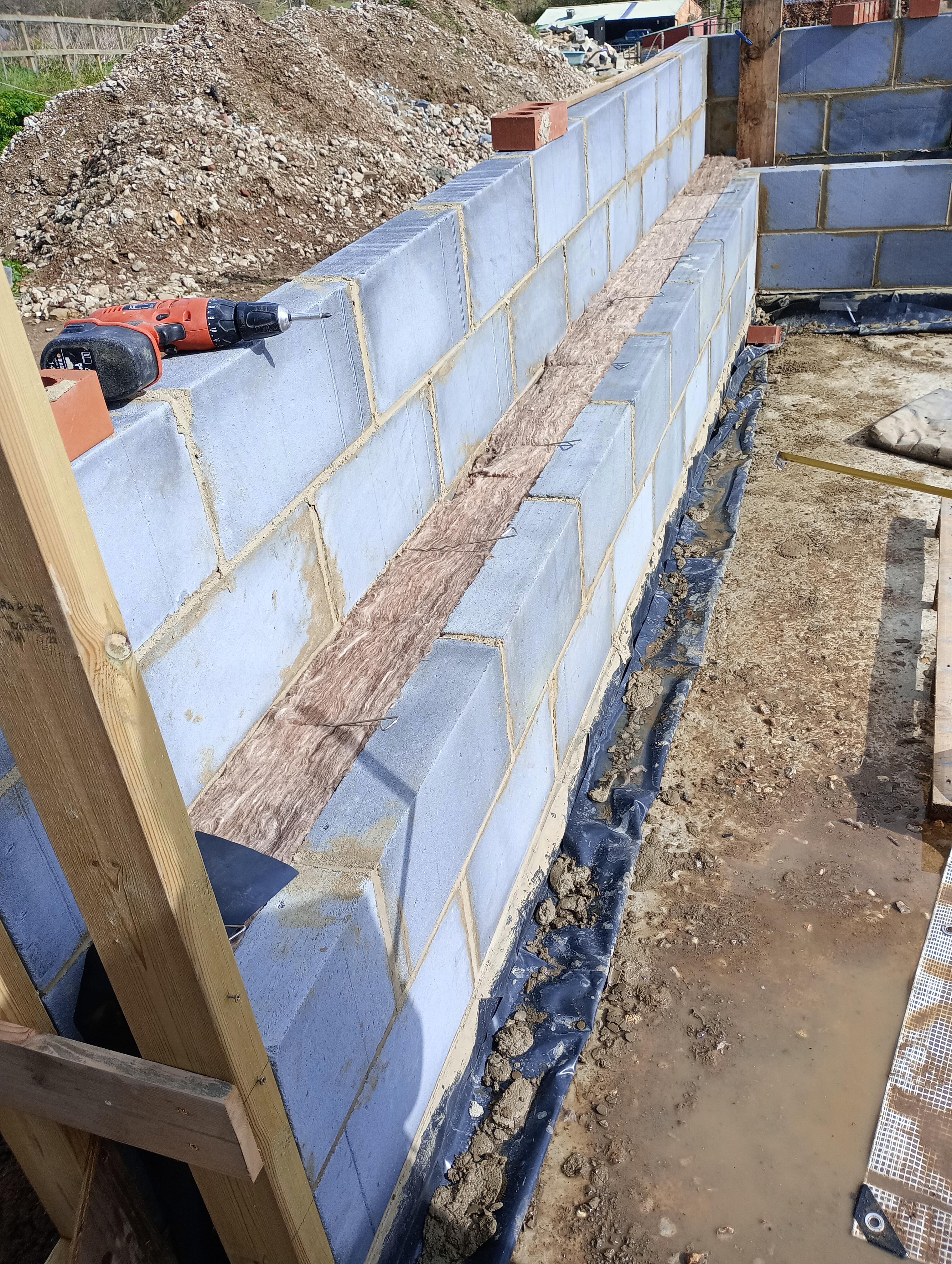

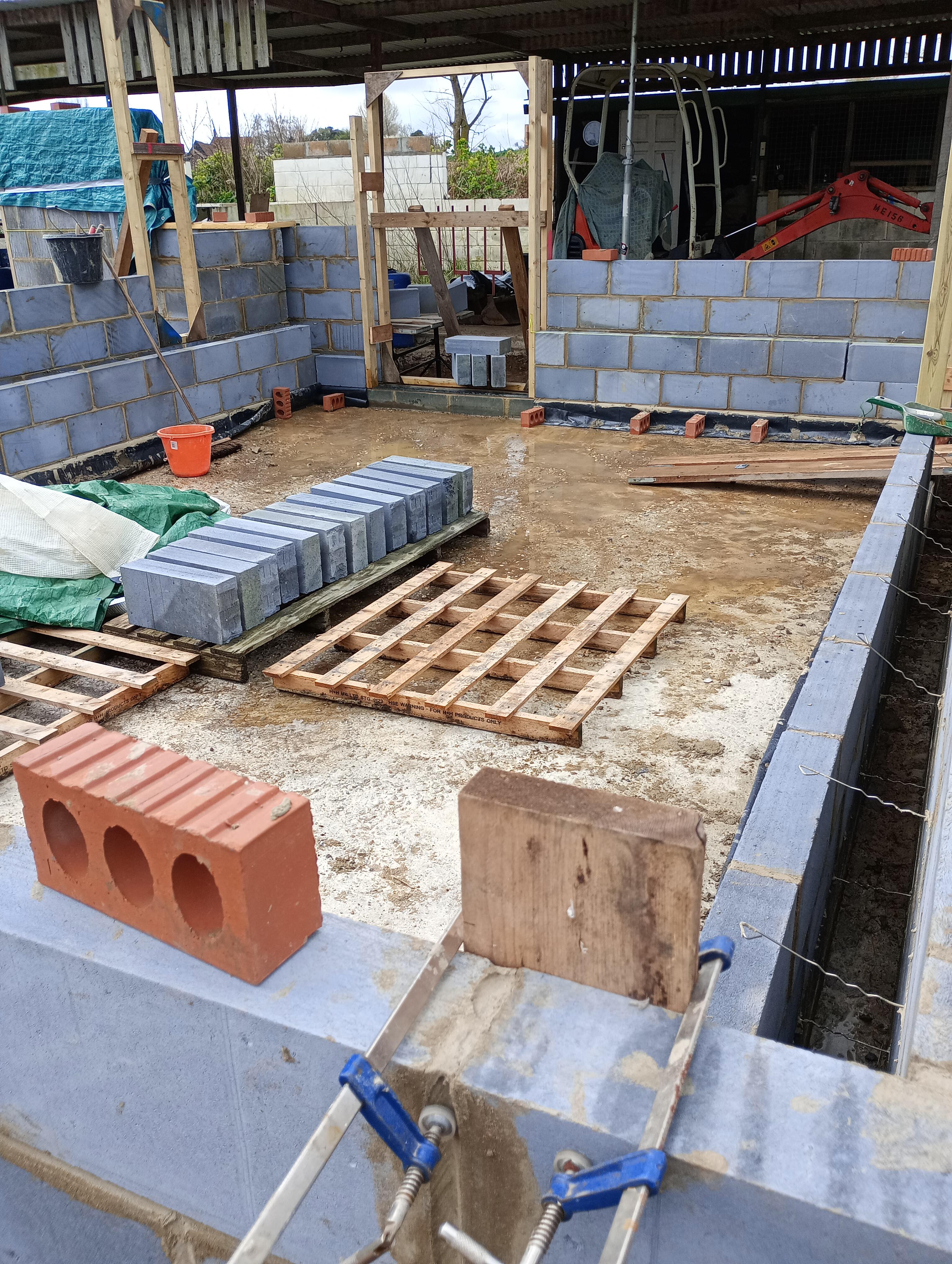

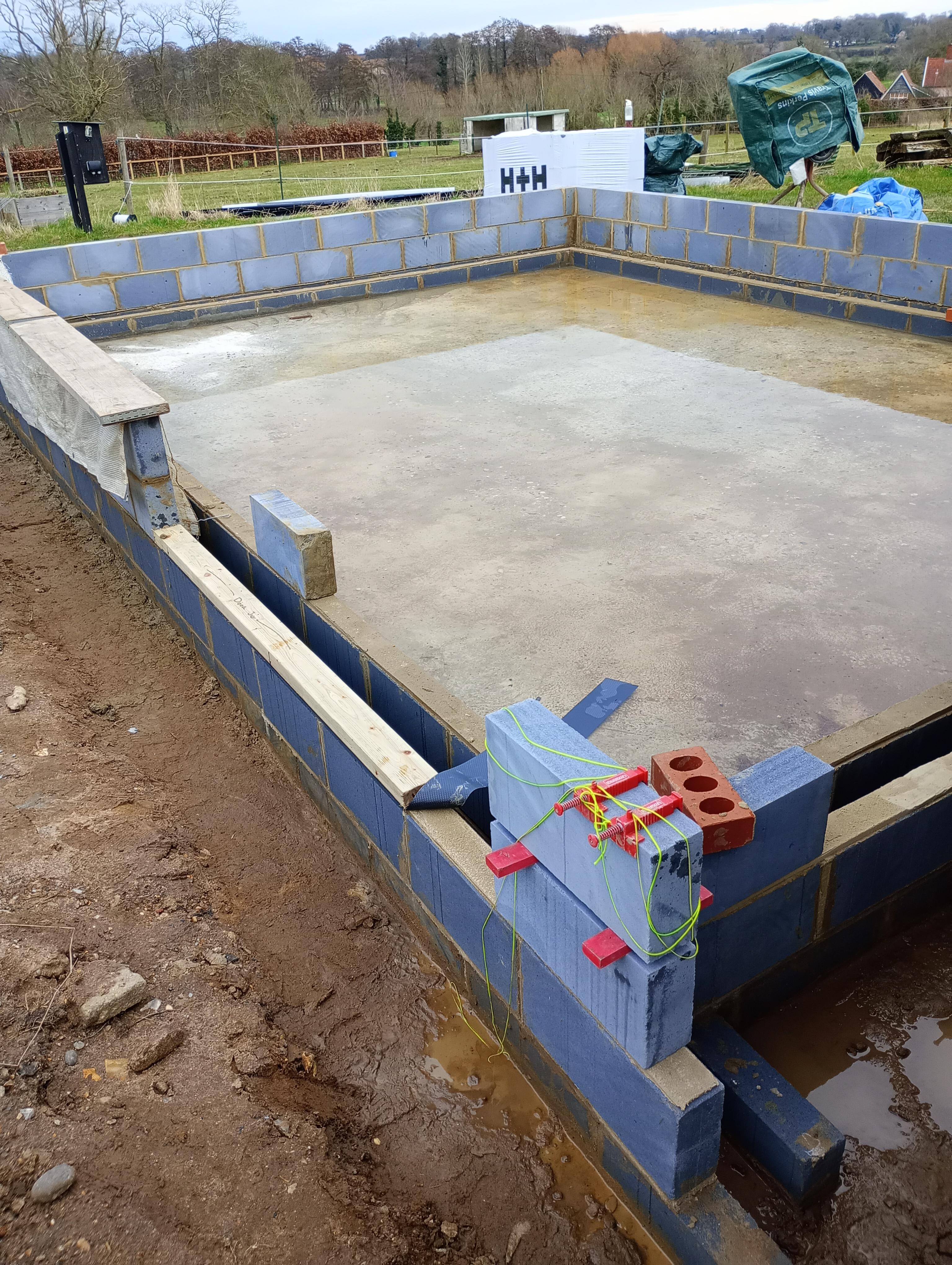

the first row of outside blocks added showing the cavity
first blocks over DPC

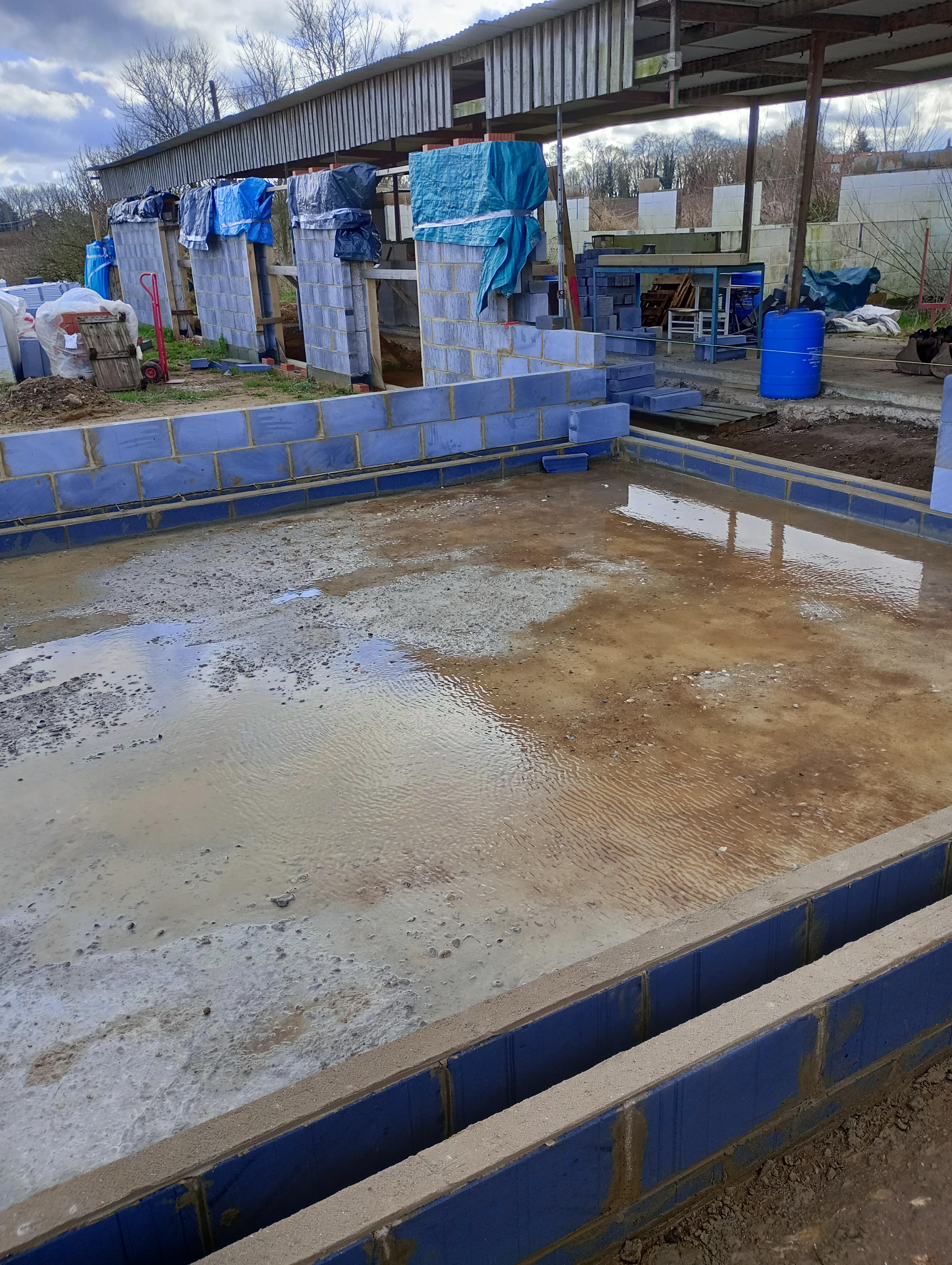

with all the rain we have created a bit of a swimming pool
It was at this point that we purchased a puddle pump as hubby really didn't like having to kneel and build low in water

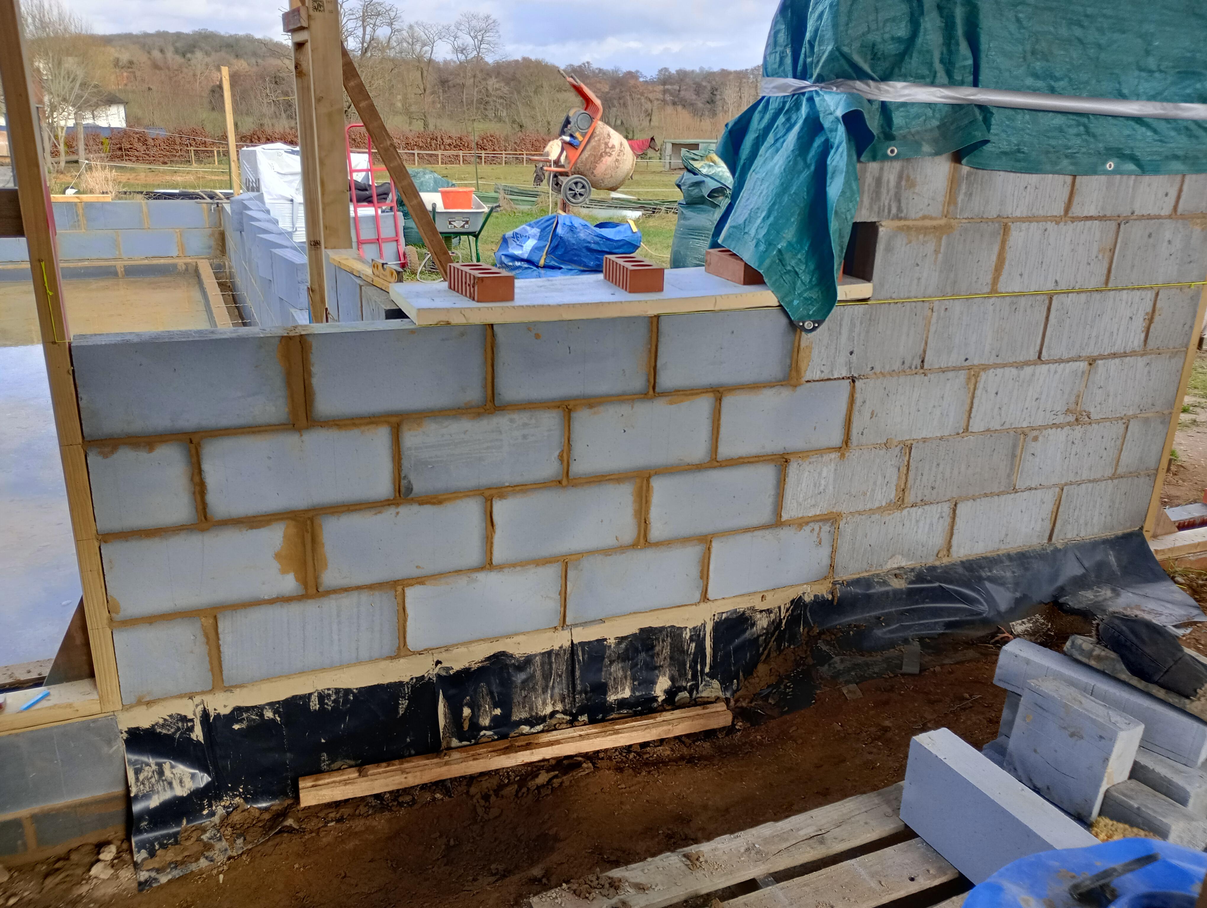

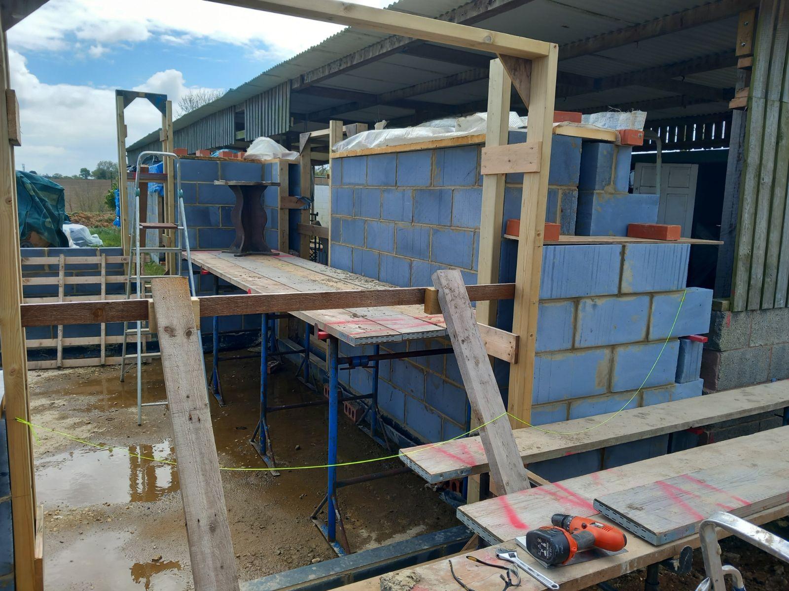

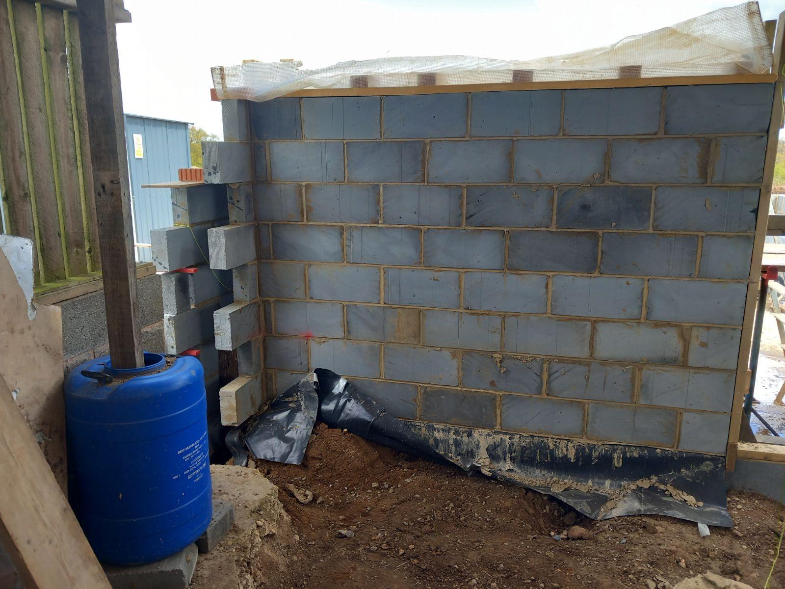

going up with some windows & doors framed
insulation going in
joining the existing walls to the new part
this is where some of the kitchen cabinets will be hung, so although internal we are using heavier blocks to take any necessary weight
On the left hand side you can see part of the existing barn that will be staying.
The roof is currently being held up with barrels and wood
building from scaffolding is a real milestone, makes it seem like we are getting somewhere.
To protect the insulation, we have the original insulation from the barn roof cut up to provide a 'roof' over the cavity.
Having made the frames for the remaining to windows these need to be placed in situ for building around.
This area will be our front hall and snug.
Of course, the front door will only be used by visitors, but we will go through the hall internally to get into the snug.
