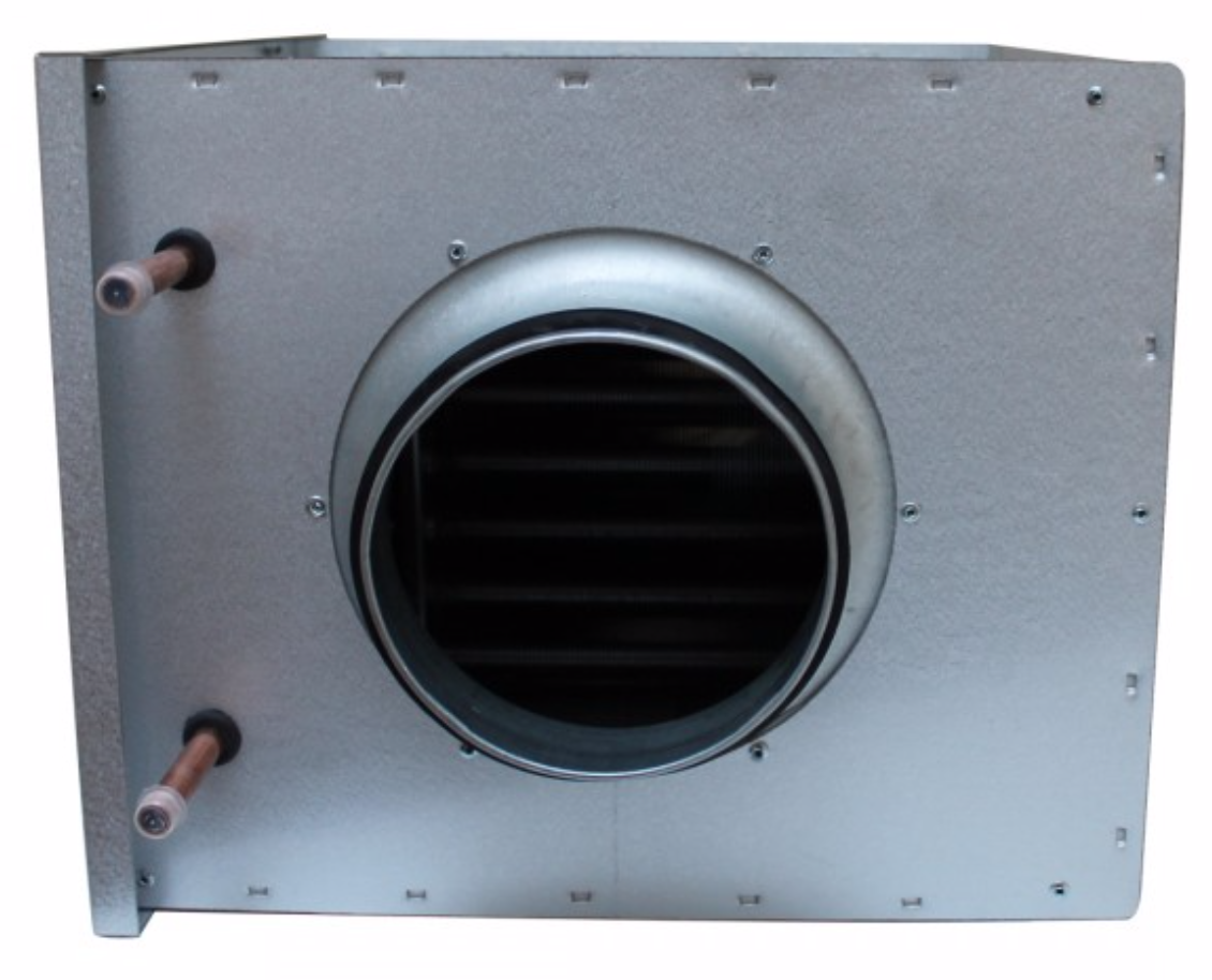

jack Posted June 4, 2019 Posted June 4, 2019 On 04/06/2019 at 09:21, Dan Feist said: @jack Can MHRV/Slab active cooling be retrofitted or does it need to be designed in from the start? I assume we'd need an MHVR system that supports the addition of cooling, and a heat pump that supports reverse mode? By "duct cooler", are you referring to active cooling being added to MHVR? Expand If you have UFH installed in the slab by MBC (which is what most of us have done), then it can be cooled using an ASHP. Nearly all of them support reverse mode, although it may not be well-documented. In our case, we had to change settings via the service mode, but instructions for doing this easily found on the internet. Yes, by "duct cooler" I mean this type of thing. It's also run off the ASHP in cooling mode. All MVHR systems support cooling, in the sense that you can always cool the air that they supply before it's distributed to the outlets. Condensation management may be more important here than in the UFH heating application - your entire floor isn't likely to reach the sorts of temperatures that would encourage condensation, but it's certainly possible in a duct. You don't need the temperature to be freezing cold though. For me, the aim would just be to reduce the temperature a few degrees below the current room temp, to reduce how high the peak gets during the day. I don't know what temperature that would be, but I imagine that something in the high teens would be fine. 1
Jeremy Harris Posted June 4, 2019 Posted June 4, 2019 Both @jack's build and ours are MBC passive system builds. PHPP showed a 3% overheating risk for us, which I (wrongly) assumed to be OK. As @jack mentioned, though, our house is in the bottom of a deep sheltered valley, facing South and is deep in a cutting in the hillside, so we get higher local temperatures than the weather/climate data predicts. Our slab cooling was just a matter of switching the ASHP into cooling mode, rather than heating mode. Almost all ASHPs will reverse and cool pretty much as well as they heat. Our MVHR cooling uses a Genvex Premium 1L MVHR unit, that has a built in air-to-air heat pump, that can either cool or heat the ventilation air. In practice we never use it for heating, as heating is really a non-issue for our house, but it's handy for providing a small amount of comfort cooling. The effect of the cooling from the MVHR is modest, as the ventilation rate is so low that it never shift a lot of heat, but it's useful, all the same. If doing this again I'd not have bothered with the active MVHR, but would have fitted a cheaper split aircon system. 1
Dreadnaught Posted June 4, 2019 Posted June 4, 2019 On 04/06/2019 at 09:31, jack said: Yes, by "duct cooler" I mean this type of thing. Expand While it is called a "Duct Mounted Cold Water Cooler", and has the requisite condensate drain, am I right to assume it would work perfectly well as a duct heater in winter to take the chill off incoming air, which will be ever so slightly cooler than room air during the winter?
jack Posted June 4, 2019 Posted June 4, 2019 On 04/06/2019 at 09:38, Dreadnaught said: ... am I right to assume it would work perfectly well as a duct heater in winter to take the chill off incoming air, which will be ever so slightly cooler than room air during the winter? Expand Yes, that's right. I believe the sole difference is the condensate drain. If you're only heating, you don't need one, but if you're cooling or doing both, you do. 1

jack Posted June 4, 2019 Posted June 4, 2019 On 04/06/2019 at 11:42, Dan Feist said: I was assumed retrofitting something like "Zehnder ComfoCool" if we found we needed some active cooling. A duct cooler would probably be harder to retrofit I assume. Expand I think it depends what you start with. Even if you start with the correct MVHR, you still need to ensure space to retrofit the ComfoCool unit - probably not a deal-breaker with a bit of planning. The ComfoCool looks pretty expensive - around £4000 from a quick look. You could install a big split system air conditioner for that sort of money. With planning, the duct cooler needn't be difficult to retrofit. You need to plan where it will go, and ensure there's space for you to install it, but other than that it's just a flow and return line from the ASHP circuit, plus a route to a drain for the condensate. Actually, planning the hydraulic circuit and control is probably the tricky bit, especially if you're combining it with underfloor cooling. On 04/06/2019 at 11:42, Dan Feist said: BTW, any suggestions on good external blinds that are easy to automate without have a proprietary control system? Expand Ours came with the windows. I think Luxaflex might make some, as does Hunter Douglas. They do need to be carefully detailed to work with your windows, apertures and exterior cladding/finishes.

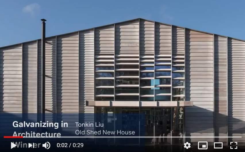

Ferdinand Posted June 4, 2019 Posted June 4, 2019 (edited) I would add 2 items. 1 - Some form of automated or touch of a button outlet for nighttime purge ventilation at the top. 2 - This interesting detail of a briese soleil that does not look like a chip cutter, from the House Of the Year if it was Designed By An Architect programme. Old Shed New House. They have a belt of trees quite close, which will help with the autumn and spring. Ferdinand Edited June 4, 2019 by Ferdinand
