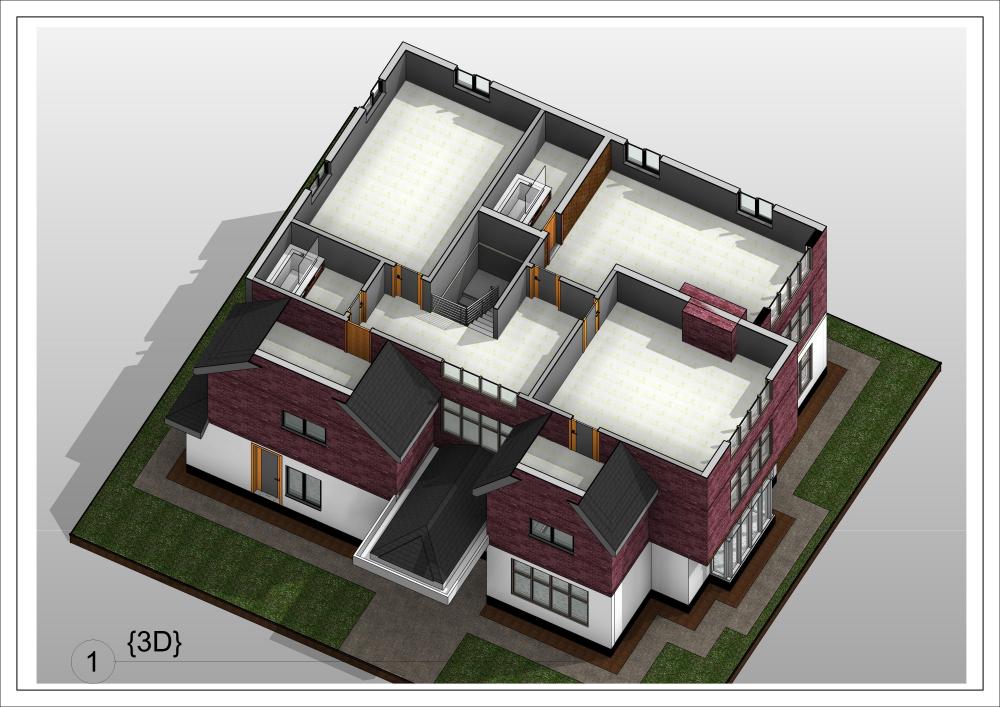

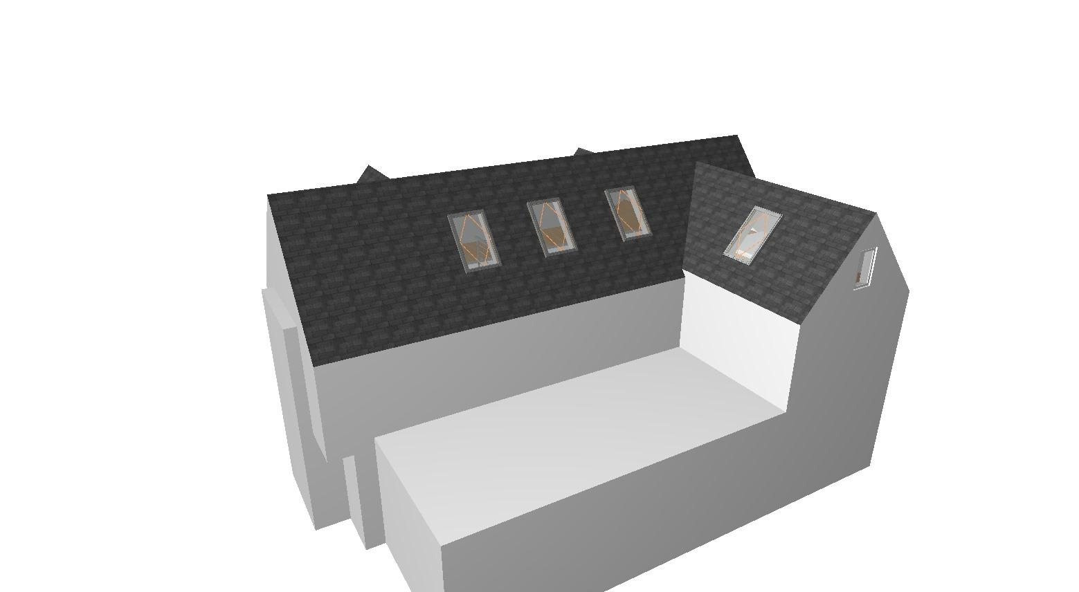

harry_angel Posted June 4, 2019 Author Share Posted June 4, 2019 (edited) Cheers guys. I should have been clearer that we would be expanding the loft space in doing this - you can see the change from the 2 images below. The 2nd image shows the proposed new 2nd floor. Currently the kitchen is single storey as you can see, but by making it 2 storey we also increase the potential size of the loft (because the existing loft will then have a new ceiling to link up to). I mean: it's a big job, we would be totally scrapping the existing pitch roof in favour of a new straight wall line + false pitch roof, semi-concealing a flat roof. So it's almost like we're saying to: "we want to convert what's already there....and add to it...considerably". I think I should probably tread softly softly and just apply as you guys say to add the bedroom above the kitchen and "re-sculpt" the roofline...which genuinely does look like a hodgpodge of random extensions currently. Note: the 2 images obviously show different sides of the house, which I know isn't clear or helpful. But the architect hasn't sent over the corresponding image yet. Edited June 20, 2019 by harry_angel 2 Link to comment Share on other sites More sharing options...
