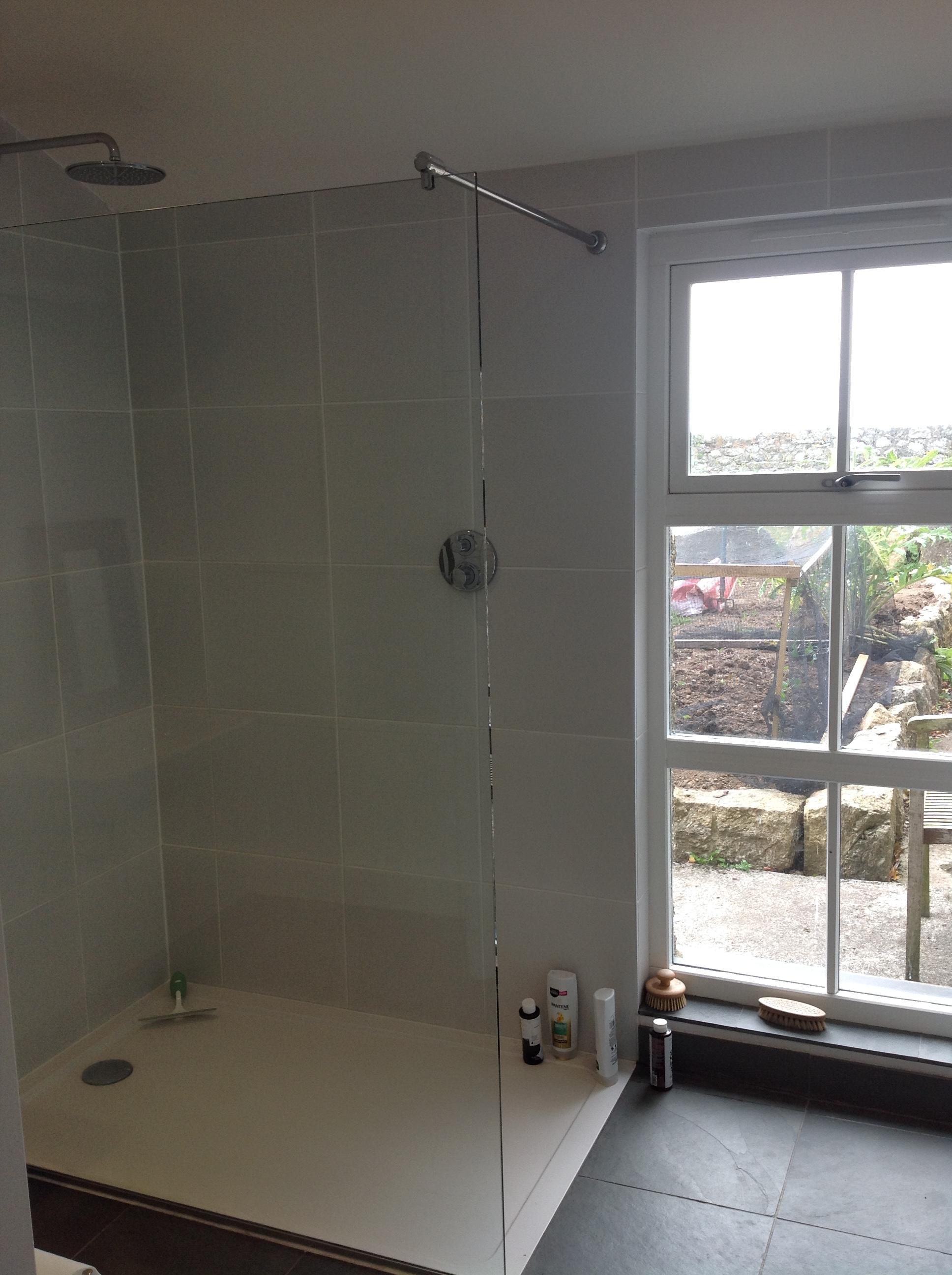

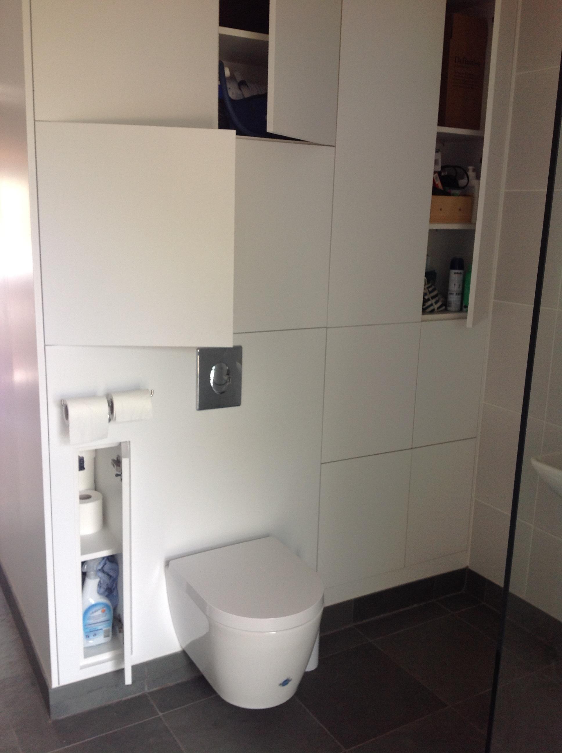

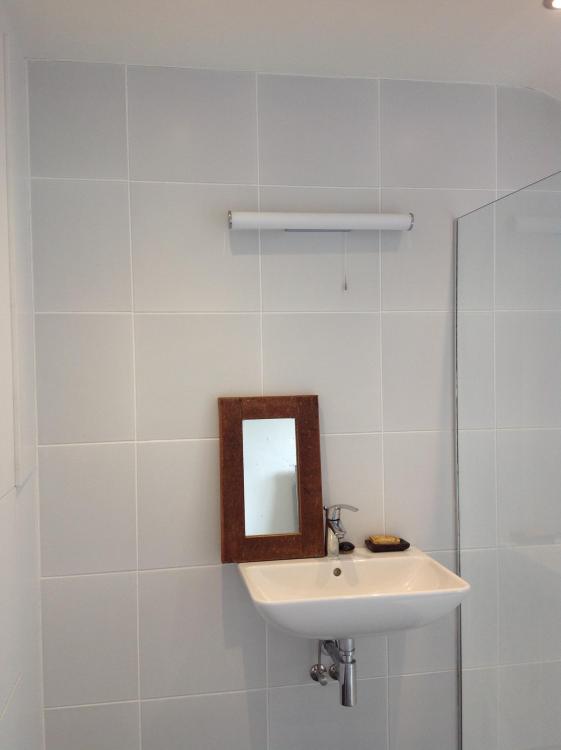

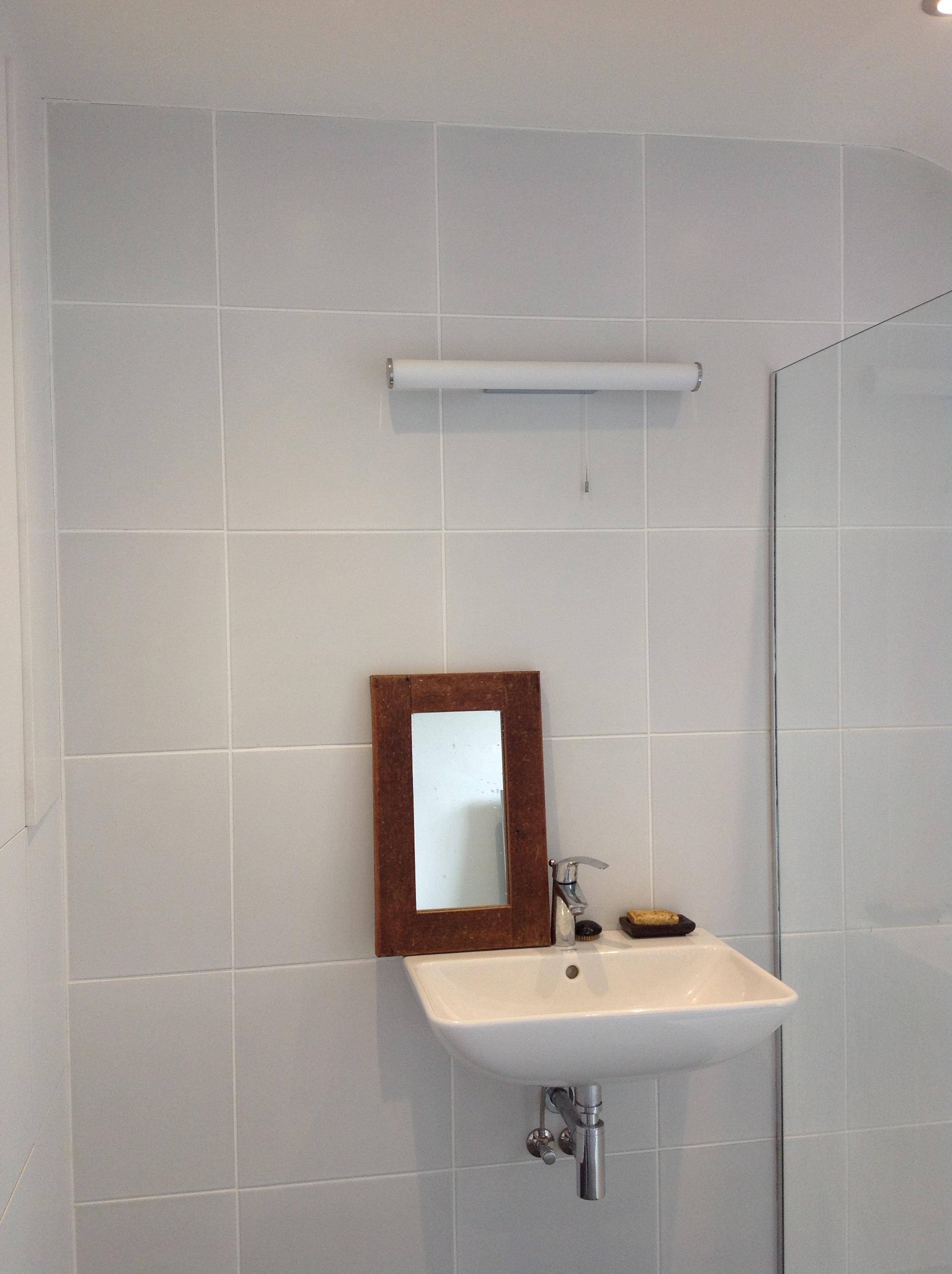

Nick1c Posted June 3, 2019 Share Posted June 3, 2019 A bit late now, but when we had our new bathroom put in at our current house we brought the stud work for the wall hung toilet forward a little & used the whole of the wall, excluding the cistern area, for cupboards. 1 Link to comment Share on other sites More sharing options...

Dreadnaught Posted June 3, 2019 Share Posted June 3, 2019 3 hours ago, Nick1c said: A bit late now, but when we had our new bathroom put in at our current house we brought the stud work for the wall hung toilet forward a little & used the whole of the wall, excluding the cistern area, for cupboards. That looks well done. How did you construct the cupboards? And pre-cut system? I am looking for storage ideas for the two bathrooms in my forthcoming build. 1 Link to comment Share on other sites More sharing options...
Nick1c Posted June 3, 2019 Share Posted June 3, 2019 The builders put it together to our design. It's made of MDF with a rolled paint finish, Blum hinges & push catches, ours is 350mm deep. I like the clean looks & it gives a lot of storage for relatively little loss of useful space on the shower room. It has a 1400mm shower tray, basin & toilet in it, it feels about the right amount of space - plenty of room to move, but not pointlessly extravagant. Still need to sort out the mirror! 2 Link to comment Share on other sites More sharing options...
