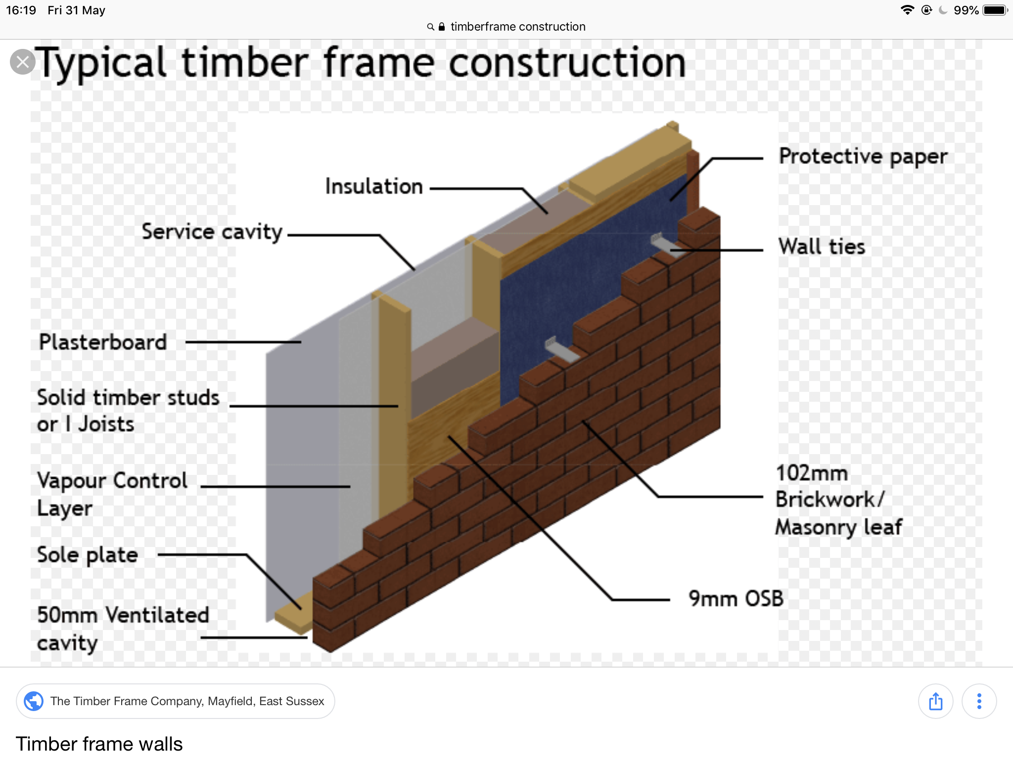

Russell griffiths Posted May 31, 2019 Share Posted May 31, 2019 You seam to be getting mixed up between different methods. You need to look at lots of our pictures on here. A timberframe house is structural, the timber holds up the floor and the roof and contains the insulation, once the frame is up the roof can go on. On the outside of this you can have whatever you want to meet your planned design, you can put boards on it and render it, you can put blocks around it and render it. A timberframe is the structure you only need one block thick on the outside, it is just a skin to keep the weather off. A block built house is TWO skins of blocks to form a cavity, insulation in the gap,cavity. Render on the outside. Link to comment Share on other sites More sharing options...
zoothorn Posted May 31, 2019 Author Share Posted May 31, 2019 @Russell griffiths hi there. Yes I think I am too. This is why I was hoping to do a thread & find out different methods, but maybe I'm getting confused between them. Ok thanks for your clarifying further the TF method, but doesn't the wall you outline also need a cavity between it & whatever is "on the outside" in order for 'weather not to bridge gap to inner wall'? I thought the cavity was the one constant compulsory needed by BRegs, consistant across different wall methods. Link to comment Share on other sites More sharing options...

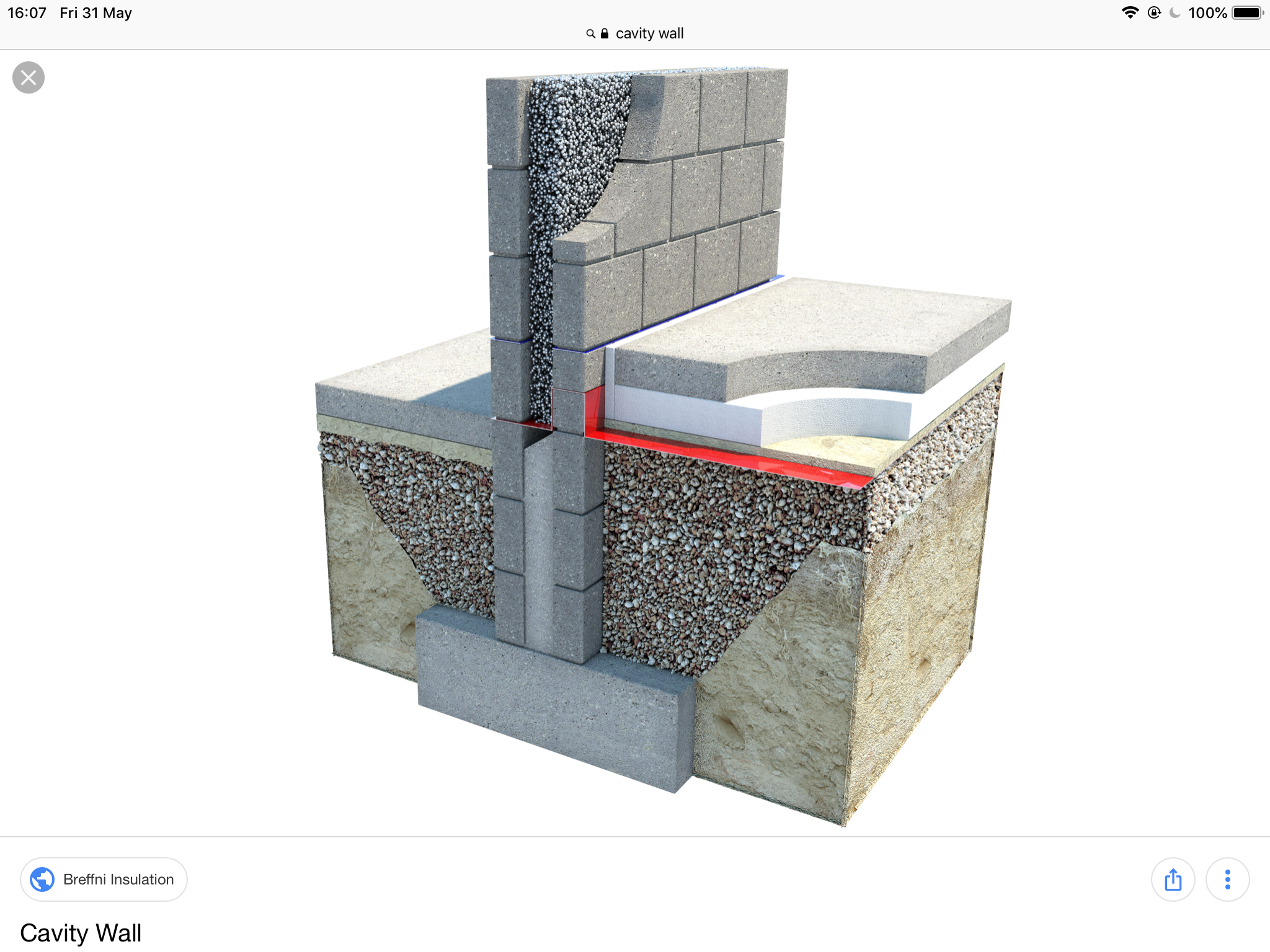

Russell griffiths Posted May 31, 2019 Share Posted May 31, 2019 double block cavity wall. On a strip foundation with a concrete floor on insulation Link to comment Share on other sites More sharing options...
Russell griffiths Posted May 31, 2019 Share Posted May 31, 2019 you are right in thinking that all methods have a cavity, but sometimes in timberframe it isn’t so much of a cavity as just a gap, this is to allow air flow between the two skins and allow any moisture that gets between the skins to dry out. Link to comment Share on other sites More sharing options...

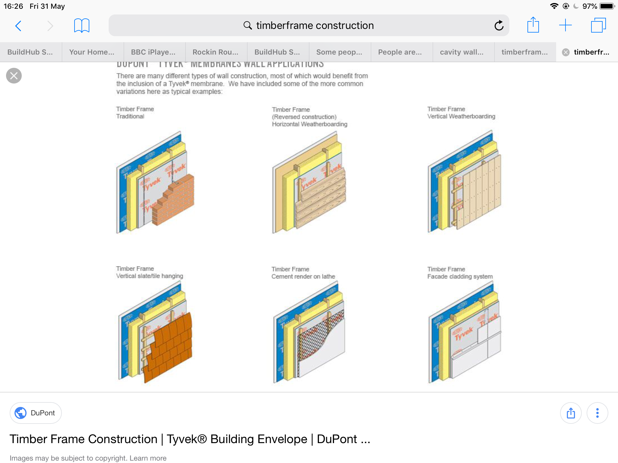

zoothorn Posted May 31, 2019 Author Share Posted May 31, 2019 Ok that helps Russell alot. So what are the options, instead of the bricks in 2nd TF construction pic? Link to comment Share on other sites More sharing options...
Russell griffiths Posted May 31, 2019 Share Posted May 31, 2019 Link to comment Share on other sites More sharing options...
zoothorn Posted May 31, 2019 Author Share Posted May 31, 2019 Right that's the image I was after- many thanks Russell. So I wonder what my builder's quote is up to if he quotes so vaguely for "external walls", & my plans he base the quote off (same as you see on my zoot's ext thread) clearly show a rendered finish? If so then image no.5 must be. For £13k his quote was for 'external walls, floor, roof'. I'm not sure the relevance of 'external': external relative to a separate internal wall/ course.. or external just a word for the 3 walls. His quote not inc groundwork, scaffold, doors/ windows, electrics, possibly not even inside pB too. Is 'for external walls.. £*k' a typical builder quote terminology, for a full wall? Link to comment Share on other sites More sharing options...

zoothorn Posted June 3, 2019 Author Share Posted June 3, 2019 Could anyone tell me about a TF build, with block cladding: how much is the outer block course adding strength/ structural chutzpah to the TF core? I see the 'wall ties' ties on various builds, but are these ties to link the two structures purely for alignment purposes.. &/ or also a link in terms of structural rigidity? Link to comment Share on other sites More sharing options...
PeterW Posted June 3, 2019 Share Posted June 3, 2019 15 minutes ago, zoothorn said: Could anyone tell me about a TF build, with block cladding: how much is the outer block course adding strength/ structural chutzpah to the TF core? I see the 'wall ties' ties on various builds, but are these ties to link the two structures purely for alignment purposes.. &/ or also a link in terms of structural rigidity? None... nothing .... nada... its a skin only. Link to comment Share on other sites More sharing options...
Jeremy Harris Posted June 3, 2019 Share Posted June 3, 2019 14 minutes ago, zoothorn said: Could anyone tell me about a TF build, with block cladding: how much is the outer block course adding strength/ structural chutzpah to the TF core? I see the 'wall ties' ties on various builds, but are these ties to link the two structures purely for alignment purposes.. &/ or also a link in terms of structural rigidity? The outer block/brick doesn't add anything structural to the TF, the TF takes the loads and the block/brick skin is really just there to keep the rain out. The ties are needed to keep the block/brick skin together against things like wind loads, as a single skin block/brick wall isn't very good at withstanding side loads and needs to be braced. As such the ties are critical to maintaining the stiffness of the wall, but they don't take any of the loads imposed by the internal structure. Link to comment Share on other sites More sharing options...

zoothorn Posted June 3, 2019 Author Share Posted June 3, 2019 (edited) 5 hours ago, JSHarris said: The outer block/brick doesn't add anything structural to the TF, the TF takes the loads and the block/brick skin is really just there to keep the rain out. The ties are needed to keep the block/brick skin together against things like wind loads, as a single skin block/brick wall isn't very good at withstanding side loads and needs to be braced. As such the ties are critical to maintaining the stiffness of the wall, but they don't take any of the loads imposed by the internal structure. hi JSH.. I understand the general ideas in reply to my Q, I wonder still though if a block outer course would add anything in terms of -wind- protection.. that's my main concern (my Q better put perhaps like so). You hinted "..wind loads" wouldn't be as good if a single skin: but wouldn't it matter inherrantly what the skins are made from though? I wonder if block would be the best barrier against the load from wind (especially hitting the end of my extention, sideways on). Are there any benefits to choosing a block cladding over a timber, for my build? Edited June 3, 2019 by zoothorn Link to comment Share on other sites More sharing options...
