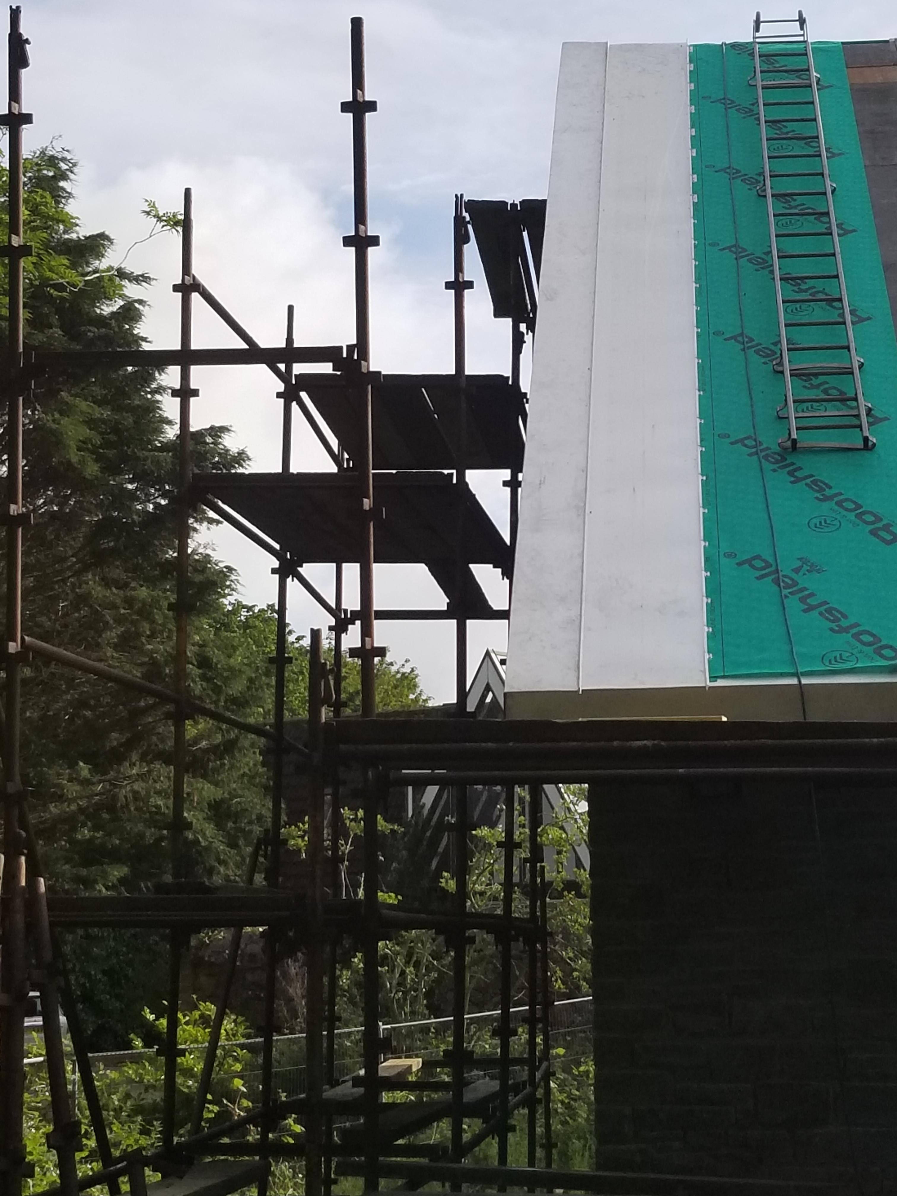

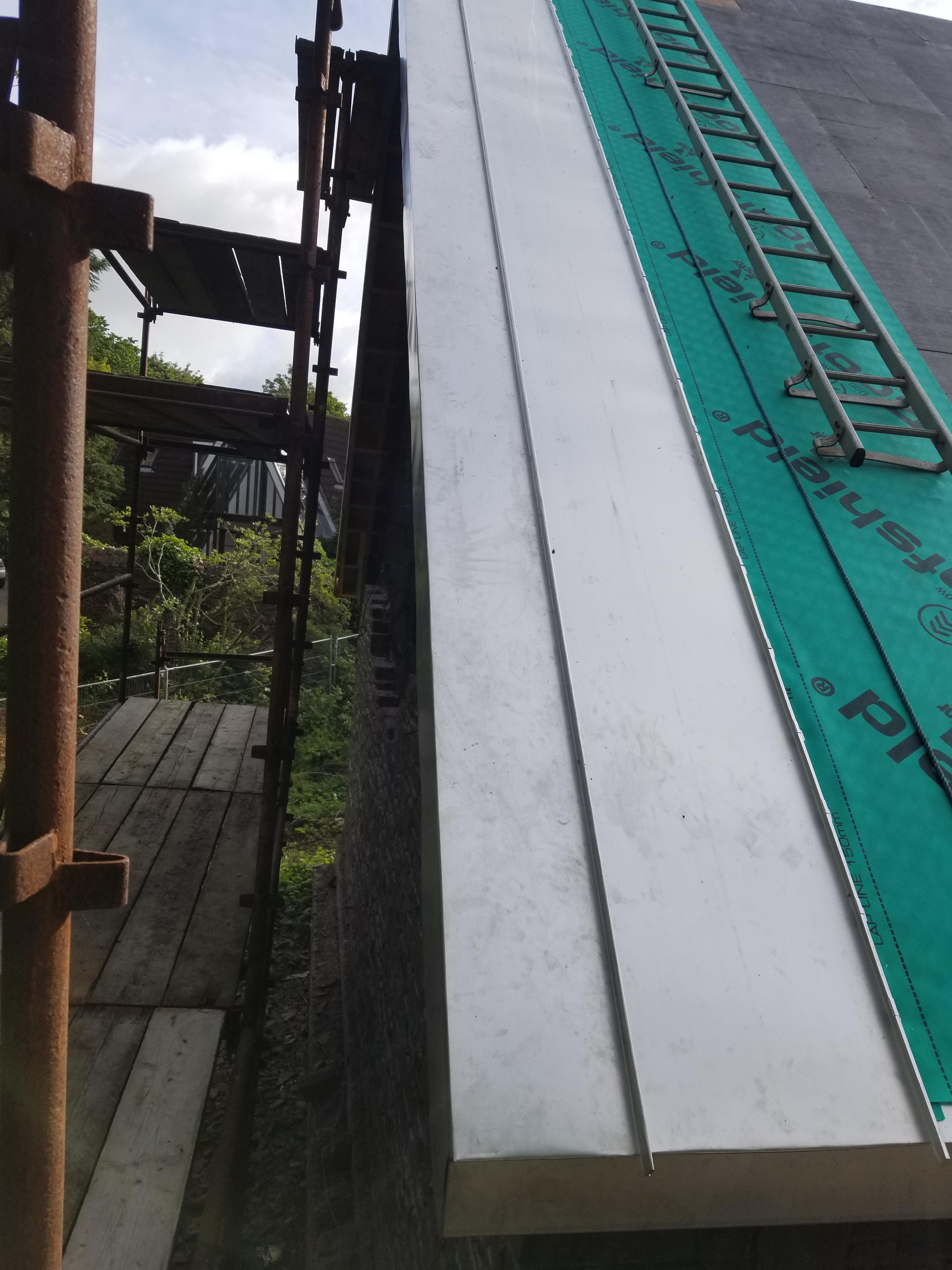

Alexphd1 Posted July 5, 2019 Posted July 5, 2019 Only started a few days ago but having a problem with the seaming machine. Will post a few photos today.

Cpd Posted October 18, 2019 Posted October 18, 2019 @Alexphd1 can you explain your reasoning for putting your roofing felt on in vertical strips rather than doing the whole roof first and laying it in horizontal formation starting at the bottom so that your overlaps will prevent water ingress should there be a leak. I am sure you are following proper guidelines but I have never seen it done like this. Thanks. 1
Pocster Posted October 18, 2019 Posted October 18, 2019 1 hour ago, Cpd said: @Alexphd1 can you explain your reasoning for putting your roofing felt on in vertical strips rather than doing the whole roof first and laying it in horizontal formation starting at the bottom so that your overlaps will prevent water ingress should there be a leak. I am sure you are following proper guidelines but I have never seen it done like this. Thanks. Yeah I noticed that and thought “eek!” . But as I know there could be method to the madness
Alexphd1 Posted October 18, 2019 Posted October 18, 2019 Tbh should have done horizontal but that's the 2nd felt layer, questioned if really needed it. 1

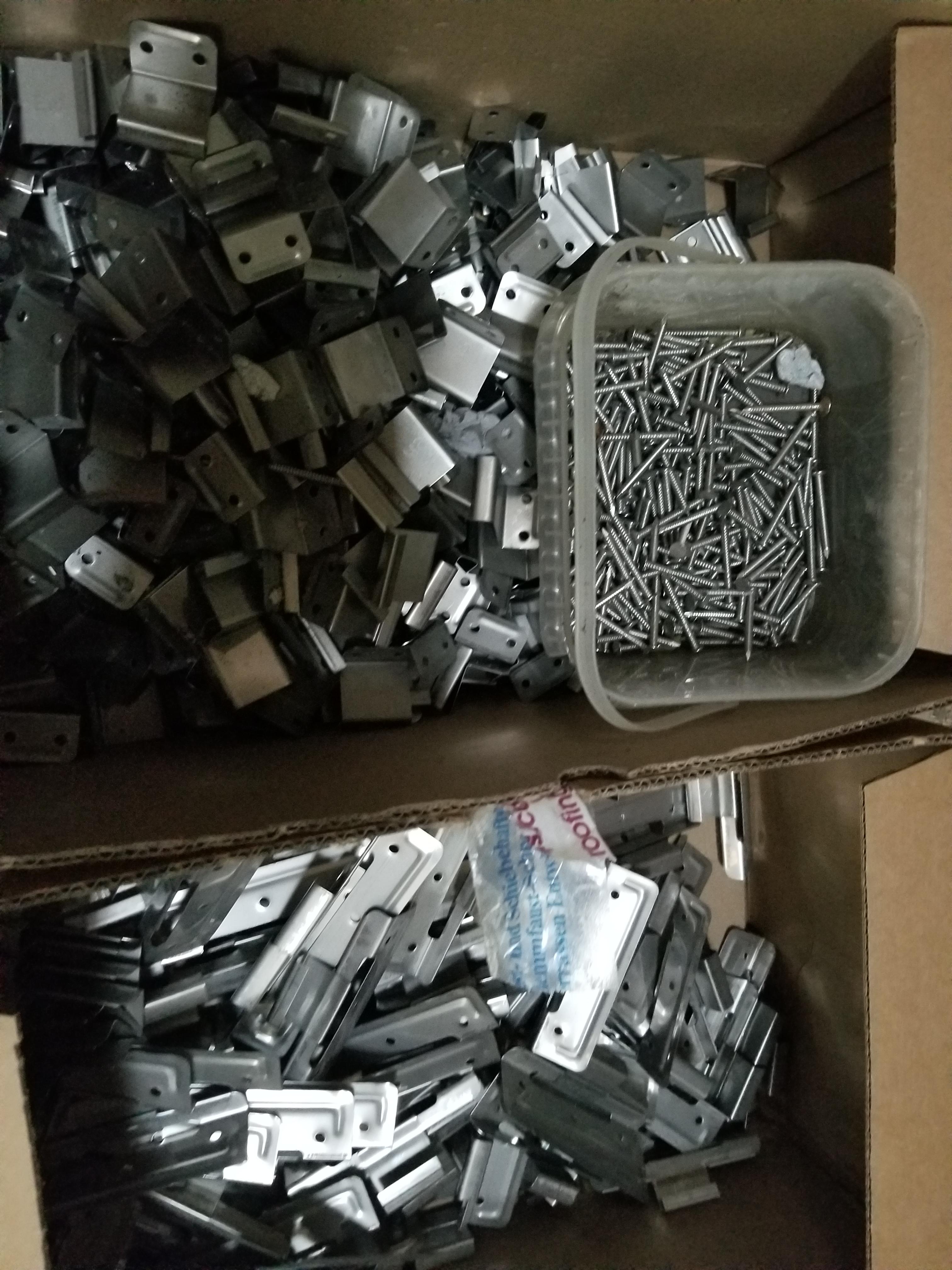

Russell griffiths Posted October 18, 2019 Posted October 18, 2019 The company building lots of high spec houses down the road from me are putting their membrane on vertically, I did consider it but opted to make life utterly miserable and installed it horizontal which was a bloody pain. How do you like all those clips @Alexphd1 I have 3500 to put on ? tiny little screws and big fat fingers. Lol
Alexphd1 Posted October 18, 2019 Posted October 18, 2019 Not my favorite job? we actually used stainless nails. We have a few clips left (normal and sliding) so if you need a few to finish of give me a shout (not looking to offload as will use them on next build but may just help you out finishing of job) 1
