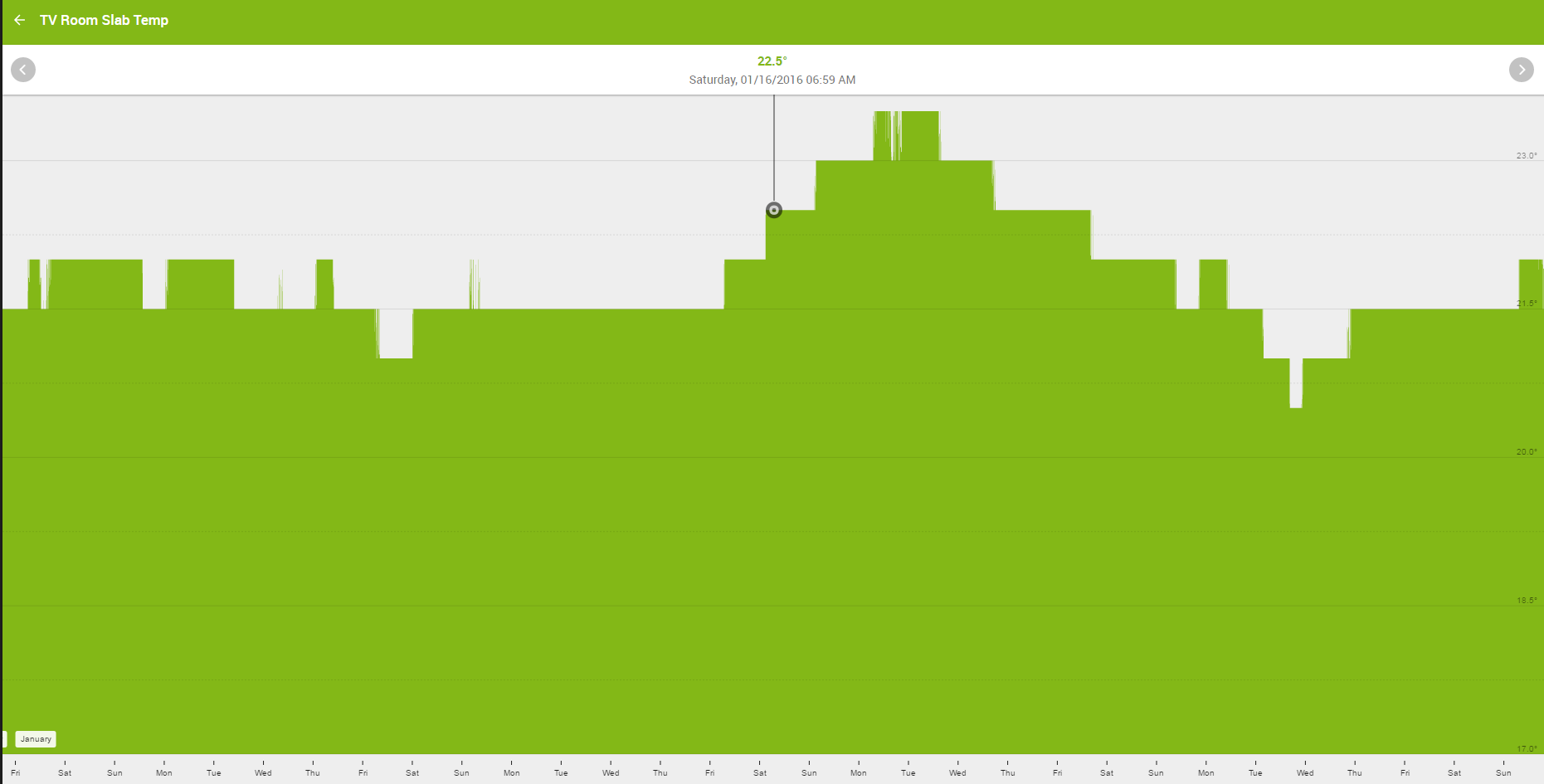

jack Posted September 6, 2016 Posted September 6, 2016 We have a 5kW Panasonic Aquarea for our close-to-Passive-House-standard 289m2 house. As I've mentioned elsewhere, we have quite a bit of shading and nothing like Jeremy's warm microclimate, so the ASHP spent a lot of winter ticking over gently keeping the insulated slab at around 21-22 degrees. As for DHW, over winter we have the ASHP heat the tank to 55 degrees between 4 and 6 o'clock each morning. Looking at the temperature plots, that seemed to be about the maximum time it took to get the whole 250L tank up to temperature (and it did get to pretty-well bang on 55 degrees, despite the ASHP being located 9 or 10m away from the tank). The top 30% of the tank is then heated to 85 degrees by the upper immersion heater that switches on at 6am. I don't believe we've ever run out of water with our family of four. Also, we have 8.5kW of PV. It occurred to me the other day that the ASHP probably hasn't had cause to turn on for several months due to the amount of energy being pumped into the tank every day. I wonder whether not being used in this way could negatively impact longevity? 1
Stones Posted September 6, 2016 Author Posted September 6, 2016 On 06/09/2016 at 11:15, jack said: We have a 5kW Panasonic Aquarea for our close-to-Passive-House-standard 289m2 house. As I've mentioned elsewhere, we have quite a bit of shading and nothing like Jeremy's warm microclimate, so the ASHP spent a lot of winter ticking over gently keeping the insulated slab at around 21-22 degrees. As for DHW, over winter we have the ASHP heat the tank to 55 degrees between 4 and 6 o'clock each morning. Looking at the temperature plots, that seemed to be about the maximum time it took to get the whole 250L tank up to temperature (and it did get to pretty-well bang on 55 degrees, despite the ASHP being located 9 or 10m away from the tank). The top 30% of the tank is then heated to 85 degrees by the upper immersion heater that switches on at 6am. I don't believe we've ever run out of water with our family of four. Also, we have 8.5kW of PV. It occurred to me the other day that the ASHP probably hasn't had cause to turn on for several months due to the amount of energy being pumped into the tank every day. I wonder whether not being used in this way could negatively impact longevity? Expand Interesting. Would you say your ASHP ran pretty much 24/7 during the coldest spell (albeit ticking over)? In terms of DHW production, was there any noticeable or measurable drop in house temperature whilst the ASHP was otherwise engaged?

TerryE Posted September 6, 2016 Posted September 6, 2016 (edited) On 06/09/2016 at 18:27, Stones said: Interesting. Would you say your ASHP ran pretty much 24/7 during the coldest spell (albeit ticking over)? In terms of DHW production, was there any noticeable or measurable drop in house temperature whilst the ASHP was otherwise engaged? Expand Jason, If it did then there'd be something wrong with the thermal design of the house. Our net loss in a typical January is estimated at around 11 kWhr / day or less than 0.5 kW sustain. OK our slab isn't going to perform as well as modelled but this isn't going to lift this by more than about 25-30%. If the minimum output of a 5 kW ASHP is say 1.5 kW then it's mark/space ratio should still be around 30% in the depths of winter. And as Nick says, the thermal capacity of the slab will totally dominate any mark/ space ripples. As Jeremy kept repeating: do the calculations and have faith in them. The main complication from a design PoV is whether you are going to attempt to use the ASHP to prime for DHW and to do this you need a TS or a zones PWC as in Jack's case. Here you have to balance the gearing of the ASHP against the extra heat losses from a TS or PWC. Your call. Edited September 6, 2016 by TerryE
jack Posted September 6, 2016 Posted September 6, 2016 On 06/09/2016 at 18:27, Stones said: Interesting. Would you say your ASHP ran pretty much 24/7 during the coldest spell (albeit ticking over)? In terms of DHW production, was there any noticeable or measurable drop in house temperature whilst the ASHP was otherwise engaged? Expand I didn't really check it. Sometimes it was on (generally with the fan barely moving) when I went near it, other times it was off. I'm not presently set up to record how much energy it uses or when it's on/off - that's a plan for when everything else is finished! Certainly there was no discernible change in slab temperature. This image shows the slab temp for one of the sensors across January (each step is 0.5 degrees - I'll eventually swap out this one-wire sensor for one with a higher resolution): The biggest temperature difference across an entire day was about 1 degree (bearing in mind the resolution limitations) and usually it's a lot less than that. Of course, the ASHP was only in DHW mode for two hours every morning, so not a lot of time for the temperature to fall.
