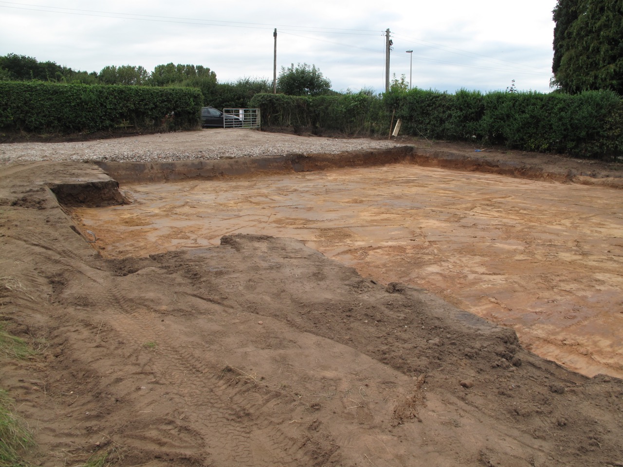

TerryE Posted September 5, 2016 Posted September 5, 2016 (edited) BTW, just had a quick scan of your blog and you typically don't use MOT 1 for a passive slab, but MOT 3 or crushed gravel over a fabric membrane. This because you want the stone bed to be free draining. However the crew do prefer to use MOT 1 for the last stone layer as this makes it easier for them to lay the blinding sand layer. The general area around the slab will get churned up from the stone delivery and laying, and once the crew have laid the blinding sand layer you've got a featureless "bowling green" at least 1m wider on all sides than the former footprint. They aren't going to want to wait around for half a day for some surveyor to turn up, so you need to be able to quickly and accurately mark out the slab corners. So for this reason it is well worth you or your surveyor setting out some reference datum makers outside the dig area so you can triangulate or sight-line the former corners. Edited September 5, 2016 by TerryE
worldwidewebs Posted September 5, 2016 Author Posted September 5, 2016 @TerryE The type 1 was specified by MBC's engineer, although it will only be about 250mm thick. Below that is sand We've had the dig area only marked up at the moment, but once the type 1 has been done and the groundworks guys go I'll get the surveyor to come back and mark the precise position of the slab - I'm guessing they'll use profile boards. It's all planned and in hand (famous last words)

TerryE Posted September 6, 2016 Posted September 6, 2016 (edited) OK, if your underlying base is sand then MOT 1 makes sense. Unless MBC have changed their approach from every other slab that I know of, the same crew will do the ground works, EPS formwork, rebar and pour in one continuous operation over about 6-7 days. There isn't a nice break to invite your surveyor back. Have a chat with your MBC project manager. Edited September 6, 2016 by TerryE

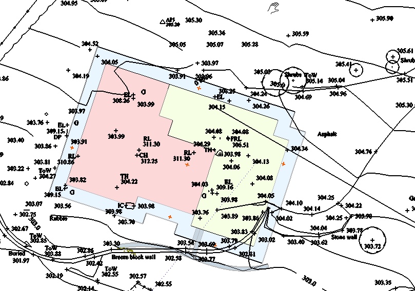

Barney12 Posted September 6, 2016 Posted September 6, 2016 (edited) We have an interesting challenge with this subject as our house design is split over two levels. with 600mm difference in the two. Despite asking I still have no idea how the passive slab will be formed. I guess their structural engineers will decide! I'm just hoping we don't end up with the need for strip foundations and dwarf walls as well as the slab. Add to this we also need to create a retaining wall as the plot is on a slope. Here's a rough layout: Blue (1m perimeter) Green: level 1 Red: level 2 (600mm lower) Edited September 6, 2016 by Barney12
TerryE Posted September 6, 2016 Posted September 6, 2016 @Barney12, we had a ~450mm gradient over our slab footprint but have gone for a single FFL throughout. The main driver here was keeping the ridgeline down. The rear garden will be terraced, no lawn just paved areas and deep bed planters. The lawn is on the level area out front. I personally feel that having a split level GFL is a PITA and extremely wheelchair unfriendly.

worldwidewebs Posted September 6, 2016 Author Posted September 6, 2016 10 hours ago, TerryE said: OK, if your underlying base is sand then MOT 1 makes sense. Unless MBC have changed their approach from every other slab that I know of, the same crew will do the ground works, EPS formwork, rebar and pour in one continuous operation over about 6-7 days. There isn't a nice break to invite your surveyor back. Have a chat with your MBC project manager. The groundworks (site strip, level, dig, MOT1 etc) is all done in advance of MBC turning up - MBC will just lay the blinding layer and then the EPS (then rebar, UFH etc etc)
worldwidewebs Posted September 6, 2016 Author Posted September 6, 2016 7 hours ago, TerryE said: Even so my original comment applies: the MBC team will create a pad that is 1-1½m wider than the house footprint so any corner markers will get wiped out. All www or his surveyer need to do is to bang in 4 rebar spikes well ouside this area to give two taught lines: one for the front and one for a side wall. This will fix the slab precisely so the MBC crew will do the rest. I'm doing a bit more than that actually. Once the groundworks guys have left, we will have MOT1 laid over an area 1m beyond the house footprint. The surveyor will then come back and mark up exactly where each of the corners of the slab will be. They have already marked levels on site, from which the dig and MOT1 are measured
