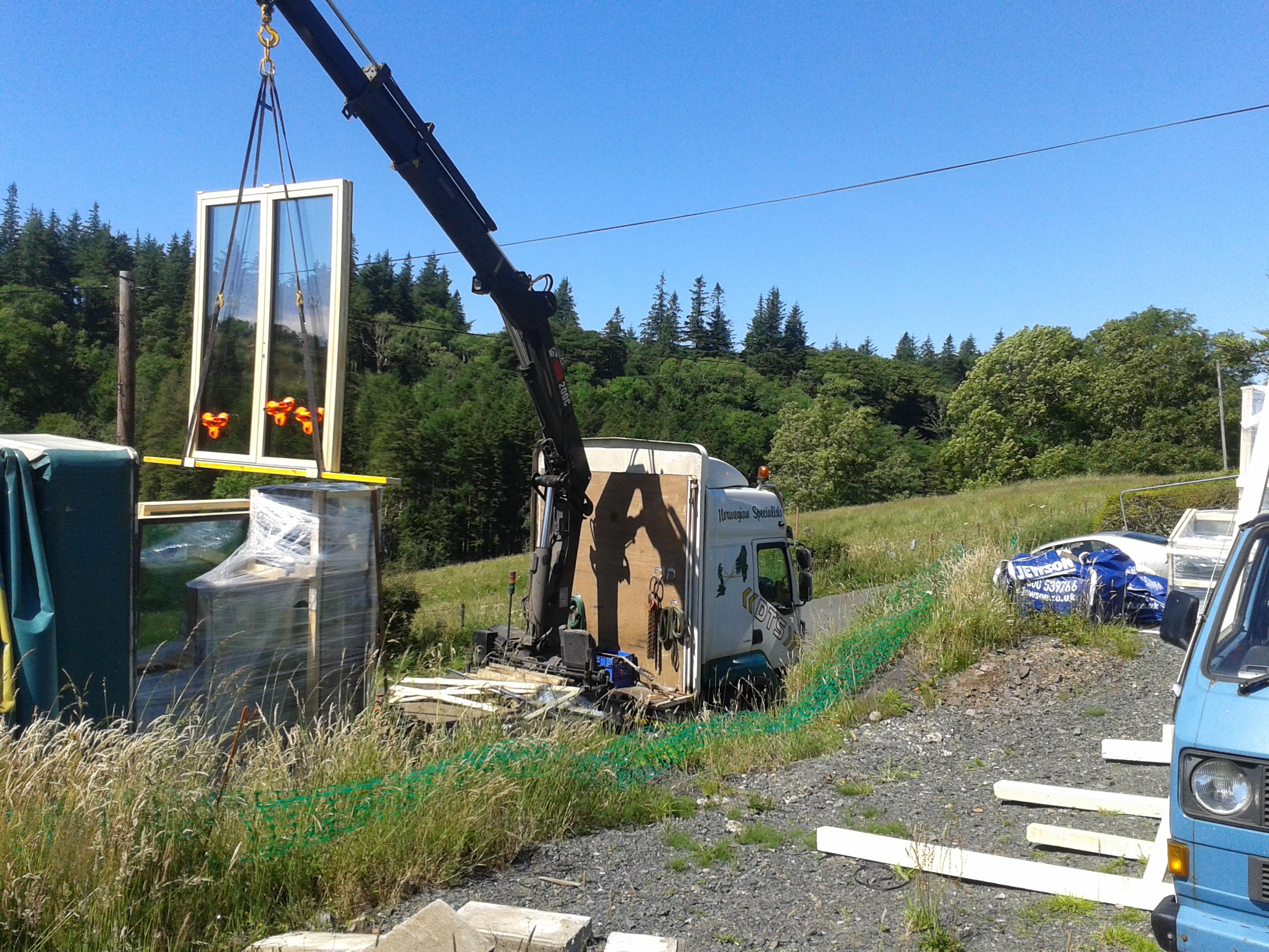

jamiehamy Posted September 3, 2016 Share Posted September 3, 2016 (edited) Have you considered a mini crawler crane? We looked at these for our floor beams and also the windows. It might help hugely de-risk the move too? The price we were quoted for a week was £1500, with £2000 for the operation (including their stay). So if you only need it for a day or so, could be possible? The transport up to Scotland was silly money tho. Also worth considering how you actually get it into position - one reason we couldn't use a crane for the windows was the roof overhang - we'd have gotten the windows up, but not in, our overhang on one elevation is 500mm+. Oh, and will the crane lift it straight off the truck? You're definitely right to get the insurance checked out - as our recent experience shows, things DO happen. And be crystal clear who is responsible for what activity. Also checking how the unit will be supported - after our disaster when the units fell over on the truck, we had to take them out one at a time with HIAB - and it was only because I insisted we put a timber runner under the frame (low threshold) that it wasn't seriously warped. The operators wasn't too clued up on window lifting. http://www.maedaminicranes.co.uk/application/pdf/lc383.pdf Edited September 3, 2016 by jamiehamy Adding pic Link to comment Share on other sites More sharing options...
oranjeboom Posted September 4, 2016 Author Share Posted September 4, 2016 Thanks Jamie. Windows were imported from EU and were precariously unloaded a few weeks ago with a forklift and a sideloader, so hoisting them over with a Hiab on arrival is not an option. Would not have been possible anyway as the weight is too much/reach required is too far (25m). Think you lose circa 1t for every horizontal metre so the working radius is simply too far for most smaller cranes including spiders/hiabs. I'll just have to bite the bullet and go for a 40t crane. Good point about the runners under the windows. My 800kg doors have re-inforced steel in the frame so hoping the warping is minimised. If we place runner underneath, then we won't be able to get it out as the door will have to be placed into the opening straight away and I cant see how we will lift that to remove the runner The insurance I will have to look into for sure. Don't want any mishaps with plant, property or people! Link to comment Share on other sites More sharing options...

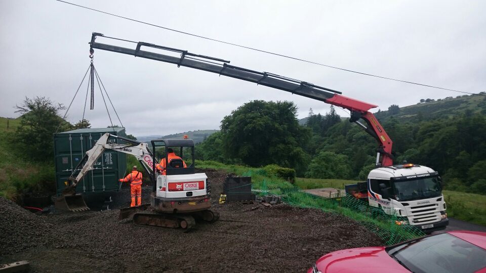

jamiehamy Posted September 4, 2016 Share Posted September 4, 2016 (edited) 11 hours ago, oranjeboom said: Windows were imported from EU and were precariously unloaded a few weeks ago with a forklift and a sideloader, so hoisting them over with a Hiab on arrival is not an option. Would not have been possible anyway as the weight is too much/reach required is too far (25m). Think you lose circa 1t for every horizontal metre so the working radius is simply too far for most smaller cranes including spiders/hiabs. I'll just have to bite the bullet and go for a 40t crane. I was thinking for a small crawler crane to actually lift it round the side, if you have enough clearance/access? There are some different specs, but that's what some are meant for and they are fairly narrow - would have a far less complex operation and 800kg should be no problem. The window would always be within a metre of the ground. But yes, just too far for HIAB - This one would do 790kg to 21m but would probably not clear the house http://www.3bcranehire.co.uk/cranehire/wp-content/uploads/2016/05/Plant-Hiab-XS-288-Lift-Capacities.pdf I got a HIAB to lift our phone box(750kg) 15m - you should see the bend in the boom! If I can find a pic I'll upload. (can't find phone box pic but the container weights quite a bit more) Edited September 4, 2016 by jamiehamy added pic Link to comment Share on other sites More sharing options...

oranjeboom Posted September 5, 2016 Author Share Posted September 5, 2016 11 hours ago, jamiehamy said: Whatever you do - don't watch any videos on the matter https://www.rt.com/news/311458-crane-collapse-hollande-house/ Too late!!!!! 11 hours ago, jamiehamy said: (can't find phone box pic but the container weights quite a bit more) I was thinking that was a big/secure phone phone box!!! The problem I have is that the rig will most likely hit the gable roof if the crane is down the side of the house. There's a field next door, but that will be too cumbersome (farmer's permission, trees, matting required) and I reckon with all the extra gear required will probably cost more. Link to comment Share on other sites More sharing options...
