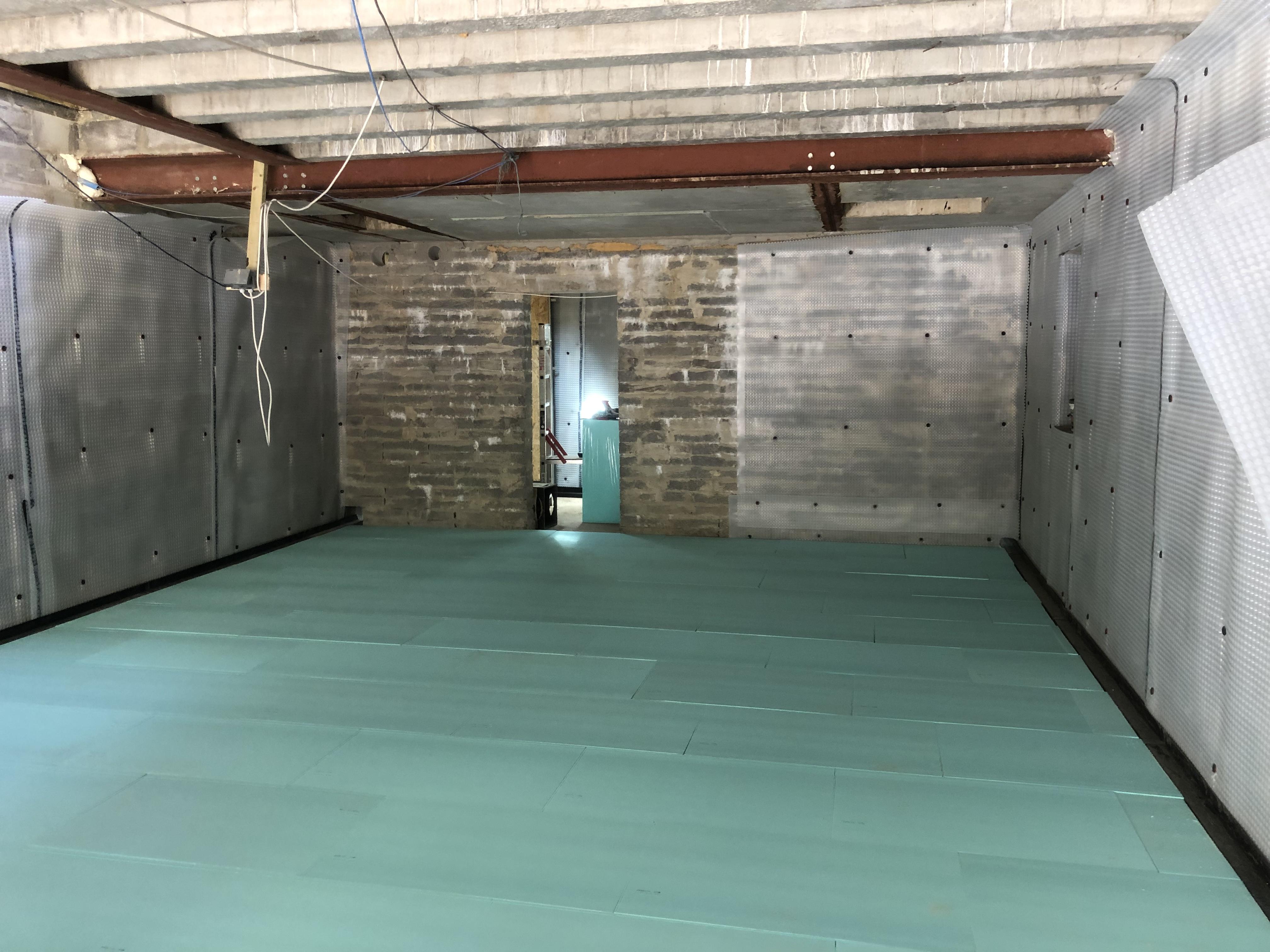

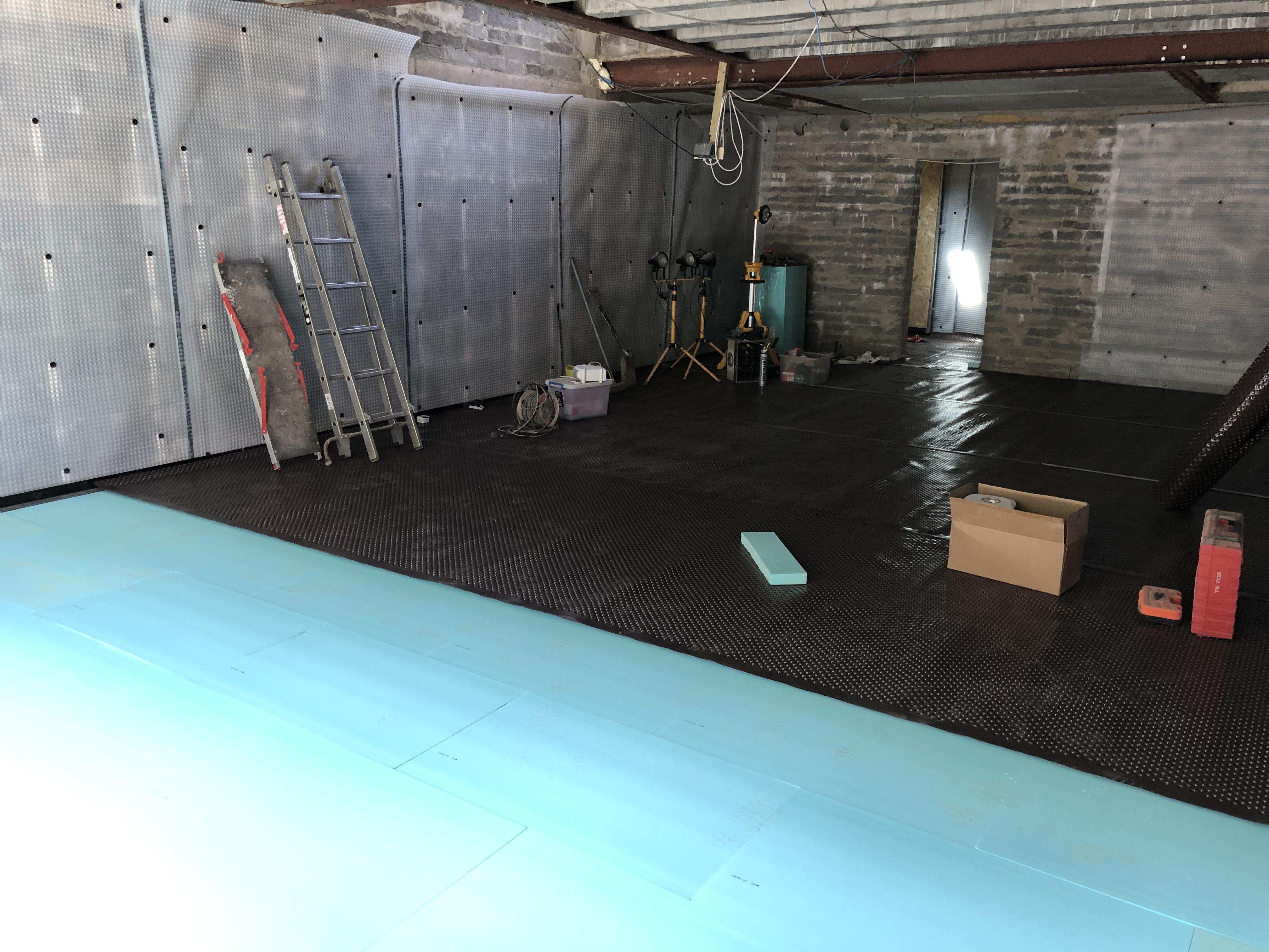

Pocster Posted May 13, 2019 Author Share Posted May 13, 2019 Heavy work this insulation Link to comment Share on other sites More sharing options...
Pocster Posted May 15, 2019 Author Share Posted May 15, 2019 On and on it goes ... 1 Link to comment Share on other sites More sharing options...

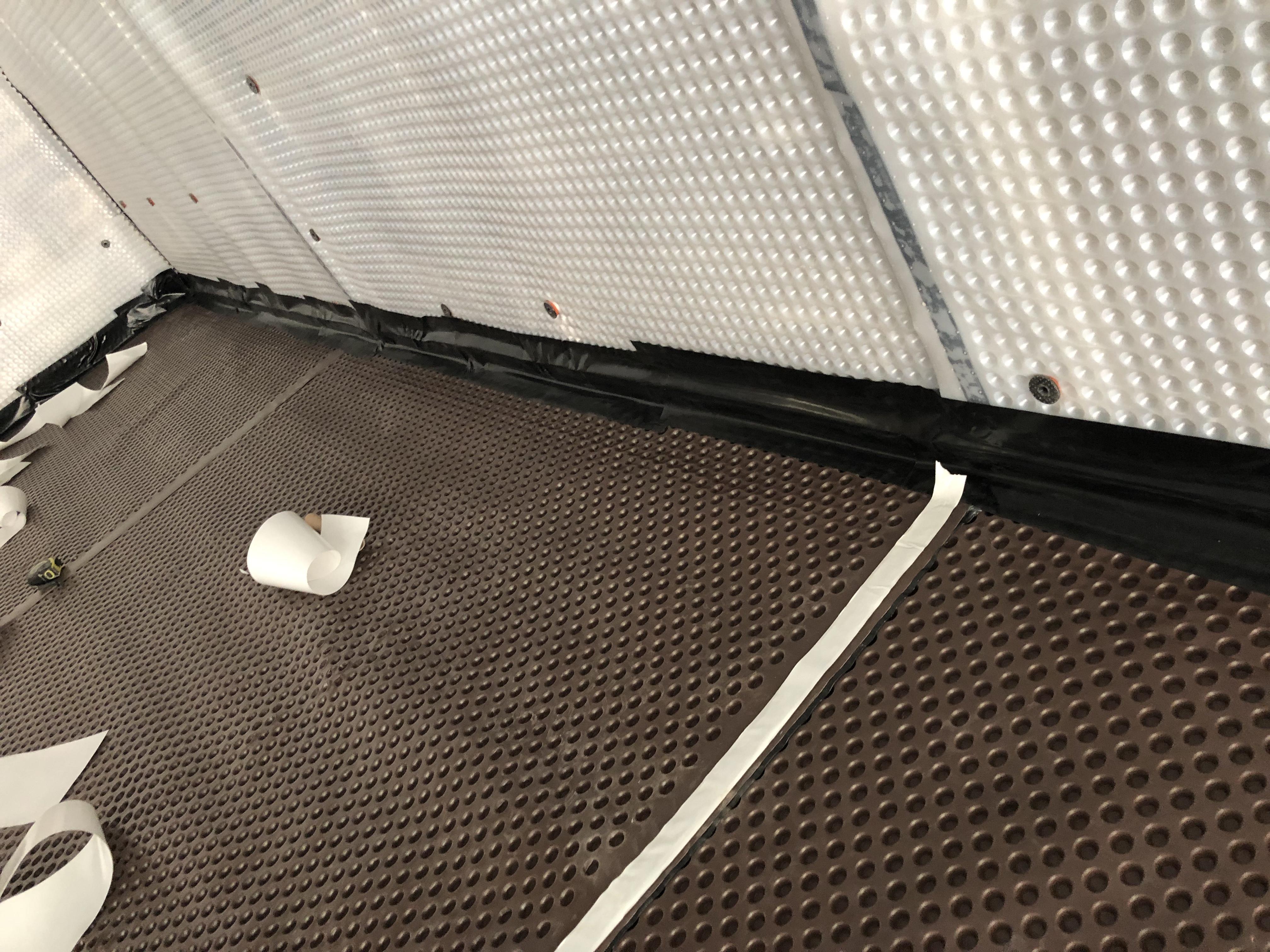

Pocster Posted May 16, 2019 Author Share Posted May 16, 2019 For a change started putting the ‘rubber tape’ type stuff around the edges . Wow is it sticky ! Stickier than @Onoff after a Friday night ! Link to comment Share on other sites More sharing options...
Onoff Posted May 16, 2019 Share Posted May 16, 2019 13 minutes ago, pocster said: For a change started putting the ‘rubber tape’ type stuff around the edges . Wow is it sticky ! Stickier than @Onoff after a Friday night ! Pot, kettle. 1 Link to comment Share on other sites More sharing options...
