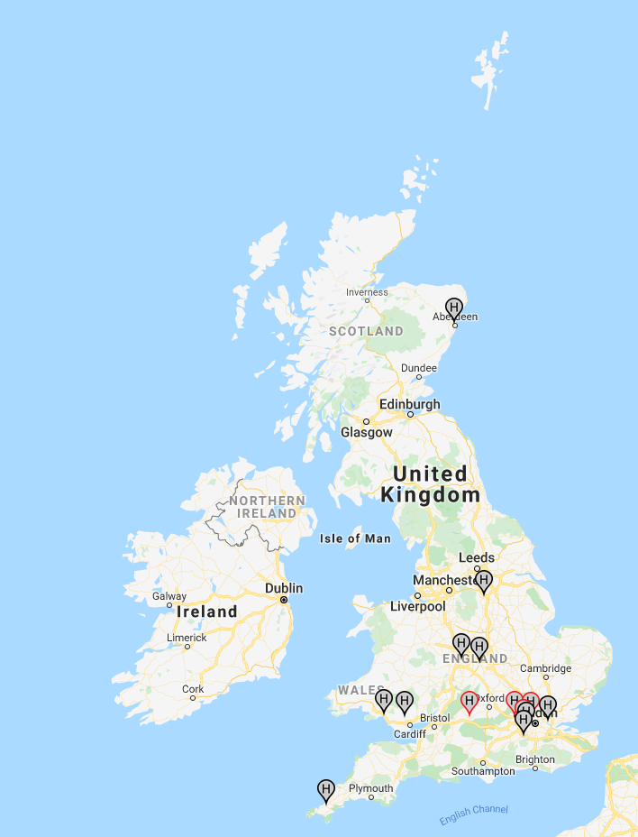

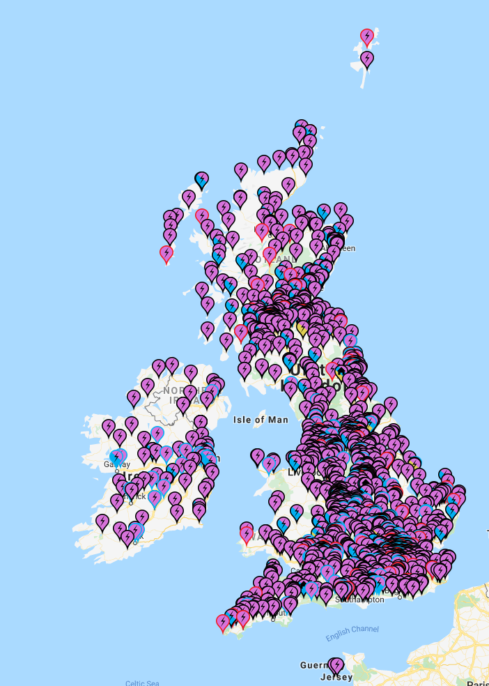

Jeremy Harris Posted December 31, 2019 Share Posted December 31, 2019 Just had a look at Zap Map and it's showing that there are currently 14 hydrogen filling stations across the UK: Just for comparison, this is a map showing just the rapid (50 kW or more DC) charge points across the UK (albeit filtered to only those that will fit my car - so this doesn't include all the Chademo chargers): Link to comment Share on other sites More sharing options...
SteamyTea Posted December 31, 2019 Share Posted December 31, 2019 1 hour ago, Markblox said: Didn't the UK's only Hydrogen filling station (at the time) explode this year Had a look, only found one in Norway. 51 minutes ago, Jeremy Harris said: 14 hydrogen filling stations across the UK One of which is in Redruth, which seems an odd place to put one. Though it has been described as the new Shoreditch (Redruth, not a gas pump). Link to comment Share on other sites More sharing options...
Markblox Posted January 1, 2020 Share Posted January 1, 2020 13 hours ago, SteamyTea said: Had a look, only found one in Norway. I could swear I read about an explosion in the UK, never mind, will just have to increase the medication! Happy new year. Link to comment Share on other sites More sharing options...
Markblox Posted January 1, 2020 Share Posted January 1, 2020 14 hours ago, Jeremy Harris said: Just had a look at Zap Map and it's showing that there are currently 14 hydrogen filling stations across the UK: Just for comparison, this is a map showing just the rapid (50 kW or more DC) charge points across the UK (albeit filtered to only those that will fit my car - so this doesn't include all the Chademo chargers): I think this explains it neatly, It is pointless even considering what system of energising electric cars is best because this is a Betamax/VHS situation and that means for cars at least, BEV's win. Link to comment Share on other sites More sharing options...
