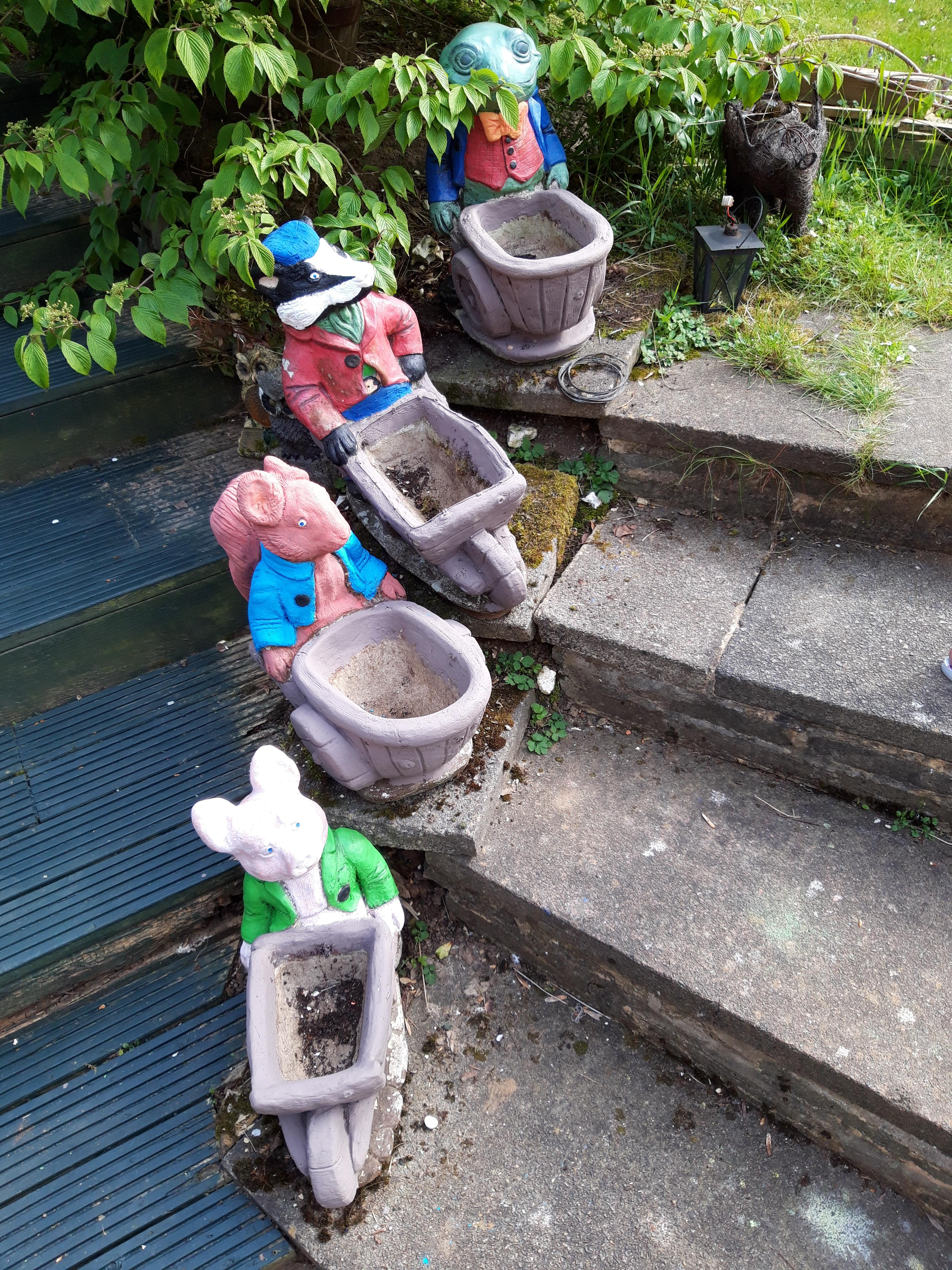

Onoff Posted April 22, 2019 Posted April 22, 2019 The Whelan's ornaments getting a bit of a tart up today. Had these circa 20 years: Emulsion match pots with yacht varnish over the top. Keeps the kids amused for a good while.
