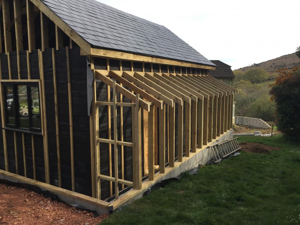

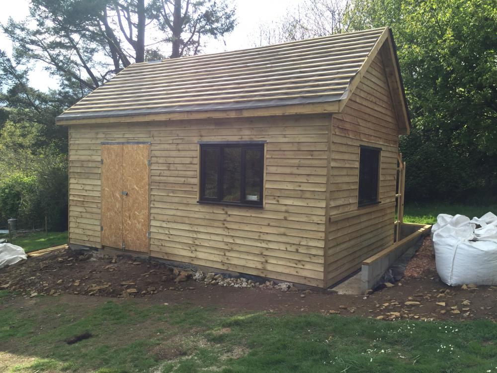

Barney12 Posted May 22, 2016 Share Posted May 22, 2016 Well in an attempt to bring my workshop thread back to life from the other forum I'll thought I post an update. Cladding now well underway. As is the rear lean-too extension (I'm never really sure why I didn't want a completely oblong workshop) Rear section of roof is now tiled. Front ready for the 6 panel solar array. Thats been delayed by classic indecision over supplier on my part! 2 Link to comment Share on other sites More sharing options...
Crofter Posted May 22, 2016 Share Posted May 22, 2016 Looks good! Is the PV for the shed itself or is it on FiT connected through your house? Link to comment Share on other sites More sharing options...
Onoff Posted May 22, 2016 Share Posted May 22, 2016 Proper job! Might be picking your brains when I do something similar. What's the rear extension for, looks too narrow for anything.....grow room? Link to comment Share on other sites More sharing options...
Barney12 Posted May 22, 2016 Author Share Posted May 22, 2016 19 minutes ago, Crofter said: Looks good! Is the PV for the shed itself or is it on FiT connected through your house? It will feed into the main house supply but no intentions of having it FiT registered. Link to comment Share on other sites More sharing options...
Barney12 Posted May 22, 2016 Author Share Posted May 22, 2016 15 minutes ago, Onoff said: Proper job! Might be picking your brains when I do something similar. What's the rear extension for, looks too narrow for anything.....grow room? It was a bit of an afterthought to make use of some space. It's wide enough for shelves and me. To the right of the door into the lean-too will be the dust extraction and air compressor (both noisy). To the right will be a 4m run of shelves for storing "stuff"! 1 Link to comment Share on other sites More sharing options...

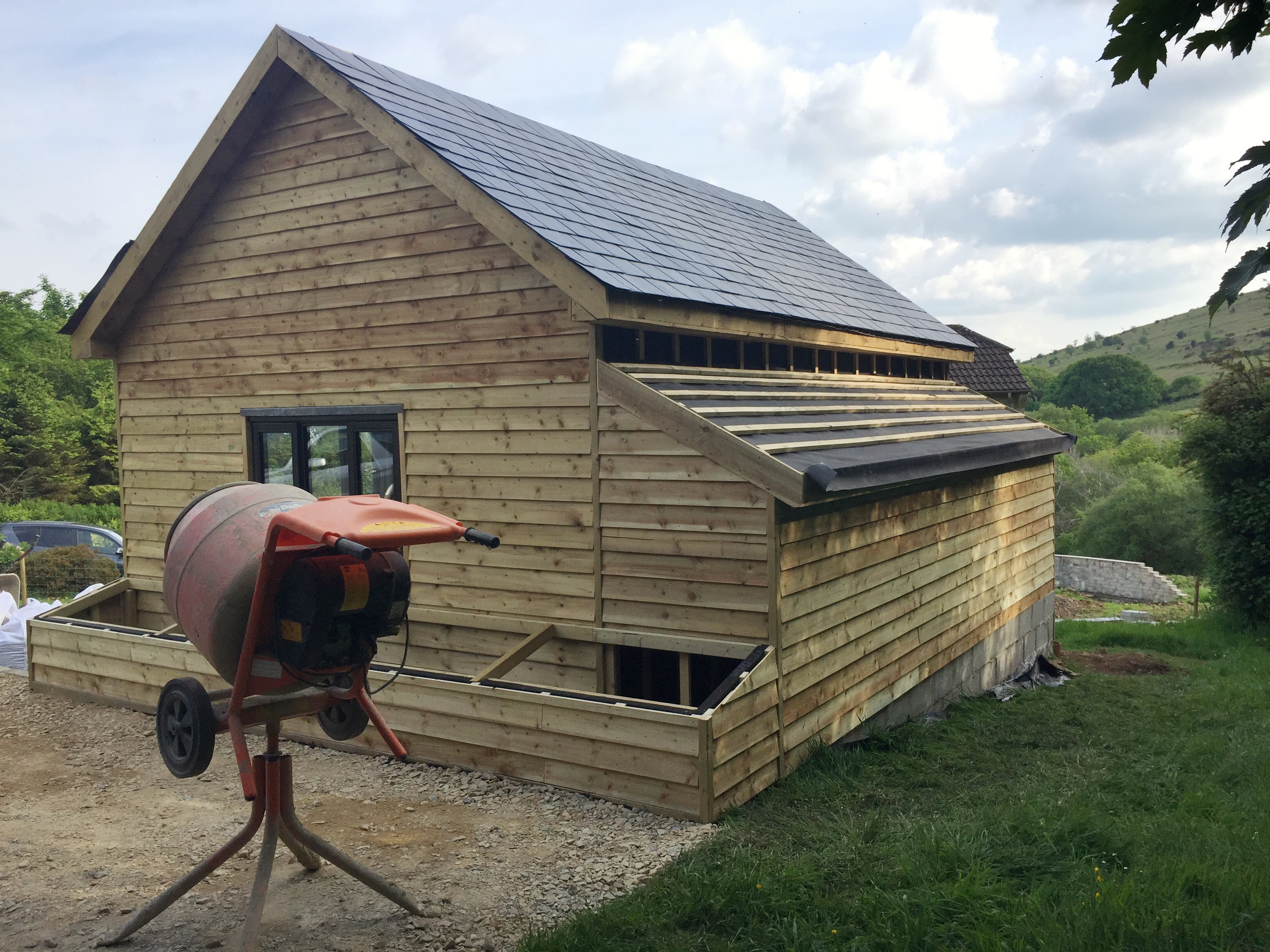

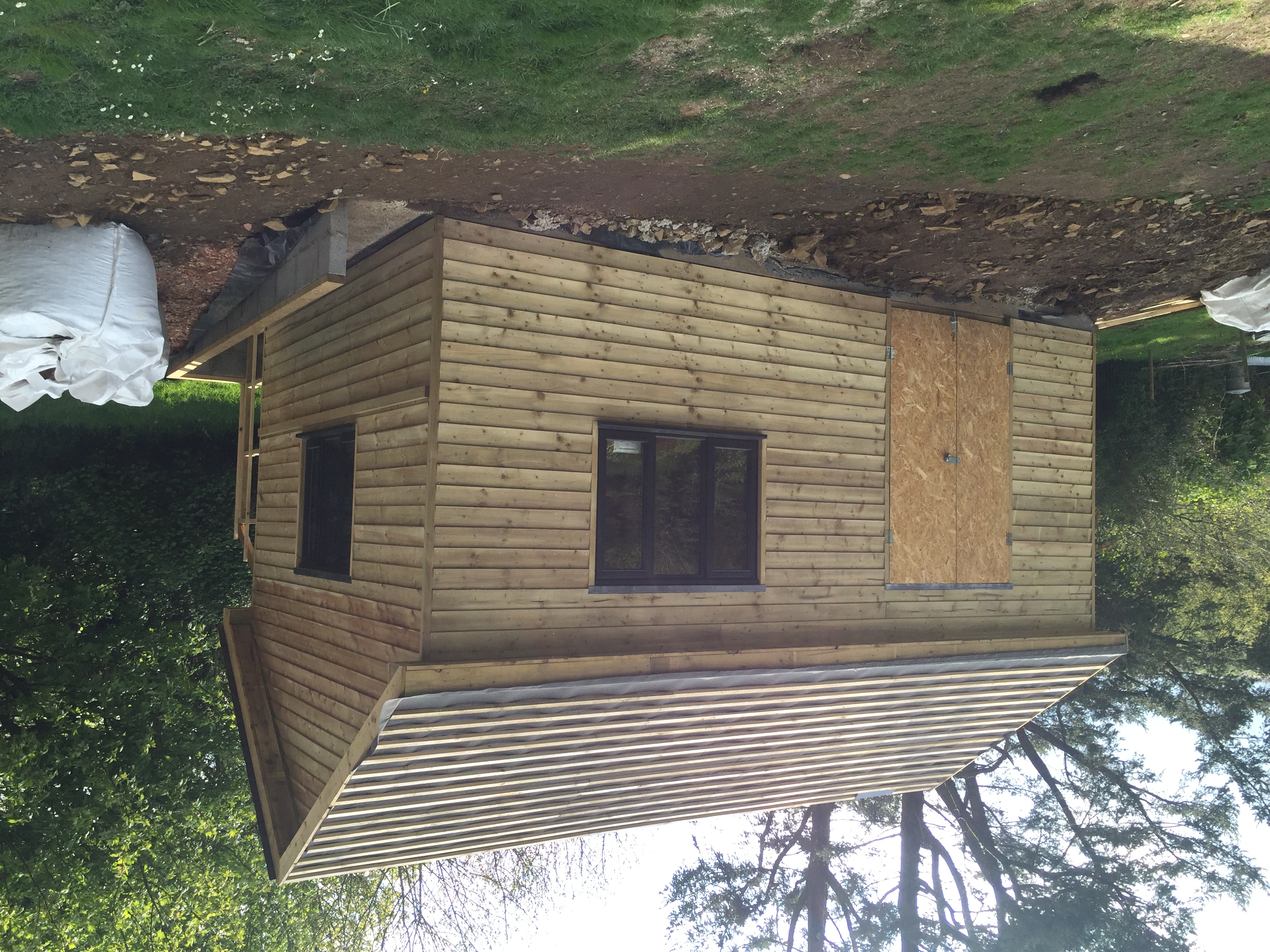

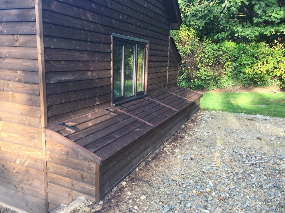

Barney12 Posted May 31, 2016 Author Share Posted May 31, 2016 We have a few different species up here. The biggest roosting in our property is a Serotine. 300-400mm wingspan and a face like a bulldog chewing a wasp The little pips are quite cute though. Hang on what am I saying, they're not cute they're delaying my build thus I must despise them! Crikey I'm going soft! Anyway another productive weekend building their new home. Rear lean too and side cloche style storage now finished and clad. still so much to do though but it's keeping me busy whilst the ecologists finds reasons to invoice Link to comment Share on other sites More sharing options...

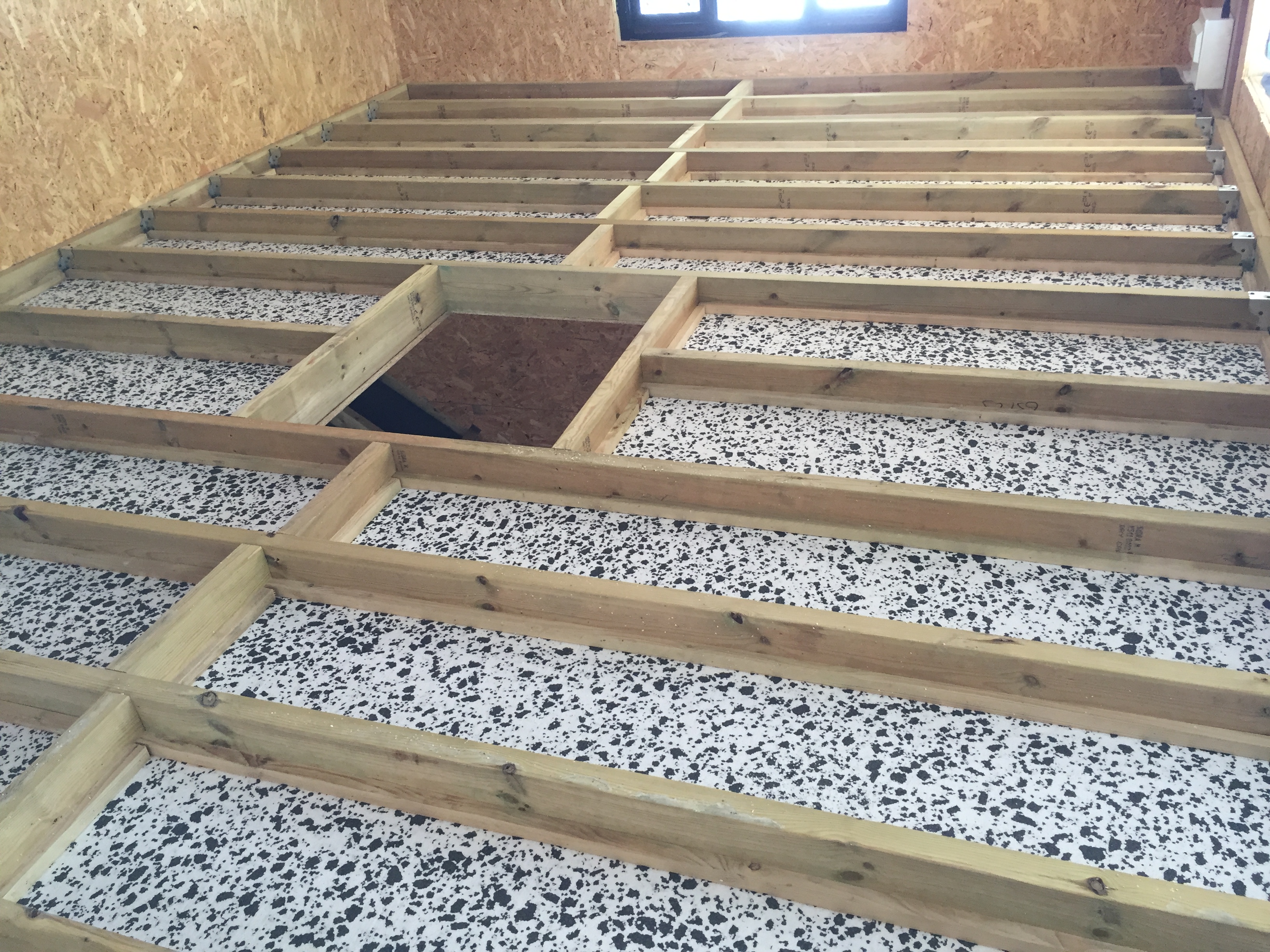

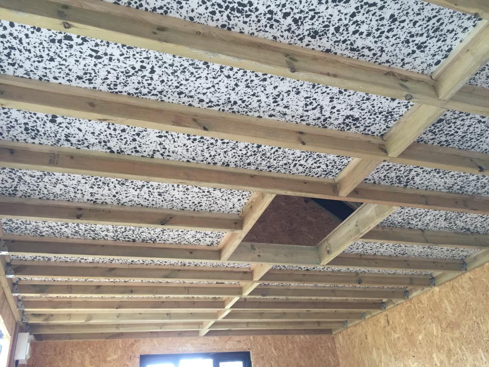

Barney12 Posted May 31, 2016 Author Share Posted May 31, 2016 Here is the ceiling. I deliberated for ages about whether to make it temporary so it could come down in the future but in the end decided to make it permanent. 6x2's with 18mm OSB. Then 50mm of jablite between the joists. There is 1.8m of height in the loft area which was what was specified by the ecologists. Whatever they might say it's going to get filled with 'stuff' at some point. Hence the nice big loft hatch. :D. Link to comment Share on other sites More sharing options...

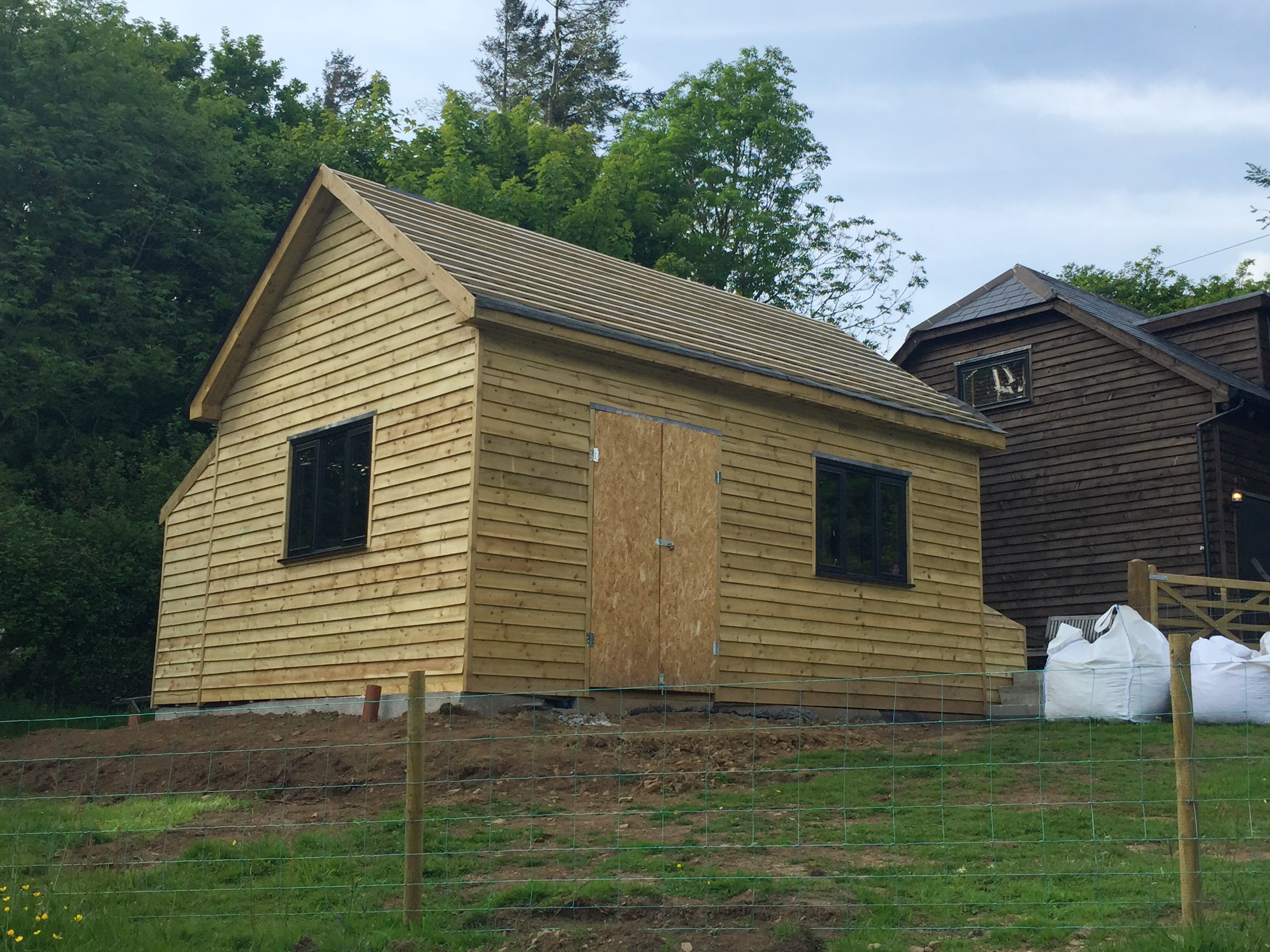

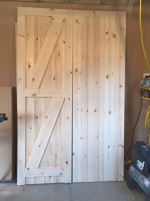

Barney12 Posted June 21, 2016 Author Share Posted June 21, 2016 As Natural England rejected our application to re-home the bats today I thought I'd update this thread by swearing and throwing a tantrum Oh alright then. How about a picture of the doors that I made at the weekend. Two sets (sorry only one set photographed), one set for the workshop and one for the store. Of course they're massively over engineered (when will I ever learn!). I didn't want flimsy tongue and groove boarding so instead machined up my own boards using 25mm stock and then bonded them together with a large number of biscuits! All the frames are loose tenon jointed. Everything glued, pinned and screwed for good measure. Seems a shame to paint them black but that's what the planners demand. All I need to do now is re-enforce the door frames to take the weight :D. 3 Link to comment Share on other sites More sharing options...

Crofter Posted June 21, 2016 Share Posted June 21, 2016 Look very smart! The only time I ever built a pair of doors they warped like b*ggery and only closed properly if you bolted them top and bottom. It put me off doing it again! Link to comment Share on other sites More sharing options...
Onoff Posted June 21, 2016 Share Posted June 21, 2016 "Brace" yourself..... What, no double angle on the ends? Link to comment Share on other sites More sharing options...
Barney12 Posted June 22, 2016 Author Share Posted June 22, 2016 8 hours ago, Onoff said: "Brace" yourself..... What, no double angle on the ends? Alas no, I ran out of timber as I used the last length to beat my ecologist and the jumped up kn*b head from Natural England into a pulp. 4 Link to comment Share on other sites More sharing options...
