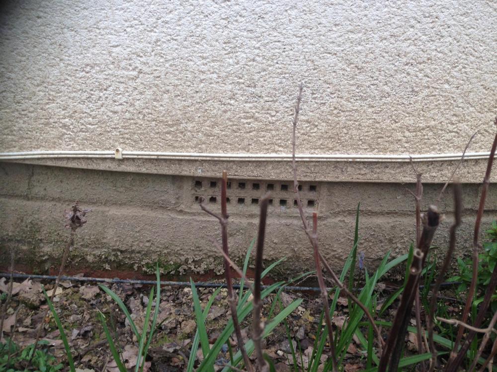

Bri44 Posted April 12, 2019 Author Posted April 12, 2019 In the front, they are saying they will dig a trench and backfill with free draining gravel. I`m asking them where the water will drain to as I`ve dug the trench as deep as it goes before hitting hardcore. They have not answered despite me asking several times.

Bri44 Posted April 13, 2019 Author Posted April 13, 2019 Thanks guys. Any particular type of conpany I should be contacting? I'm near Portsmouth. once the decking is eventually sorted they have to start on the render repairs. Cracks and staining everywhere. At first they said they would only repair the cracks and paint over these areas leaving the house all streaky. I had to dispute this, I contacted Weber and sent the developer Webers technical manual on how repairs should be carried out. My house takes ages to heat up, goes old real quick, I have trickle vents on windows, even when closed I can hear every little noise outside. Main road 800 metres away sounds like it's outside my house. Probably bad insulation etc. As as for the tiles, 4 are cracked, 2 at each side of two door frames as though under stress from frame or floors moved up. it has been and still is a struggle. they lied to LABC saying I got a discount to buy the house sold as seen with faults, I have the emails from LABC saying this, my solicitor(their recommended one) said in an email this is not true. Ill get quotes and then then it may have to be a legal route.

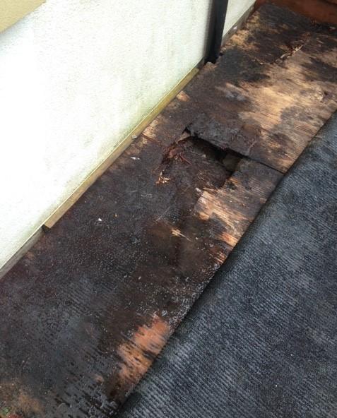

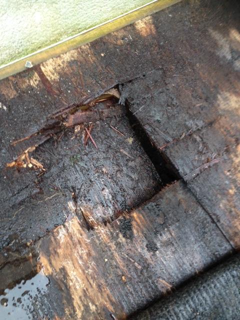

Bri44 Posted April 13, 2019 Author Posted April 13, 2019 (edited) 42 minutes ago, newhome said: I looked at the LABC warranty. It’s clear who is responsible initially but LABC ‘may’ be able to help through conciliation which means nothing TBH. It also notes that it is restricted to issues in their technical manual. It says elsewhere that things like central heating, appliances aren’t included but these look more structural so surely would be. Problems within the Defects Period During this period the developer is responsible for rectifying any defects (which are deemed to be a failure to comply with our Technical Manual). You must report any faults to the developer in writing as soon as possible, making sure you keep a copy of this correspondence. If you have reported these issues to your developer within the Defects Period and either: a) They have failed to rectify them within a reasonable time period, or; b) They are unable to rectify them due to their insolvency Then we may be able to help through our conciliation service. Please note that we will only be able to assist with issues governed by our Technical Manual. LABC Warranty I had to get LABC involved and then open 2 disputes with the dispute resolution service. One to have the roof repaired again, the 2nd for the DPC levels. LABC. The developer said, water pooling on the roof because the roof was lower than the exit point for the drainpipe was not a build defect and met the building spec etc. LABC said it was a fault. What is reasonable time? The developer is dragging it out, making excuses, then trying to say its my fault for not allowing the work to start. LABC report was sent to them FEB 2018, It is only the past few months they have been asking their contractors to quote. The DRS/LABC have now said they are unable to assist on how the developer sorts the deck as its not a structural part of the house, even though it has been fixed to the house and causing damp. They say, they can only tell the developer to do remedial works that will stop the damp, however, rain will still splash against the render if it is cut back by 150mm and left 40mm above dpc. LABC said this in their report which I have now said, if they are unable to tell the developer how to fix, then they should not make a suggestion. Item No 2 - ‘Ground level at or around DPC level’ Our Observations: The external ground level on all three elevations is at or close to damp proof course (DPC) level i.e. less than 150mm below DPC. See photographs 6, 7, 8 and 9. Conclusions and Recommendations: All paving and drives with the exception of the principle level access into the dwelling should be laid at least 150mm below the damp proof course of the dwelling. A simple ground work solution to resolve the problem could be to; 1. Cut back the various external ground finishes at least 150mm back from the face of the external elevations. 2. Excavate the 150mm wide trench to a depth of 300mm from the level of the DPC. 3. Form the edges of the trench. 4. Back fill the 300mm deep trench with 150mm free draining gravel. 5. Level the upper 150mm of the trench clear to maintain the 150mm clearance of the DPC. Quote Edited April 13, 2019 by Bri44
newhome Posted April 13, 2019 Posted April 13, 2019 To be honest you may need to get a surveyor in to do a full assessment. At least then you have something concrete to put to the builder / warranty provider, and it would count as an expert opinion, not just quotes from builders that however good they are could be argued as just their opinion. There is a post here where someone did that https://forum.buildhub.org.uk/topic/9265-new-build-quality/?do=findComment&comment=157804 Hopefully you have been doing already, but put every contact with the builder in writing. If you have a conversation with them follow it up with an email to confirm the conversation. On the insulation front, when I bought my previous house from a large developer it had no insulation in it at all, despite the fact that we were handed a guarantee for the insulation. It appears that they had ‘missed’ installing any insulation for a whole group of houses. You could ask a surveyor to assess that aspect too as a new build these days should be pretty well insulated if it conforms to building regs. Tell the builder and LABC that this is the route you will now go down and will take them to court to fix the defects plus you will expose the house builder for their poor quality, and LABC for signing off houses that are sub standard.
newhome Posted April 13, 2019 Posted April 13, 2019 4 minutes ago, Bri44 said: Conclusions and Recommendations: I kind of accept that LABC may not be responsible for the deck although they will be responsible for the issues with the damp so this is what I suspect their report is based on. The developer however sold you the house with the deck so they are indeed responsible for it and should therefore be responsible for rectifying the issues it causes to the property AND providing a deck that is fit for purpose IMO.

Bri44 Posted April 13, 2019 Author Posted April 13, 2019 So I have asked the developer at least 10 times to explain what this means via a detailed schedule of works which they have not provided. All they send is this saying as per LABC recommendation. I`ve asked where the water will drain to as there are no drains there, I get, it is free draining gravel. It is like talking to a Potatoe. A simple ground work solution to resolve the problem could be to; 1. Cut back the various external ground finishes at least 150mm back from the face of the external elevations. 2. Excavate the 150mm wide trench to a depth of 300mm from the level of the DPC. 3. Form the edges of the trench. 4. Back fill the 300mm deep trench with 150mm free draining gravel. 5. Level the upper 150mm of the trench clear to maintain the 150mm clearance of the DPC.
Bri44 Posted April 13, 2019 Author Posted April 13, 2019 2 minutes ago, newhome said: Think my post above this covers this? LABC are saying they are only responsible for the issues with the house thus their recommendation only relates to addressing that aspect. The developer however IS responsible for providing you with everything they sold you being fit for purpose including the deck. I agree, but they will try the old Sold as seen on me, just like saying me reporting my foot going through is out of the 2 year warranty, it is just excuse and lies from them. They just simply want to cut it back by 150mm but have not said what they will do with the spars attached to house etc.
