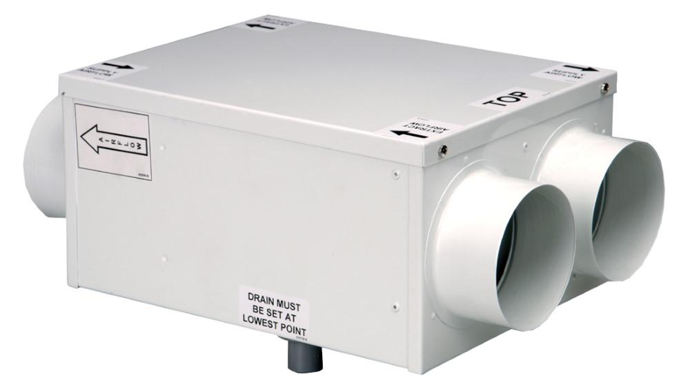

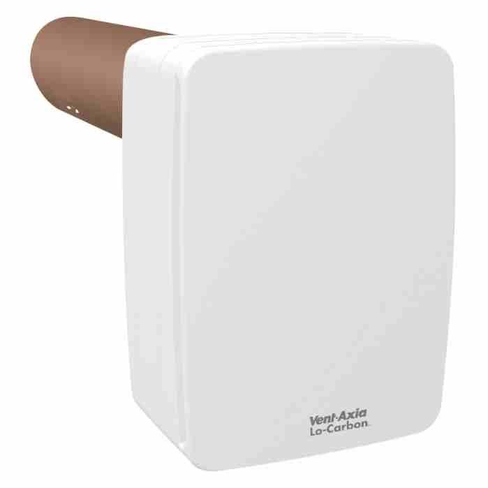

The original plan was to use a wall mounted, single room Ventaxia but tbh I think they are bloody ugly!
It was @Ferdinand's recent thread that put me onto one of these:
I can mount this up in the loft which is pretty much a blank canvas. But where to put the vents as in there are 4. There's two go outside as I understand it and I guess they just have to be a certain distance apart. Planning those in the soffit.
But the two inside???
In the interests of keeping some symmetry I was thinking maybe one vent where the green Post-It is high up on the wall behind the rainfall head. It'd go through that tile into the void behind the mitred corner then up through the ceiling to the unit in the loft. I fancy the challenge!

Big question, the MVHR unit and pipes in the loft: The loft is cold and uninsulated. Do the unit and ducts need to be "lagged"?

It seems to be a really complicated way to deal with ventilation for a single bathroom. ?
An alternative .. if the problem is an ugly unit with the through the wall one ... is to just put it in a small cupboard with a louvred door, as I did with one of mine.
That will save you at least 4 pipes, and a half-octopus in the loft.
Or would that not fit in with the design? ?

I was referring to the first unit you display, which is a through-the-wall item ie one 100mm hole, and you think is plug-ugly. The first one I installed back in 2012 put into a backless cupboard carcase with a louvred wooden door and mounted slightly off the wall. and was therefore invisible.
That might be less trouble than a cephalopod in your loft.
But it would require an external wall, which may be scarce.

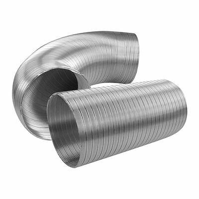

Glued together beer cans for the straight section then maybe some of this where it needs to pass through the branches. Needs the internal diameter to fit snug over a beer can:

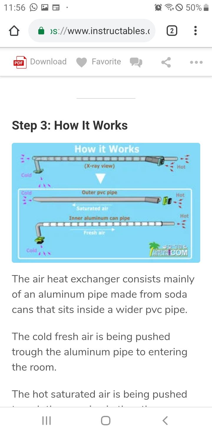

The reasoning behind this question then: Taking the screen grab below of a DIY tubular heat exchanger:
Assuming the "Hot in" is the extract from the (in this case) bathroom, then to still achieve 15L/s would the extract fan need to be more powerful than normal as the surface area of the extract duct is compromised by the heat exchanger tube up the middle?

Most axial bathroom fans are pathetic with a long run of pipe. you really need a centrifugal fan instead. Ceiling mounted ones tend to be bulky and ugly, so look for in line ones to go in the loft.
That beer can heat exchanger will just cause condensation and will be about 3% efficient if that.....
Just extract the moist air and let the cool air feed in from under the door.
Why such low efficiency?
Because you have a tube ... that’s it ..!! Surface area of two tubes, laminar flow, thickness of material etc etc. There is just not enough flow to surface to get anything like any transfer of heat.
Understood. What if the tube assembly is much longer or are there then other losses?
So.... to get the same surface area of a standard heat exchanger (40sqm) you would need a tube of around 210m long ........
I’d fit an ordinary extractor and move on ...

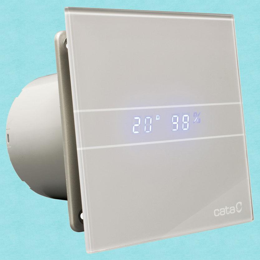

A sparks mate has just fitted one of these. Tbh he went for is based purely on aesthetics. Looks good too to my mind having blue LEDs. Yes, a bit gimicky but it ticks my boxes!
https://www.ebay.co.uk/itm/Cata-E100GSTH-Grey-Glass-Vent-Extraction-Fan-100mm-With-Humidistat-Timer/272246942762?epid=1138908186&hash=item3f632eac2a:g:~EQAAOSw9VZXPEwX
Height wise I'm going to have to have a measure in relation to the rainfall head.
