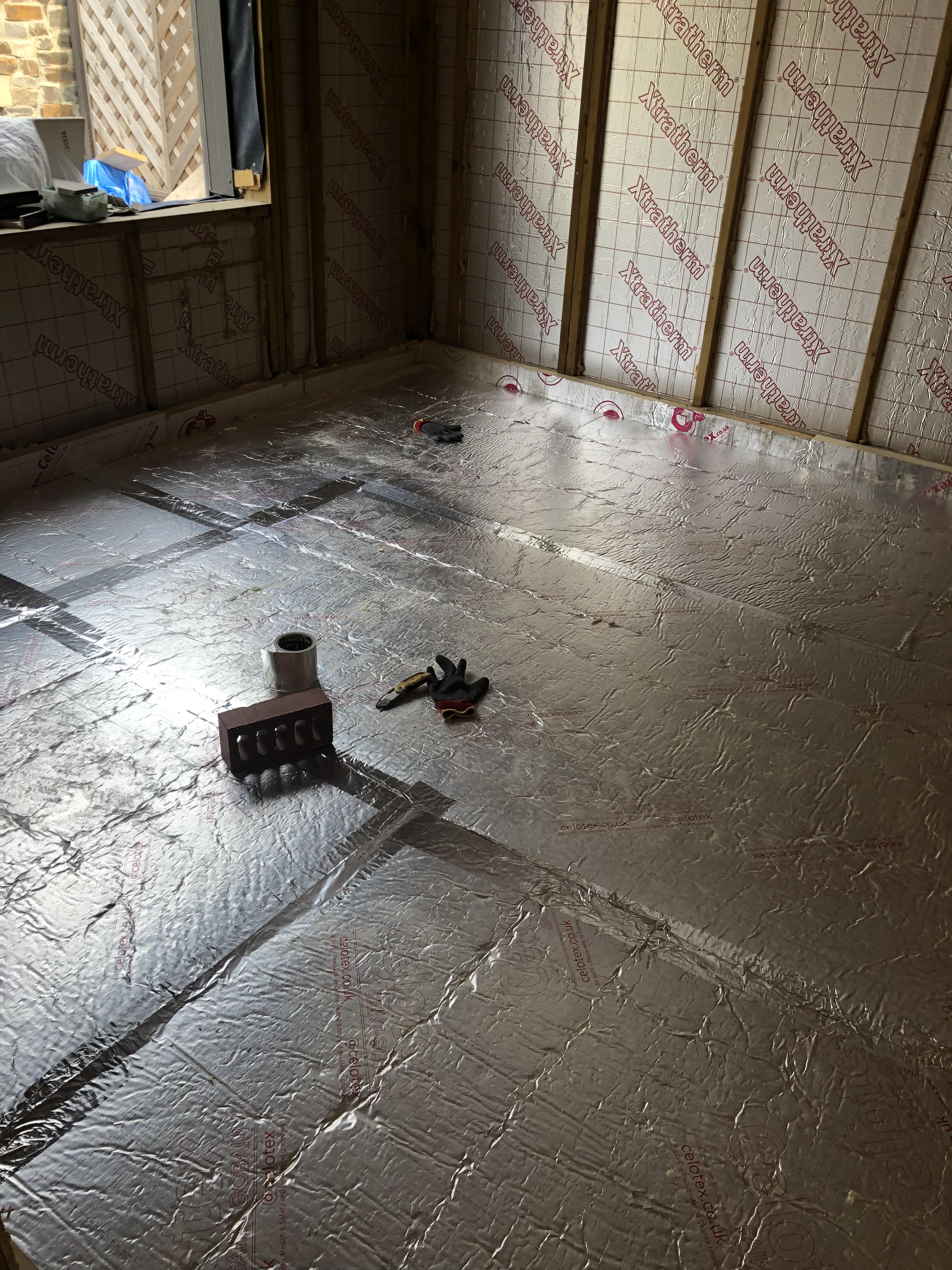

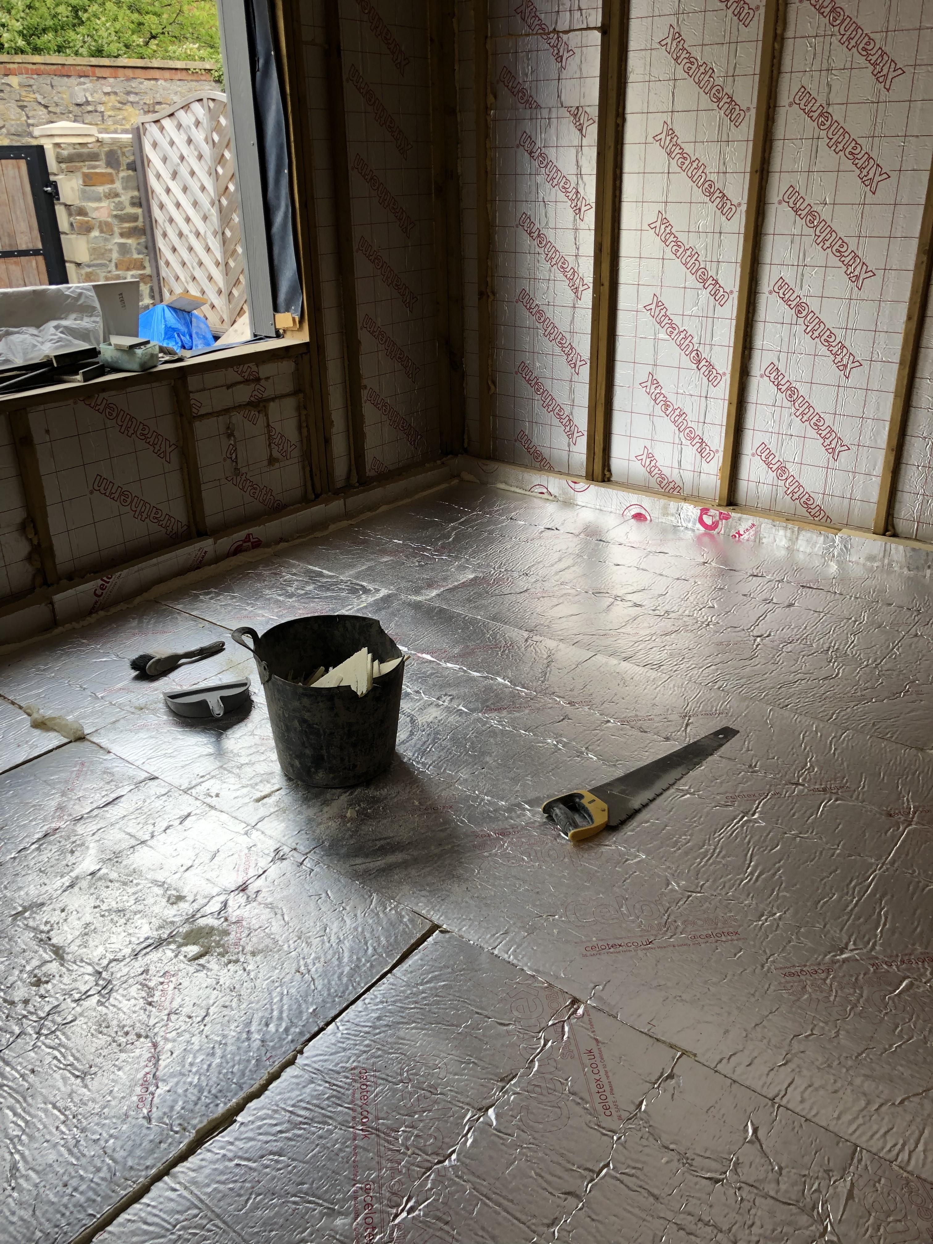

Pocster Posted April 16, 2019 Author Share Posted April 16, 2019 Just waiting for foam to go off ; then will cut excess followed by foil tape all joints . I don’t know ; feels like my build consists solely of pir with some cladding ? 1 Link to comment Share on other sites More sharing options...
Onoff Posted April 16, 2019 Share Posted April 16, 2019 Just make sure that your UFH pipes are very well secured so they don't lift / bend and end up poking through the top of the screed. 1 Link to comment Share on other sites More sharing options...
CC45 Posted April 16, 2019 Share Posted April 16, 2019 5 hours ago, pocster said: Just waiting for foam to go off ; then will cut excess followed by foil tape all joints . I don’t know ; feels like my build consists solely of pir with some cladding ? That picture brings back memories from 2 years ago.... looks like a neat job. Have you left enough of the dpm to tape your airtight membrane onto? As @Onoff says make sure you pin the ufh pipes down well, our screeders wanted extra to protect against the pipe lifting. Link to comment Share on other sites More sharing options...
Pocster Posted April 16, 2019 Author Share Posted April 16, 2019 31 minutes ago, CC45 said: That picture brings back memories from 2 years ago.... looks like a neat job. Have you left enough of the dpm to tape your airtight membrane onto? As @Onoff says make sure you pin the ufh pipes down well, our screeders wanted extra to protect against the pipe lifting. Lol No dpm ; just vapour barrier to go ontop Link to comment Share on other sites More sharing options...
Pocster Posted April 17, 2019 Author Share Posted April 17, 2019 Cut off excess foam - taped joints . Vapour barrier now Link to comment Share on other sites More sharing options...

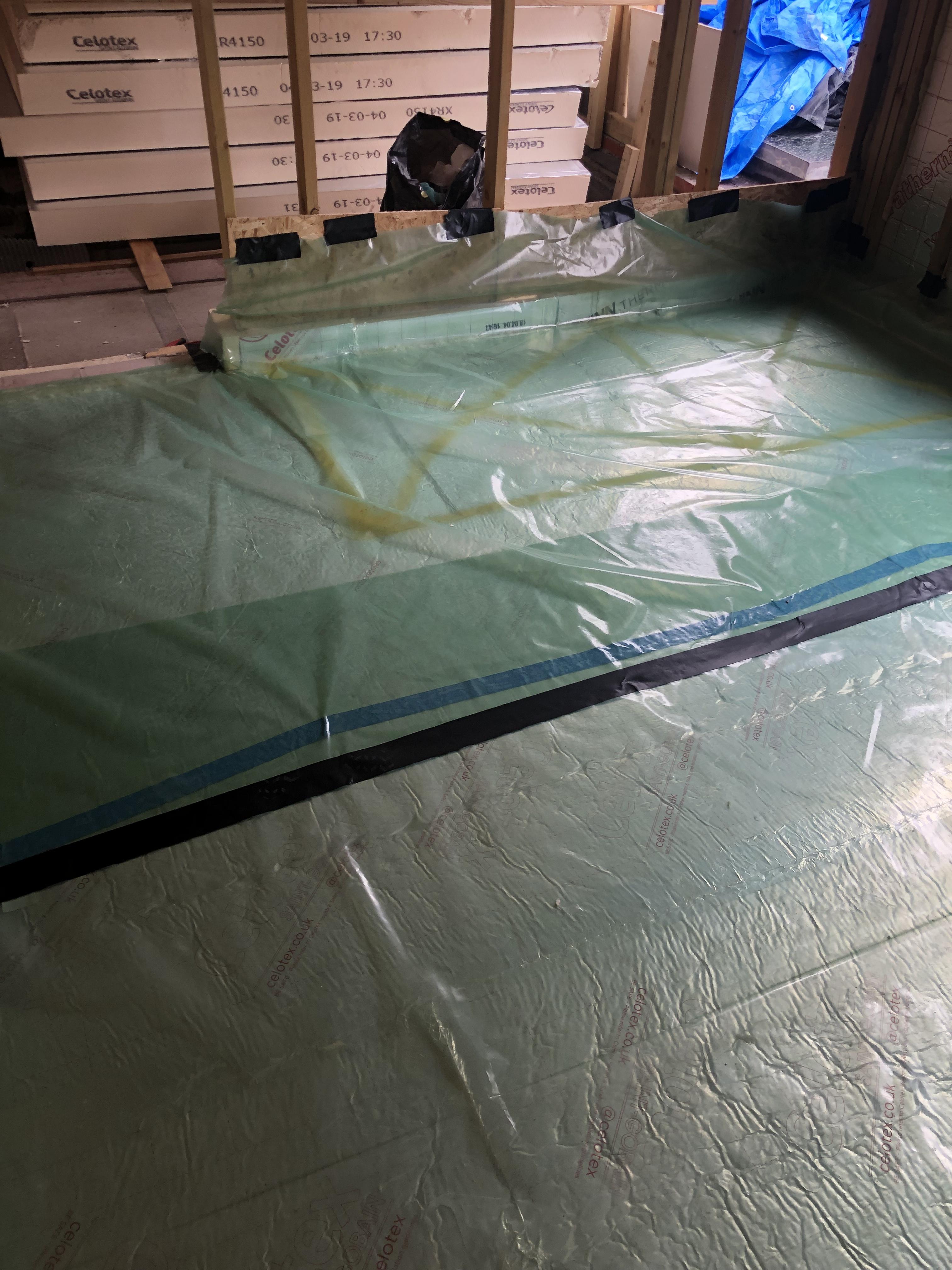

Pocster Posted April 17, 2019 Author Share Posted April 17, 2019 Emergency question ! i assumed the vapour barrier would have a ‘ install this side facing up ‘ ( like roofing barrier ) . But it doesn’t - so it doesn’t matter ? Seems strange Link to comment Share on other sites More sharing options...

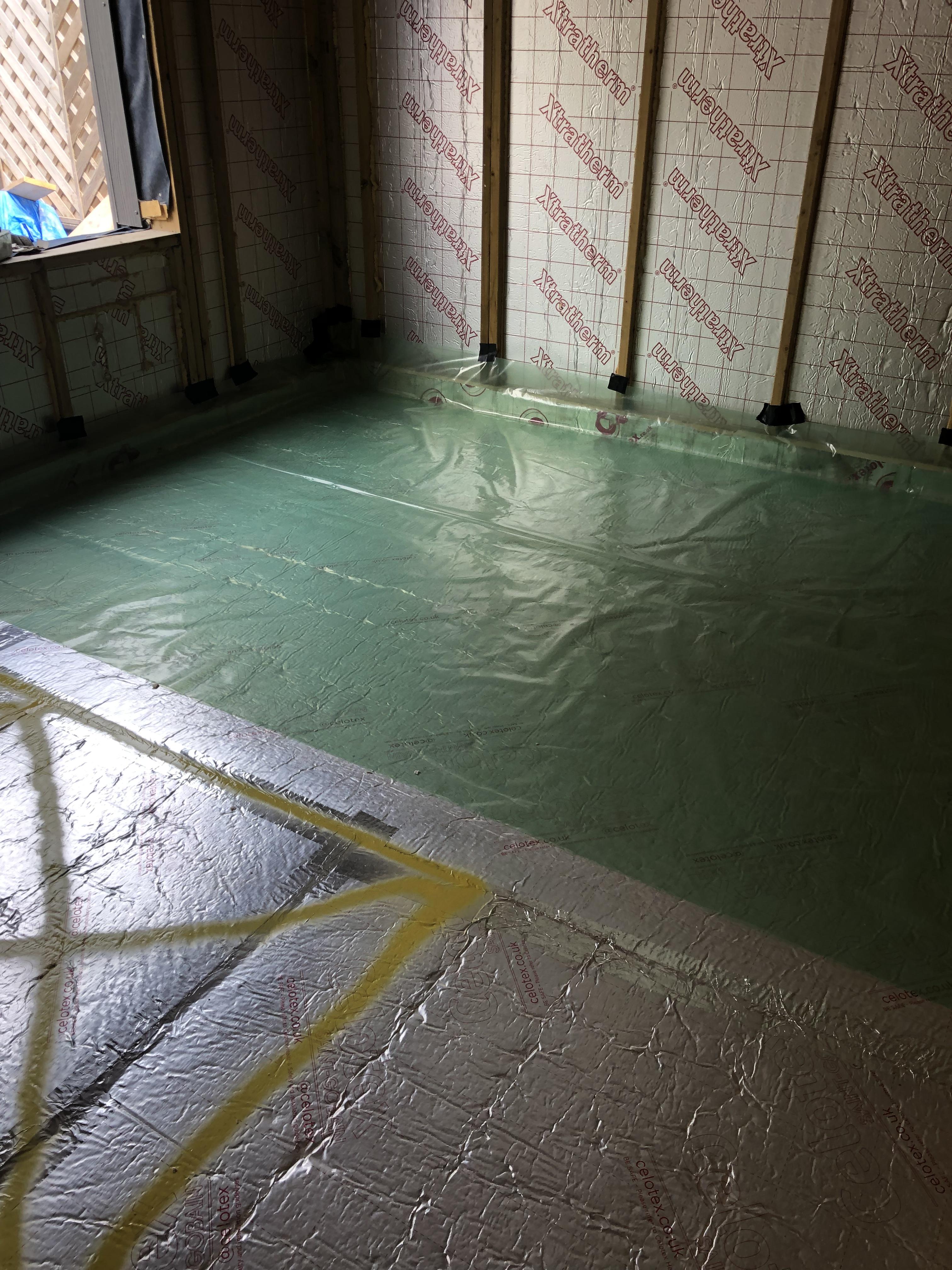

Pocster Posted April 17, 2019 Author Share Posted April 17, 2019 First sheet down . Pushed it into the corners . Can see though when they pour the screed suddenly causing the plastic to slip and slide inwards . Link to comment Share on other sites More sharing options...
Mr Punter Posted April 17, 2019 Share Posted April 17, 2019 Tape the edge to the celotex, as well as taping the laps. Link to comment Share on other sites More sharing options...
Pocster Posted April 17, 2019 Author Share Posted April 17, 2019 2 minutes ago, Mr Punter said: Tape the edge to the celotex, as well as taping the laps. Will do i was worried when it pulls it would rip the foil on the celotex Link to comment Share on other sites More sharing options...
Mr Punter Posted April 17, 2019 Share Posted April 17, 2019 19 minutes ago, pocster said: i was worried when it pulls it would rip the foil on the celotex Nobody dies from that 1 Link to comment Share on other sites More sharing options...
Pocster Posted April 17, 2019 Author Share Posted April 17, 2019 Double sided taped along vapour barrier join ; with single sided tape over edge 1 room done ! 1 Link to comment Share on other sites More sharing options...
