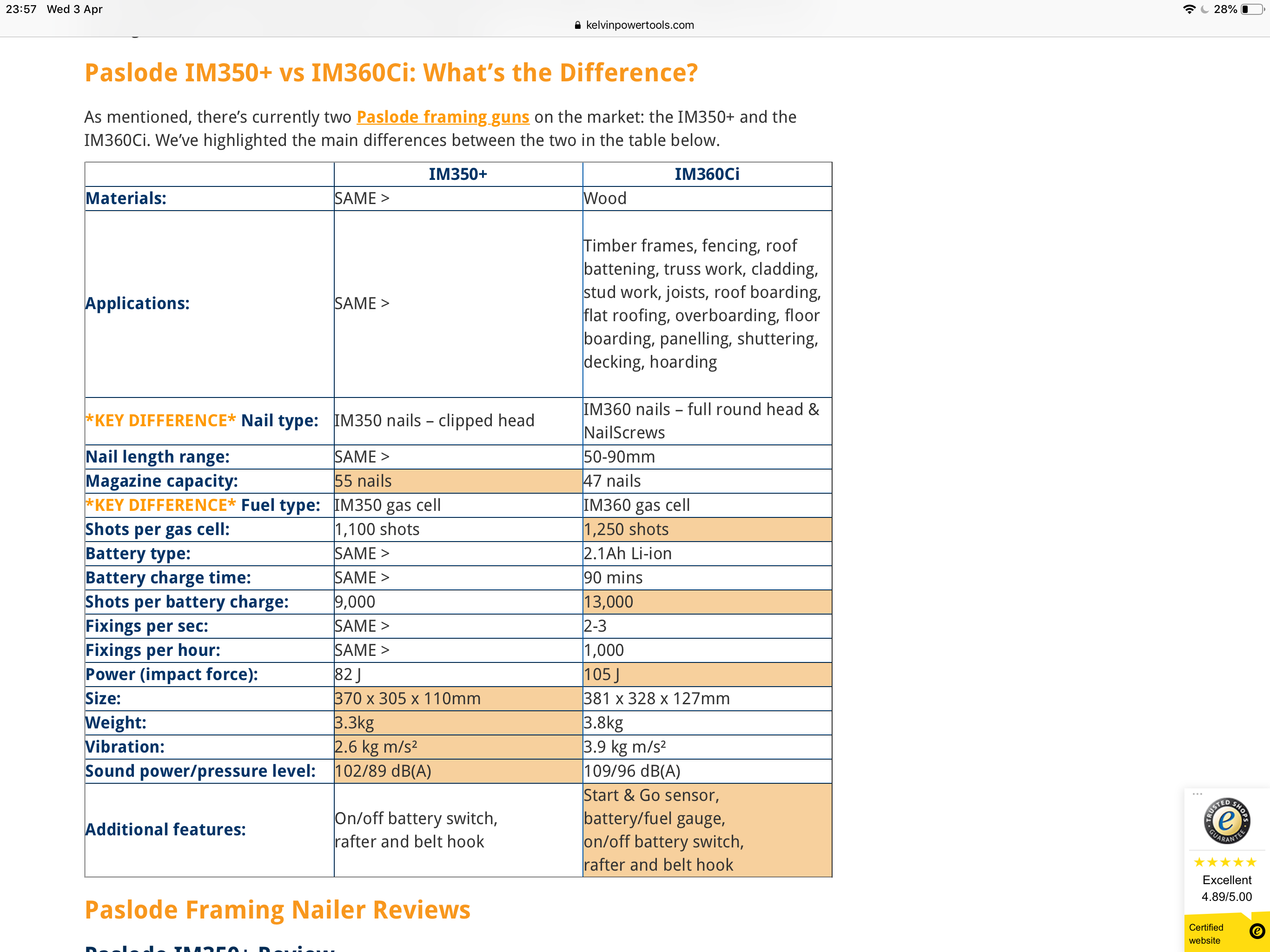

K78 Posted April 3, 2019 Author Share Posted April 3, 2019 (edited) I’ve read the 360 can fire round head nails and screw head nails. But they are expensive compared you the standard ones. Screwfix reviews and questions can be quite useful. Edited April 3, 2019 by K78 Link to comment Share on other sites More sharing options...
Ed Davies Posted April 4, 2019 Share Posted April 4, 2019 Interesting, it's obviously more complicated than what was explained to me. Still, I think all the nails I've bought (Paslode packs specifically for the IM360ci) are clipped head. The other thing that swayed me towards the 360 was that it can do 90mm ring nails whereas the 350 can only do 90mm round/smooth ones. Actually, the 360 does struggle a bit with 90mm ring if there's some tougher wood in the way. E..g, the other day I was doing some JJI beam blocking firing them through 2x18mm ply + 3x9mm OSB3 and about half the nails needed a few taps with a hammer to get them right in. Same layers but all OSB and that very rarely happens. That table says “Power (impact force):” 82 J for the 350 and 105 J for the 360. Apart from that being “impact energy” (joules don't measure power or force) that would explain the difference. 1 Link to comment Share on other sites More sharing options...
