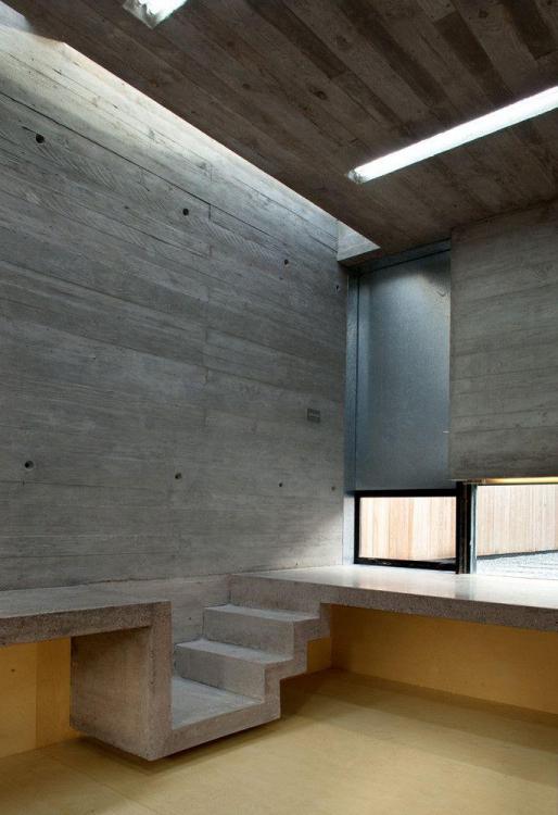

Temp Posted March 31, 2019 Posted March 31, 2019 These tiles might be an option... https://tile.expert/en-gb/tile/Energieker/Formwork I'm on my phone at the moment and it's hard to see the images but they look like tiles intended to produce the shuttered effect. 1

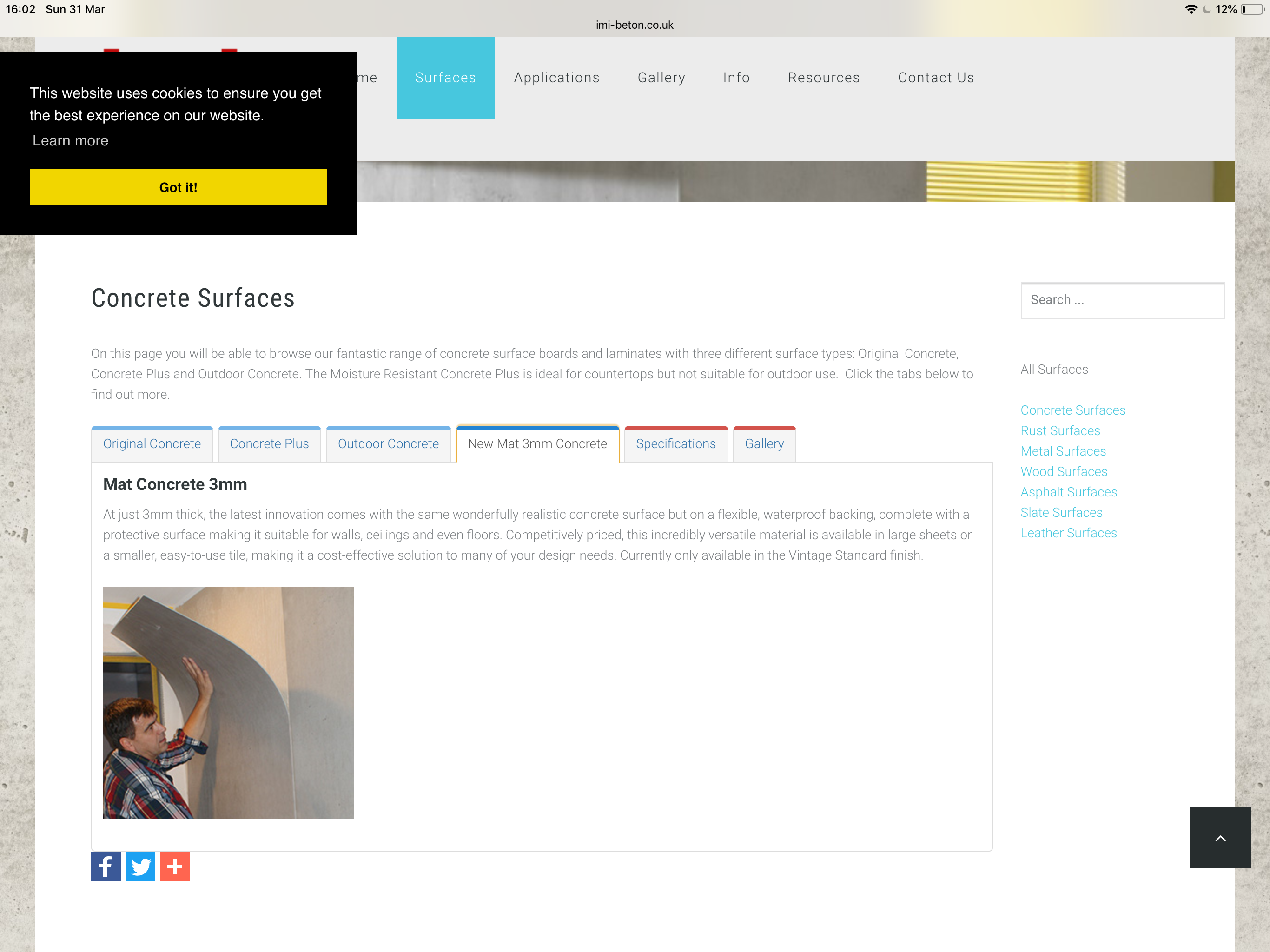

K78 Posted March 31, 2019 Author Posted March 31, 2019 (edited) 1 hour ago, Temp said: These tiles might be an option... https://tile.expert/en-gb/tile/Energieker/Formwork I'm on my phone at the moment and it's hard to see the images but they look like tiles intended to produce the shuttered effect. I stumbled across this site http://www.imi-beton.co.uk/surfaces/concrete?gclid=EAIaIQobChMIxMG3l9Ks4QIVUOJ3Ch3AEwp0EAAYASAAEgKn5PD_BwE No doubt crazy expensive. The product in the pic looks good though. Edited March 31, 2019 by K78

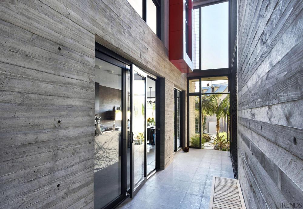

Ferdinand Posted March 31, 2019 Posted March 31, 2019 Gravel board moulds with that finish probably exist too, and could be made up by your local fence place at a tenner each, perhaps with holes for bolts. It would redefine the meaning of "industrial style concrete finish". But I am not sure I would want a wall surface of gravel boards, just from a "what if one fell off" point of view. F 1
K78 Posted March 31, 2019 Author Posted March 31, 2019 It seems that fibre reinforced concrete solves the weight problem. https://anthonyconcretedesign.com/board-formed-concrete-feature-wall-toronto/
Temp Posted March 31, 2019 Posted March 31, 2019 Just to add to my post above... Googling formwork tiles finds there are quite a few makes. 1
K78 Posted March 31, 2019 Author Posted March 31, 2019 (edited) 3 hours ago, Temp said: Just to add to my post above... Googling formwork tiles finds there are quite a few makes. They are definitely an option, and not as expensive as the were. Im going to experiment this week. I’m going to make a mould like in this video. But line the bottom with reclaimed pallet wood before I pour the concrete. I’ll add coconut fibre to the mix and go 1” thick. It’s worth a try. If it’s awful it my satisfy my curiosity and I’ll move onto something else. Edited March 31, 2019 by K78

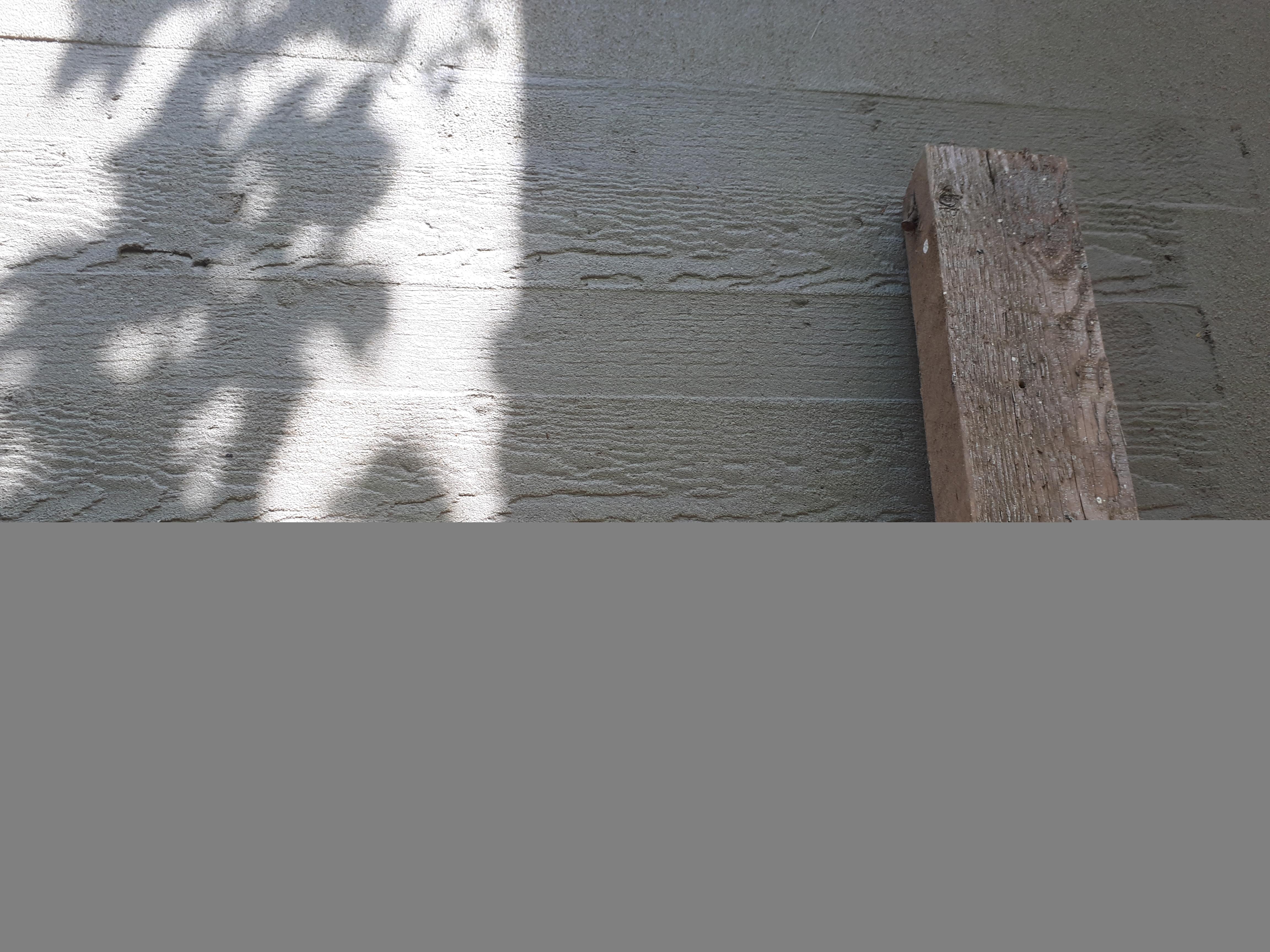

Luckylad Posted May 22, 2019 Posted May 22, 2019 Hi I like the idea of what you’re trying to achieve. I picked up some timber from the skip at work and pushed it into my render. Don’t know if that’s the appearance that you are after. 1
mvincentd Posted May 26, 2019 Posted May 26, 2019 @Luckylad if that pic is your result then excellent, could you please expand on your ‘push’ and you ‘render’.....stuff like the render mix, how soon after application did you push the wood on, did you just push and release or keep it in place, if so how long, any release agent on the timber, etc? thanks
Luckylad Posted May 27, 2019 Posted May 27, 2019 Glad you like it, I’m not sure why all of the photo didn’t upload. We mix the render scratch coat to a ratio of 4 sand/1 cement/half hydrated lime . The top coat we mix 6 sand/1 cement/1 hydrated lime.Half a mug full of wickes waterproofer in each mix, whether its scratch coat 12/3/1.5 or topcoat 12/2/2. Large handful of reinforcement fibre in the scratch coat and 75% less in the topcoat. The sand is 50% soft washed plastering sand and 50% sharp sand. Rule it off and rub it up quickly.When we’re Pargetting we start tapping the moulds with the butt of a large pointing trowel into the wet render as soon as possible. Speed is of the essence. That piece of wood in the photo is straight in one direction but curved the other way,so I could almost roll out the imprint . We’ve never used mould release oil,just being abit cautious about how masonry paint would stick to it. I mostly use a dry rag to rub the mould when sticky or dip it in a bag of kiln dried sand ,the type they use for block paving. 1
K78 Posted May 27, 2019 Author Posted May 27, 2019 On 22/05/2019 at 18:53, Luckylad said: Hi I like the idea of what you’re trying to achieve. I picked up some timber from the skip at work and pushed it into my render. Don’t know if that’s the appearance that you are after. Great result. That’s pretty much it. I want a bit more colour variation.
mvincentd Posted May 27, 2019 Posted May 27, 2019 Thanks for the details @Luckylad, the relative ease is inspiring.
