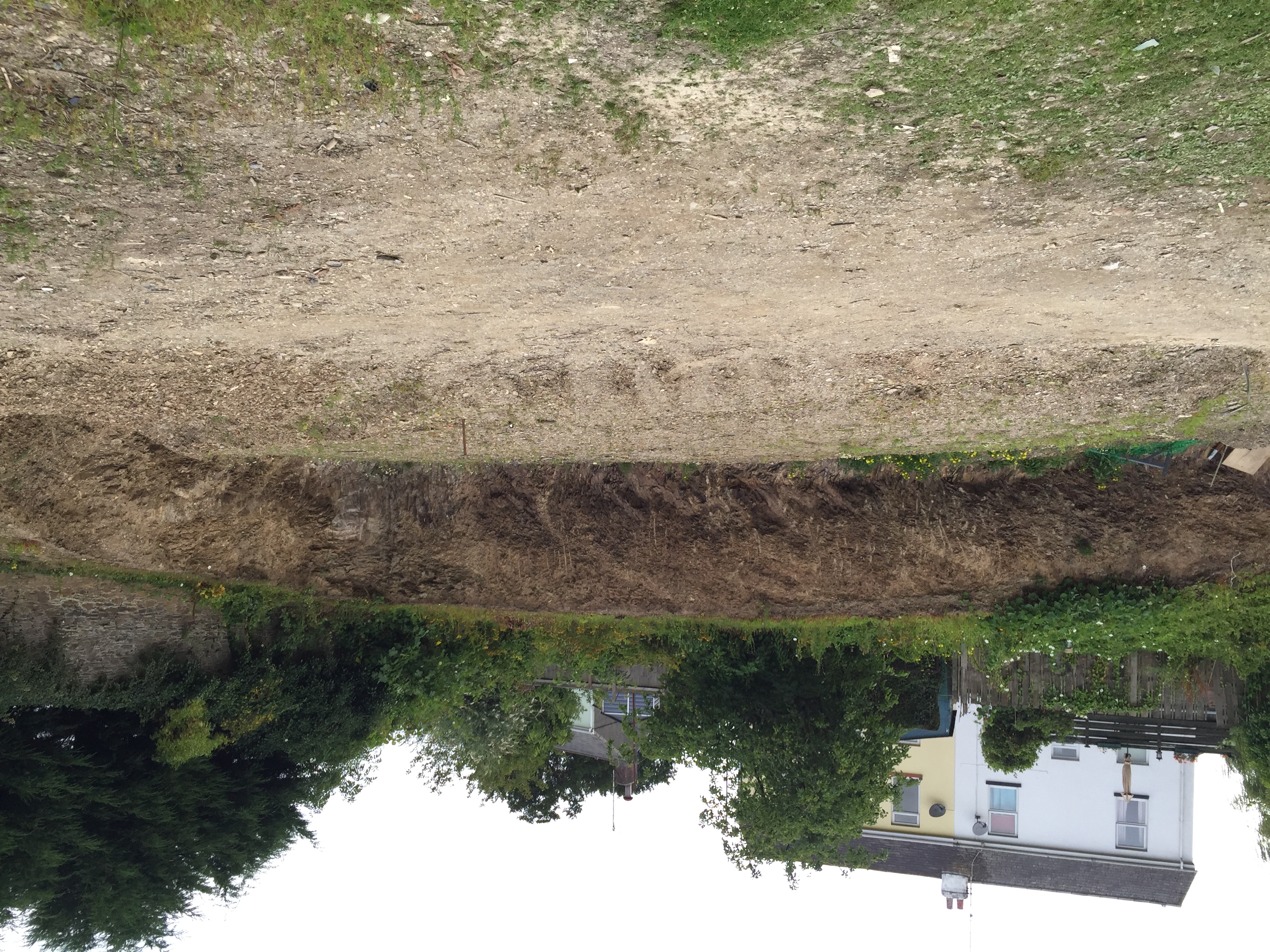

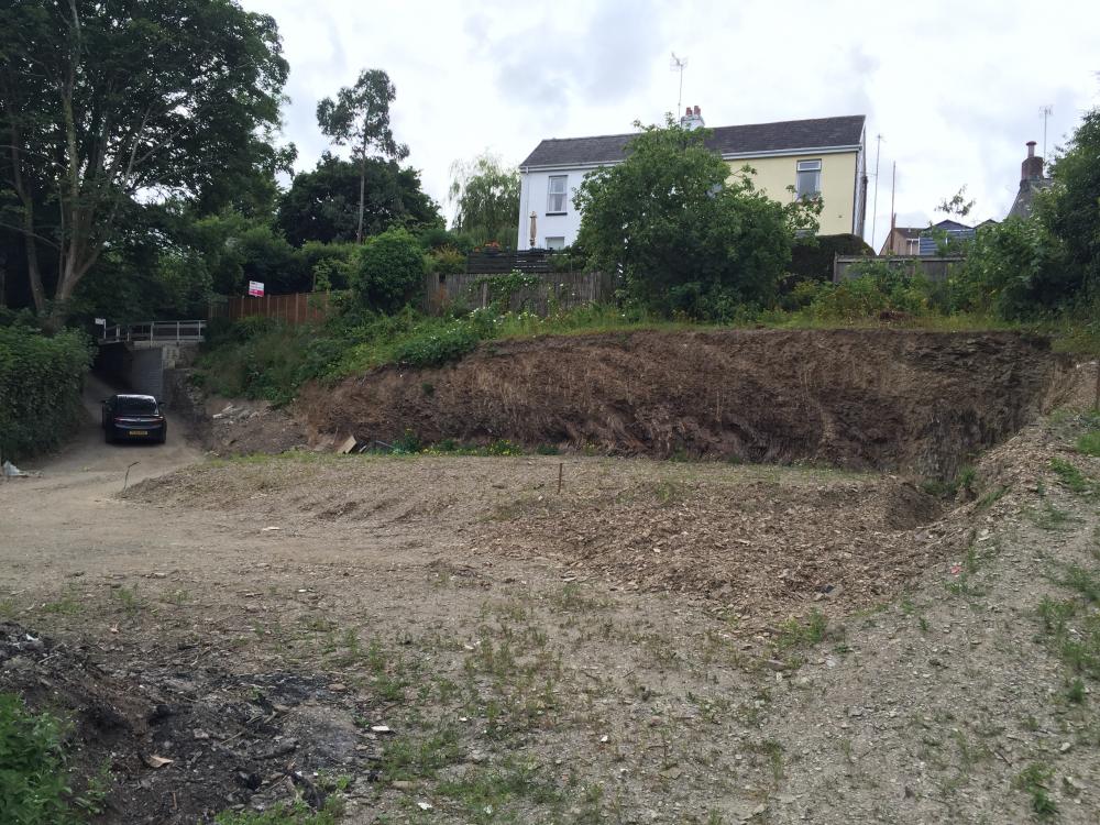

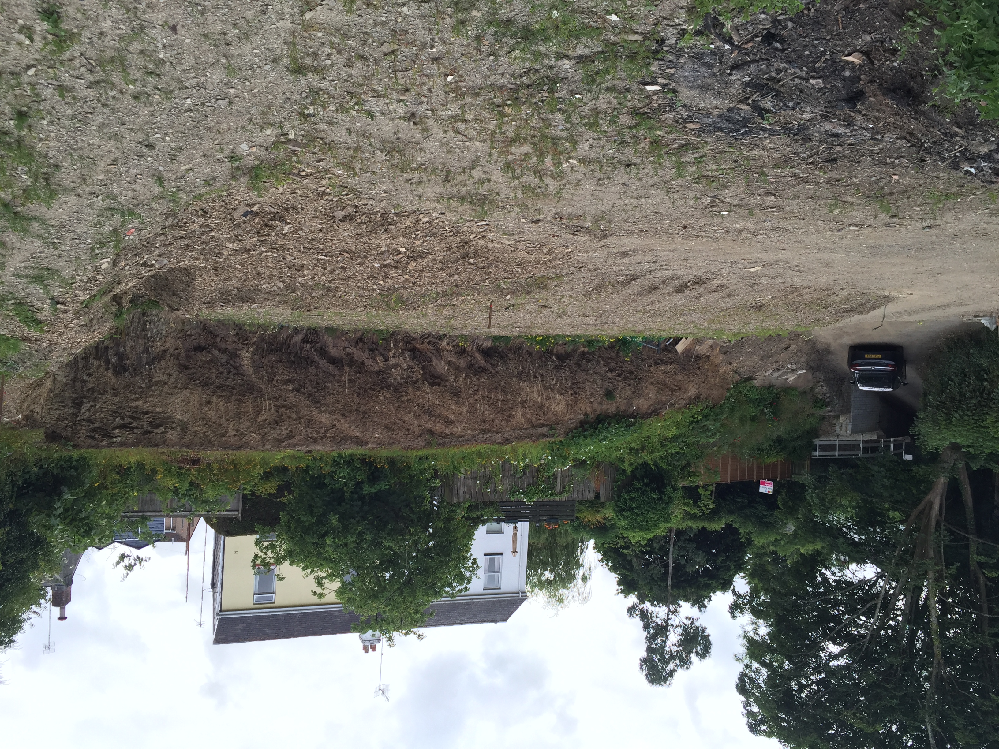

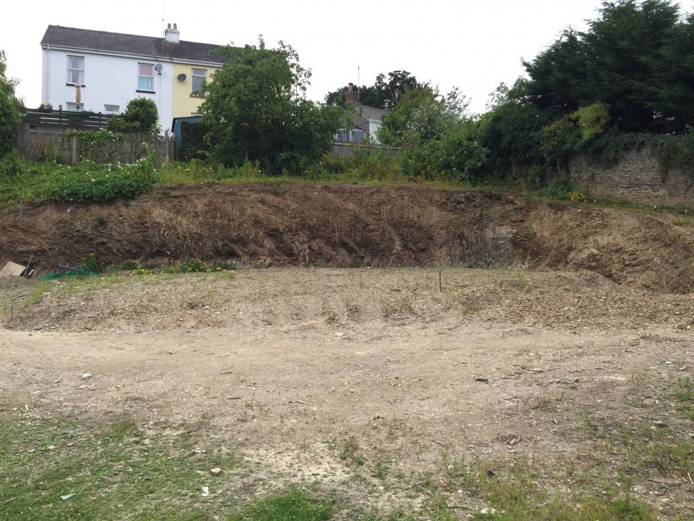

Grosey Posted August 25, 2016 Author Share Posted August 25, 2016 This is the tree in front of the Semis on the higher level. That level needs to be reduced by around 1m so we are going to be getting close to undermining it, everything is generally going to be a lot easier if the tree isn't there! Link to comment Share on other sites More sharing options...
PeterW Posted August 25, 2016 Share Posted August 25, 2016 The little thing about 6m tall..?? Link to comment Share on other sites More sharing options...
Stones Posted August 25, 2016 Share Posted August 25, 2016 That's not a tree, it's a large bush. From the plan I'd assumed it was a tree of the stature of the one to the left of the car / driveway. Personally I'd cut it down and replant later if required. Link to comment Share on other sites More sharing options...
Grosey Posted August 25, 2016 Author Share Posted August 25, 2016 Haha yeah it's not exactly a great oak! Glorified weed really, just wasn't sure how seriously planning take these things! Now where's my chainsaw... Link to comment Share on other sites More sharing options...
PeterW Posted August 25, 2016 Share Posted August 25, 2016 Can you measure it's diameter at 1.5m up from the floor...?? Less than 315mm it's not classed as a tree so can come out anyway. I would be removing it and replanting post build with something else. is there a tree survey as part of the planning submission online ..? Link to comment Share on other sites More sharing options...
Grosey Posted August 25, 2016 Author Share Posted August 25, 2016 No tree survey, the whole place was mostly just overgrown and but wild, with apple trees that have been slowly seeding themselves around the site. Probably time for one last scrumpy harvest. Link to comment Share on other sites More sharing options...
PeterW Posted August 25, 2016 Share Posted August 25, 2016 Ok I would have that out then. Link to comment Share on other sites More sharing options...
