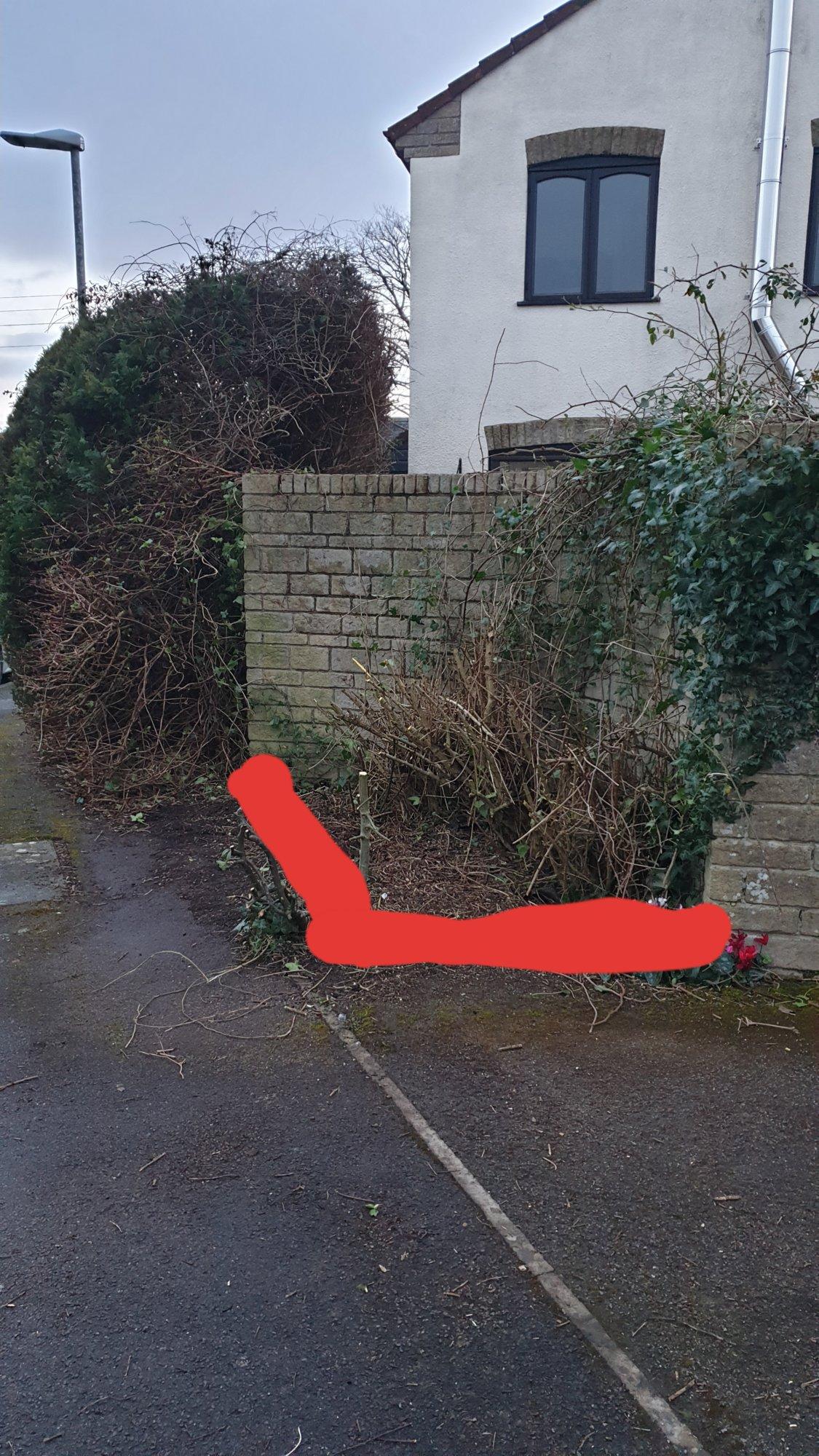

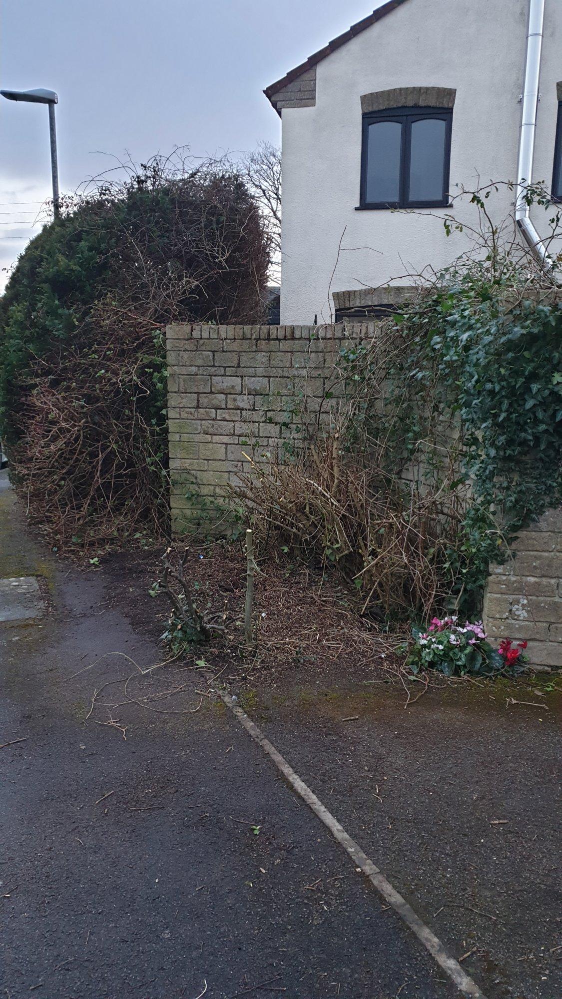

M44XMW Posted March 25, 2019 Share Posted March 25, 2019 Hi everyone!I am hoping for some opinions on whether or not I need planning permission to alter my garden wall. The wall is 6ft high, and has a large curve as seen in the photos attached. I want to remove the curve and straighten it up as shown by my amazing artwork (not to scale). I have read on various threads online that altering a wall of any height can be done without PP. However I don't know if this counts as altering, or other? I also wonder if it being on the curbside would make a difference?Any opinions will be greatly appreciated!ThanksMax Link to comment Share on other sites More sharing options...
lizzie Posted March 25, 2019 Share Posted March 25, 2019 Why is it curved? Visibility splay perhaps...looks like it may be next to a driveway. Is it your land? Link to comment Share on other sites More sharing options...
ProDave Posted March 25, 2019 Share Posted March 25, 2019 I suspect that will need planning permission. In my very first house there was a 6ft fence at the end of my garden bordering a road, except there was first a 5ft strip of land before the footpath, which was shown as mine on the deeds. I had to get planning permission to move that fence as it bordered the highway and anything over 1 metre tall adjoining the highway needs PP. I wonder why it was built like that? I can clearly see why you want to move it. Link to comment Share on other sites More sharing options...
M44XMW Posted March 25, 2019 Author Share Posted March 25, 2019 29 minutes ago, lizzie said: Why is it curved? Visibility splay perhaps...looks like it may be next to a driveway. Is it your land? I am unsure why it is curved, I have another curved section on the other side of the house also. Weird I know! The piece of tarmac to the right hand side is my drive way. For visibility, no other properties will be affected by the wall alterations. Previously there were some very large bushes in that space. Link to comment Share on other sites More sharing options...

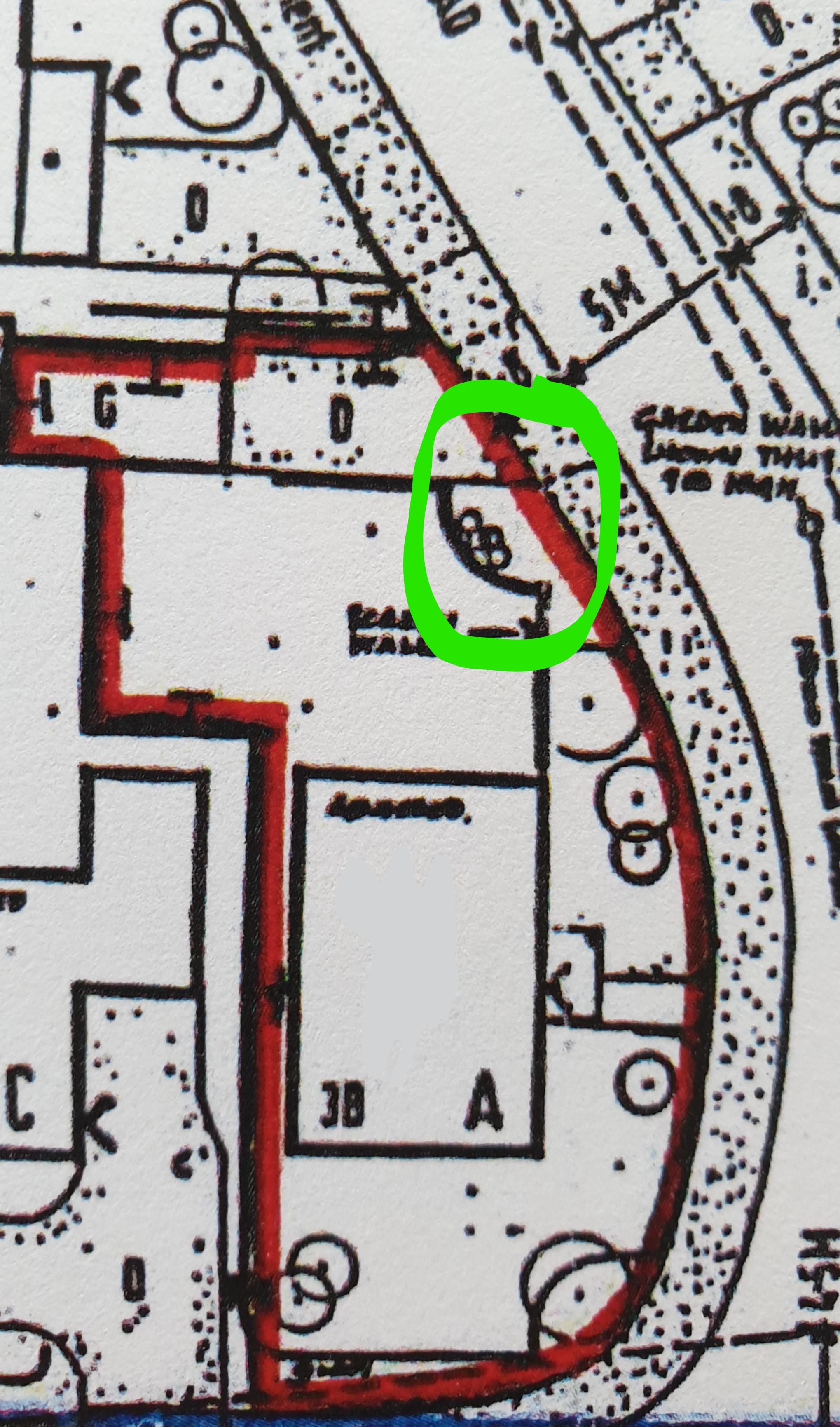

AliMcLeod Posted March 25, 2019 Share Posted March 25, 2019 (edited) Can you post a rough site layout with the wall marked? Does your drive open out onto a busy road? It could be that the visibility splays are there so that cars on the road can see cars coming out of the drive (and vice-versa). Edited March 25, 2019 by AliMcLeod Link to comment Share on other sites More sharing options...
M44XMW Posted March 25, 2019 Author Share Posted March 25, 2019 1 hour ago, AliMcLeod said: Can you post a rough site layout with the wall marked? Does your drive open out onto a busy road? It could be that the visibility splays are there so that cars on the road can see cars coming out of the drive (and vice-versa). I think they are meant to be visibility splays, however for years now there have been huge bushes that stop them being of any use. I have attached a plan. The green circle is the wall in question. Link to comment Share on other sites More sharing options...
lizzie Posted March 25, 2019 Share Posted March 25, 2019 Yes you can see why it was done like that for visibility coming out onto the road. Think you need to talk to your local planners, they may want an input from highways too. Link to comment Share on other sites More sharing options...
Temp Posted March 25, 2019 Share Posted March 25, 2019 I would check with the planning office what visibility splay is required and see if you can meet it. If you can then submit a planning application. If not then consider reducing a section to 1m high. If you own the land bordered in red it looks like other enlargements are possible. Link to comment Share on other sites More sharing options...
