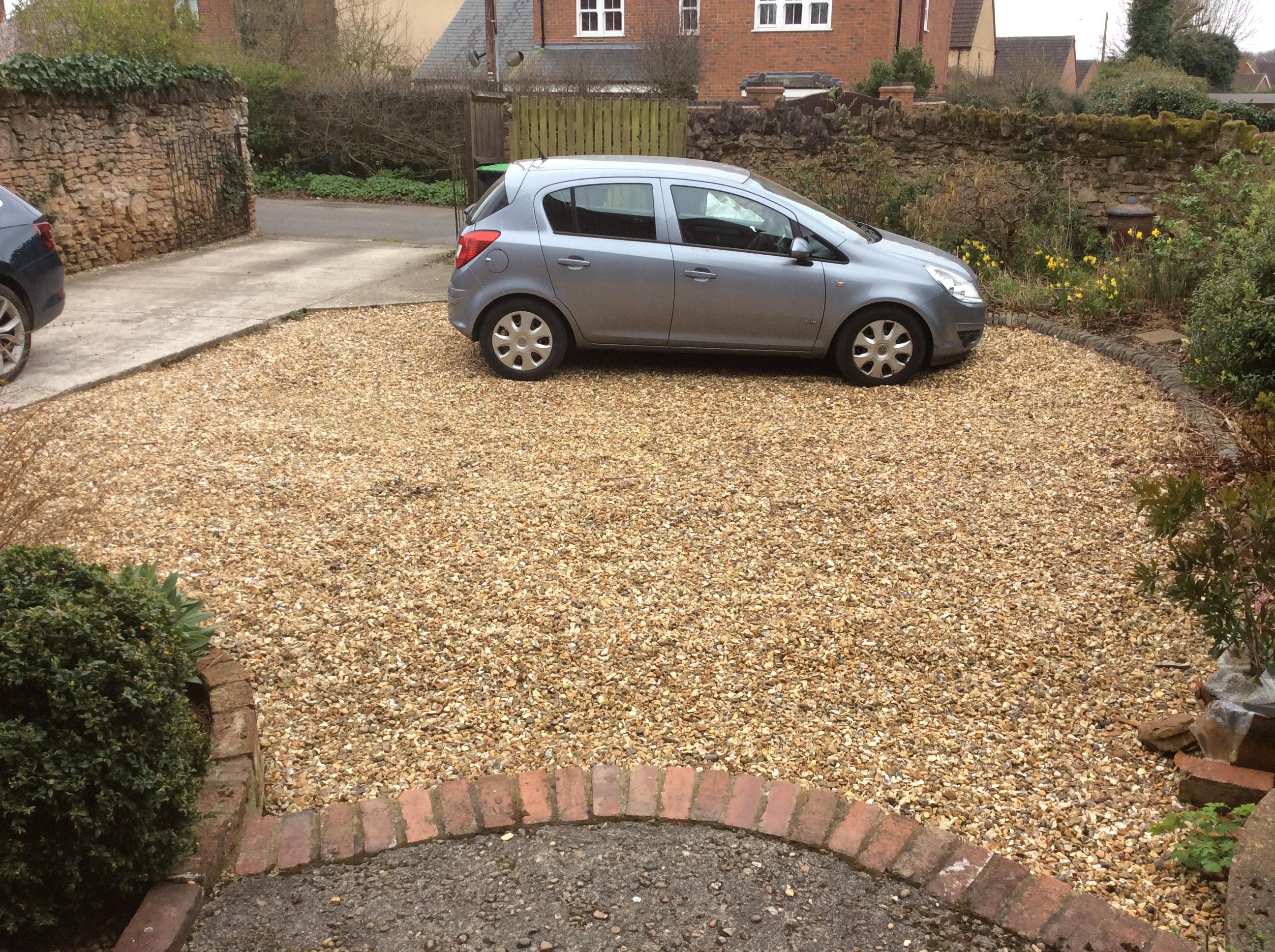

Ferdinand Posted March 22, 2019 Posted March 22, 2019 (edited) You could do a two-area one using trad gravel with tarmac. This is mine done about 5 years ago, where I replaced the existing traditional suburban front garden lawn and beds with 2-3 car parking, Aimed for 3, in practice a comfortable 2. The existing concrete drive stayed in situ. It was done with proper ground fabric etc, and it is about 50-50sqm of gravel. The edgings are cement, and I think the whole thing was about 3k all in in 2013. As you can see, it is still Pretty much weed free, and te maintenance is 1 raking a year, or perhaps 2. Oh .. car is for sale if anyone wants a 2009 1.4 Corsa auto with 50k. Ferdinand Edited March 22, 2019 by Ferdinand

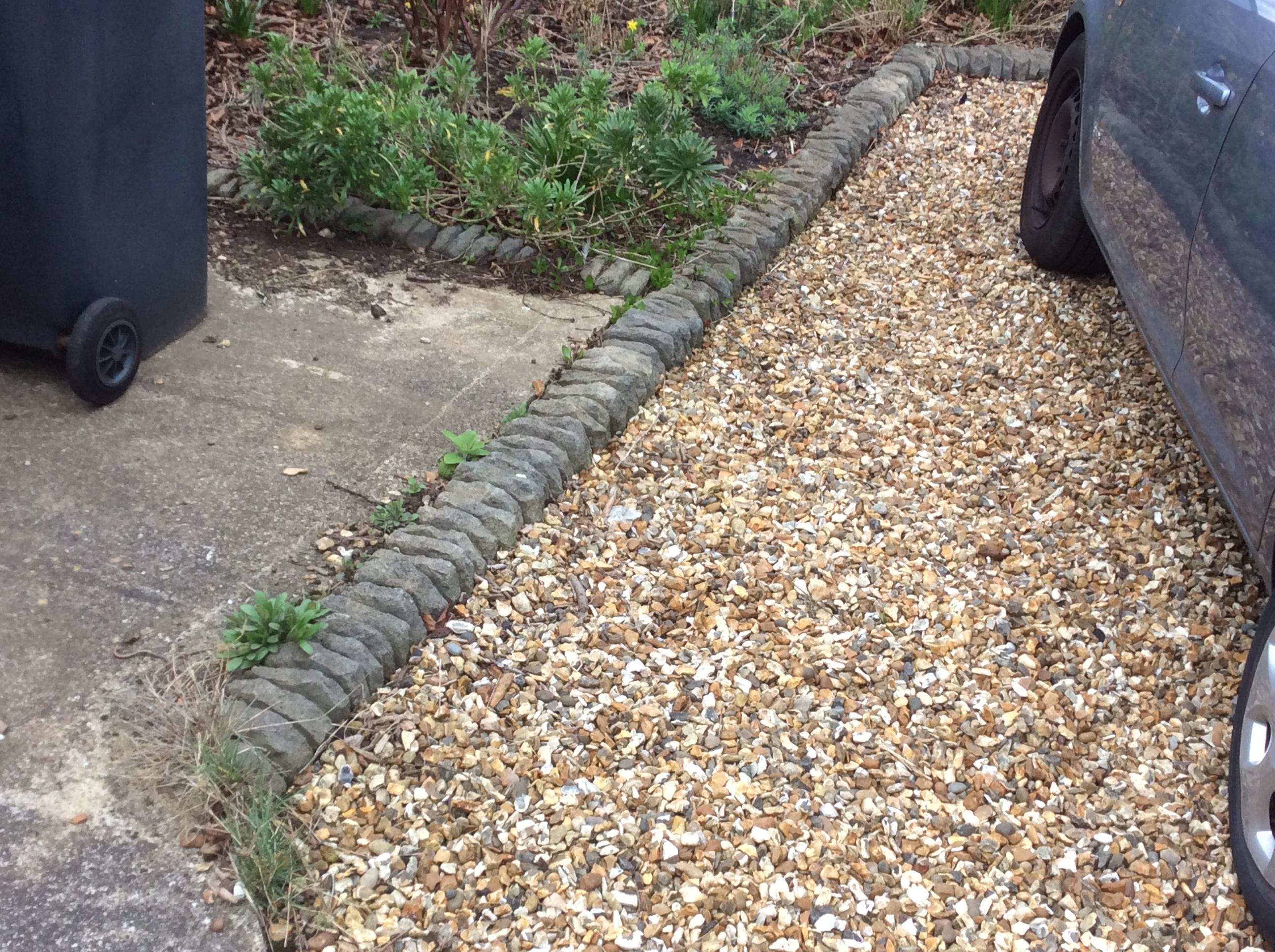

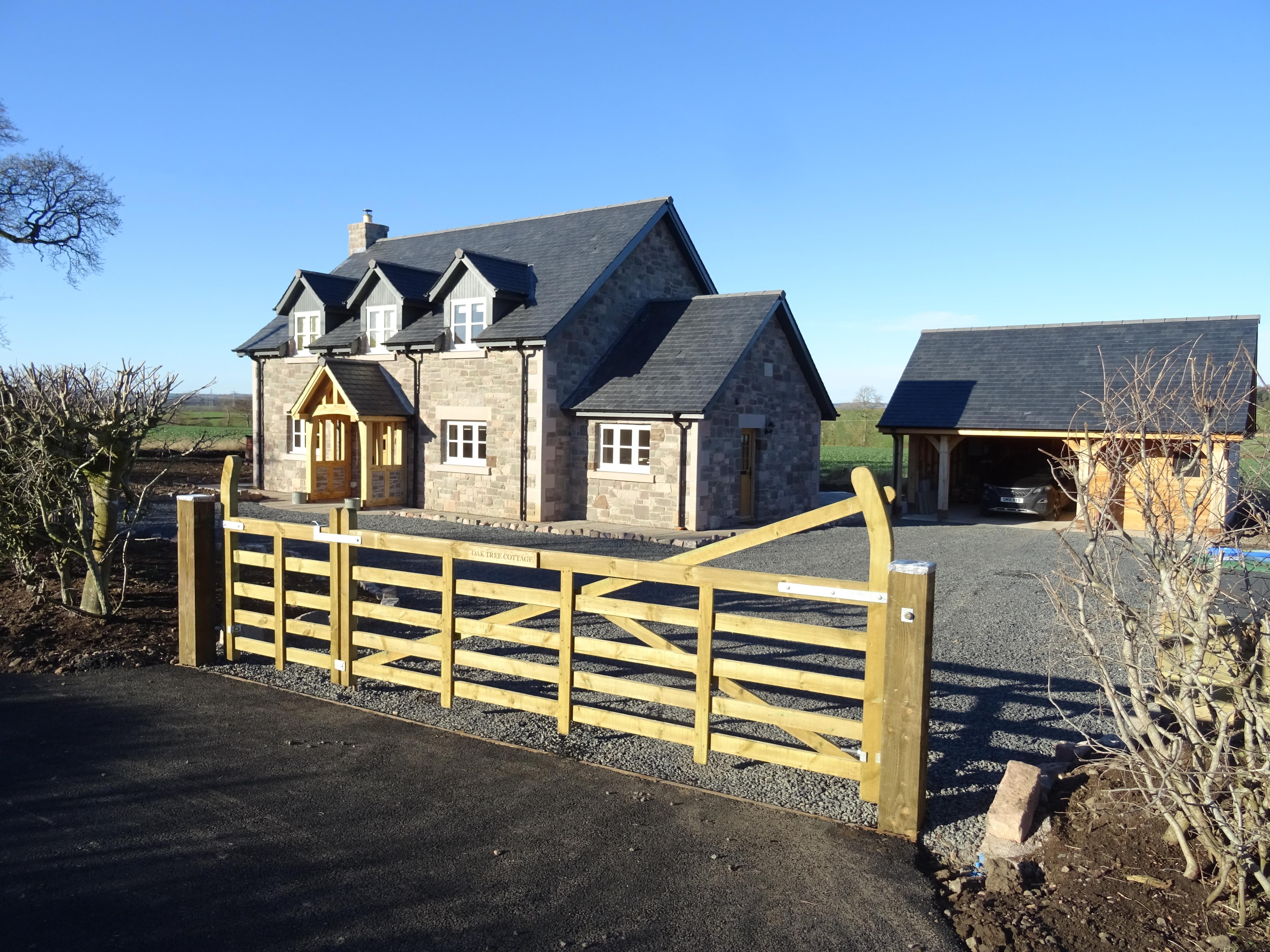

Redoctober Posted March 22, 2019 Posted March 22, 2019 All good suggestions above and for completeness, I thought I would include a loose chippings driveway. Thus far [4 months] no issues with it. 1

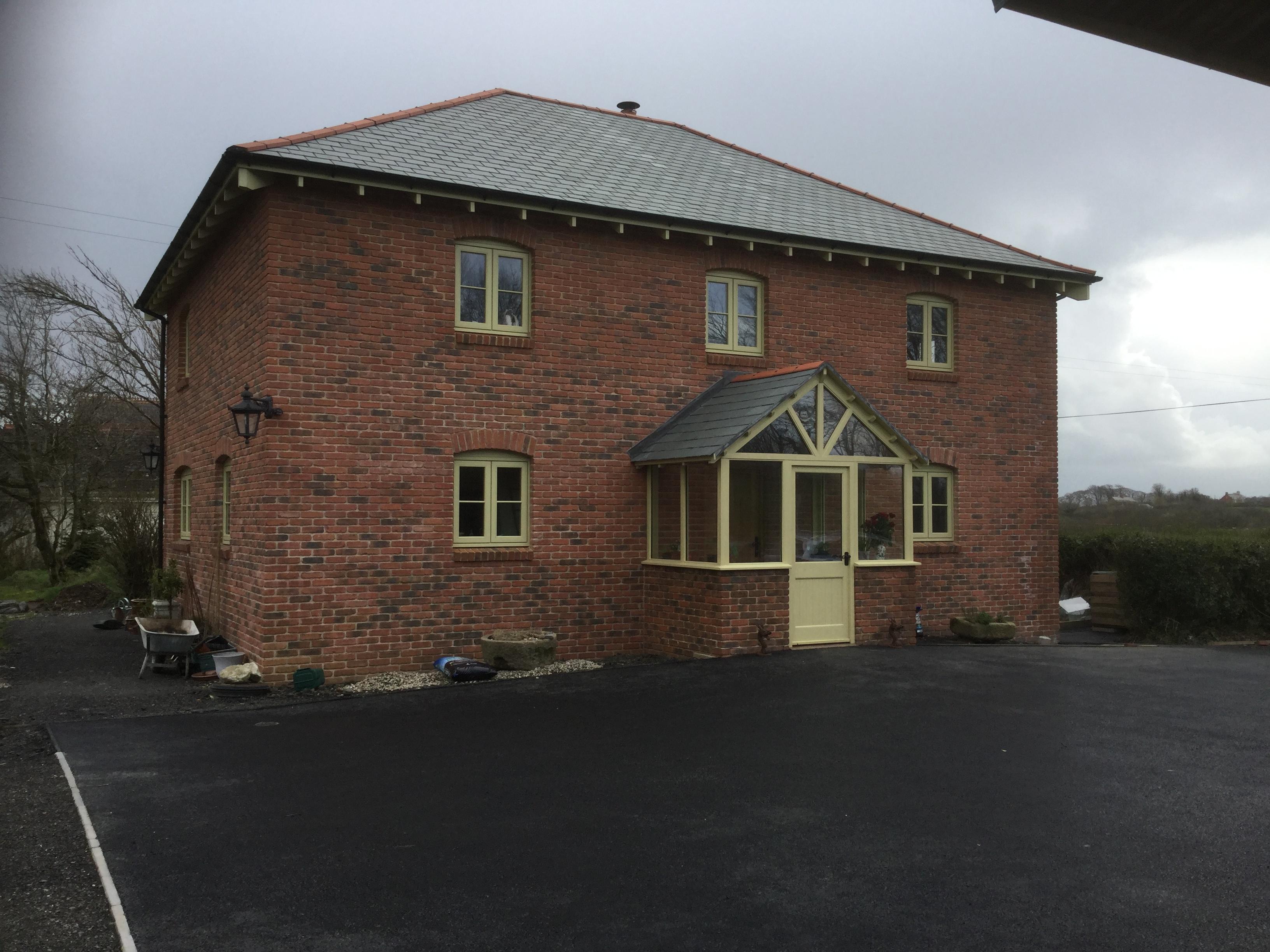

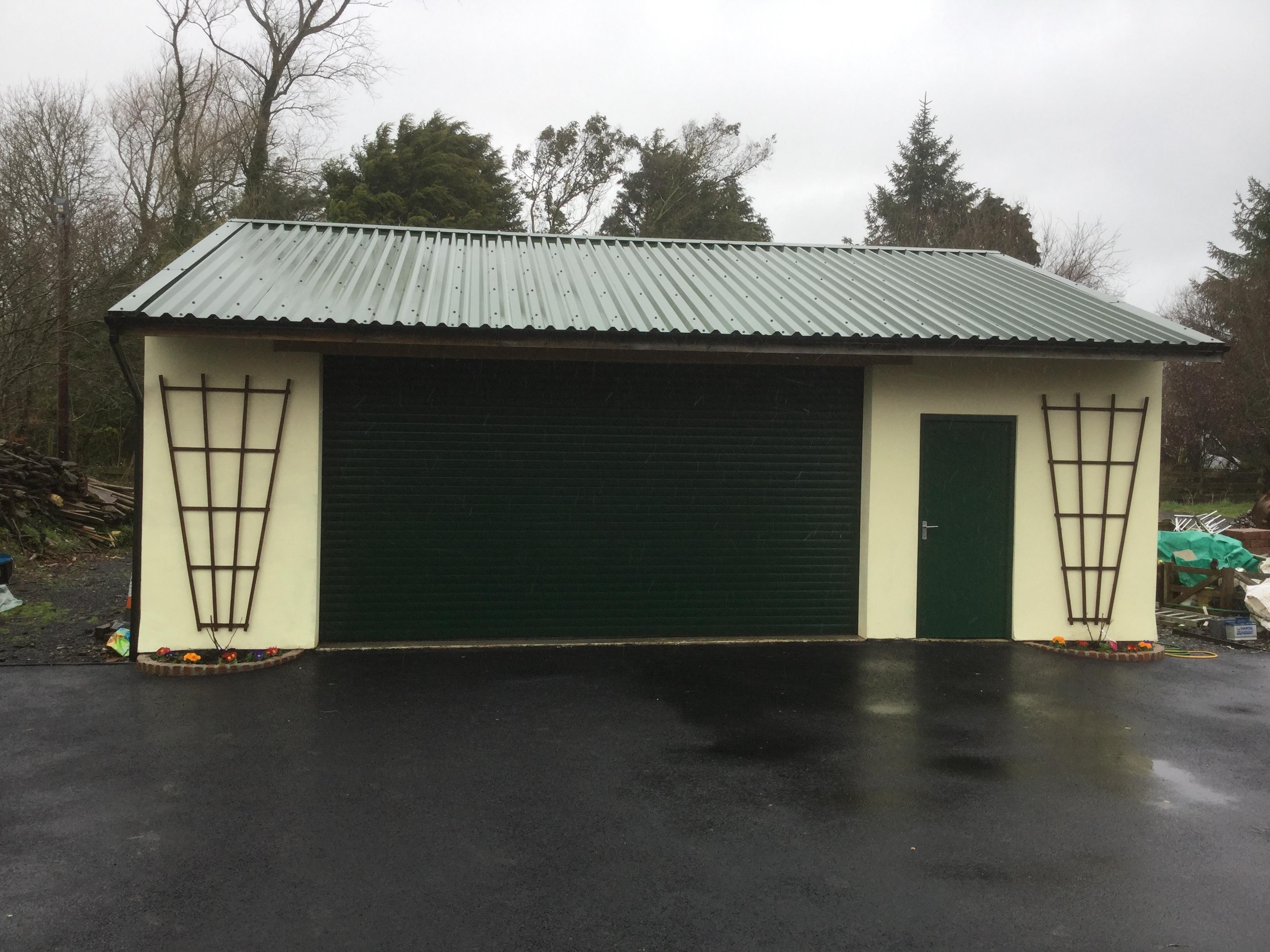

joe90 Posted March 22, 2019 Posted March 22, 2019 We went for tarmac and and plan fancy brick edging to match the house, gravel areas for pots and block paving for paths around the house. 1
