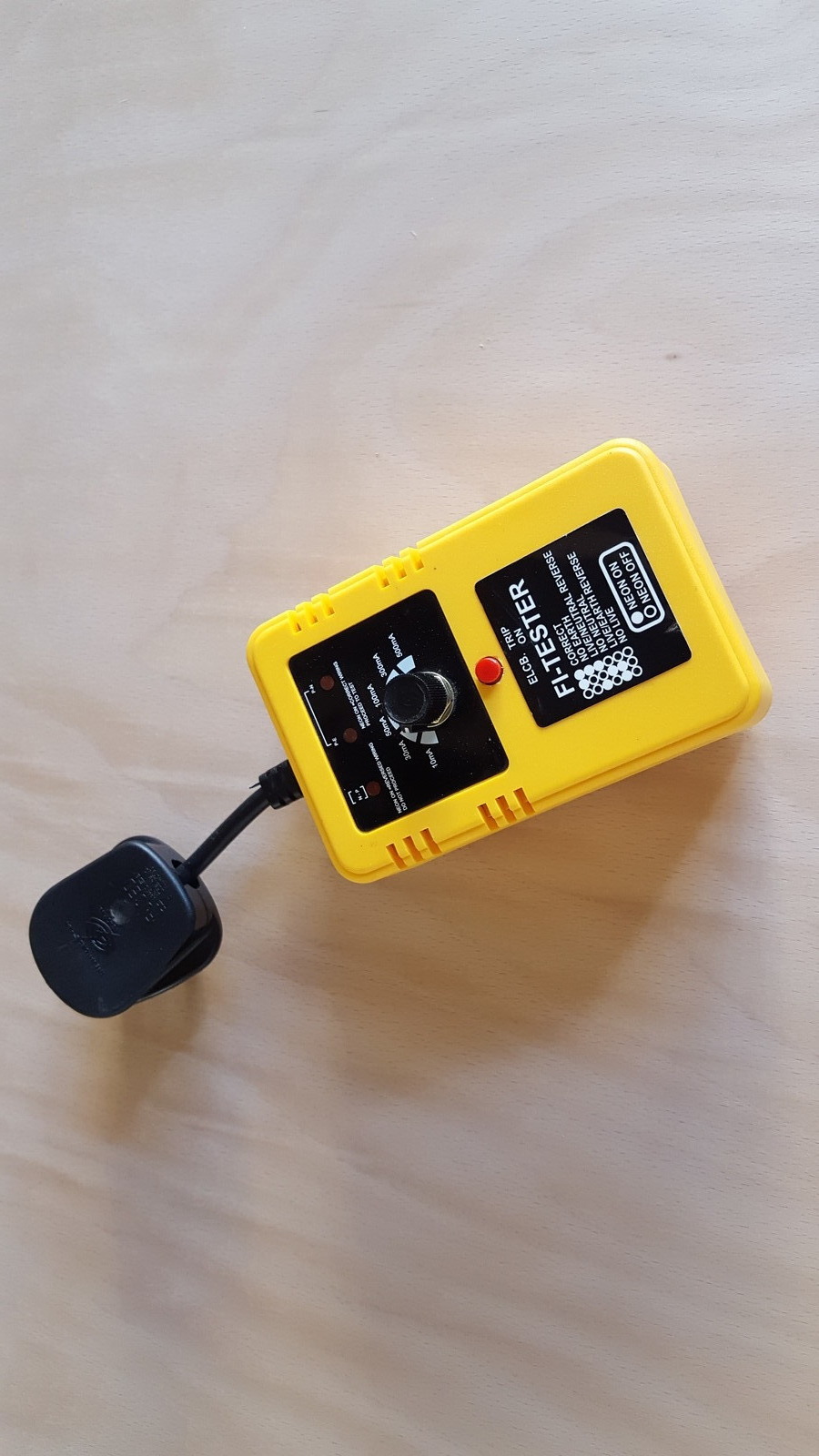

MJNewton Posted March 29, 2019 Posted March 29, 2019 (edited) 28 minutes ago, Carrerahill said: Jeremy, that is how the Merlin Gerin ones worked, albeit built into the RCD, and I thought many others did too now. Down and dirty testing is often pretty good! It is definitely the best method for testing the RCD protection of a single RCD or a complete circuit (ideally with timing measurement of course) but the only way to test a downstream RCD such as the plug-in types without indiscriminate tripping of an upstream RCD is to force an inbalance through that one coil and not them both as would be the case if leaking to Earth. Incidentally, my neon socket tester has a built-in RCD test function with variable leakage currents and whilst it doesn't perform trip timings (or detect neutral-earth reversal) it is nevertheless a handy cheap tool to have. I don't see many of this type around though for some reason. (Apologies for the incorrect rotation - the original is landscape though) Edited March 29, 2019 by MJNewton
Jeremy Harris Posted March 29, 2019 Posted March 29, 2019 5 minutes ago, MJNewton said: It is definitely the best method for testing the RCD protection of a single RCD or a complete circuit (ideally with timing measurement of course) but the only way to test a downstream RCD such as the plug-in types without indiscriminate tripping of an upstream RCD is to force an inbalance through that one coil and not them both as would be the case if leaking to Earth. Incidentally, my neon plug tester has a built-in RCD test function with variable leakage currents and whilst it doesn't perform trip timings (or detect neutral-earth reversal) it is nevertheless a handy cheap tool to have. I don't see this type much around though for some reason. (Apologies for the incorrect rotation - the original is landscape though) That's a posh version of my tatty home made one! Mine just has a single resistor that gives around 30 mA or so, as we've not lived anywhere with a TT installation for years now.
MJNewton Posted March 29, 2019 Posted March 29, 2019 (edited) I was trying to see if I could find mine anywhere as people often ask where it was from but it seems it has long since been discontinued. I did just stumble across this one though (a DI-LOG DL1092 in case the link ever rots) which for £17.99 might be worthwhile for those not wanting to spend too much or go down the DIY route. Edited March 29, 2019 by MJNewton
