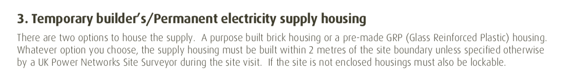

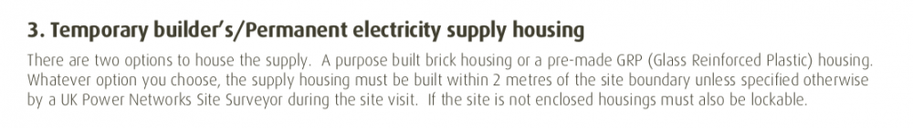

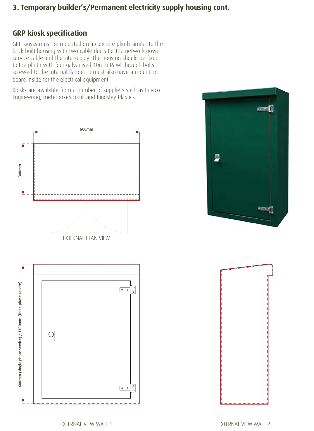

Dreadnaught Posted March 19, 2019 Author Share Posted March 19, 2019 Now I have noticed something that is confusing me. In the document from UKPN that accompanied my quote called "YOUR TO DO LIST, What you need to do to get connected" it does specify a £600 GRP cabinet, as shown below. Why do they say that? Link to comment Share on other sites More sharing options...
epsilonGreedy Posted March 19, 2019 Share Posted March 19, 2019 20 minutes ago, Dreadnaught said: It now dawns on me that I am bit short of time before UKPN install the supply on 28 March so I need to decide on the meter cabinet/kiosk type and location. Quick question: is it possible to attach a plastic meter cabinet temporarily to a pretty-run-down old fence? The ideal (cheapest) sequence of events is to get the foundations dug and the concrete poured, then schedule the DNO power grid hook-up bringing the meterbox right up to the wall near its final cavity wall mounting position. With careful positioning of the meterbox on stilts there will be enough spare cable to lift the meter directly into the wall without further £ bills. Buildhubbers with larger plots seem to favour a dedicated services meter housing near the plot boundary and then total control over subsequent services re routing within the plot as the build progresses. 1 Link to comment Share on other sites More sharing options...
