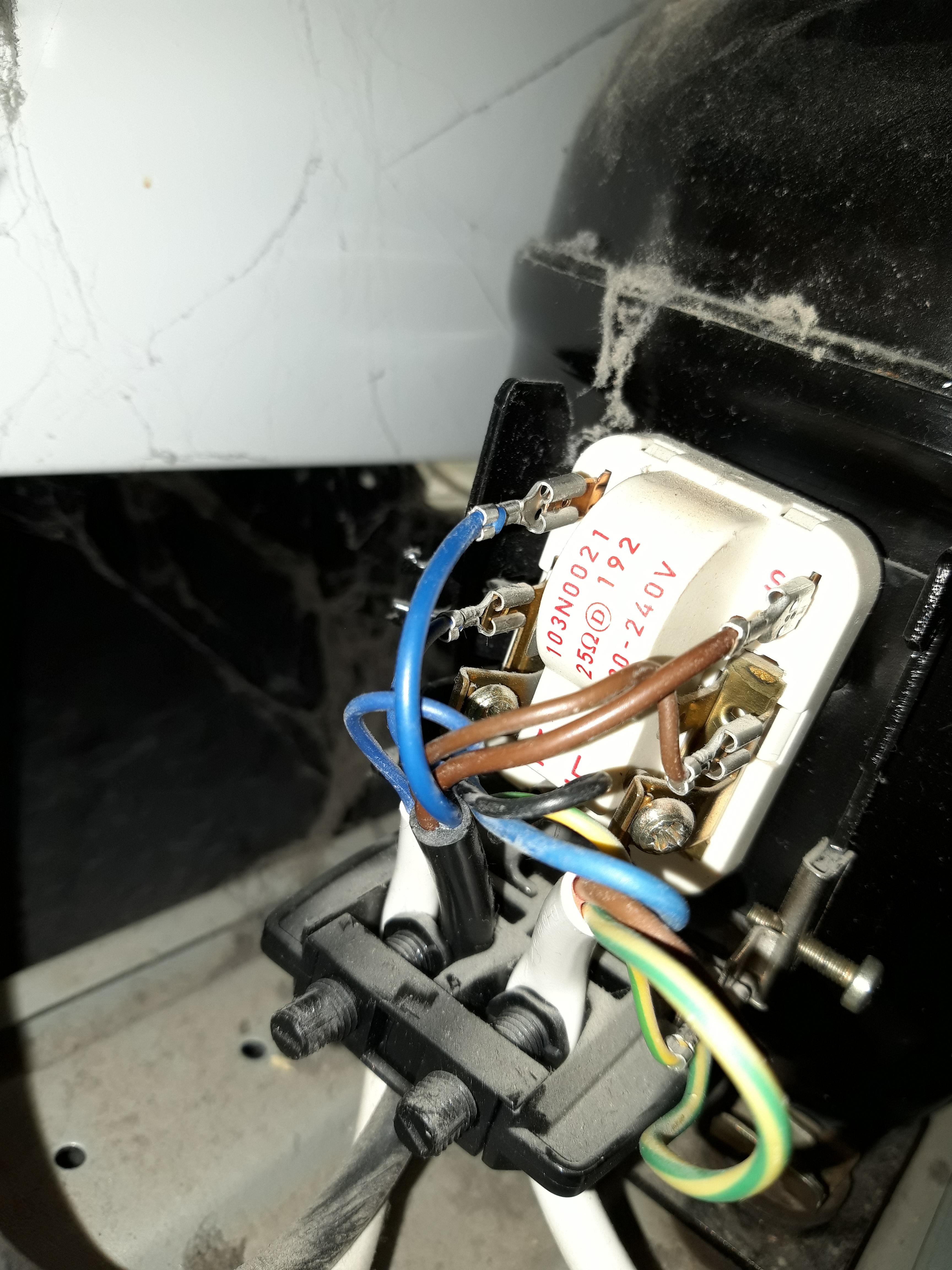

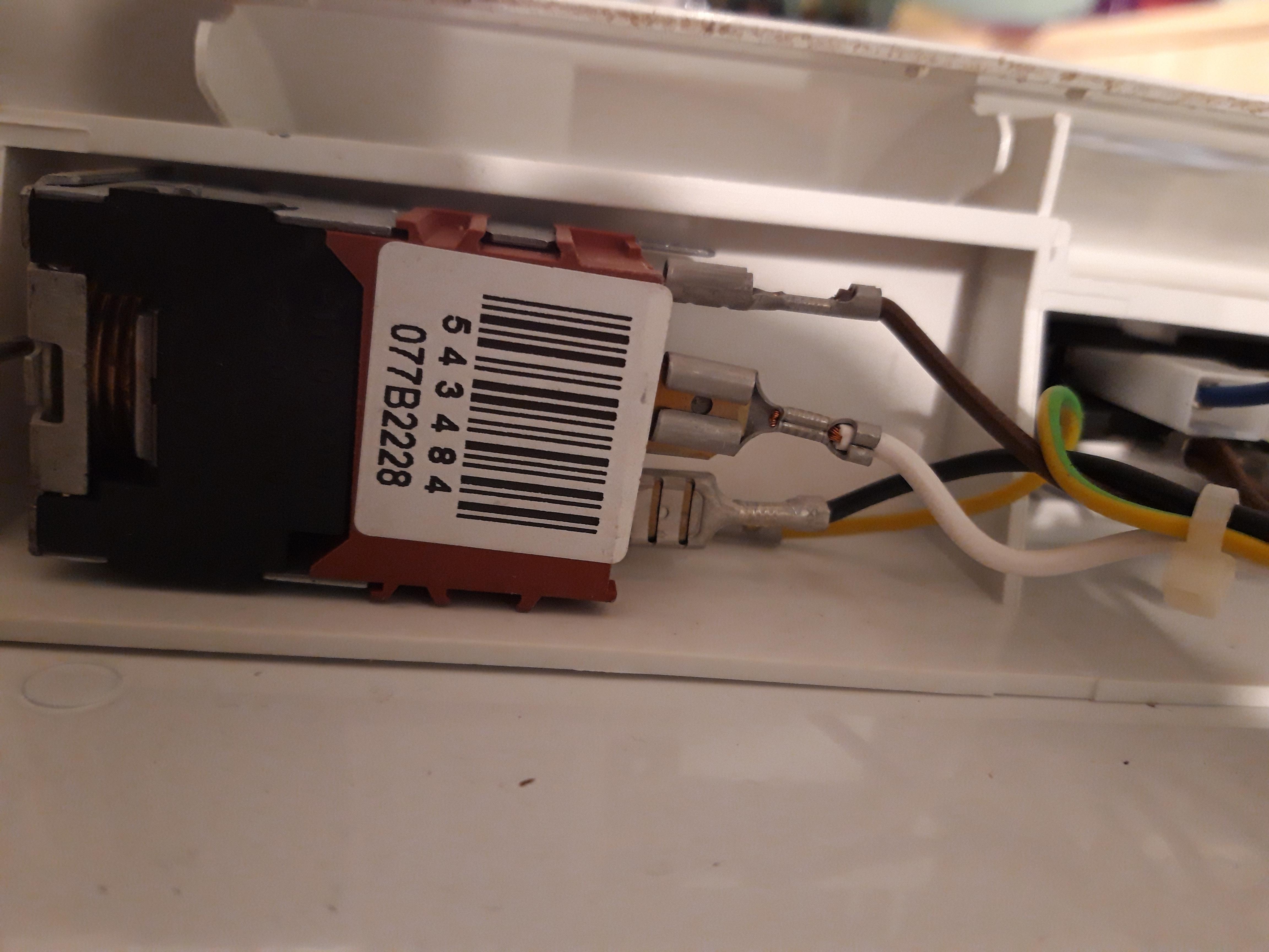

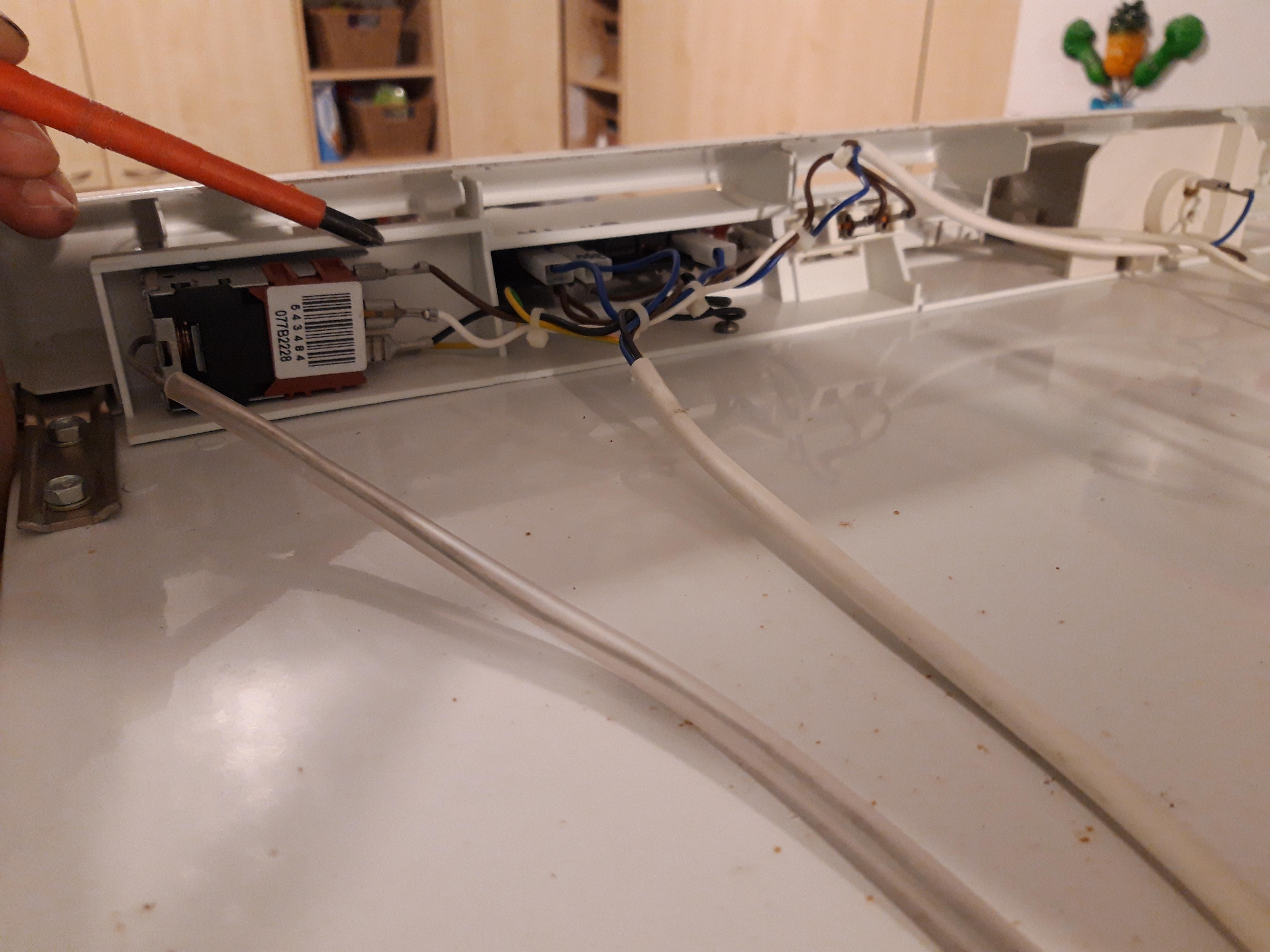

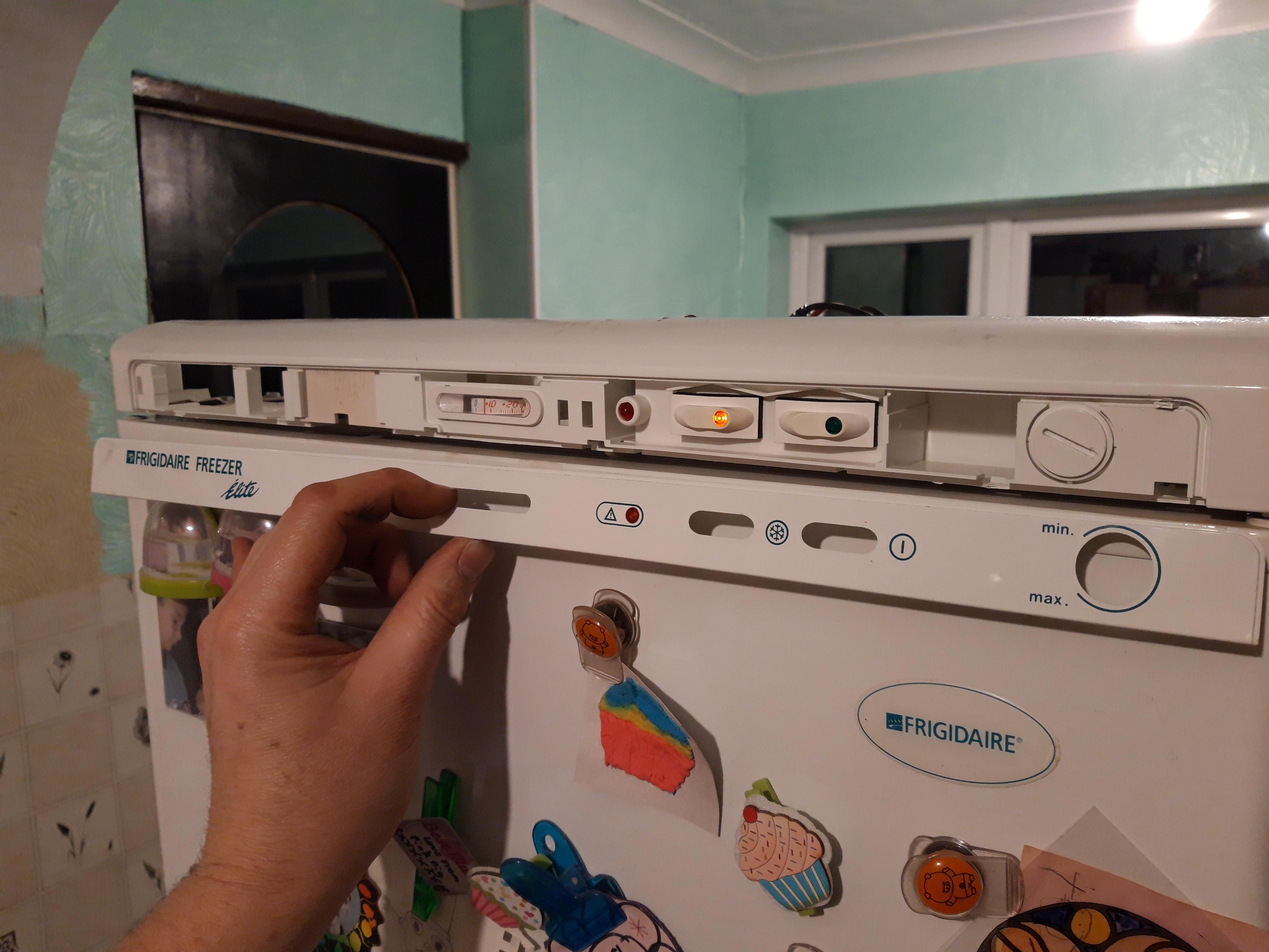

Onoff Posted March 19, 2019 Author Share Posted March 19, 2019 (edited) Having a look now... 4uF cap climbs to circa 3.8uF. On / off switch works ok but (green) neon duff. Compressor (Danfoss) does not start. Switching fast freeze (orange neon) on "*" and compressor starts. I assume that fast freeze just bypasses the stat. Switching on and stat gets 230V on the brown. Nothing on the black or white. Turning the stat makes no difference and there's also no audible "click". White btw just goes to the low temp lamp between the fast freeze switch and thermometer. When the freezer failed it didn't come on! With the on switch "on" then switching the fast freeze on and I get 230V at the black. This then goes down to the control relay on the side of the compressor. Compressor runs and gets hot. Looks like the stat is duff then to me. Edited March 19, 2019 by Onoff Link to comment Share on other sites More sharing options...
Jeremy Harris Posted March 19, 2019 Share Posted March 19, 2019 Sounds very much like a duff stat. Should be a relatively easy fix, with luck. Link to comment Share on other sites More sharing options...
ProDave Posted March 19, 2019 Share Posted March 19, 2019 I assume with fast freeze on and the compressor running, the freezer gets cold? If so buy a new stat. Link to comment Share on other sites More sharing options...
Onoff Posted March 19, 2019 Author Share Posted March 19, 2019 10 minutes ago, ProDave said: I assume with fast freeze on and the compressor running, the freezer gets cold? If so buy a new stat. Yep appears to. Result! Looking now. Capillary nom 800mm long. Link to comment Share on other sites More sharing options...

Onoff Posted March 19, 2019 Author Share Posted March 19, 2019 (edited) I think it's this: Lists it as an equivalent for the 007B2228 albeit with 1100 rather than the original 850mm capilliary: http://vi.raptor.ebaydesc.com/ws/eBayISAPI.dll?ViewItemDescV4&item=283001312043&category=184666&pm=1&ds=0&t=1553027435910&cspheader=1 Then going by the 631237 part number a bit closer to home: https://www.espares.co.uk/product/es929226? Edited March 19, 2019 by Onoff Link to comment Share on other sites More sharing options...
Onoff Posted March 20, 2019 Author Share Posted March 20, 2019 Are these specs for the stat OK for the freezer? Temperaturen: kalt aus: -30,0° C kalt ein: -23,0° C warm aus: -23,0° C warm ein: -17,0° C Link to comment Share on other sites More sharing options...
ProDave Posted March 20, 2019 Share Posted March 20, 2019 6 minutes ago, Onoff said: Are these specs for the stat OK for the freezer? Temperaturen: kalt aus: -30,0° C kalt ein: -23,0° C warm aus: -23,0° C warm ein: -17,0° C So it has about 6 degrees hysteresis between turning on and off, and you can adjust it between a (mean) temperature of -27 and -20 Link to comment Share on other sites More sharing options...
Onoff Posted March 20, 2019 Author Share Posted March 20, 2019 1 minute ago, ProDave said: So it has about 6 degrees hysteresis between turning on and off, and you can adjust it between a (mean) temperature of -27 and -20 Um...so is it the right one? https://www.ebay.co.uk/itm/Thermostat-077B2289-Danfoss-Gorenje-631237/222525840210?epid=1766688363&hash=item33cf92db52:g:iL0AAOSwK6RZKVh9 @recoveringacademic, have ein look for me would you pls? I want a 007B2228 part number 631237. I THINK this part from Germany equates. Cheers Link to comment Share on other sites More sharing options...

Onoff Posted March 25, 2019 Author Share Posted March 25, 2019 All up and running with the new stat. Didn't take a pic of how it fitted inside beforehand but something like this I think: Link to comment Share on other sites More sharing options...
