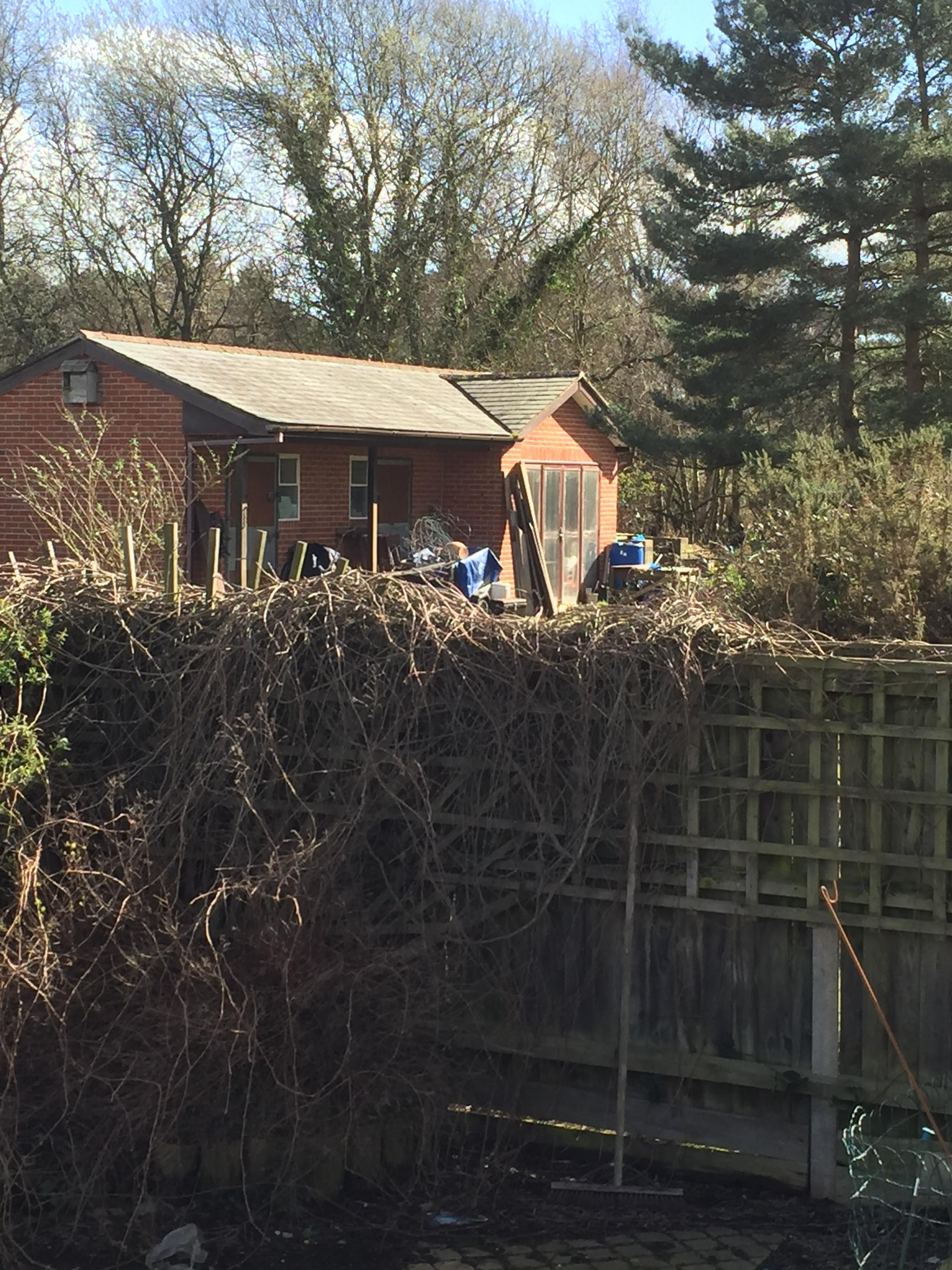

Sue B Posted March 19, 2019 Posted March 19, 2019 I know where we are is unusual but this picture is of the “stable” next door to us. The owner of the land next door has just died and his nieces and nephews are all fighting over the land. They all have dreams of selling in the land for a huge profit because of the potential self build possibilities. A neighbour further up had a small parcel of land next to them up for sale. They would listen to all the potential buyers visiting the site, planning where the house would sit, where the garden shed would go etc.etc. Neither plot will allow anyone to live on it. Anyone looking at the stable next door would just assume that it could be replaced with a nice house. Planner just say no.

Danny68 Posted March 19, 2019 Author Posted March 19, 2019 Maybe I'm taking too much on perceived logic and trust, but the fact it's had oil (old tank in place) at one time and now has a Worcester Bosch gas boiler and even a small extension on the building plus 2 chimney stacks made me believe it wasn't an issue of letting me rebuild but more a case of how big I would be allowed (not that I want a mansion). The funny thing is the place resembles a scrap yard in many places and I'm quite prepared and looking forward to declutter the place and bring the land back to its natural habitat
Sue B Posted March 19, 2019 Posted March 19, 2019 (edited) I’m giving you worst case scenario and the scrap scenario is probably more of a concern as it could indicate just who has owned the plot in the past if you get my drift - building a house and living in it without the required permissions would be common in my experience locally. Hence us all telling you to ask the local planners - albeit without too much information given out. Edited March 19, 2019 by Sue B
