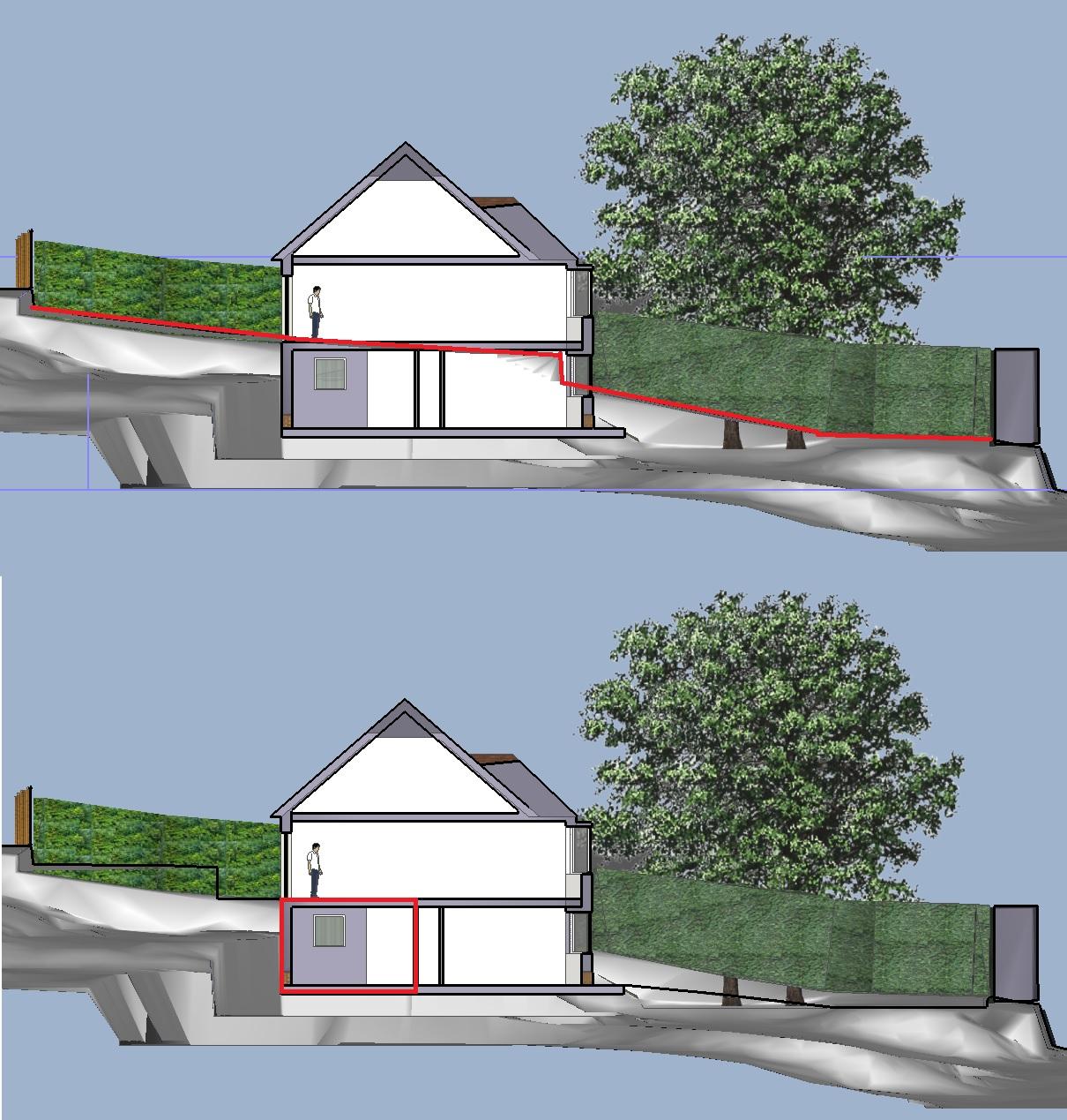

Moonshine Posted March 15, 2019 Posted March 15, 2019 (edited) I am looking to develop a plot on a sloping site, with the rear garden level a level (first) above the entrance at the front (ground), so about 3m difference. Working on a hypothetical depth of the house being 8 metres, I am trying to work out it it's worth excavating the full 8m back or going a fixed distance in at ground level, e.g. 4-5m. The pros being that it increases the habitable space and may make the construction more straight forward, with the retaining wall tying up with the line of the rear external wall. The con's are the cost increases in excavation, retaining wall and build cost The site will need a fair bit of excavating anyway so it's may only be a relatively small increase in cost. Based on a 8 m wide house it would be about 96m3 extra to excavate, but an increase in floor area of 32m2. I can sketch the levels and change a bit later Edited March 15, 2019 by Moonshine

Moonshine Posted March 15, 2019 Author Posted March 15, 2019 Thanks, i am aware of the increase in volume once its un-compacted. @Bitpipe are you willing to share what the associated cost involved were, to use as a yard stick? The existing site level is the red in the top figure below, and area i am thinking about is red in the bottom one
Bitpipe Posted March 15, 2019 Posted March 15, 2019 In 2015 it was about £35/m3 for the muck away - some gave a volume calc as it was in the ground and some used the out of ground value (x2)
