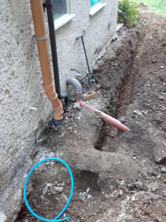

Outside the bathroom the mixture of soil and waste pipes is a complete mess. Already partially dug up due to the water leak I decided to make a start to sort it once and for all. So.....up came the concrete path that filled 7/8 jumbo bags!
At the mo it's multiple, different colour 110mm pipes & fittings connecting into a clay pipe system underground. First off I need to drill a hole through the cavity wall to connect the soil run from the wall mount wc:
So a bit of trimming of the stud wall inside. I'll probably trim enough that I can get a start with a core drill then drill right through with a pilot. Then do one leaf from inside and the other from the outside. I need to tee into this (brown) vertical stack that's all being replaced:

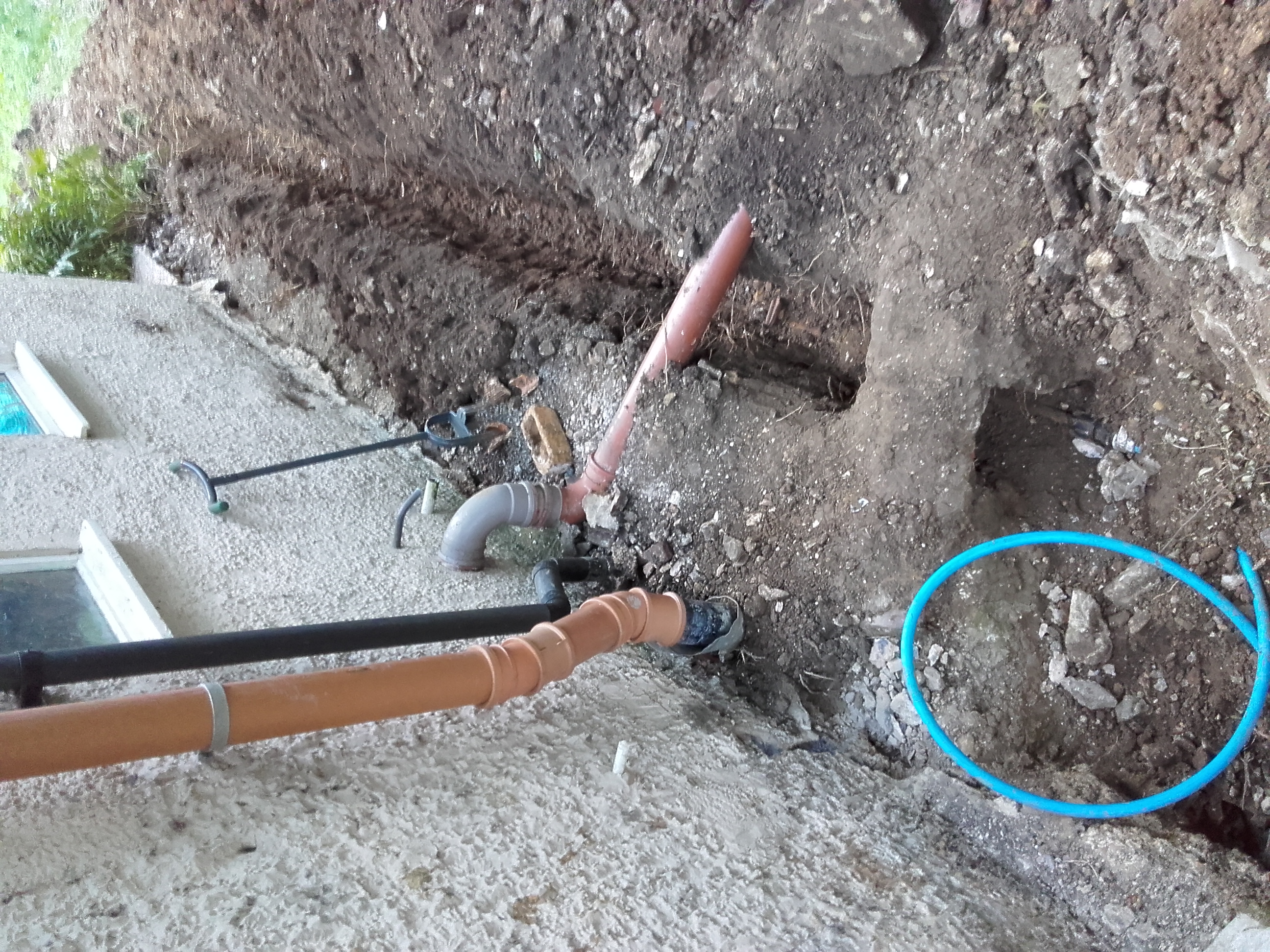

The horrible, barely below the surface, brown soil pipe from the, in use, downstairs wc will be brought into this new stack, crossing where the black drain pipe from the gutter is now.
The black drain pipe will be moved. Tbh I don't even know where it goes at the mo (probably into the soil system) but the trench in the picture will take it to a soakaway.

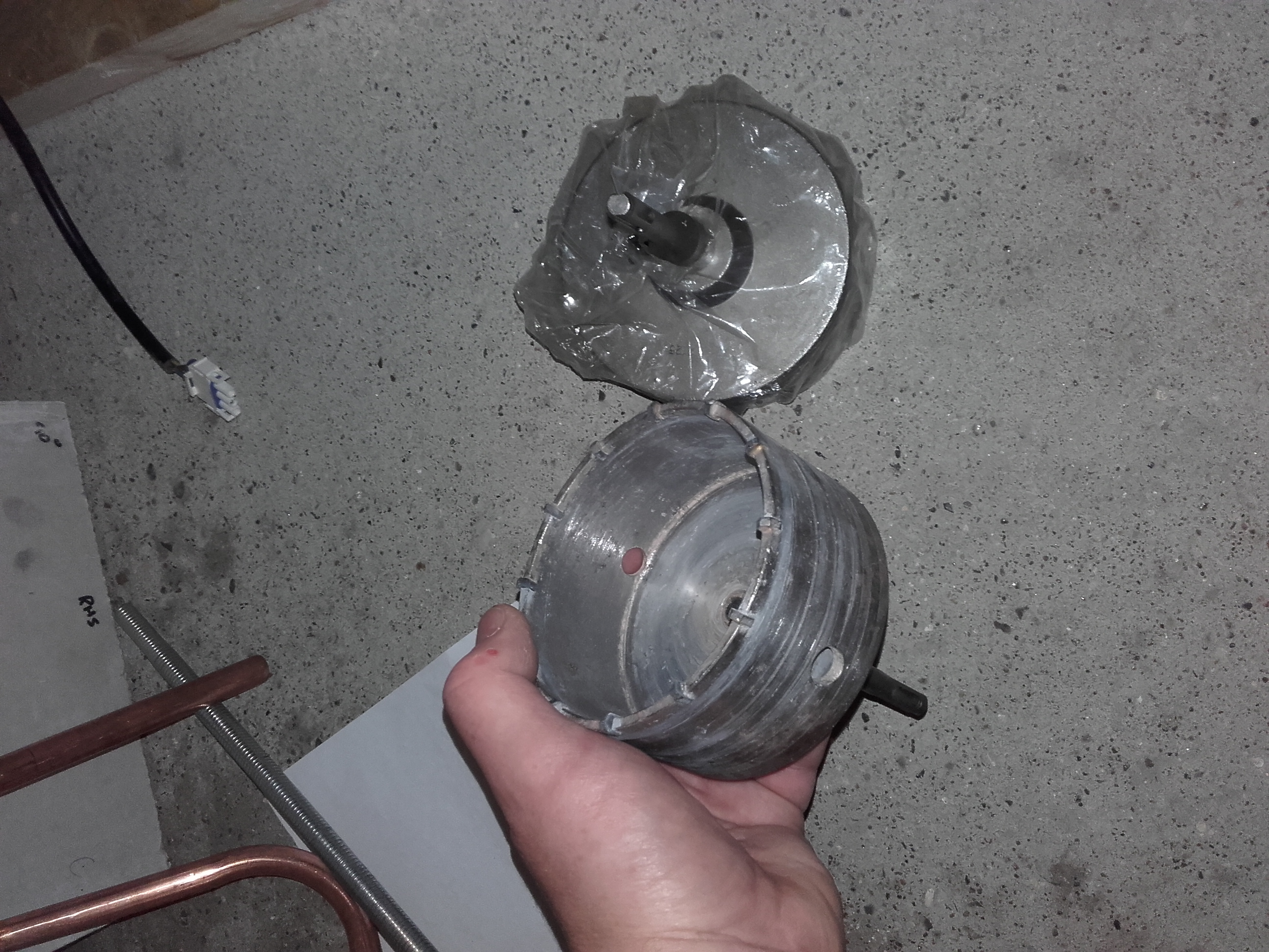

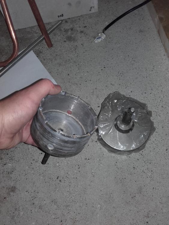

Pretty much where the brown stack kinks at the bottom is where I need to drill to line up with the first picture. I've only got these:
For the 110mm pipe should I use the 110mm drill then curse when I can't  quite get the angle or the 125mm drill and fill round the pipe.....or the 110 on the inside and 125 outside?

125mm all the way - it's only going to give you 7mm wriggle room
all round which isn't much.

Sds drills aren't supposed to be used for core drilling ;)  That's a recipe for a dead drill. Ask me how many I've done in because I was too lazy to set up my diamond drill. ¬¬. Better still......don't.
Why are you using a TCT core drill bit instead of diamond? And @PeterW, that TCT drill 100% requires hammer action, that's how it works. The drill for coring out with a TCT bit needs to be a slow turning low geared drill with a heavy hammer action. A standard sds drill will be too fast and not hard enough on the hammer. Ask your hire centre and they'll recommend a drill to suit.
Get extension bars and drill from one side only. If you try and join up from inside out, even with a pilot, you'll be surprised at how far out it'll be. Trying to re-align / ream that right is pure punishment and a royal pita, again, ask me how I know.
Fwiw I'd just hire a good diamond ( not TCT core ) bit and accompanying diamond drill set and it'll fly through in one clean operation. If your sds is slipping now, it'll be in the bin at the end of this job.

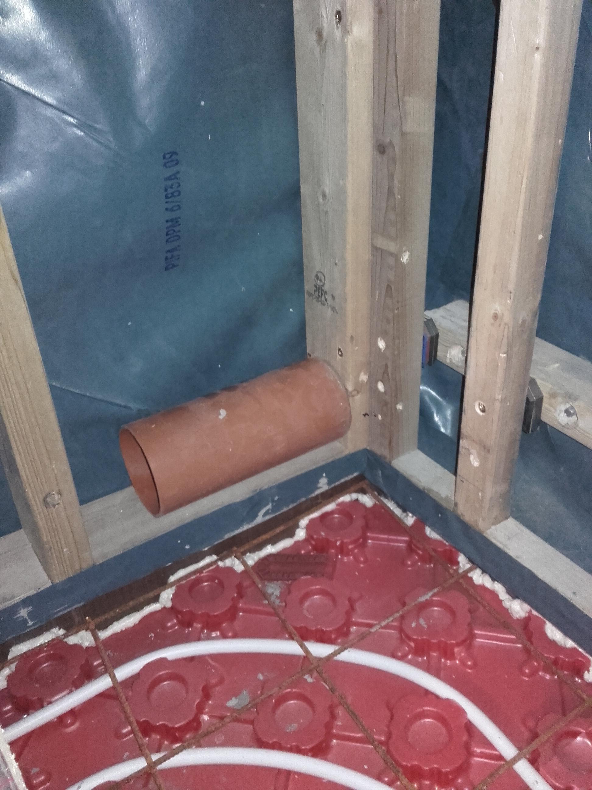

Cheapo 125mm cutter did the job:
2016-08-29_08-09-47
2016-08-29_08-09-19
Temporarily blocked up for now.
