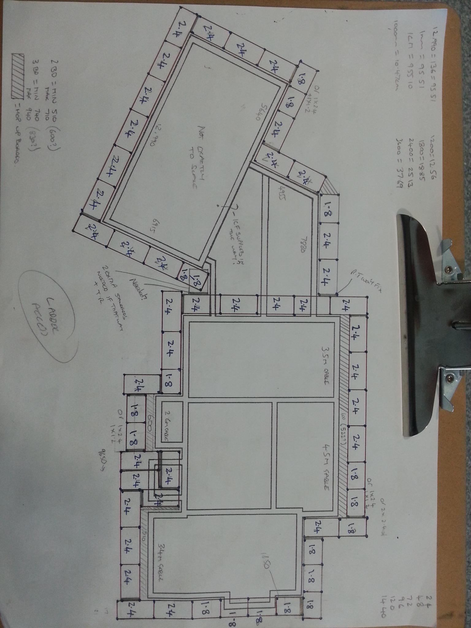

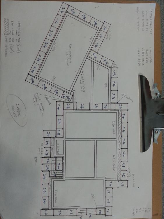

Vijay Posted May 2, 2019 Author Posted May 2, 2019 (edited) Finally got some sort of plan drawn out. Any comments before I work out totals of each item I need? Edited May 2, 2019 by Vijay
Vijay Posted May 7, 2019 Author Posted May 7, 2019 Where I have a lift of say 6970, which I would be using 1 x 9'9" and 2 x 6'6" standards, would I use 4 transoms, one at the bottom, one at the top and 1 between each standard joint?
ProDave Posted May 7, 2019 Posted May 7, 2019 6 minutes ago, Vijay said: Where I have a lift of say 6970, which I would be using 1 x 9'9" and 2 x 6'6" standards, would I use 4 transoms, one at the bottom, one at the top and 1 between each standard joint? I use 1 transom per lift, i.e every 4 pegs up the standard. More if you want proper handrails at every lift so one transom every 2 pegs all the way up. Arguable even more if you have dual handrails.
Vijay Posted May 7, 2019 Author Posted May 7, 2019 so no matter what lengths of standard, you have 1 transom (and I assume ledger?) every 4 pegs, so approx every 1.8m? I wasn't planning on using handrails anywhere but my working platforms
ProDave Posted May 7, 2019 Posted May 7, 2019 6 minutes ago, Vijay said: so no matter what lengths of standard, you have 1 transom (and I assume ledger?) every 4 pegs, so approx every 1.8m? I wasn't planning on using handrails anywhere but my working platforms You have to build it up somehow. So you put a layer of planks on, then working from that put the next layer on 4 pegs up. Even if the lower ones don't end up as working platforms you still need them temporarily to work from even if those planks then get moved up to the next level as you go.
Vijay Posted May 7, 2019 Author Posted May 7, 2019 OK, makes sense about needing to work off the platform to do the one above. So the ledgers and transoms get left in place as you go up and you just move the boards up each level So is the every 4 pegs you mentioned your personal preference or the safe limit (so the structure is safe) for the ledgers and transoms?
ProDave Posted May 7, 2019 Posted May 7, 2019 Yes I leave the metalwork for lower levels in place (unless I am running really short) 4 pegs is as high as I can lift the planks up to the next layer without standing on anything, that is the only reason I say that. If you are really tall you might just make 5.
