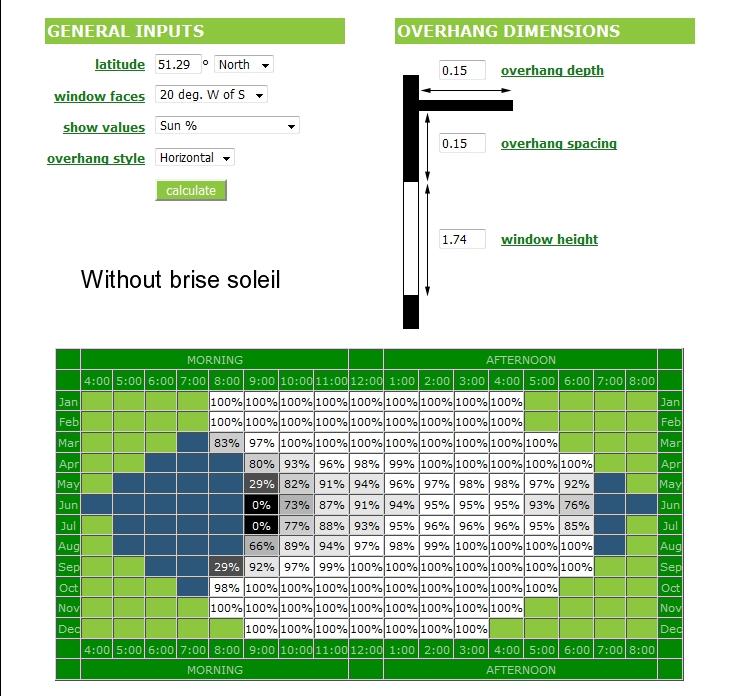

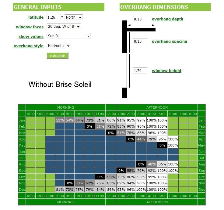

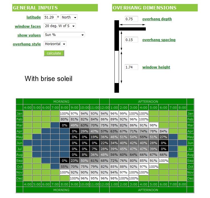

Before we move into our house last year I had designed a brise soleil to shade our lift slide doors which are the only south facing glazing we have. Needless to say I never actually made it and having lived in the house for the first summer and now winter I’m not sure it’s needed. We had a nice lot of solar gain recently which meant there was no heating on in the house. IIRC last summer the sun only penetrated around 600mm into the room on the floor. I’ve run the software linked to by @Cambs and results suggest I would lose too much solar gain when I need it from October to February. Any comments? The doors are shaded completely before 12.00.

I think the key bit is that the doors are shaded by midday.  I've found that most of the solar gain through our overhead shaded front glazing is from around 11:00 to about 15:00.  From the  data above I'd say that it looks very much as if you don't really need the brise soleil.

Have you missed the 5 for fifty when entering the latitude?
Edit: The latitude of Canterbury is 51.2802° N

Posted (edited)
Isn't that longitude. I think the North refers to hemisphere. No you're right it should be 51.292297.

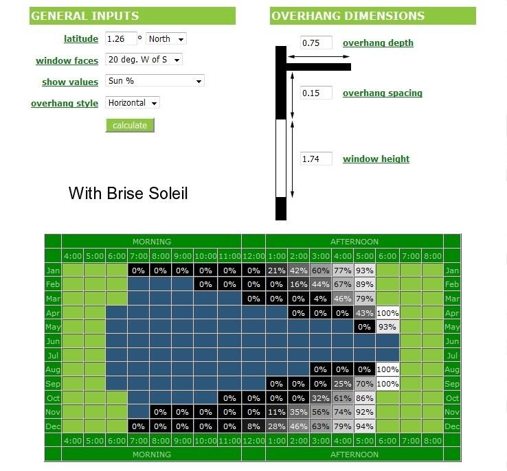

Well having the correct data makes all the difference. Thanks @epsilonGreedy that'll teach me to cut and paste without checking. Wendy won't be happy but it looks like we will need one after all. It now looks more like I expected it to.

Posted
Pretty sure it wants latitude to calculate the elevation of the sun for each hour per month. You would then need to fiddle the numbers for your local noon which is a small adjustment, about 5 minutes I guesstimate for your part of Kent.
