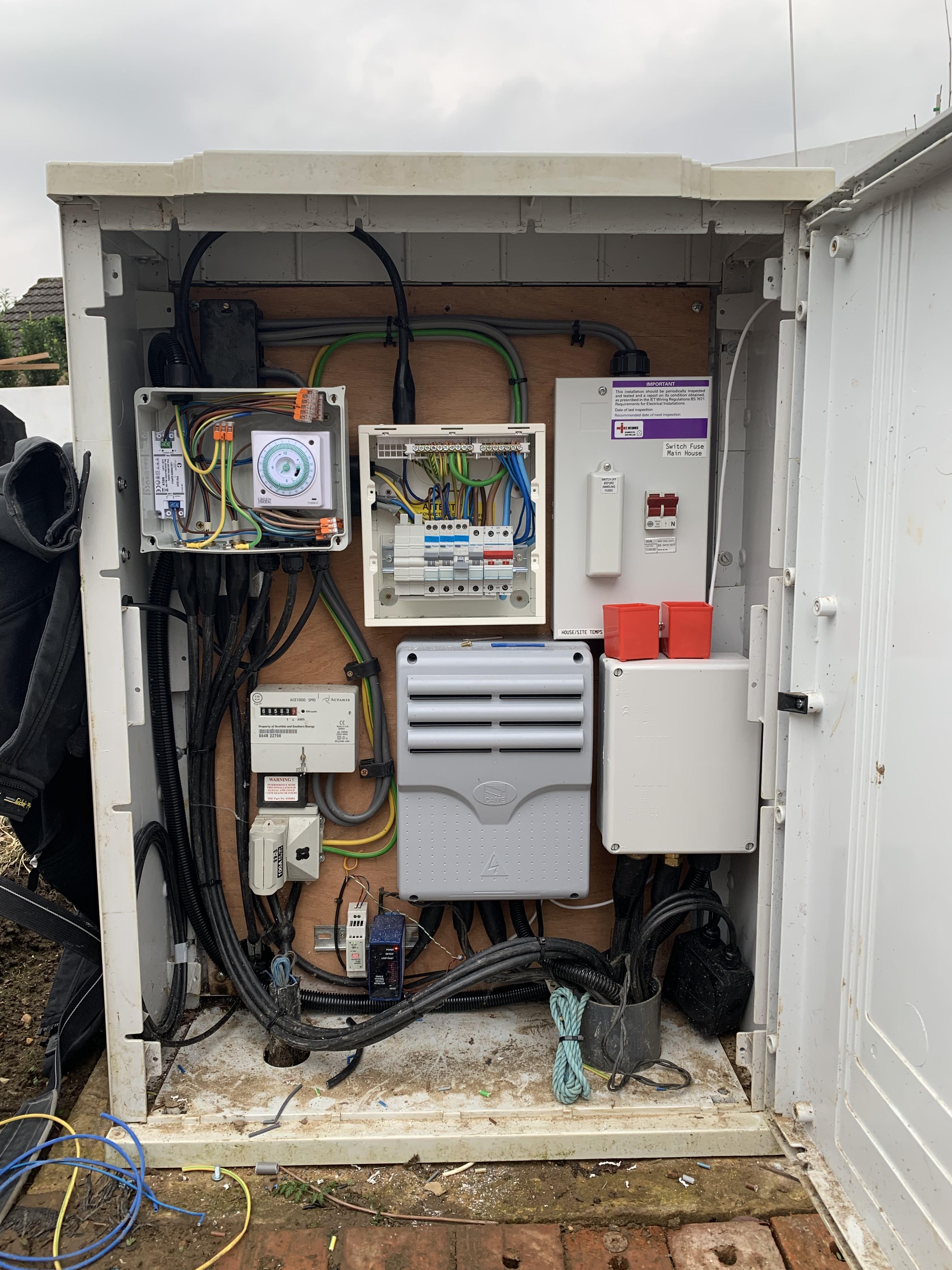

Bitpipe Posted March 1, 2019 Share Posted March 1, 2019 (edited) Our beloved sparky has been doing the last few jobs and is finishing up where he started, in the garden kiosk which he installed on October 2014! It's probably not in the ideal location but has survived the whole build process of demolition, heavy plant, deliveries, landscaping and felling of a nearby tree. The kiosk now contains incoming mains supply, company fuse, meter, switched supply to house, garage and garden sockets (was temps to caravan and site office) main gate controls, driveway lighting, wall lighting and supply to secondary gate controls. Very tragically there is no room for a smart meter Seems a shame to put covers on the boxes and close the door on it! Might explore making it completely see through and light it from inside, like those funky gaming PCs ... Edited March 1, 2019 by Bitpipe 1 Link to comment Share on other sites More sharing options...
Barney12 Posted March 1, 2019 Share Posted March 1, 2019 Whats the vented grey box pretty much central? Shame about the SMART meter Link to comment Share on other sites More sharing options...
Mr Punter Posted March 1, 2019 Share Posted March 1, 2019 Automatic gate controls I think. There is still some room for some more stuff if you pack it tightly. Maybe some ethernet stuff or CCTV? At least a couple of double sockets, just in case. Link to comment Share on other sites More sharing options...
Bitpipe Posted March 1, 2019 Author Share Posted March 1, 2019 Yes, grey box is a Came gate controller. External socket is going on wall so kiosk doesn’t need to be opened to use it. Cctv was the one thing i never really make provision for - kind of wish I’d pulled an additional few cat 6 between house and kiosk - the one that’s there is for the intercom and gate controls. Link to comment Share on other sites More sharing options...
ToughButterCup Posted March 1, 2019 Share Posted March 1, 2019 3 hours ago, Bitpipe said: [...] Might explore making it completely see through and light it from inside, like those funky gaming PCs ... Ahhhh, that'll be it: fill the thing with water and light it with purple LEDs. Stick a humongous heat sink in it (22mm copper pipe) . Keep tropical fish in it while yer at it. (Like one of my more zany students did) Top idea! Link to comment Share on other sites More sharing options...
Onoff Posted March 1, 2019 Share Posted March 1, 2019 Are you missing a seal (s) on that head fuse? Link to comment Share on other sites More sharing options...
Bitpipe Posted March 1, 2019 Author Share Posted March 1, 2019 1 hour ago, Onoff said: Are you missing a seal (s) on that head fuse? I have no idea. Will ask sparky on Monday. Link to comment Share on other sites More sharing options...

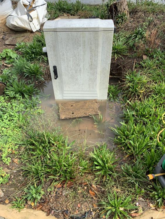

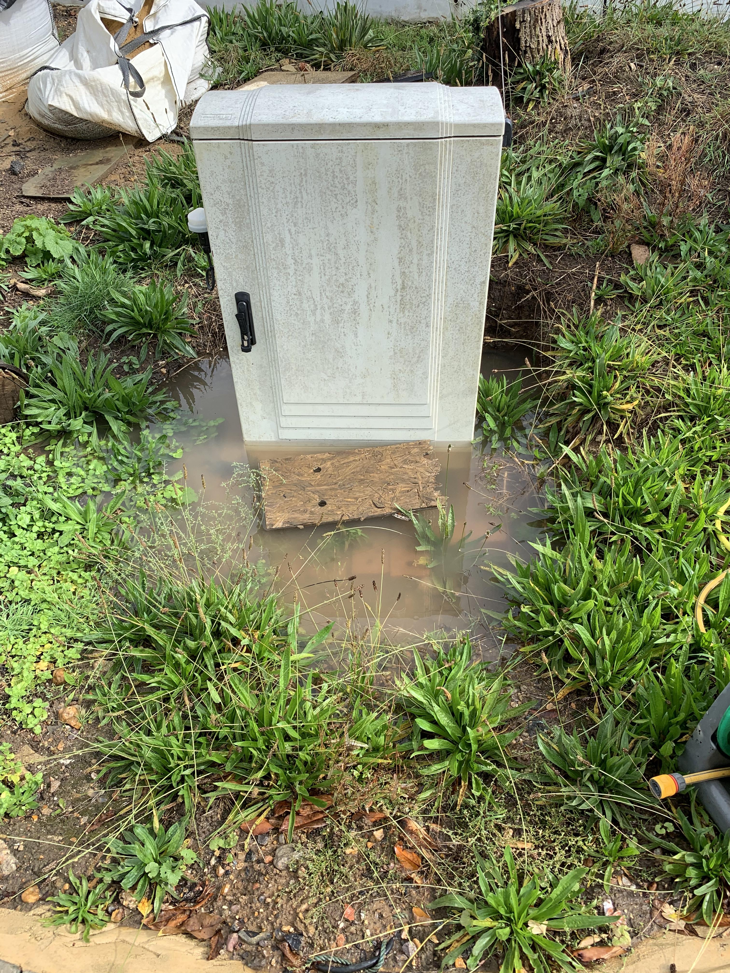

Bitpipe Posted September 24, 2019 Author Share Posted September 24, 2019 Eek.. It’s dissipated now but rain has been torrential all day - even porus resin driveway was flooding. Will need to move the gate induction loop unit up a bit as it has a 240-12v transformer next to it, don’t want that getting wet. Everything else should be well out of the way. Link to comment Share on other sites More sharing options...
Jeremy Harris Posted September 24, 2019 Share Posted September 24, 2019 Ooops! That's a bit of a bugger. Makes me glad I decided to stick ours fairly high up in a fence. Had our very good landscaping chap back around yesterday (who happens to have just started a Class Q self-build), as we want to put in a pond and some more raised beds. When I looked out our bedroom window this morning it looked like we already had a pond pretty much exactly where we are getting one put in... Link to comment Share on other sites More sharing options...
Bitpipe Posted September 24, 2019 Author Share Posted September 24, 2019 Problem is just behind it we have a soak away for a street gully which was overflowing so that didn’t help. Link to comment Share on other sites More sharing options...
