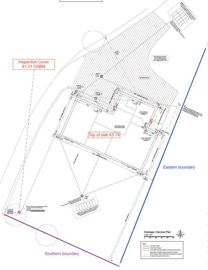

Russdl Posted February 20, 2019 Posted February 20, 2019 (edited) Is this simple or complicated, can someone put me straight? We have a relatively level site, dropping 1.2m over 51m from north to south. Our southern boundary is a neighbours fence and our eastern boundary is an easily defined straight line. I know the elevation of the inspection chamber cover in the south west corner of the plot, 61.31m, and the top of slab, 61.74m As we are having an MBC foundation (which we expect to be of fairly standard depth) I'm going to need a hole 600mm below the top of the slab, and covering the footprint of the building (T shaped) plus 1m all around. To my mind, and in my particular circumstances, it looks like it's going to be fairly straight forward to do that. (15m and a bit from the souther boundary, 1m and a bit from the eastern boundary and dug out to 170mm below the level of the inspection chamber cover. Is there more to it than that? Edited February 20, 2019 by Russdl Had my maths homework marked and got 2/10
Mr Punter Posted February 20, 2019 Posted February 20, 2019 I make it 170mm dig down from the IC cover (but 15mm wont make much difference).
Russdl Posted February 20, 2019 Author Posted February 20, 2019 8 minutes ago, Mr Punter said: I make it 170mm dig down from the IC cover (but 15mm wont make much difference). ? It clearly is complicated then if I can't even do some basic maths! I'll edit that, thanks.
TerryE Posted February 20, 2019 Posted February 20, 2019 (edited) IMO, a key point is to dig / concrete in some datum posts near the perimeter of the site and well outside the area where your groundworks team is going to be using plant; also preferably where you have clear line of sight to the entire slab area. If you have 3 of these to form a reference baseline then you can easily triangulate the corners (and retriangulate as needed) and recover accurate levels if you have a Dumpy or equiv. Edited February 20, 2019 by TerryE 2

Russdl Posted February 20, 2019 Author Posted February 20, 2019 2 hours ago, JSHarris said: I established two fixed datum points, one was a handy OS spot height nail I remember reading about that in your blog Jeremy, my survey is referenced to a spot heigh at the nearby church. The IC cover I have on the plot is permanent fixture for the time being and so I was considering that my 'nail'. 3 hours ago, TerryE said: IMO, a key point is to dig / concrete in some datum posts near the perimeter of the site and well outside the area where your groundworks team is going to be using plant; also preferably where you have clear line of sight to the entire slab area. I have space to do that, great idea. 2 hours ago, JSHarris said: These proved invaluable when doing the cross checks to ensure that the base for the slab was in the right place and that the ducts, pipes etc were all coming up in exactly the right places. I presume that means you had all the drains etc in position prior to MBC arriving and starting the slab? For me MBC will: "install all pipes and ducts to a distance of 1 metre from the edge of the foundation slab – leaving you and your groundwork contractor to connect onwards." Am I right in thinking that's different to what happened in your build?
Jeremy Harris Posted February 20, 2019 Posted February 20, 2019 4 minutes ago, Russdl said: I presume that means you had all the drains etc in position prior to MBC arriving and starting the slab? For me MBC will: "install all pipes and ducts to a distance of 1 metre from the edge of the foundation slab – leaving you and your groundwork contractor to connect onwards." Am I right in thinking that's different to what happened in your build? Yes, that's different to us. I agreed to lay the sub-base and put in drains, ducts etc, MBC then blinded that. levelled and compacted everything and installed the slab. If they do the drains, ducts, sub-base etc then that removes the risk of them being in the wrong place, so it's a good move, IMHO, and takes even more risk out of things.
Russdl Posted February 20, 2019 Author Posted February 20, 2019 15 minutes ago, JSHarris said: and takes even more risk out of things. That was what I was thinking. It seems that for me it's going to be really straight forward but just the fact that I'm thinking that makes me nervous that I've missed something really obvious that will bite me in the backside on 'D' day. I'm planning to just have the hole dug and nothing else so that MBC can put the slab in it and then, after the slab is in, and MBC have left for a couple of weeks start connecting drains and services to the "pipes and ducts" they've left behind.

TerryE Posted February 21, 2019 Posted February 21, 2019 (edited) @Russdl make sure that you have a very clear agreement with your TF supplier who is responsible for what when it comes to drainage etc. Like Jeremy our agreement with Trish @ MBC was that I was responsible for the exact placement of the drains, not MBC -- though they did provide the labour. The process that we agreed was that they laid the sub base layers and binding sand layer and the EPS perimeter -- which I then surveyed to validate levels, trueness, etc. MBC had previously sent me the AUTOCAD files, and I used a free autocad viewer to take distances and X,Y positions of the foulwater risers, etc. so that we could position these to the nearest cm or so. As with Jeremy this saved a lot of grief after the frame was up because the risers were correctly positioned relative to the frame. We cut the drain runs in, checked the flow rates with a bucket test and then made good and completed the EPS former. You might consider another trick that @Stones did which was to terminate all of his risers with a female fitting about 1-2cm below the slab finished level. (See his blog.) This allowed the slab crew to power-float over the top of them. It was then a simple matter to go around a day later when the slab was still green and chip off this 2cm layer, exposing the female coupler. We used a few 110mm runs as access pipe to thread water etc. into the service cupboard. This is also a good idea, but if you do this then consider using slow bends or even slow 45° bends to bring these up into the slab -- it's a damn sight easier pulling 25mm MDPE round a slow bend!! Edited February 21, 2019 by TerryE 1
Russdl Posted February 21, 2019 Author Posted February 21, 2019 @TerryE thank you for all that Terry, I'll definitely pin down exactly what is and isn't going to be done by MBC. I recall reading @Stones's comments re the female fitting on top of the risers, a good idea. 9 hours ago, TerryE said: We used a few 110mm runs as access pipe to thread water etc. into the service cupboard. This is also a good idea, but if you do this then consider using slow bends or even slow 45° bends to bring these up into the slab -- it's a damn sight easier pulling 25mm MDPE round a slow bend!! That is definitely on the 'to-do' list, and maybe 3 of them - 1 for water (in and out), 1 for electric (in and out, bt etc), and 1 for last minute changes of plan! As it stands we don't have an ASHP in the scheme - it was going to be Sunamps all the way but my confidence in that plan is being dented in light of recent developments.
