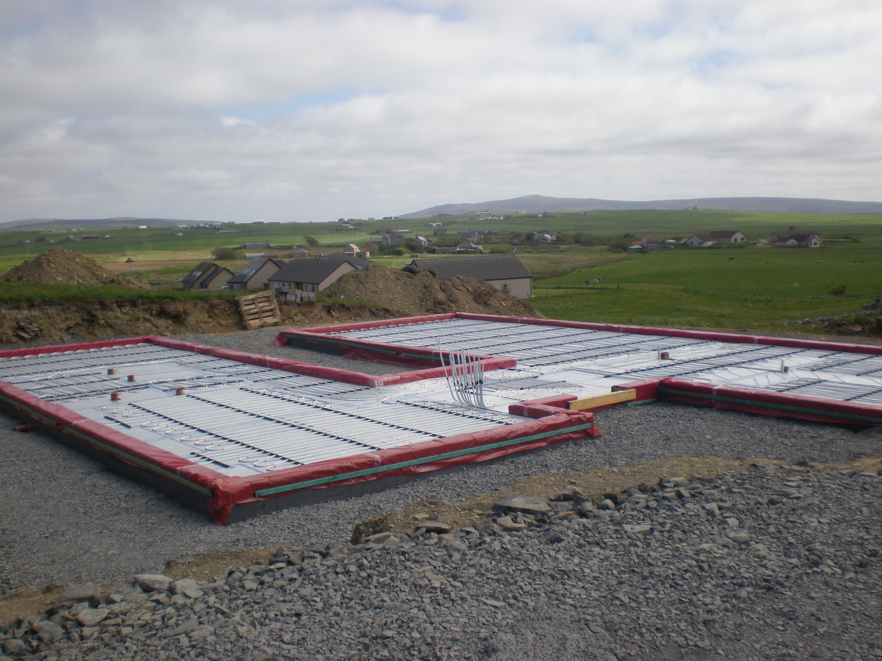

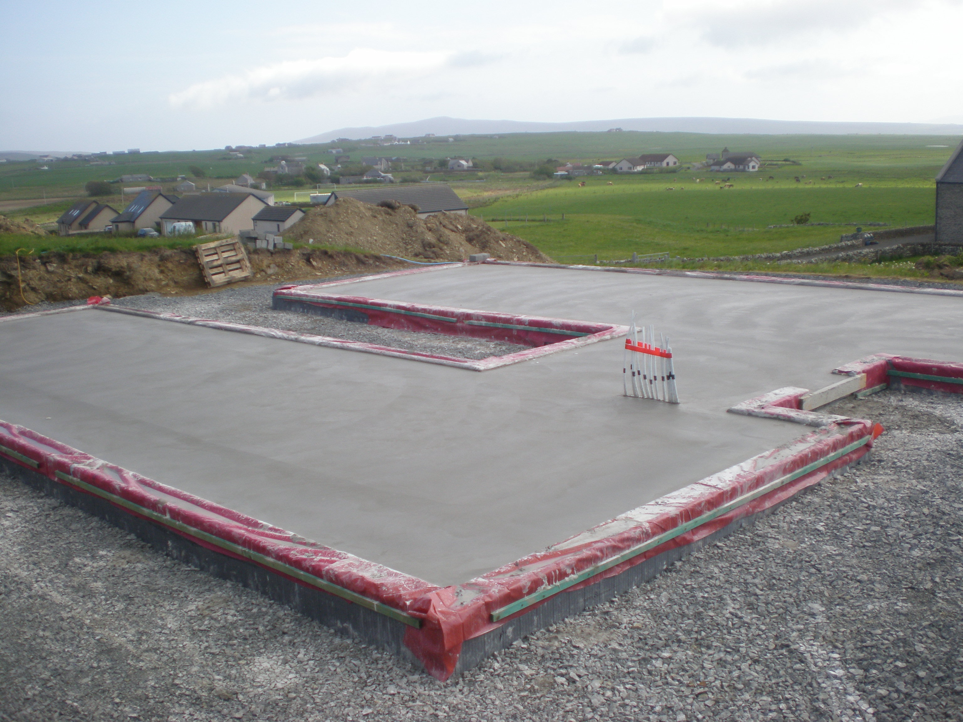

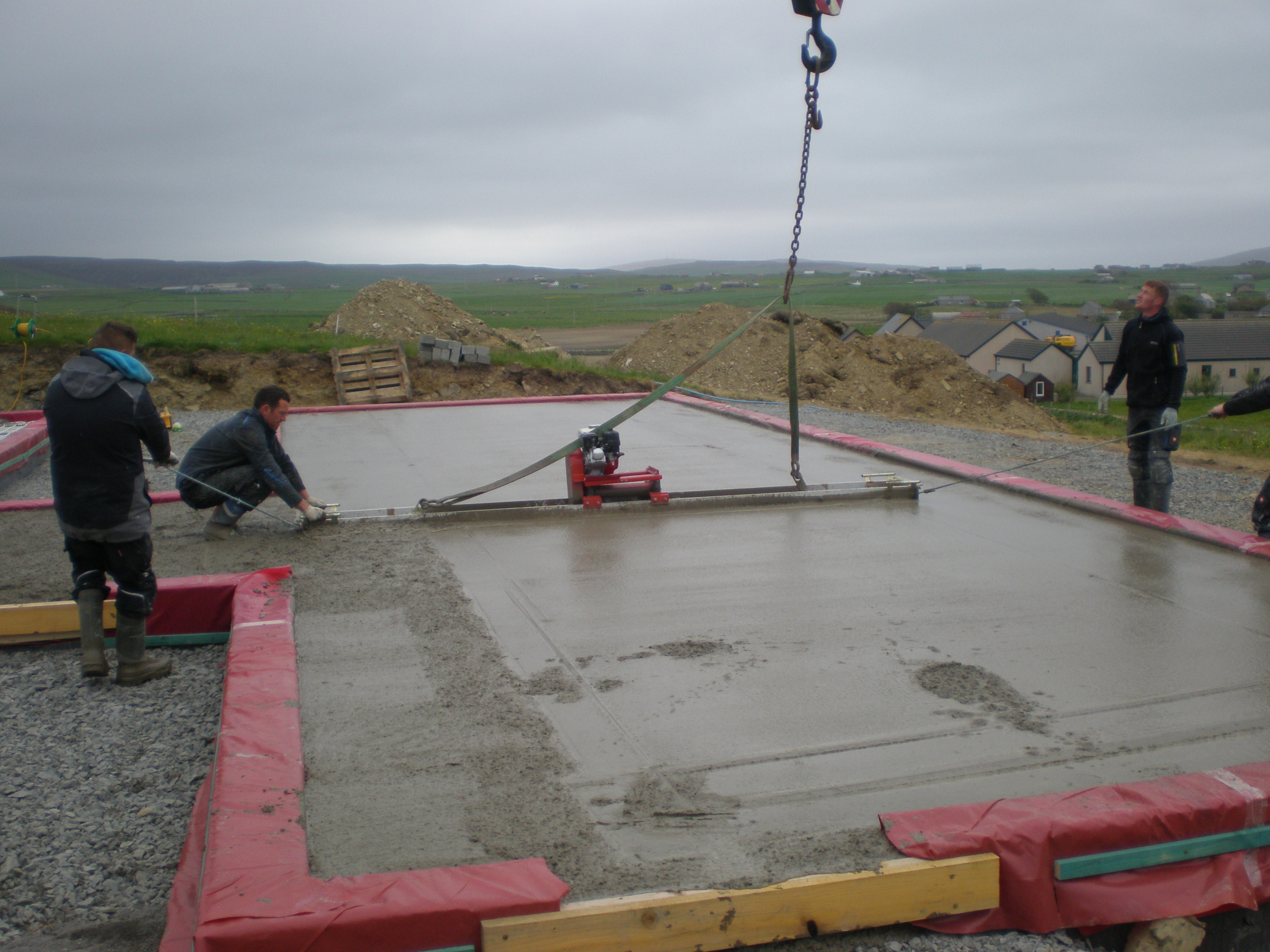

TerryE Posted August 16, 2016 Share Posted August 16, 2016 (edited) OK, right or wrong, here is what we did. I cut a 50mm channel in the EPS300 perimeter at our 4 Internorm door openings (2 conventional doors and 2 tilt and open double french doors) I also attached an extra 45×50×<door width> shuttering the outside to extend this as a tongue out into the airgap. This was rebared and poured and levelled as part of the MBC base pour. We also used OSB3 (though in retrospect I would recommend marine ply to others) boxing on top and sides of the door openings to bring the line of the doors (and windows) 45mm out in front of the frame and close the airgap. We allowed for this framing in our MBC opening calcs as you need to add this plus10-15mm filling gap to the the frame sizes to get the MBC openings right. The frames sit behind the stone skin. The bulk of the weight of the doors and frame is carried by steel straps attached to the framing box, but the foam filler and silicon also carry the load into the boxing frame. The Internorm doorframes sit on a 30mm high spacer (that ecoHaus provide as standard) and this sits on the concrete tongue. We have a stone skin that is ~150mm and I've used Perinsul load bearing blocks butted up to the tongue, with the top level with the slab. The actual cill is slate bedded on top of the Perinsul blocks. OK in theory the slate might touch the concrete tongue on the diagonal, but the area of the bridge is tiny, so I don't think that this will be a material issue. Edited August 16, 2016 by TerryE Link to comment Share on other sites More sharing options...

Stones Posted August 16, 2016 Share Posted August 16, 2016 1 hour ago, TerryE said: OK, right or wrong, here is what we did. I cut a 50mm channel in the EPS300 perimeter at our 4 Internorm door openings (2 conventional doors and 2 tilt and open double french doors) I also attached an extra 45×50×<door width> shuttering the outside to extend this as a tongue out into the airgap. This was rebared and poured and levelled as part of the MBC base pour. We also used OSB3 (though in retrospect I would recommend marine ply to others) boxing on top and sides of the door openings to bring the line of the doors (and windows) 45mm out in front of the frame and close the airgap. We allowed for this framing in our MBC opening calcs as you need to add this plus10-15mm filling gap to the the frame sizes to get the MBC openings right. The frames sit behind the stone skin. The bulk of the weight of the doors and frame is carried by steel straps attached to the framing box, but the foam filler and silicon also carry the load into the boxing frame. The Internorm doorframes sit on a 30mm high spacer (that ecoHaus provide as standard) and this sits on the concrete tongue. We have a stone skin that is ~150mm and I've used Perinsul load bearing blocks butted up to the tongue, with the top level with the slab. The actual cill is slate bedded on top of the Perinsul blocks. OK in theory the slate might touch the concrete tongue on the diagonal, but the area of the bridge is tiny, so I don't think that this will be a material issue. Our builder / ICF construction uses a similar strategy, extending the slab into the door way so that the door threshold has something solid to sit on. Not the best of pictures as i wasn't concentrating on this detail, but you can see how the slab extends through the ICF foundation blockwork for the door openings. You can just see in the last picture the PU upstand insulation behind the timber former so the finished opening is flush with the outer face of the ICF block External insulation still to be fitted onto the outer face of the ICF block. Link to comment Share on other sites More sharing options...
