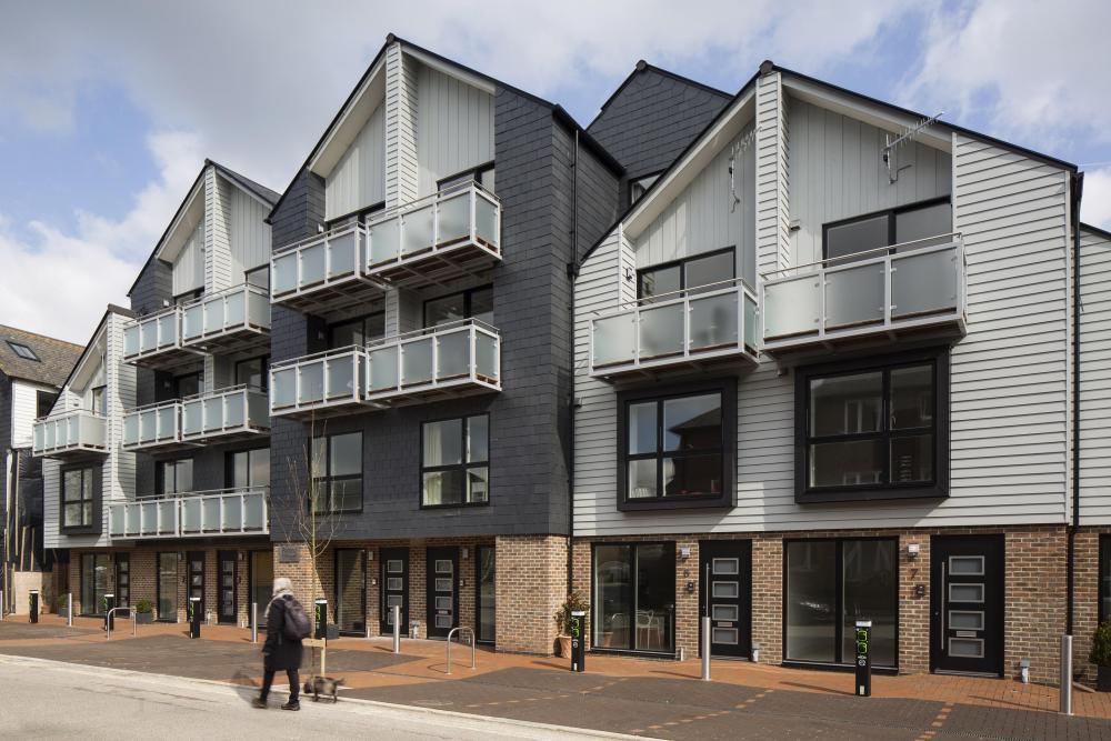

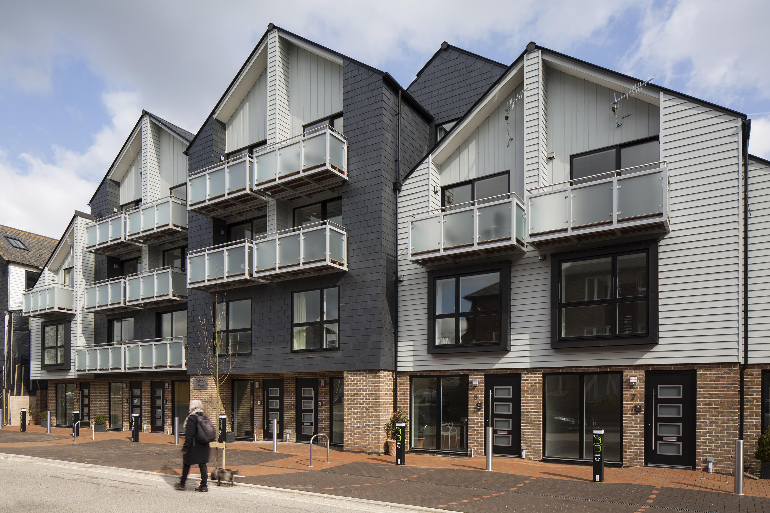

Robert Clark Posted January 23, 2019 Share Posted January 23, 2019 Have been looking online at Composite Cladding as an environmentally friendly alternative to Oak, as it’s made from recycled materials and is maintenance free. Woukd appreciate any comments or opinions on this product. Thanks Link to comment Share on other sites More sharing options...

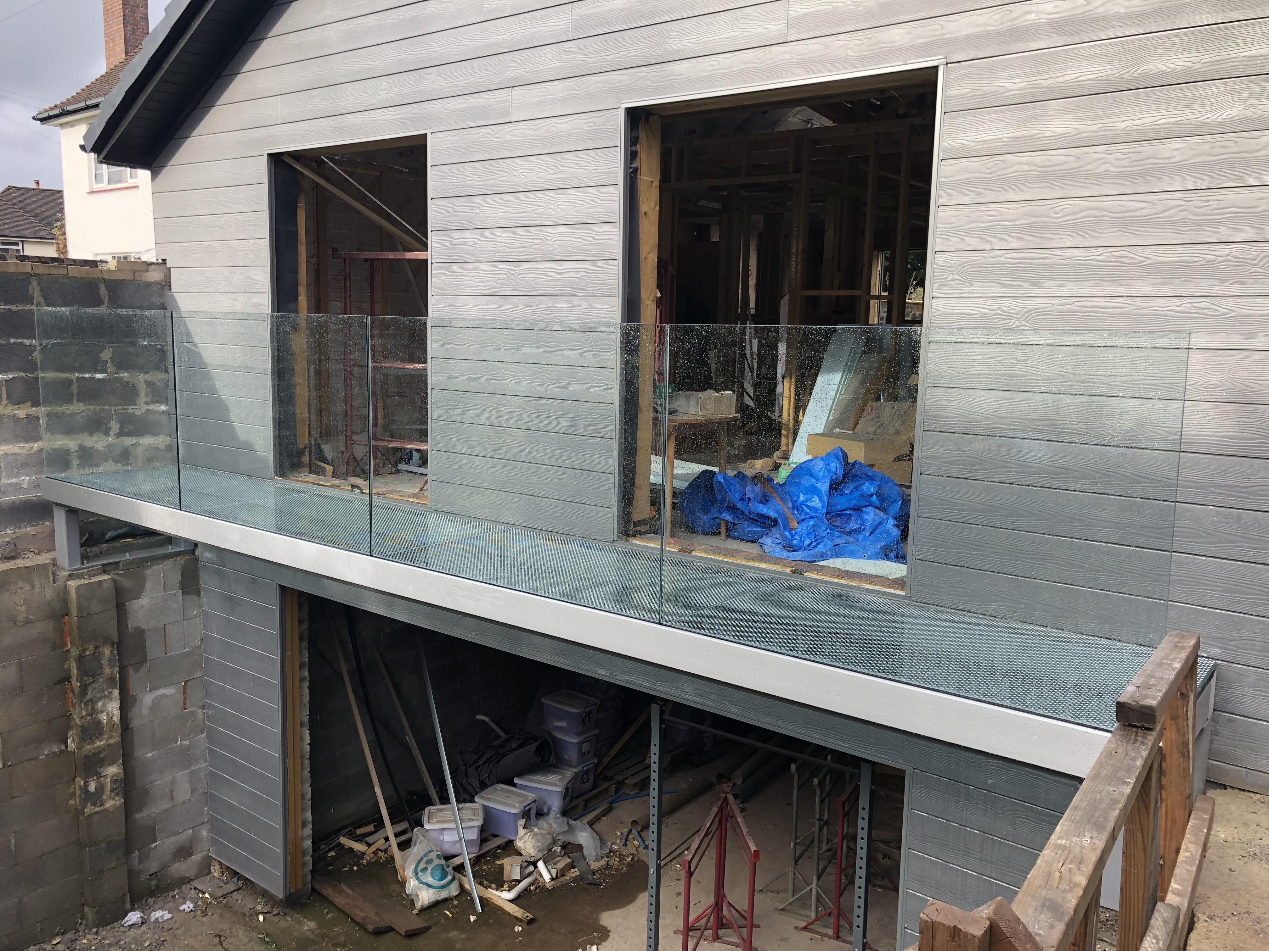

Mr Punter Posted March 4, 2019 Share Posted March 4, 2019 This is James Hardie Linea for the horizontal and HardiePlank for the vertical. It is smooth finish as I am not keen on the "woodgrain" look. Link to comment Share on other sites More sharing options...
