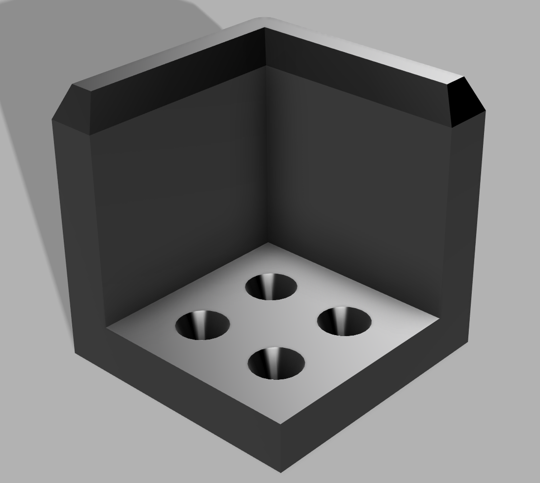

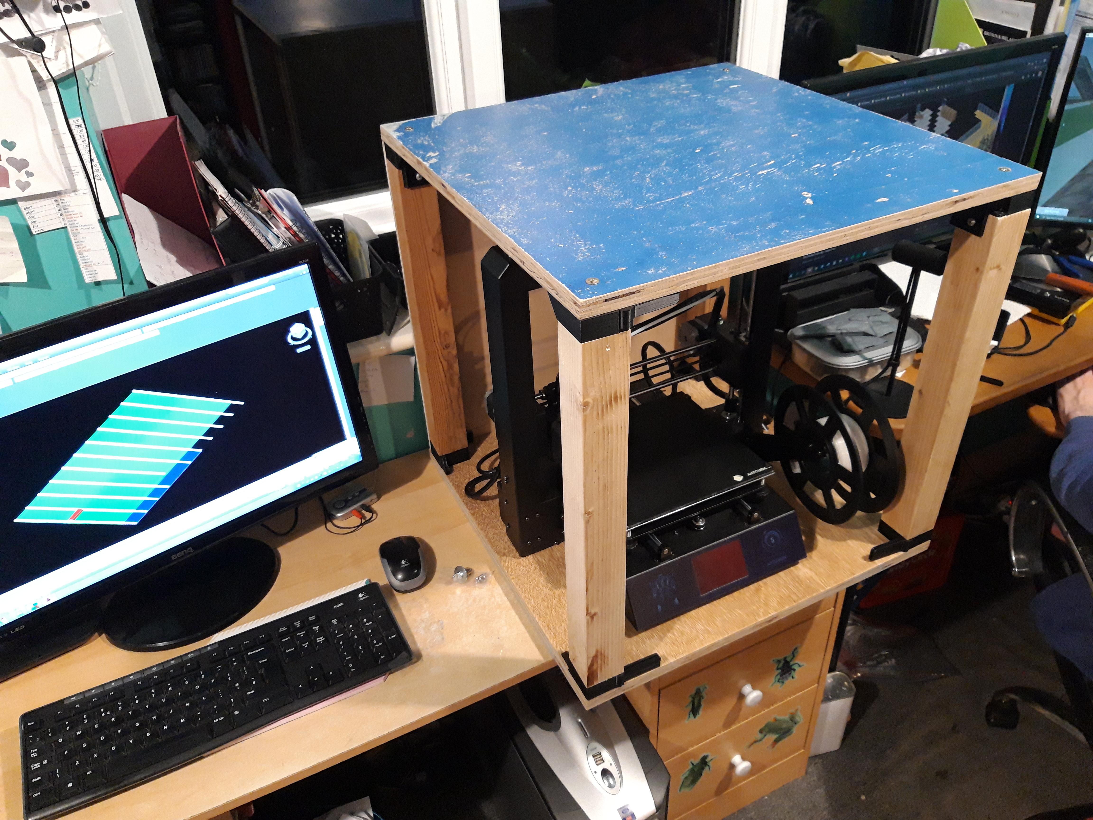

Onoff Posted May 6, 2020 Posted May 6, 2020 Scored a sheet of 2mm "perspex" today for nowt! A bit thinner than I'd like but beggars can't be etc. And ripped the start of the legs up from some scrap: Will all be sanded, filled, painted black etc. Plan is double doors on the front. Sides fully removable with wing bolts and penny washers. Just printing some "feet" up. These will be screwed to the base board and the legs will slot in allowing the whole top to be lifted off. Front feet will incorporate hinges for the front doors. The base board will hopefully become a top for a bottom storage unit on castors, later on.

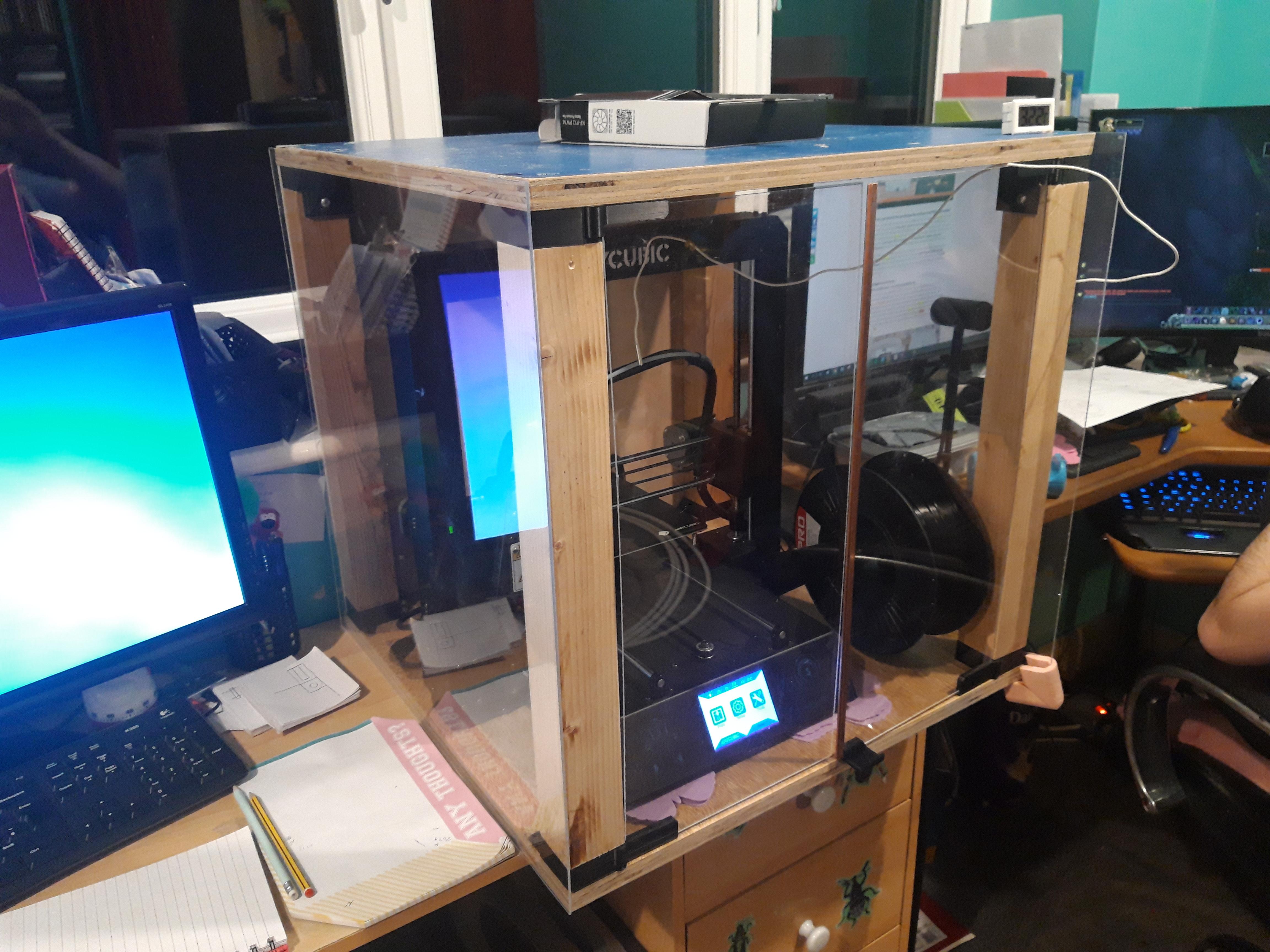

Onoff Posted May 12, 2020 Posted May 12, 2020 (edited) Something like this. Not the most flattering shot. It'll look better when sanded and painted up with it's "glass" sides and door! Who needs IKEA? ? All the wooden bits connect together with the 3D printed PLA bits at the corners OK. (Though I did break one hinge...I had had a couple). You can just see the door hinges on the front. 9mm ply sheet on the back. I'm a couple of mm out somewhere but I'll get away with it with a bit of trimming! Can't decide whether to let a clear panel into the top. A kilo of RS Pro black PLA coming tomorrow for some reprint bits. Not tried it before, it was just the quickest I could get any. Edited May 12, 2020 by Onoff

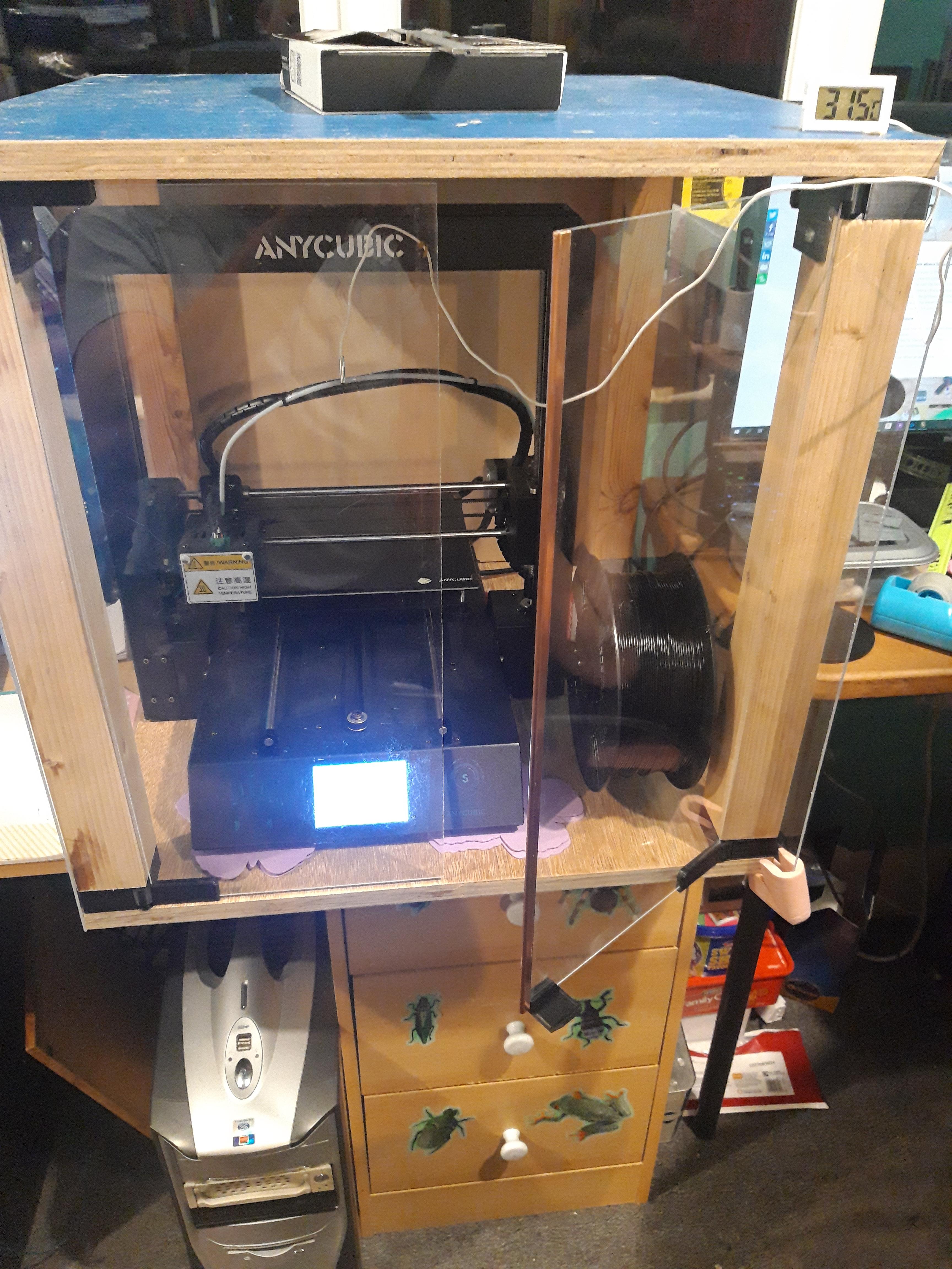

Onoff Posted May 15, 2020 Posted May 15, 2020 A bit more progress. Though you can't see them the reprinted bits are done. All joints slackened and re tightened for a better fit. Two front doors cut to size from 2mm perspex or whatever this freebie stuff is. As I feared 2mm is a bit flexible so on one door I've clipped a length of copper bus bar that fits over the edge a treat. Makes things much more rigid. Sides just stuck on with Sellotape at the mo. As a little test ran the bed up to 40degC. Using a little remote thermometer the internal temperature held at around 38degC. On the face of it that's good but when you think for ABS it needs a bed temp of like 110degC that will not be at all good for the printer's internal electronics; the psu, MOSFET board etc. Looking now to move these parts outside the enclosure. Got some blingy, wi-fi controlled, USB powered LED light strips coming for the inside. Comes with remote and can be controlled via an app. Picking up a 2G, MK USB socket to go on the back later.
Temp Posted May 15, 2020 Posted May 15, 2020 I've never tried ABS, does it need to be that hot? My printer has been running for long periods recently and I've managed to wear out the bearings in four belt idler pulleys. They aren't expensive but a pain to keep changing. Mine uses quite small 16 tooth GT2 pulleys and the bearings inside don't seem to be upto the job. I've redesigned the tensioners to use drive pulleys and separate/larger bearings.
Onoff Posted May 15, 2020 Posted May 15, 2020 44 minutes ago, Temp said: I've never tried ABS, does it need to be that hot? My printer has been running for long periods recently and I've managed to wear out the bearings in four belt idler pulleys. They aren't expensive but a pain to keep changing. Mine uses quite small 16 tooth GT2 pulleys and the bearings inside don't seem to be upto the job. I've redesigned the tensioners to use drive pulleys and separate/larger bearings. Yes, for ABS, bed at around 110degC. They reckon even with fan exhaust the internal enclosure temperature can reach 45degC.
