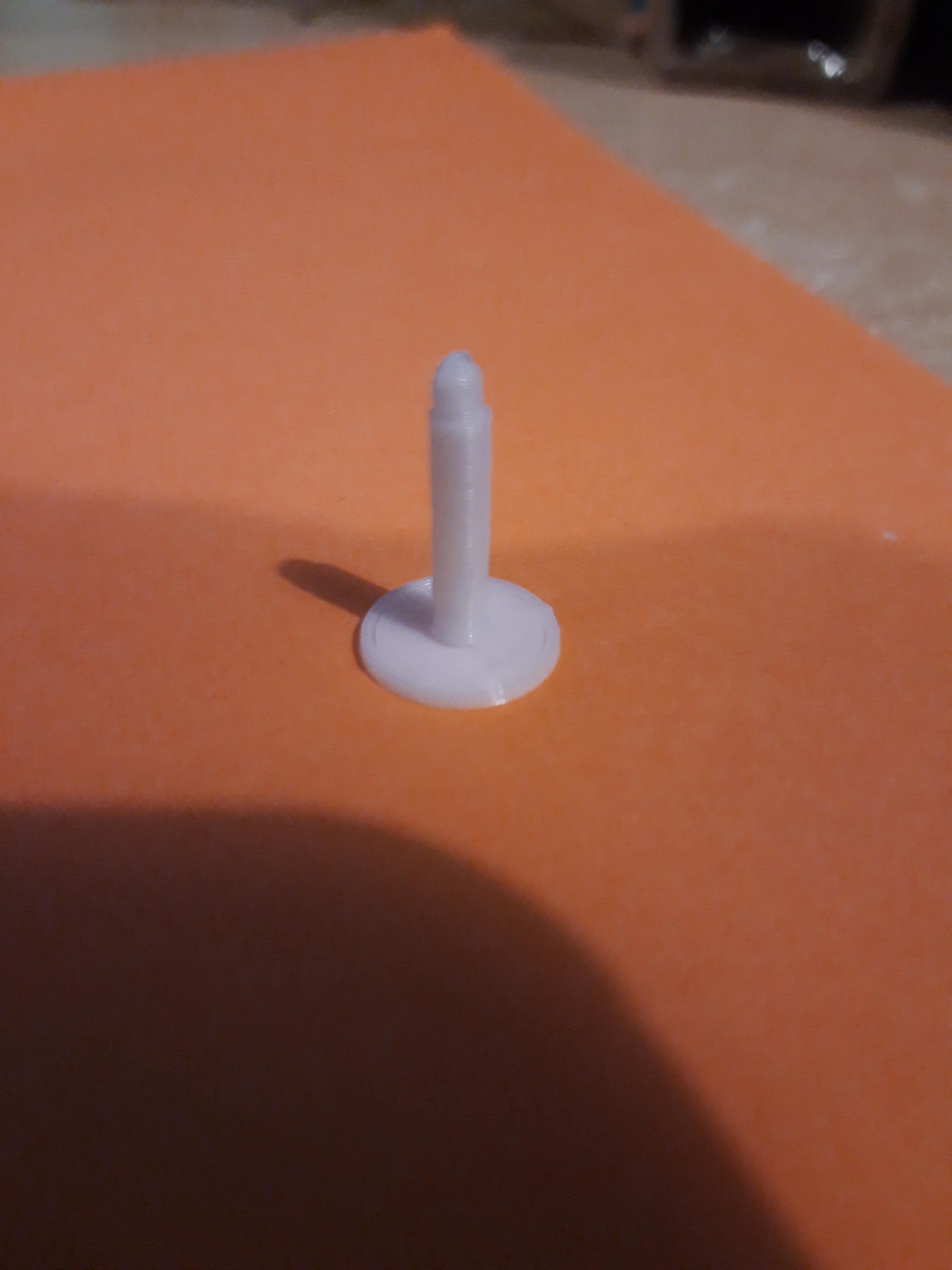

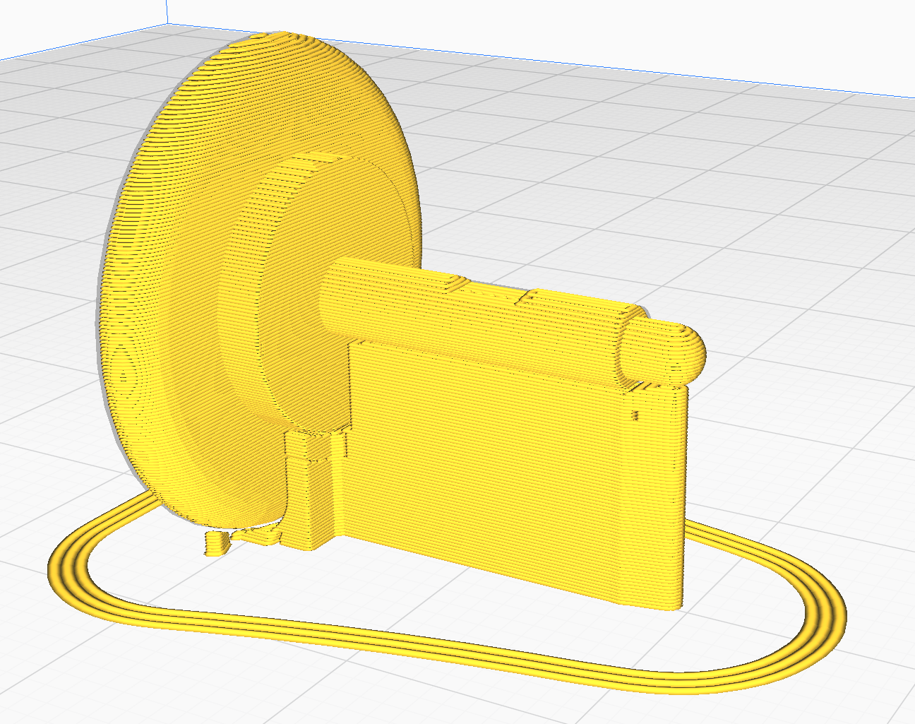

Onoff Posted December 28, 2019 Share Posted December 28, 2019 Better results by setting the Z seam alignment to random. Takes a little longer to print though. Next to try it horizontal as suggested above: Link to comment Share on other sites More sharing options...

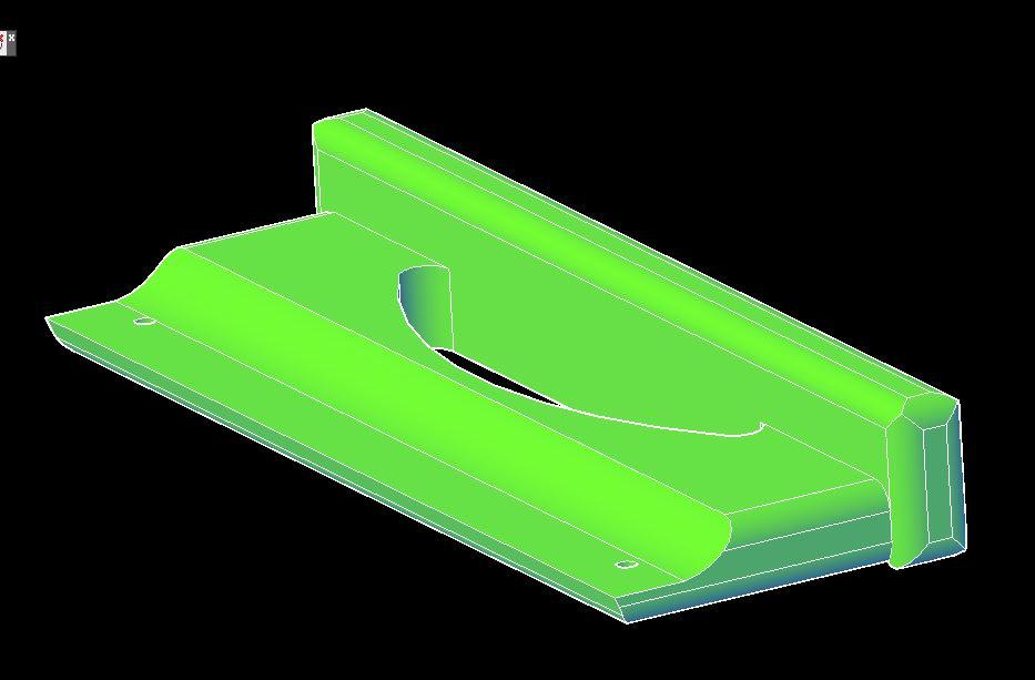

Temp Posted December 28, 2019 Share Posted December 28, 2019 I didn't notice the recess. If you print vertically it might need supports enabled "everywhere" to support the top edge of the recess. Either that or change the design so the top of the recess is at say 45 degrees rather than a horizontal overhang. Link to comment Share on other sites More sharing options...

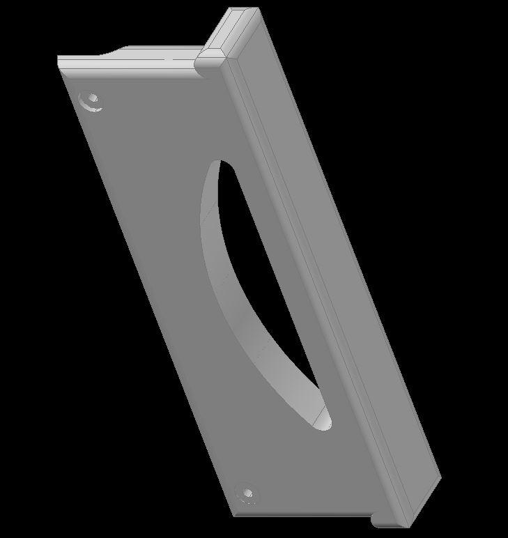

Onoff Posted December 28, 2019 Share Posted December 28, 2019 (edited) 6 minutes ago, Temp said: I didn't notice the recess. If you print vertically it might need supports enabled "everywhere" to support the top edge of the recess. Either that or change the design so the top of the recess is at say 45 degrees rather than a horizontal overhang. Recess shown on the blue CAD model on the previous page. Halfway up the pin. Edited December 28, 2019 by Onoff Link to comment Share on other sites More sharing options...

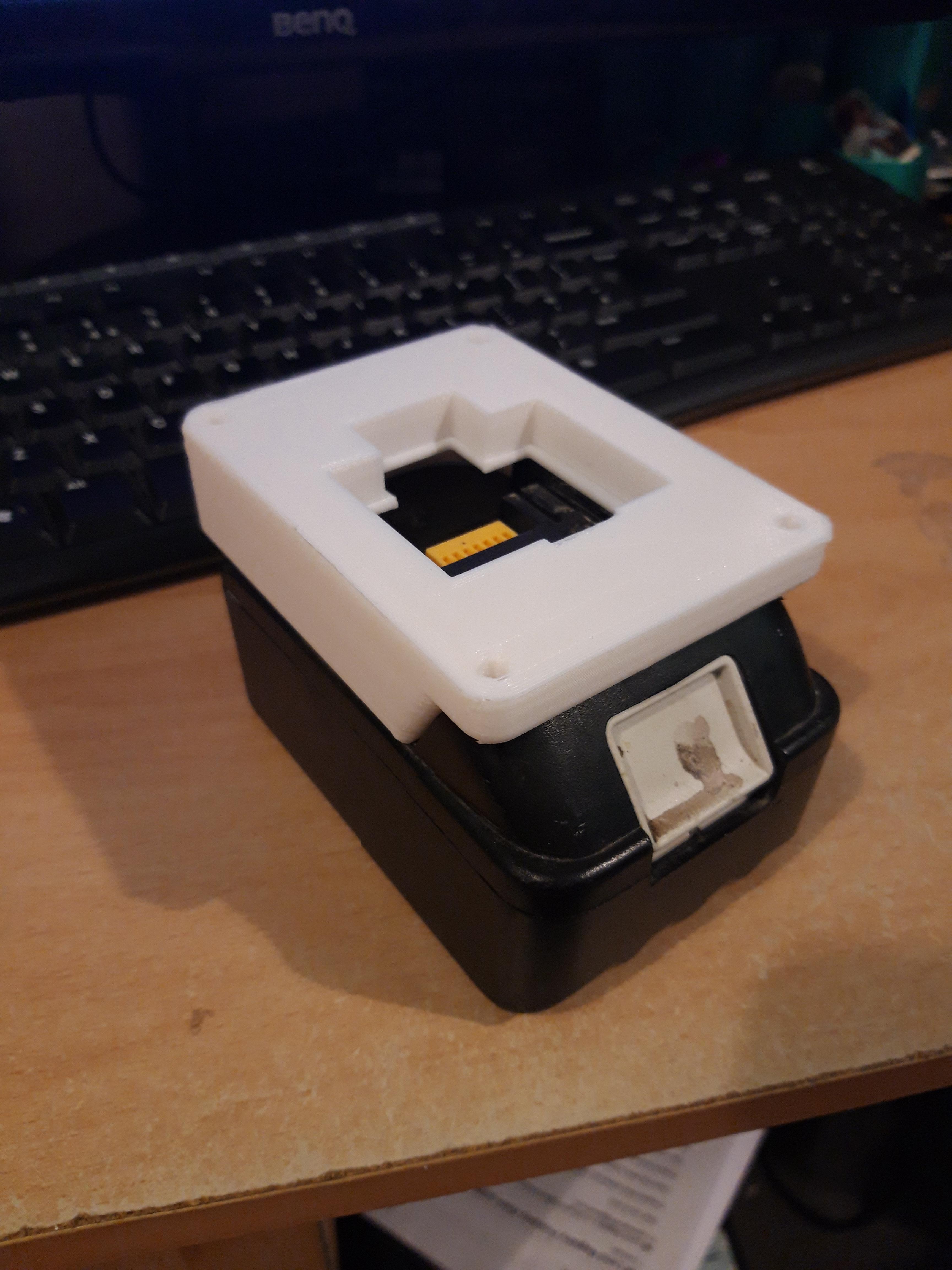

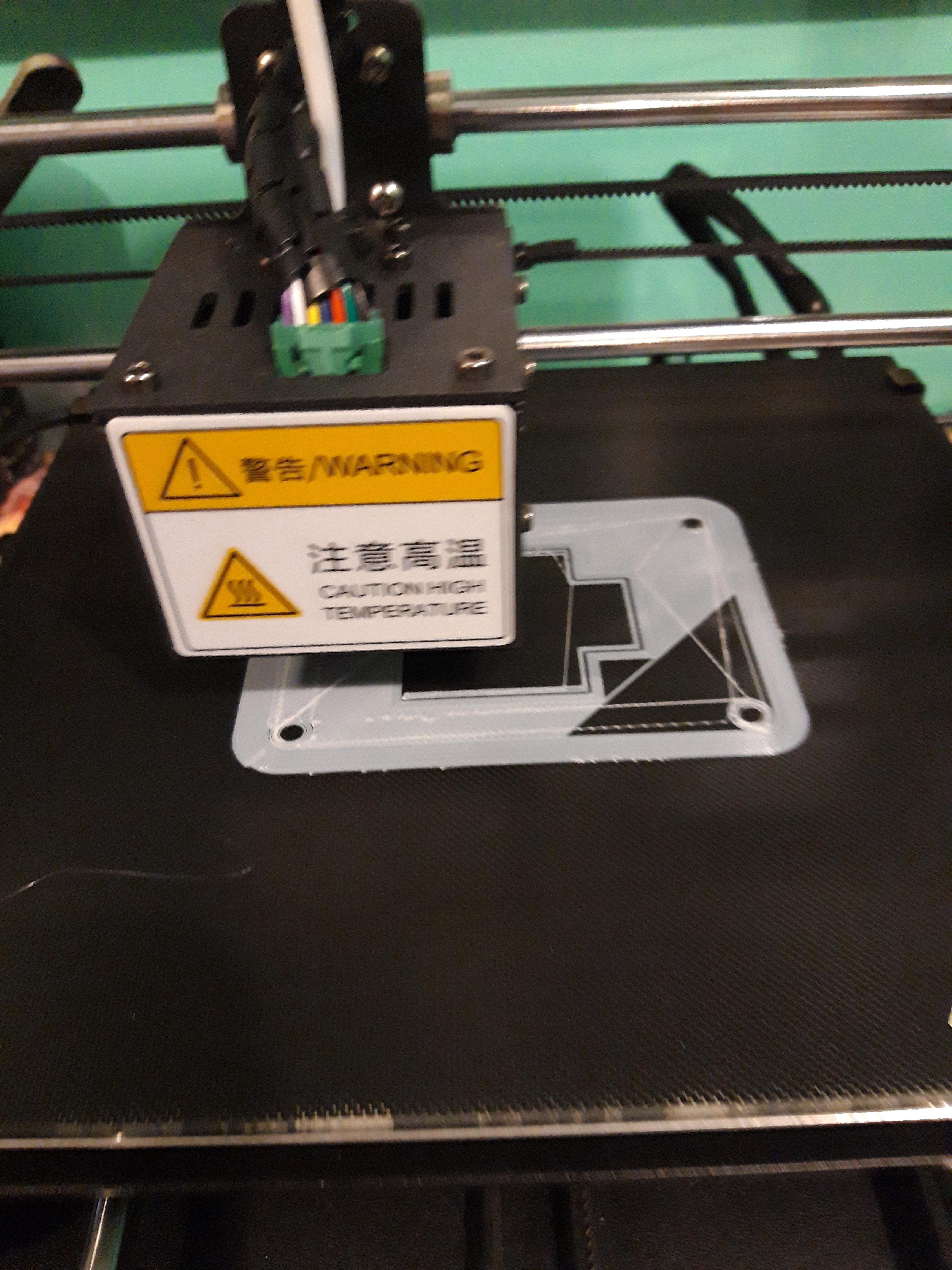

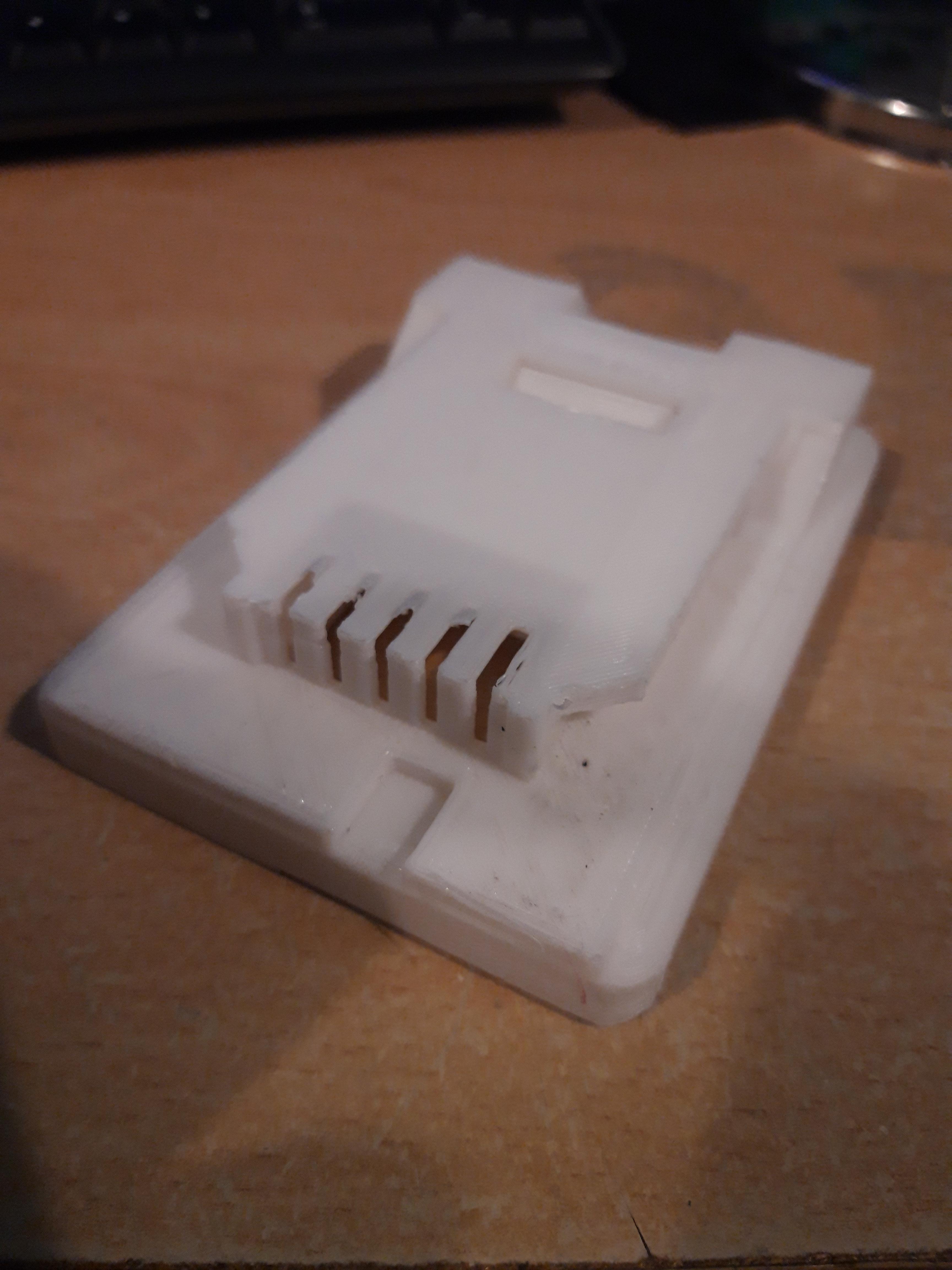

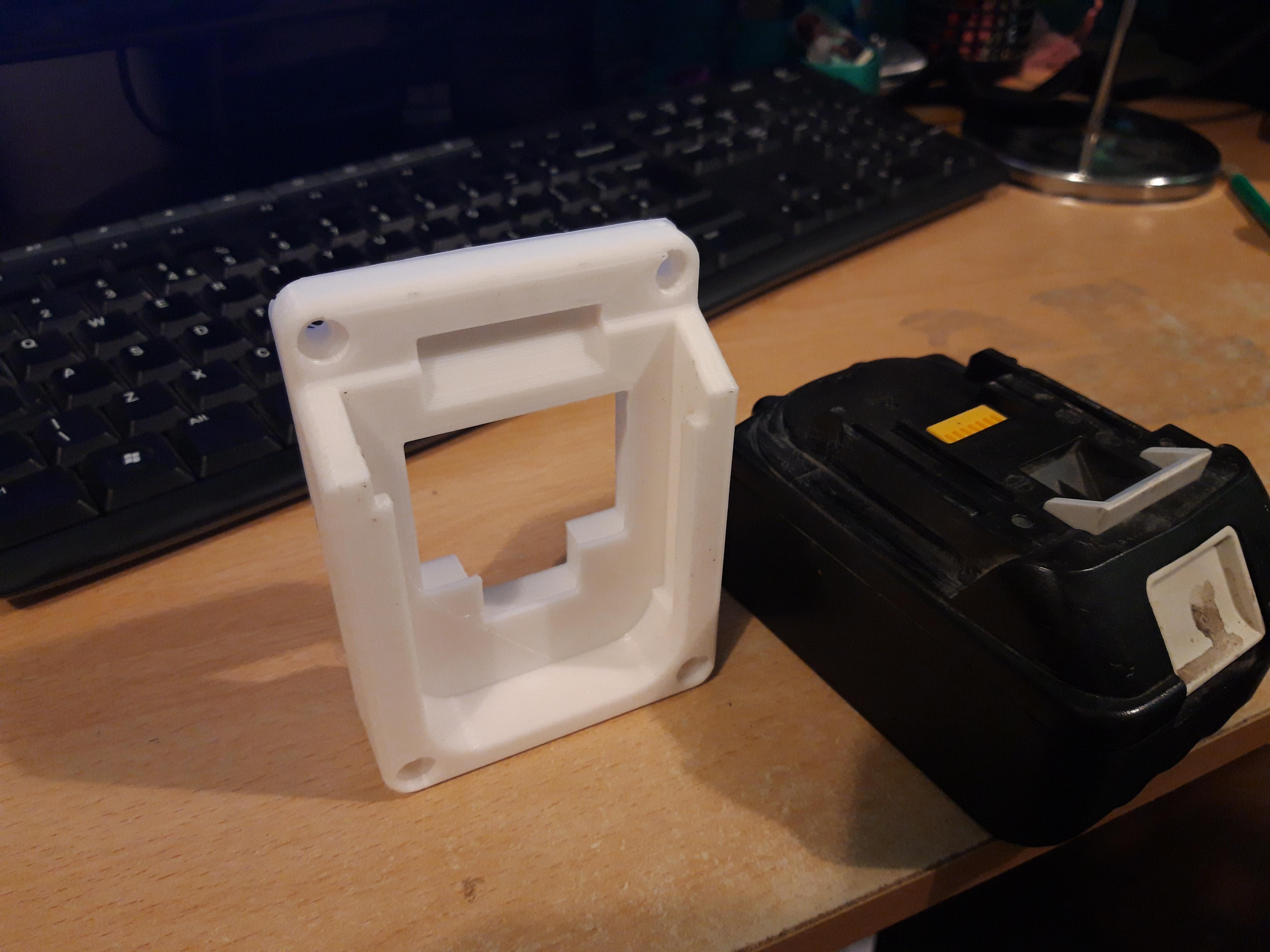

Onoff Posted January 3, 2020 Share Posted January 3, 2020 So begins the Makita battery to (Aldi) Ferrex tool adapter! (PLA, 25% fill). Link to comment Share on other sites More sharing options...

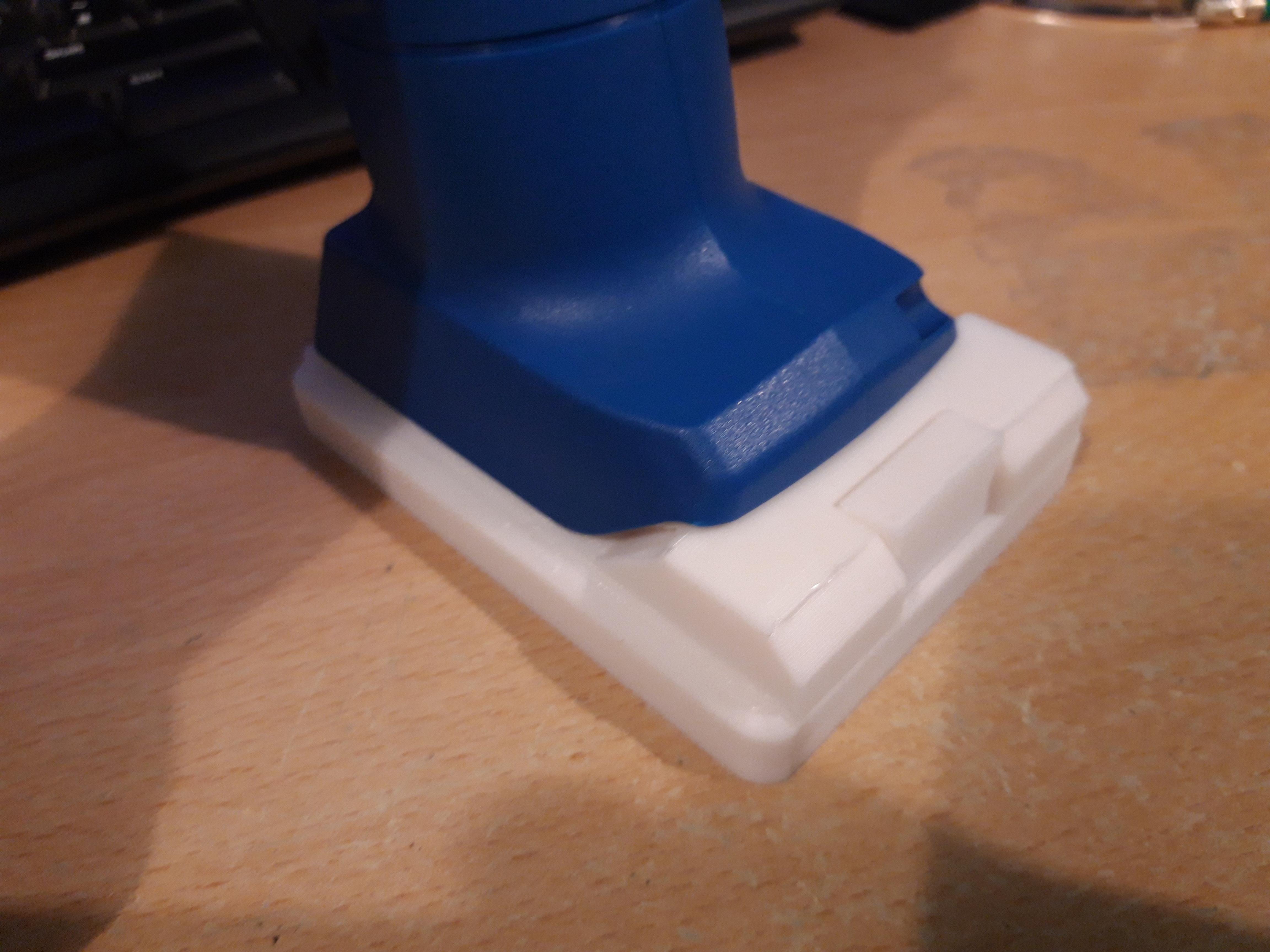

Onoff Posted January 4, 2020 Share Posted January 4, 2020 3 hours later... Fit on the battery is impressively accurate. 0.3mm layers at 25%. Not sure how resilient it'll be long term. It's quite lightweight tbh. Just seen you can get special paint to improve the surface (by smoothing) and durability of 3D printed models. 1 Link to comment Share on other sites More sharing options...

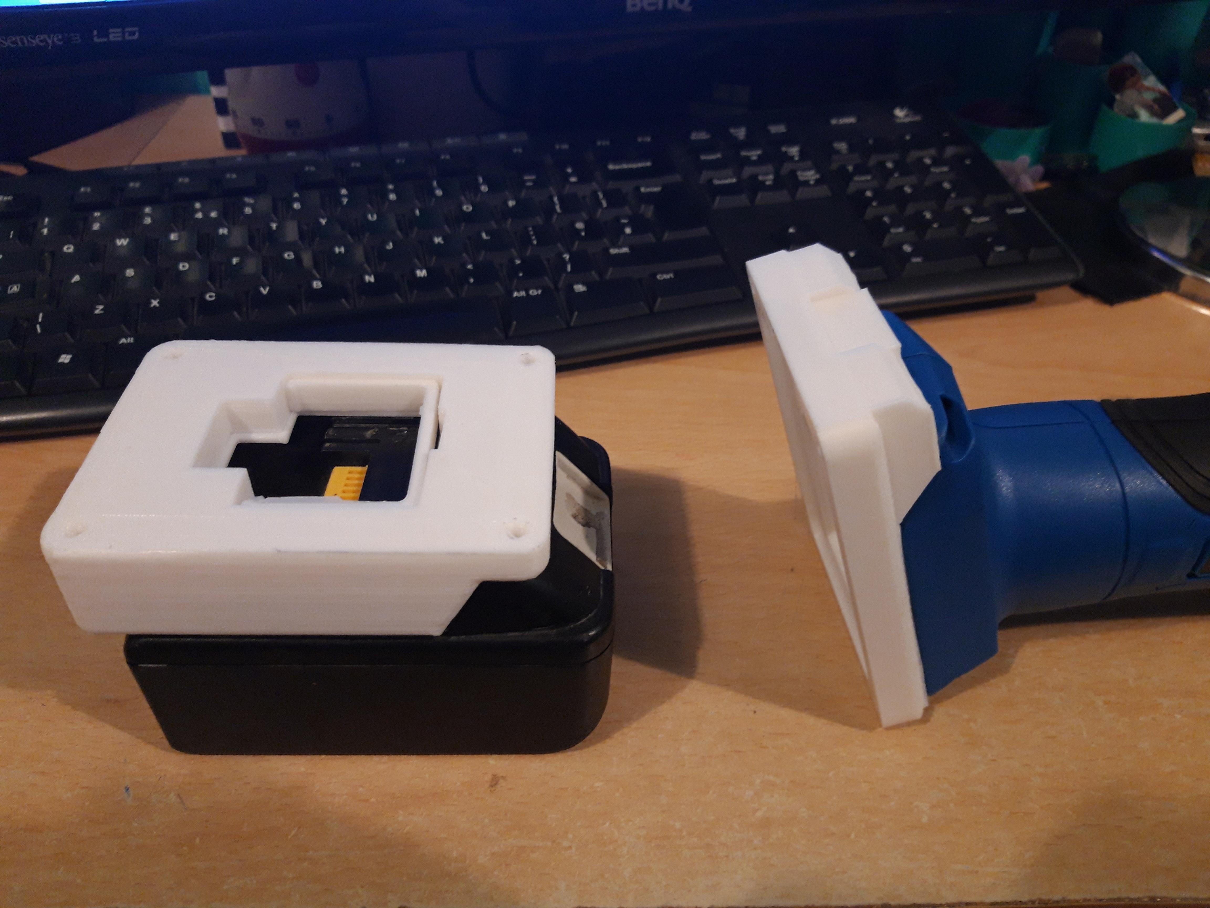

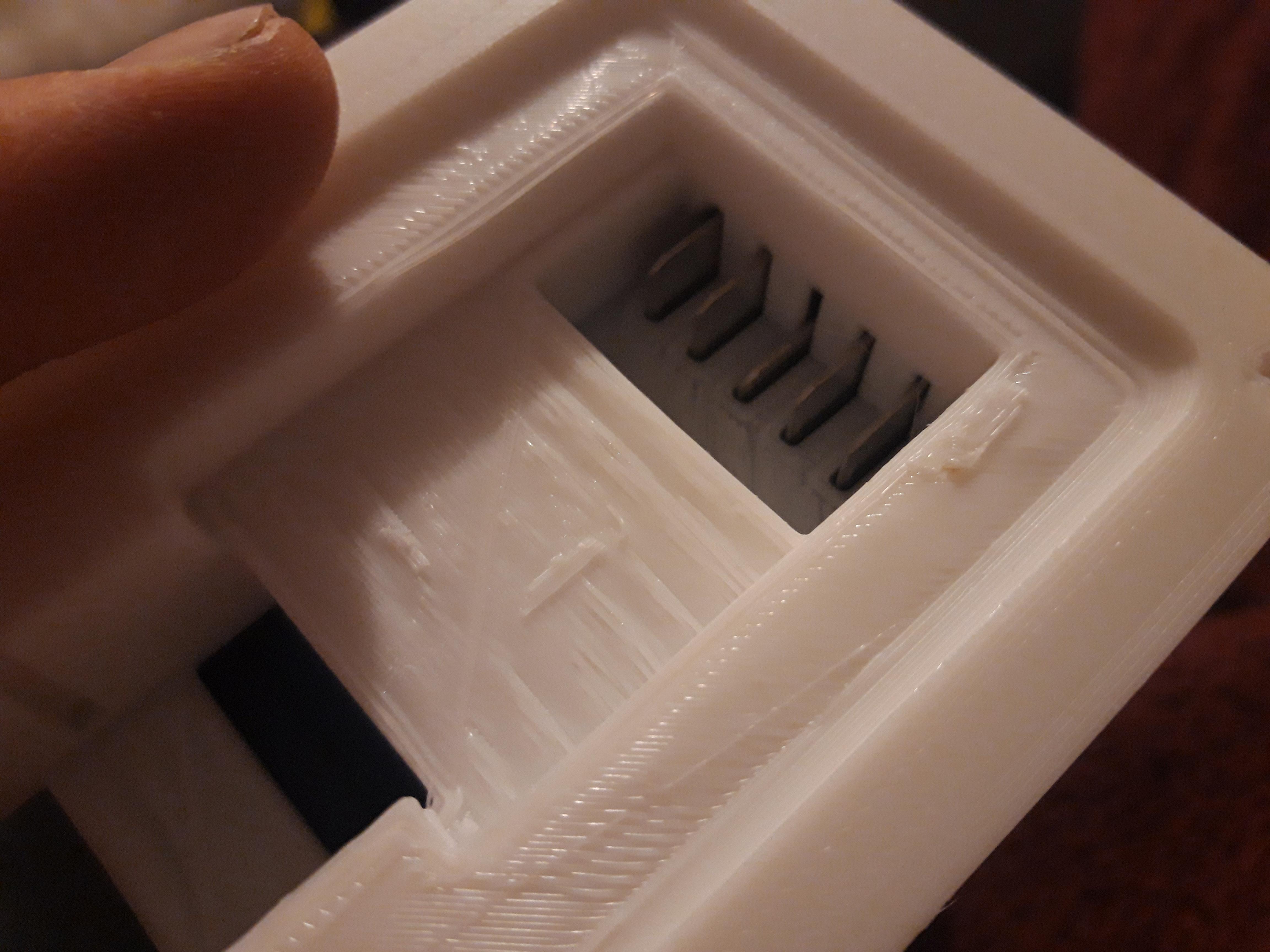

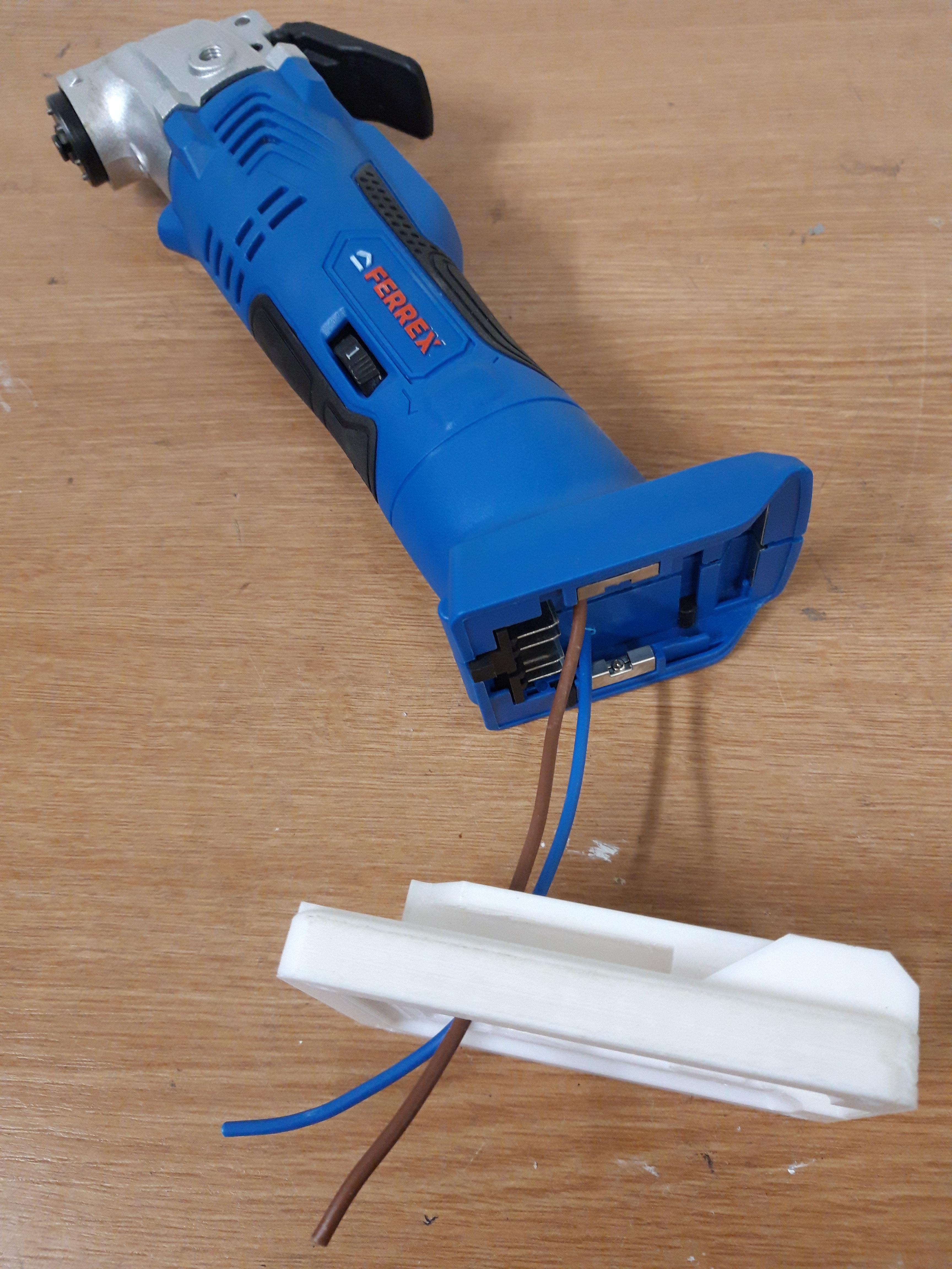

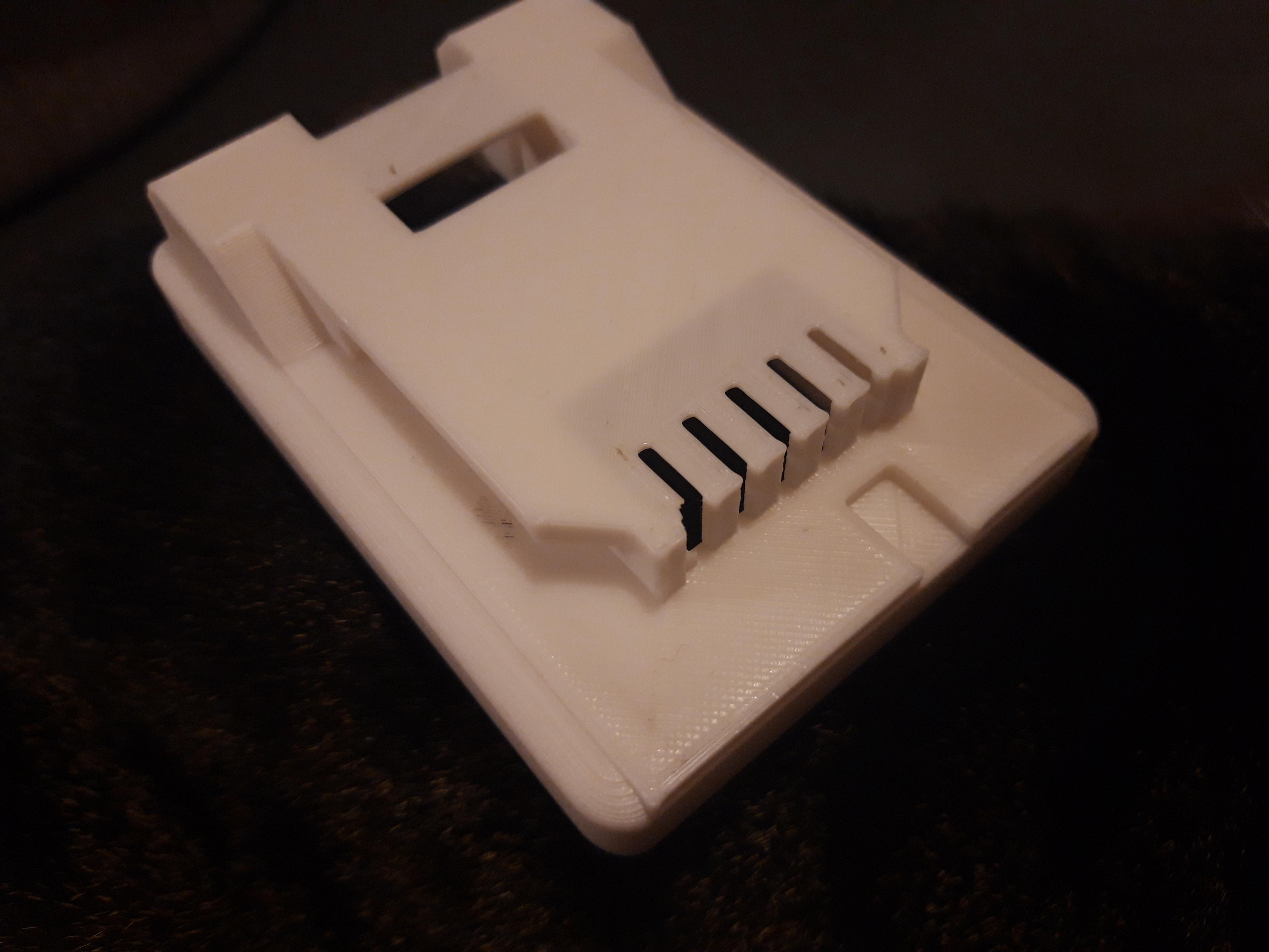

Onoff Posted January 5, 2020 Share Posted January 5, 2020 The 2nd big piece, that fits to the Ferrex tool didn't print so well. He thinks because he printed it upside down to reduce supports. It fits the Ferrex tool OK but its "rough". Will try again! Tbh, with these prints I might now CAD my own up and at the same time try and reduce the height of the adapter section which adds about 30-40mm to the tool height. This particular print expects you to cannibalize a 2Ah Ferrex battery for the contacts. As I have neither a Ferrex battery or charger I think I'll just drill the contact blades in the bottom of the Ferrex tool and solder on wires. Link to comment Share on other sites More sharing options...

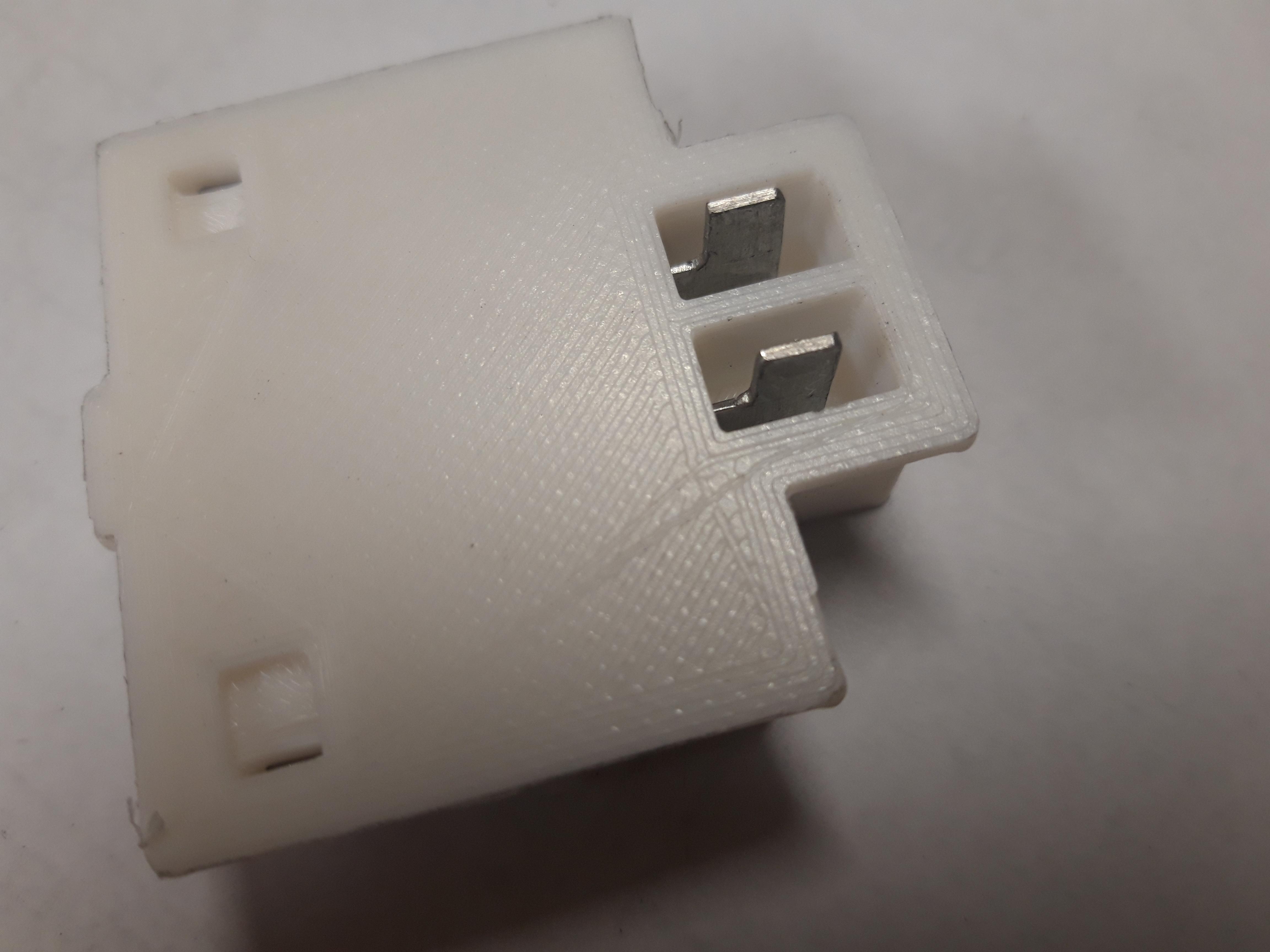

Onoff Posted January 6, 2020 Share Posted January 6, 2020 Son re did the bit that goes onto the Ferrex tool but "right" side up. Much better. Cut down on the supports underneath to speed things up which might have been a mistake as it's a bit stringy and rough here and there but then you won't see this area. (White PLA really is crap to photograph): (Broke a little bit off one of the slot edges when clipping to the tool as I misaligned it). As I've no intention of ever buying a Ferrex charger or battery, the plan is to drill through the tangs in the tool base and solder heavy duty wires on. Lad is just printing the Makita battery connector for me. Can't help thinking this would be better in ABS. Going to buy some ABS Pro I think. Link to comment Share on other sites More sharing options...

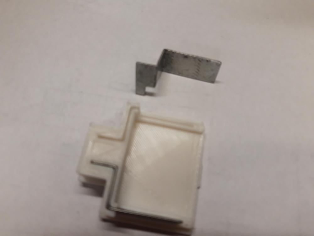

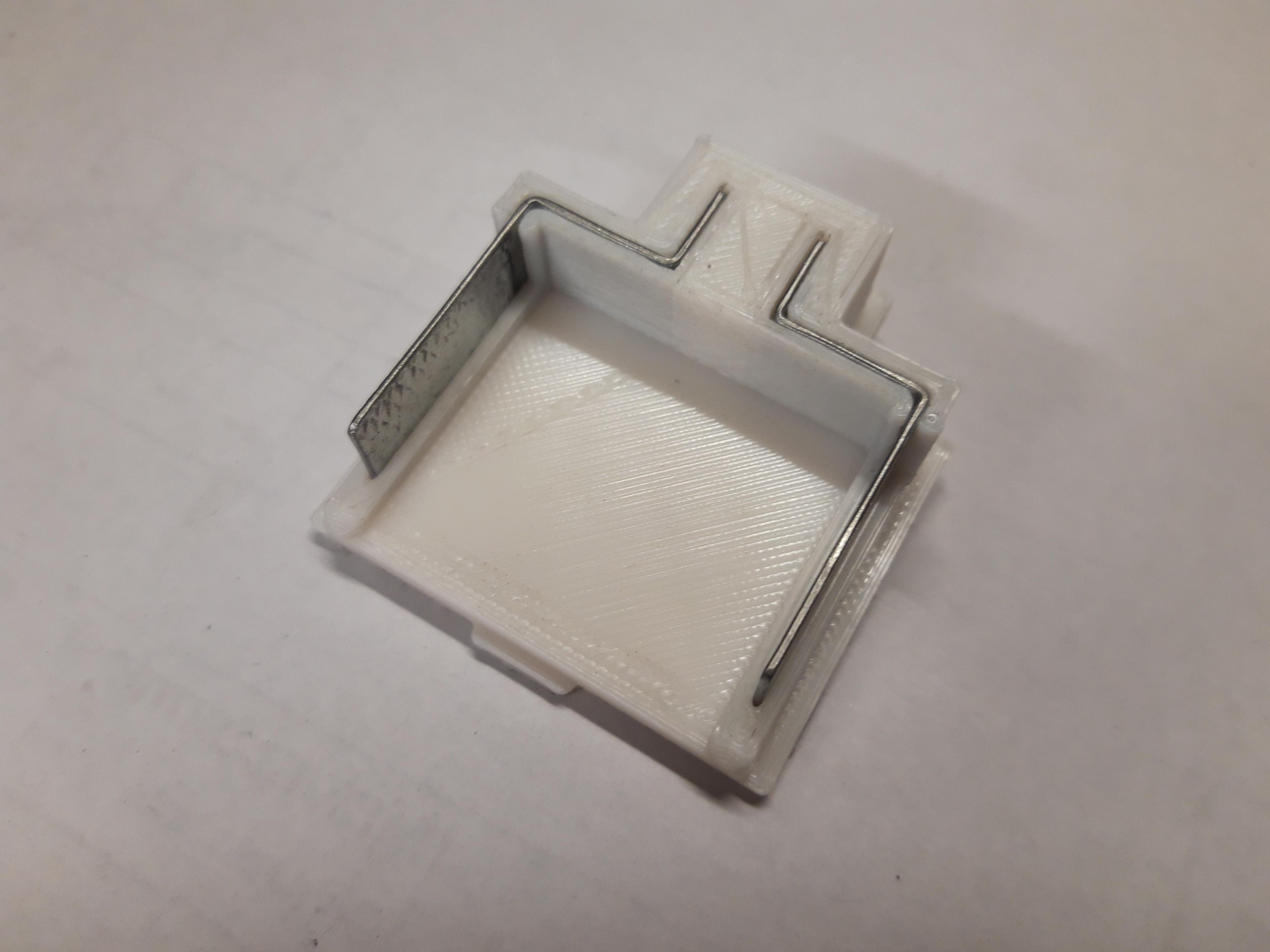

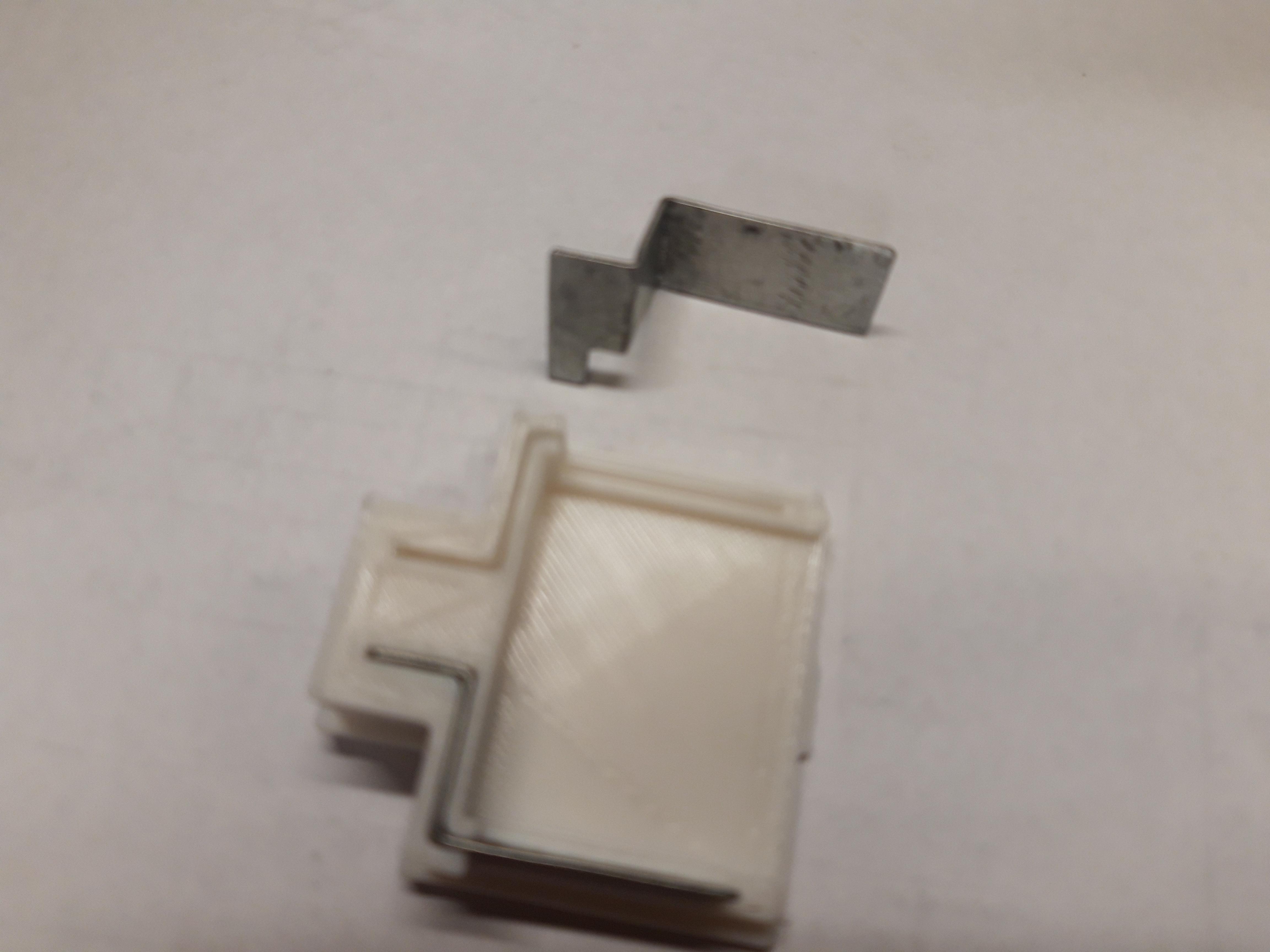

Onoff Posted January 8, 2020 Share Posted January 8, 2020 A little rough because of vice mark's etc but should work! Out of 1mm zinc plated steel: Link to comment Share on other sites More sharing options...

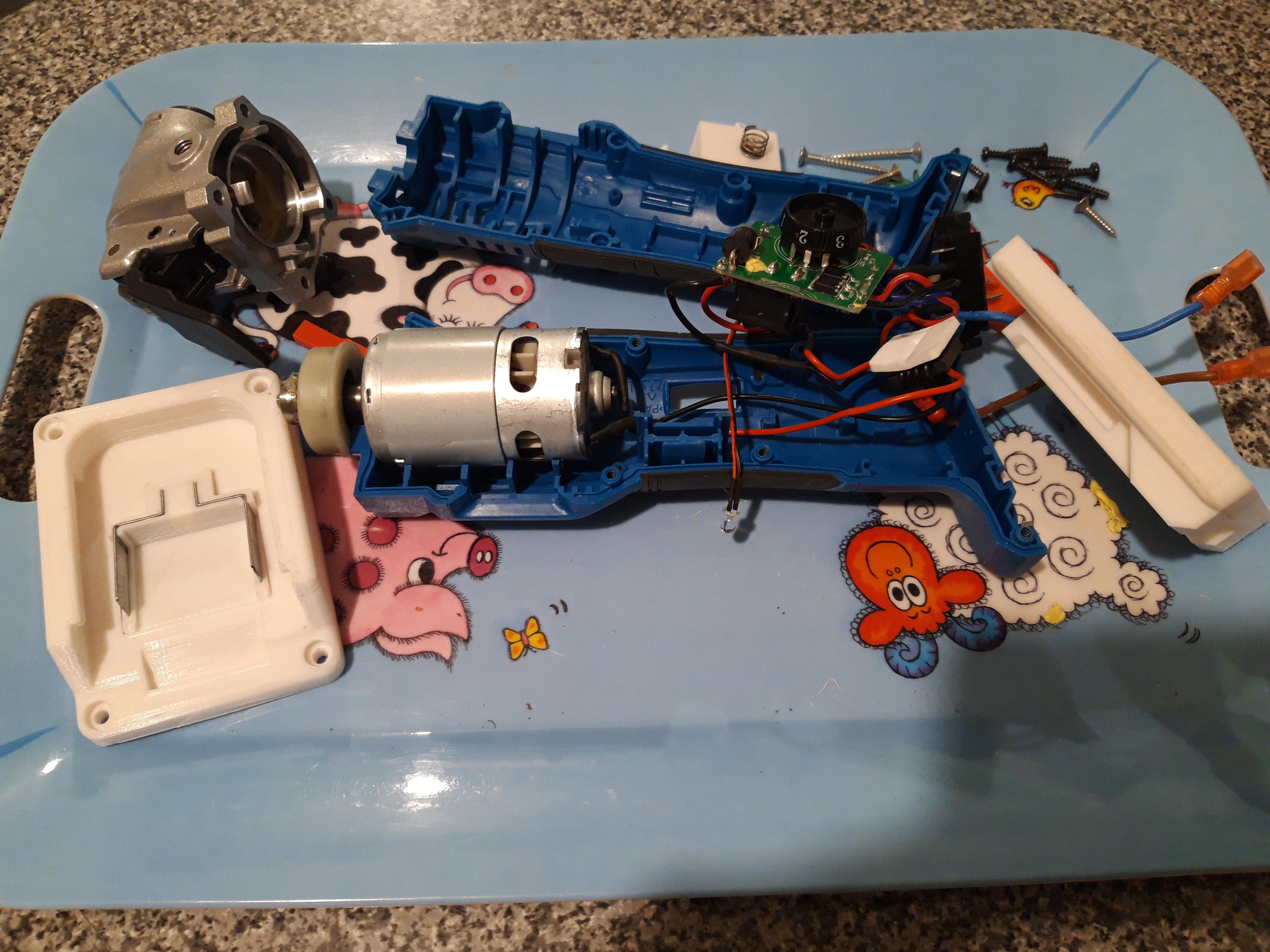

Onoff Posted January 8, 2020 Share Posted January 8, 2020 I found a random spring and 4 screws. Seems like it might work. White probably not the best colour, it'll attract dirt like a DeWalt! This is PLA btw. Got some grey ABS now to try as well. You're supposed to cannibalize a Ferrex battery to get female connectors as I think I've mentioned but I'll likely just Stanley out where the 5 slots are and take two chunky wires soldered to the Ferrex tool. VID-20200108-WA0005.mp4 Link to comment Share on other sites More sharing options...
Onoff Posted January 8, 2020 Share Posted January 8, 2020 Being honest.....it's a bit long! Unwieldy?It does stand up on it's own though:Not sure if I'll get it wired up tonight though. Call of the mild, beer o'clock etc... 1 Link to comment Share on other sites More sharing options...
Onoff Posted January 8, 2020 Share Posted January 8, 2020 I've only had one beer so...The Ferrex multitool splits easy enough to expose the battery connections to tap off of:Pic of the pcb out of interest: Link to comment Share on other sites More sharing options...
Onoff Posted January 10, 2020 Share Posted January 10, 2020 Should have had a beer before! Crimped a couple of 1.5mm2 wires into the tool, inside, (internal battery wiring is 18 AWG) and brought them out through a couple of drilled holes: Probably should have stopped there! Put the wires onto the Makita battery and nada, nothing! A quick check with the meter and I found I had continuity from the battery POSITIVE, through the tool switch to the motor. Had no continuity though on the negative side. Looked at the SMD laden pcb and thought I can't even see half the stuff and even with a magnifying glass probably haven't the dexterity everything's so small. I then, for some reason took the battery off. Half asleep I put it back on but with reversed polarity! There was a crack and some smoke and the variable resistor is well and truly cooked! Bin job. Link to comment Share on other sites More sharing options...

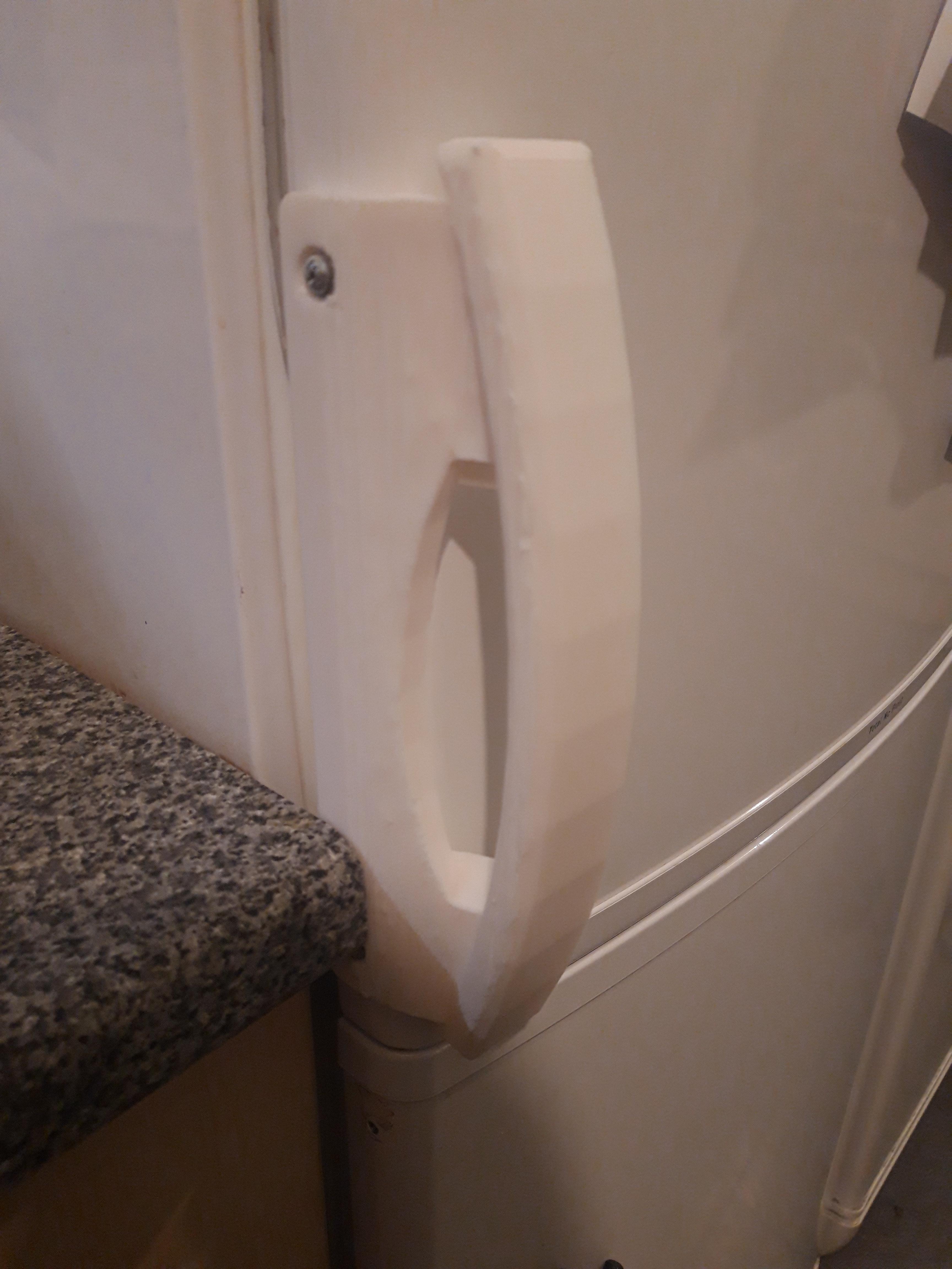

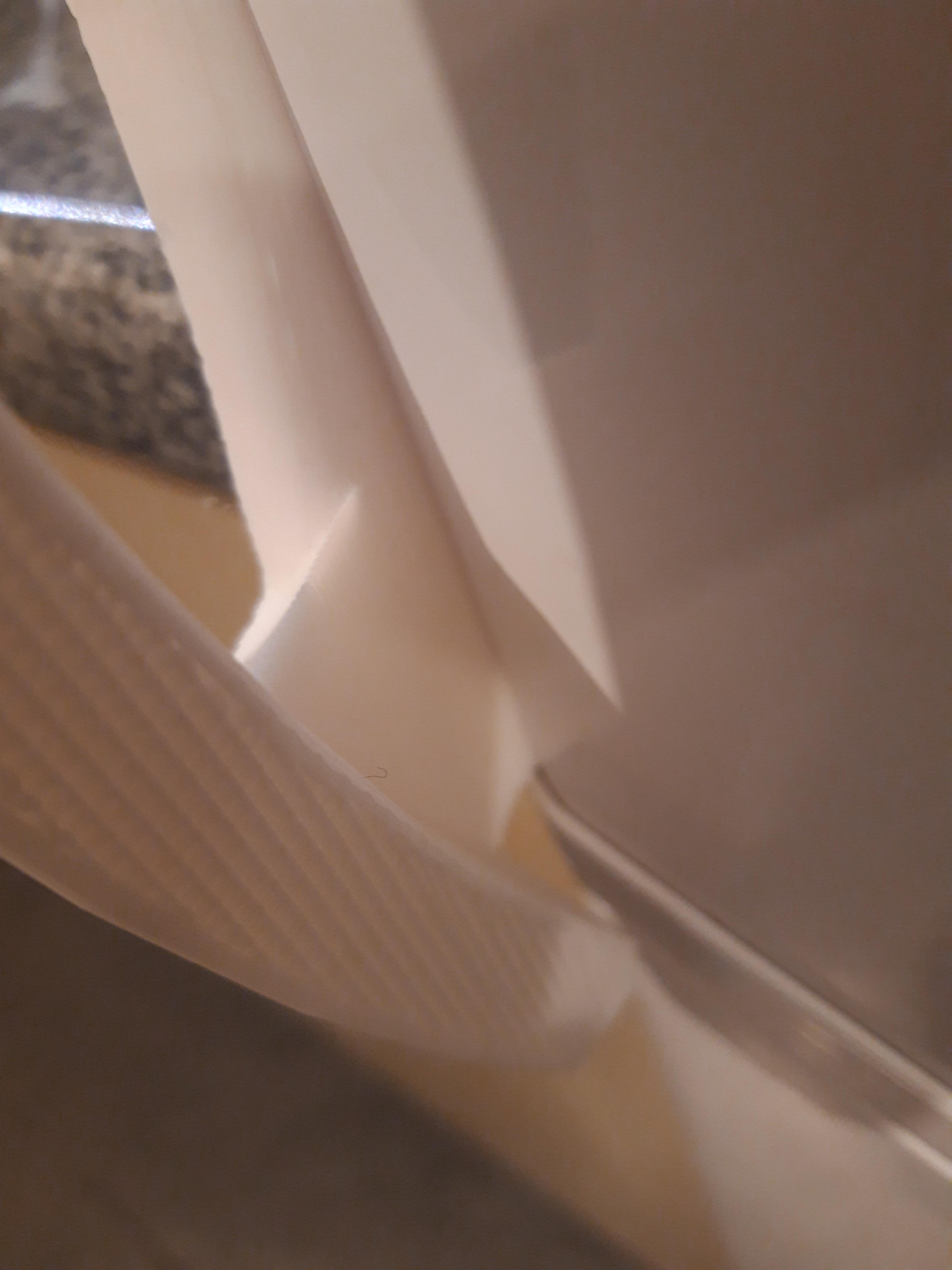

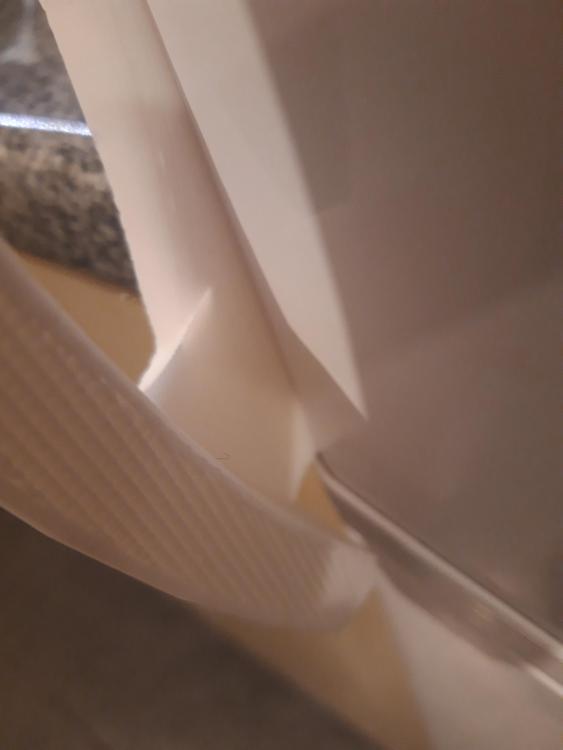

Onoff Posted January 13, 2020 Share Posted January 13, 2020 Trying to print a new fridge handle we drew up between us: VID-20200113-WA0004.mp4 1 Link to comment Share on other sites More sharing options...
Onoff Posted January 14, 2020 Share Posted January 14, 2020 The fridge handle was a failure! I modelled it in AutoCAD and it looked great. All soft curves. Printed some small sections and they fitted a treat. I then somehow lost the model! I'd sent beforehand my lad the .stls for the handle and bit that screws to the door as two separate parts for some reason. He put them together but as meshes, the resultant model looked faceted. This is how it printed, dog rough, like a lobster's back! One side of the handle was just an open mesh! Something lost in translation between packages I guess! Going to simplify the next attempt, all right angles, minimal radii and no overhangs! Link to comment Share on other sites More sharing options...
SteamyTea Posted January 14, 2020 Share Posted January 14, 2020 Non slip handle. Good move. Why are fridges made so cheaply. They really are rubbish. Link to comment Share on other sites More sharing options...
Onoff Posted January 14, 2020 Share Posted January 14, 2020 21 minutes ago, SteamyTea said: Non slip handle. Good move. Why are fridges made so cheaply. They really are rubbish. MK2 has a flat bottom so less support needed. Function over form this time! Link to comment Share on other sites More sharing options...
