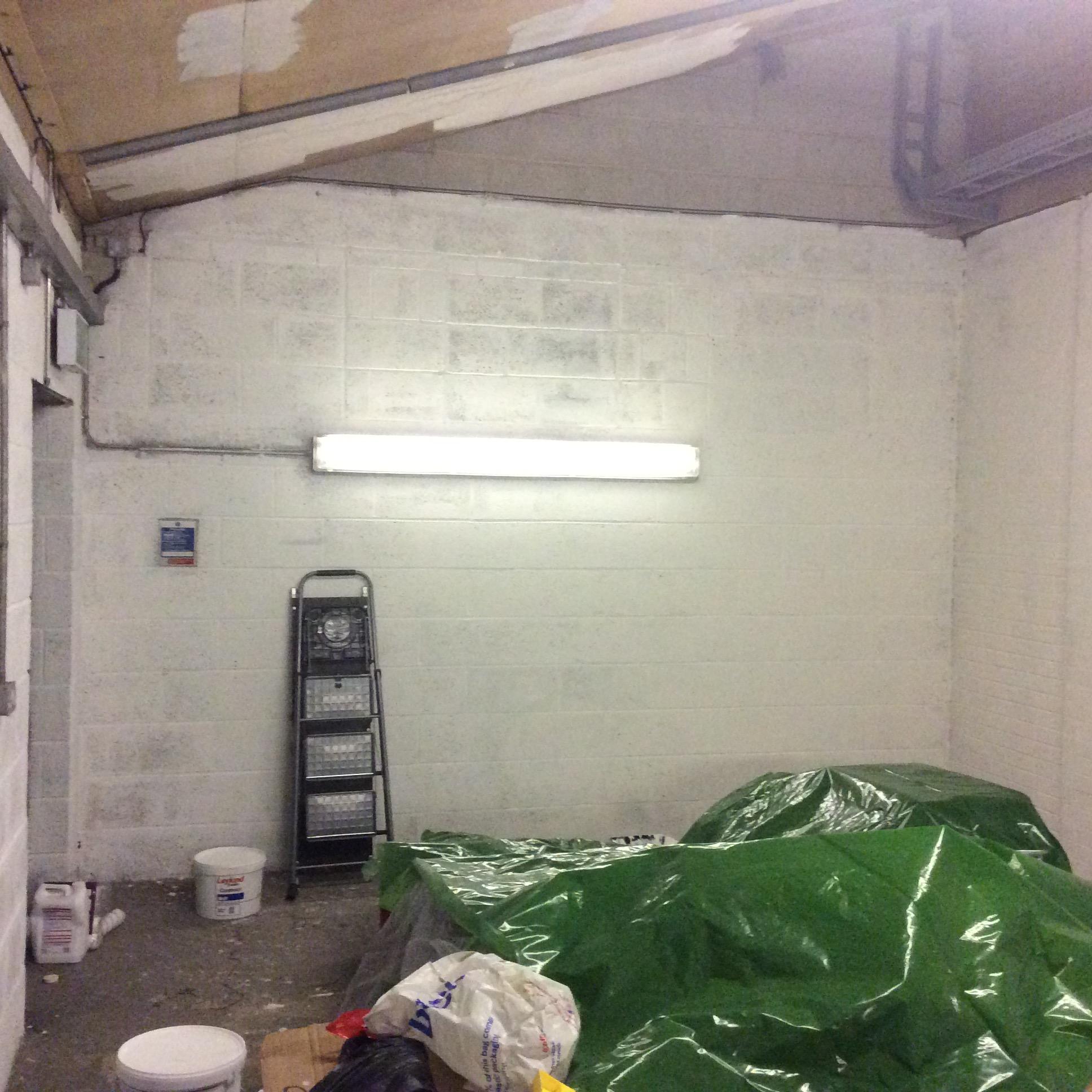

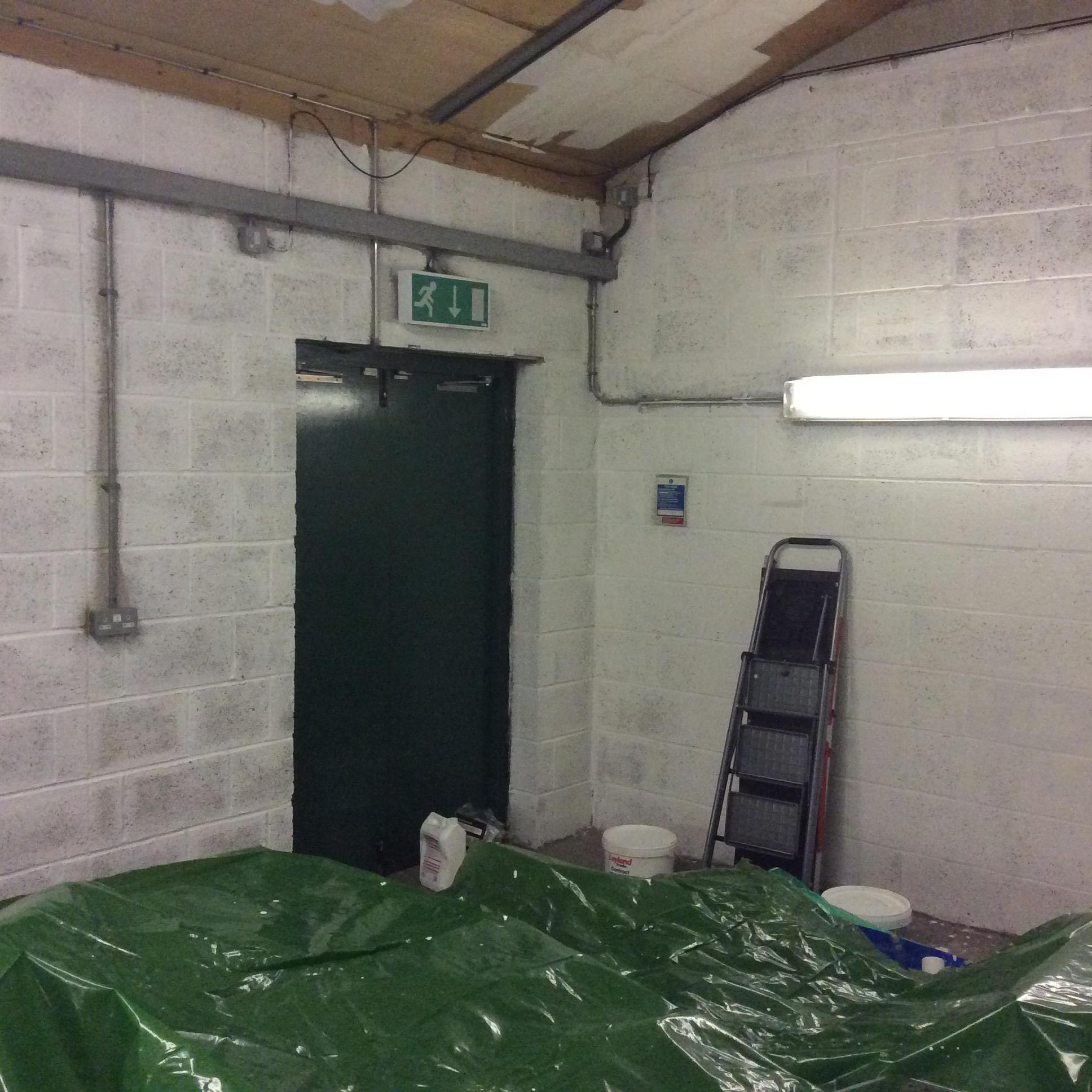

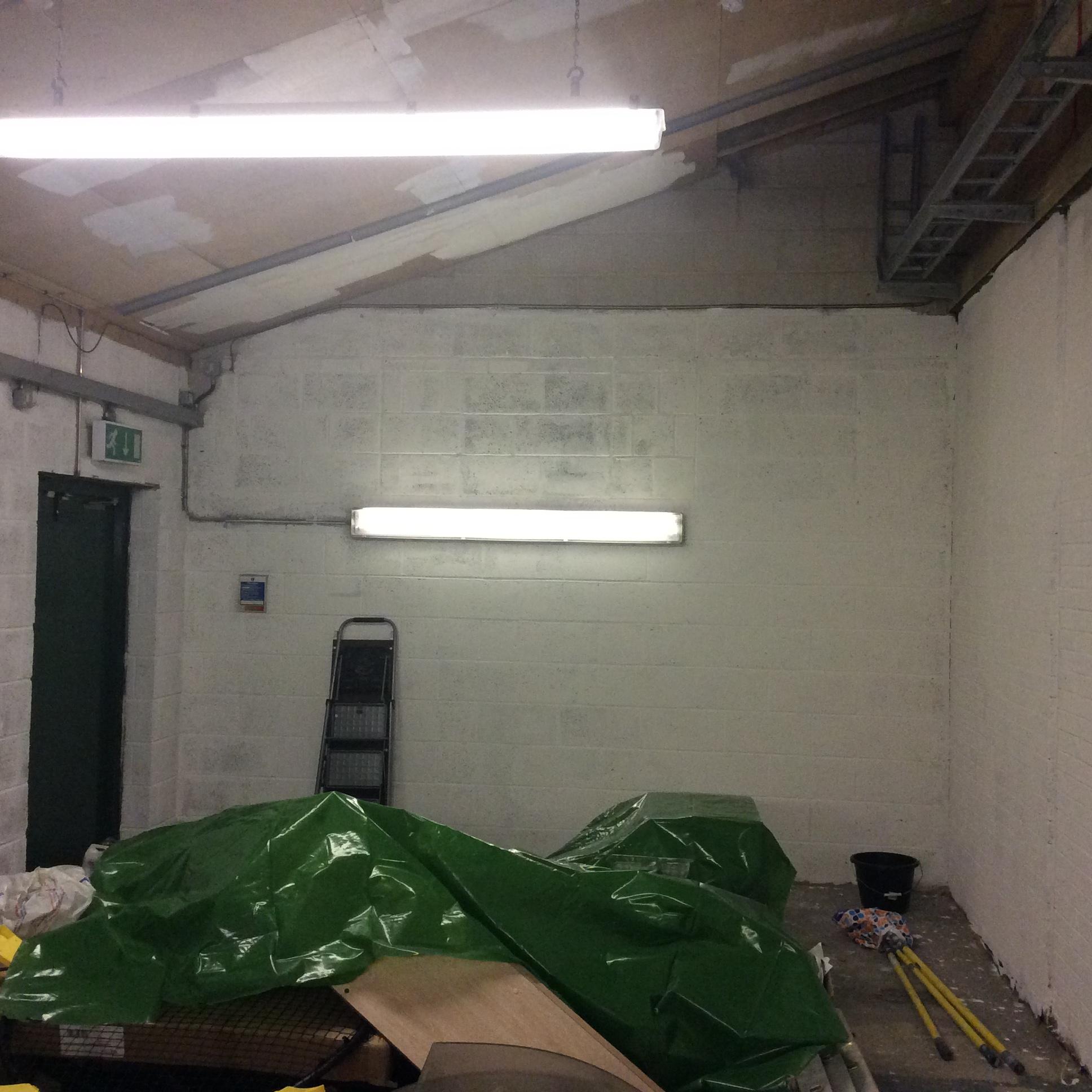

Ferdinand Posted January 24, 2019 Author Posted January 24, 2019 (edited) Further to this thread, these are photos of the space I need to subdivide. As you can see it is a lean to profile, with a ceiling height running from approx 3m up to approx 4m. I want a partition just on the far side of the electric double socket on the LHS, to give me a store at the end consisting of about 2-2.5m off the end of the room. Having thought a little more, I think I favour putting a joist in with using mini joist hangers just below the heavy ducting, a floorplate, some verticals and then boarding out on the near side with ply or son to give a rigid structure. POtentially I could board both sides, but I am not sure if will need that. Further comments are welcome. Edited January 24, 2019 by Ferdinand
