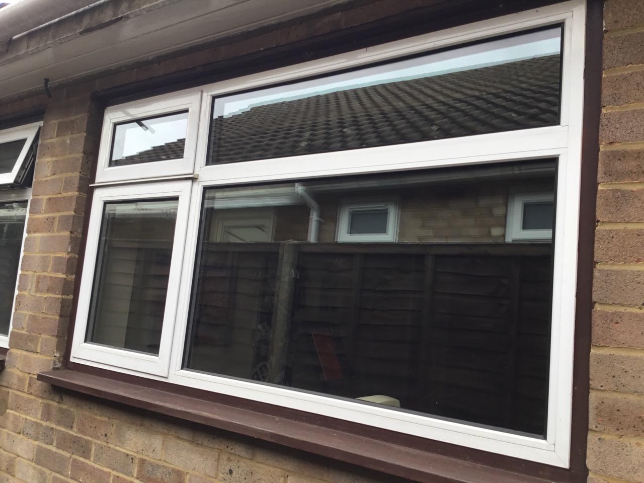

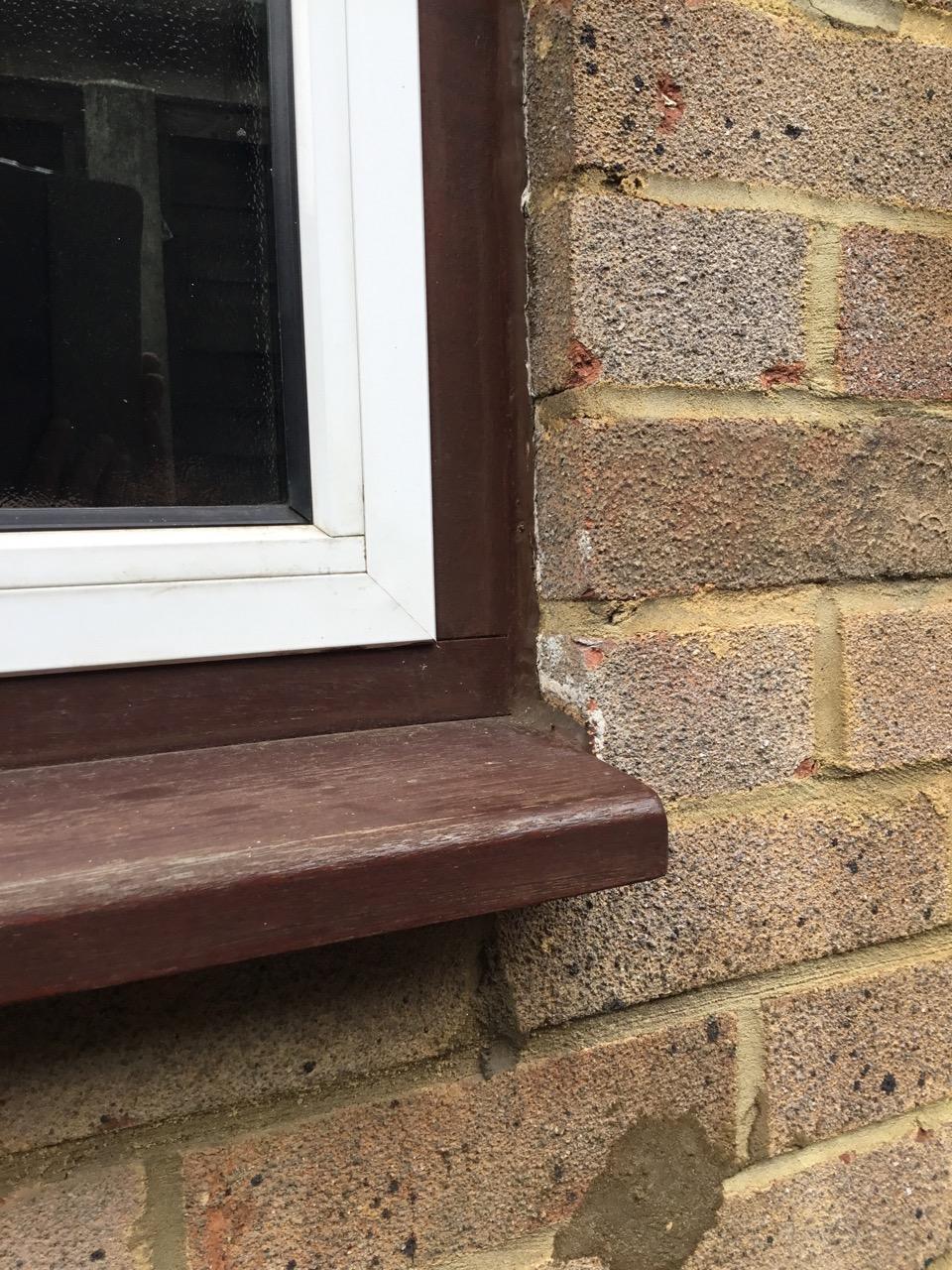

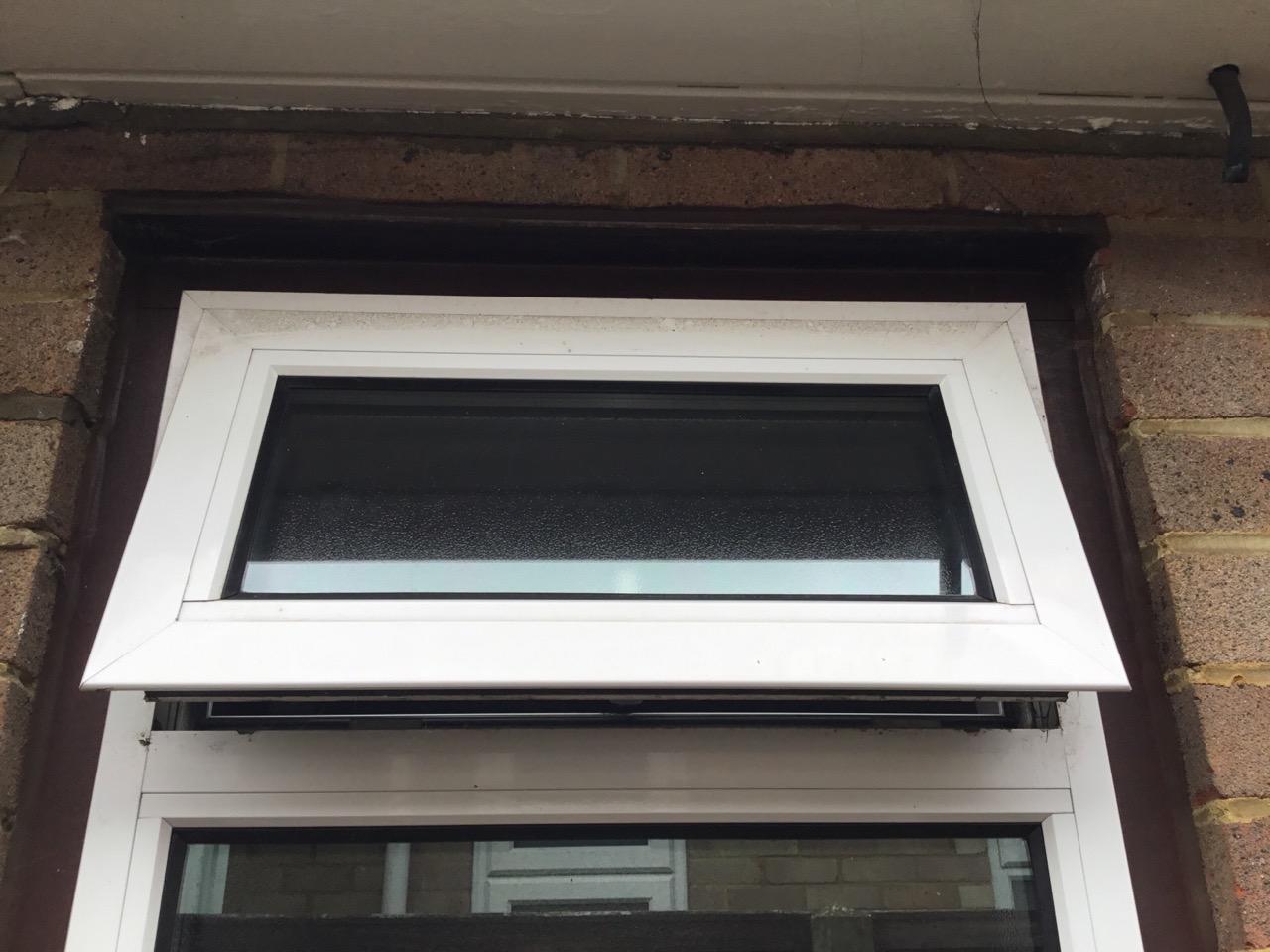

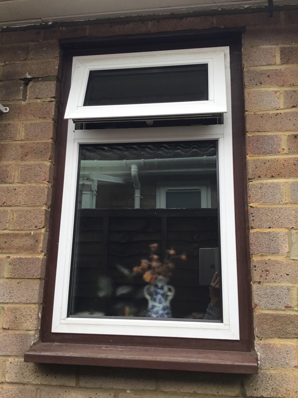

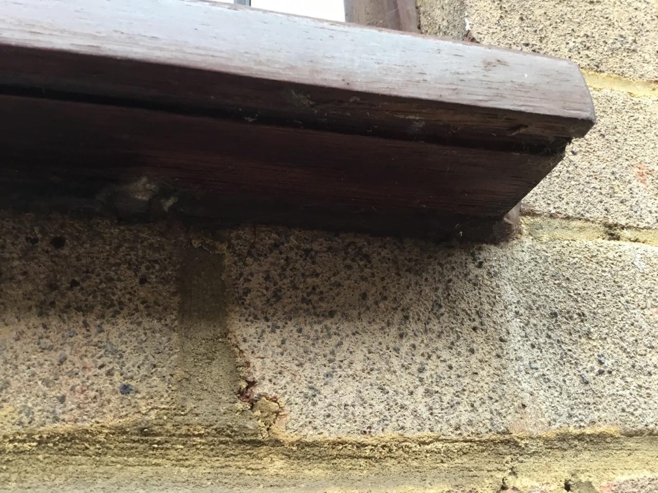

craig Posted February 26, 2024 Share Posted February 26, 2024 (edited) On 23/02/2024 at 15:56, Novice Becky said: Hope it's ok to pick up this old discussion or am I supposed to start a new one? I'm measuring for replacement windows and I've been putting it off as I can't find anyone to install only (I supply) ... looks like I'll have to learn how to DIY and rope in some friends. It's just two windows down the side of my 1960s bungalow (plus a composite front door - on another discussion). I replaced all the other windows 15 years ago. I think I'm going for timber frame, triple glazed from Russell Timber. They're good value and look pretty similar to my other (expensive) windows. QUESTION: when measuring do people take off 10mm all round, so subtract 20mm from both the height and width? There's no rendering, just brick, so I've measured from brick-to-brick on the width and on the height I did from mortar under the brick at the top to the bottom of the sill (see photos). I'll use the smallest measurements. @nod sounds like you've done this lots. Any advice? Or any recommendations of builders/window fitters near J9 of M25? FENSA installers won't do it. Local builder quoted £1750 to fit 2 small windows and a composite front door (I supply windows and compriband and air-tightness tape). Sounded a lot to me. Thanks for helping Where are you based? I can recommend some installers that will install only for you (location dependent), if you’re stuck. Edited February 26, 2024 by craig Link to comment Share on other sites More sharing options...

craig Posted February 26, 2024 Share Posted February 26, 2024 (edited) Dropped you a message with number for installer, he’ll help ya and it won’t be £1,750 👍 Have you ordered yet? Speak with him on measurements, I’d be lookibg for 5mm all around on a brick opening like you have tbh. That’s enough for a 3 to 5mm Compriband or a nice mastic bead. Edited February 26, 2024 by craig 1 Link to comment Share on other sites More sharing options...
