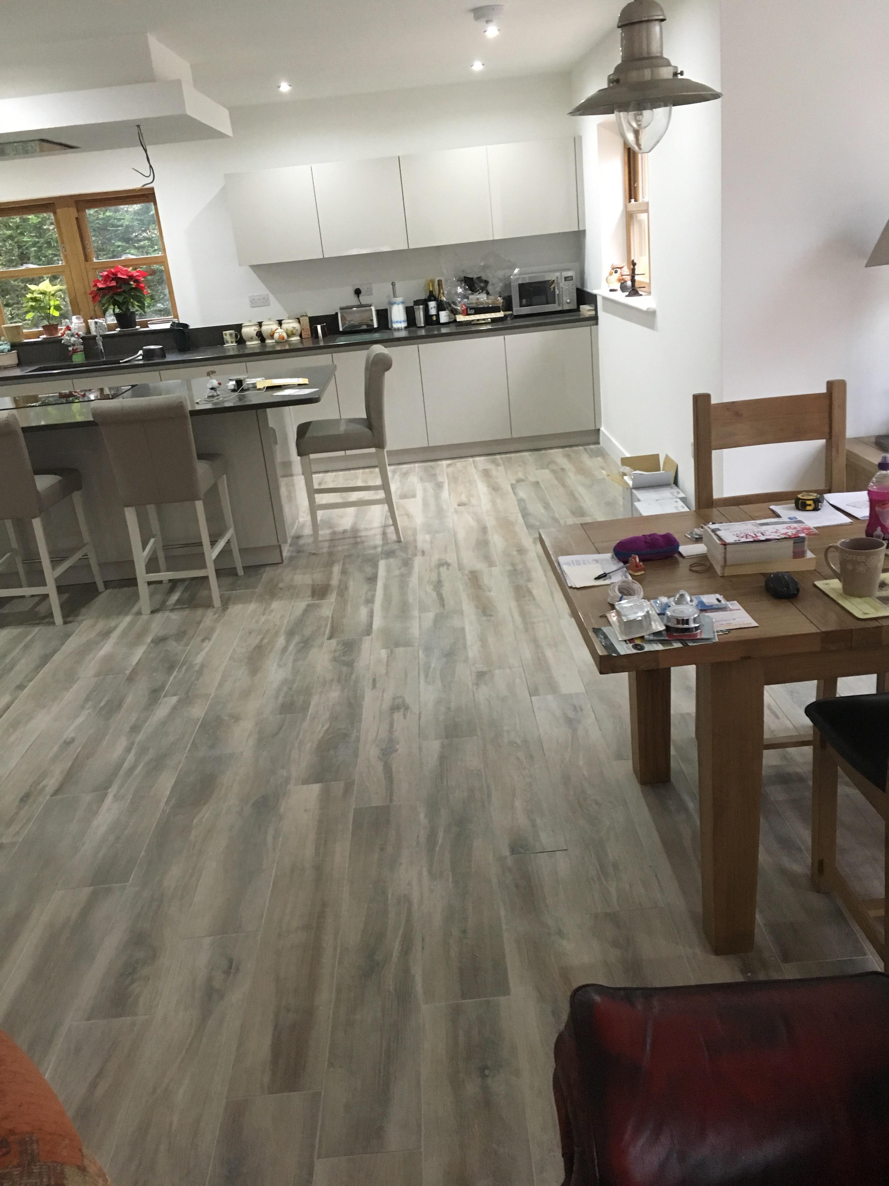

nod Posted January 12, 2019 Posted January 12, 2019 48 minutes ago, scottishjohn said: thats why so many people ban shoes in the house -- cuts down on damage dramatically you want no damage,then cermaic tile it--good choice if under floor heating Very good point I’ve put a 150 mtrs of porcelain slats on our ground floor with UFH Bomb proof We had a oak floor at our last house and didn’t take into account how careful we needed to be with furniture and shoes ? 3

newhome Posted January 12, 2019 Posted January 12, 2019 I had Karndean all over the ground floor in my previous house. We used the one with the thickest wear layer at the time, Da Vinci, as it had a 0.7mm wear layer vs 0.3 for the cheapest range. It still looked great after 10 years when we moved. For this house we used a mix of tiles and engineered oak as although Karndean can apparently be used with UFH we didn’t want to take the risk. We also chose the engineered oak with the thickest wear layer @ 6mm. I would never have laminate personally. For one thing with dogs it would be far too noisy.
newhome Posted January 12, 2019 Posted January 12, 2019 8 minutes ago, cjackson129 said: I guess I was hoping for the same flooring throughout the ground floor as the layout is open plan. We had Karndean throughout the ground floor. It was laid in planks and looked like wood unless you looked closely. Was a great choice for ‘all the way through’. I have tiles in the utility, kitchen / family room and hall (plus bathrooms), for durability and ease of cleaning (dogs being the main reason), and the engineered oak everywhere else including upstairs. The engineered oak would probably work everywhere TBH if you were careful.
