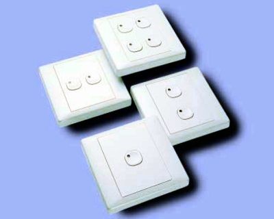

Barney12 Posted August 9, 2016 Share Posted August 9, 2016 I keep looking at Loxone and it does look well developed. Out of interest what route did you go for light switches? Link to comment Share on other sites More sharing options...
jack Posted August 9, 2016 Share Posted August 9, 2016 We went with Scolmore lighting retractive switches. Pretty good quality - a little stiffer than would be ideal for fast double clicks, but you get used to it (plus you can program around the need for double clicks in Loxone if you want to). The stiff mechanism means they can be a bit loud in operation if you're not careful. Actually, when I say good quality, I mean the switches themselves. We went for the screwless range of faceplates and I can't say I was overwhelmed by their quality. Very thin metal and not always a very positive click into place. The edges of the plates also have visible dents where the clips are formed. Again, you get used to it, but if I had my time again if have gone for far cheaper screw-on plates. Link to comment Share on other sites More sharing options...
Barney12 Posted August 9, 2016 Share Posted August 9, 2016 Interesting thanks. Automation is the subject of debate between SWMBO and I at the moment. In our last three renovations we fitted Clipsal Cbus Automated lighting and I admit I am a BIG fan of it. Easy to install, easy to commission and with the PAC controller plenty of basic automation available. By the third install I had learned to "dumb down" the switches. SWMBO just didn't like fancy switches, scene controllers, touch screens (and I tired them all). Instead we ended up with simple E2000 switches which look like this. Simple design, simple press on press off but also supports long press. Scenes can still be set but you need to use the Pascal Automation Controller (PAC) rather than any logic in the switch. BUT......SWMBO has now declared "I demand normal switches. I just want to switch it "on and off" (she means a standard switch). I think I'm a bit stuffed! Link to comment Share on other sites More sharing options...
