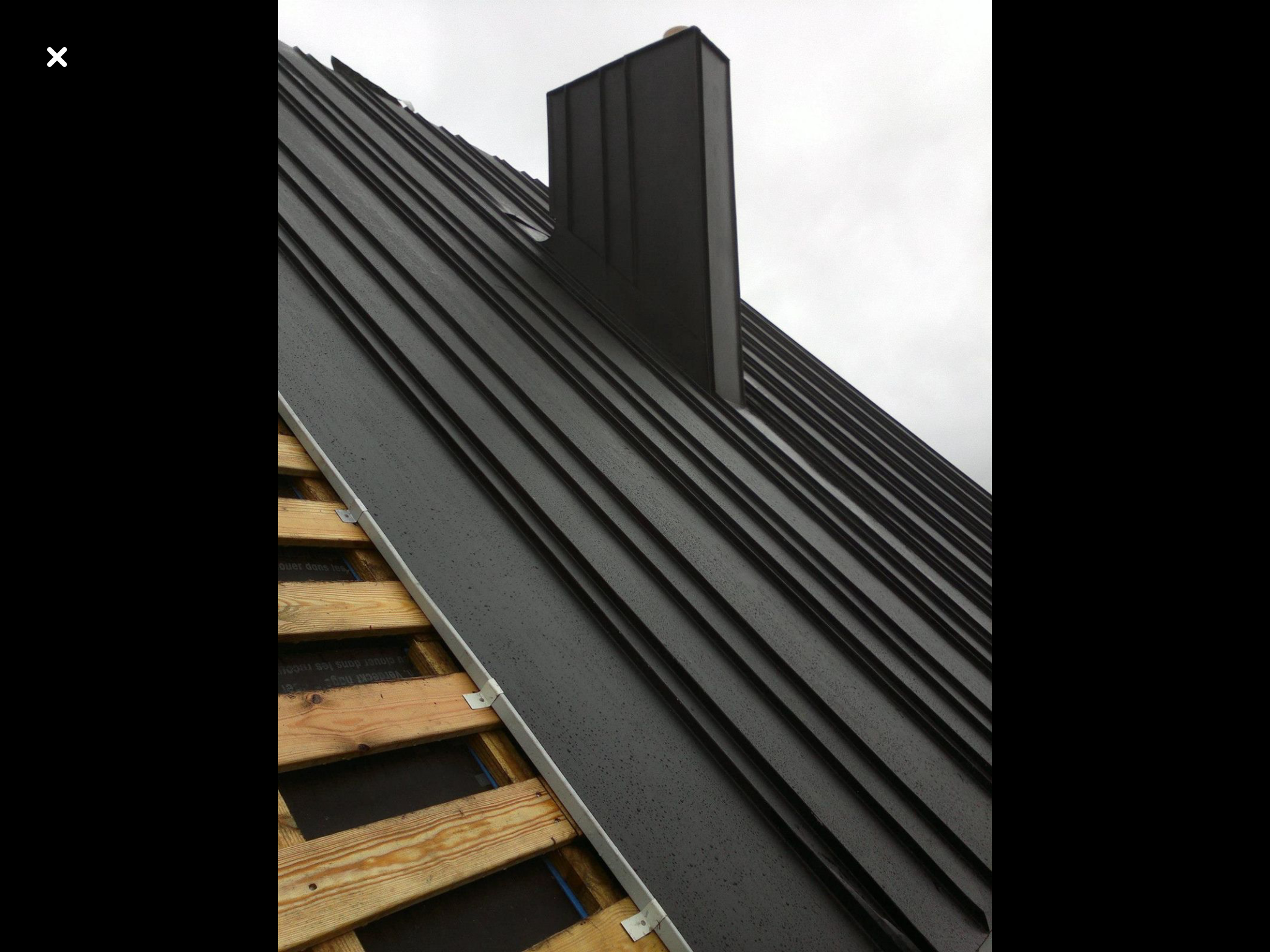

Russell griffiths Posted January 8, 2019 Posted January 8, 2019 Hi all, our roof will be metal raised seam it is supposed to sit on 18mm osb which I don’t plan on doing, I’m planning on using a sarking board just like our Scottish neighbours do would you use treated timber or just rough sawn. I have two views on this but thought I would get a collective opinion.
ProDave Posted January 8, 2019 Posted January 8, 2019 What is wrong with OSB? Cheap and solid. But our box profile rood sits on top of that on battens and counter battens, not directly onto the OSB.
Jeremy Harris Posted January 8, 2019 Posted January 8, 2019 Our sarking is 18mm OSB3. As @ProDave says, cheap and solid. We also have counterbattens on top of the sarking, the membrane laid over those, then the battens nailed on top as normal. Makes for a nice solid roof. IMHO.
Cpd Posted January 8, 2019 Posted January 8, 2019 I have always used 22mm treated sarking because I can’t get anything elts locally. If you can get rougth sawn then I think it should be grand as it will never get wet. My house roof has 100 year old untreated sarking without any membrane and it’s still remarkably good. Couple of points, if you use sarking board that is wet then it shrinks considerably.... I got up to 10mm gaps after tightly fitting 150mm wide boards. not a problem on a traditional Scottish slate roof as the slates can withstand that movement BUT if you lay the sarking and then attach your tin and then the sarking shrinks it could distort the fixings slightly as the wood shrinks, it’s minimal and I have not had a problem but on a swanky new house roof I would at least take this into consideration. Sarking is great for slates as it takes and holds direct nailing very well, also I am much happier with a roof that can breath and the gaps in the boards are great for keeping everything nice and vented. I have done my shed roof in structural ply as at the time osb was out of stock and they gave me the ply for the same price, it was a big disaster as the membrane froze and then water leaked in and soaked the ply which immediately got black mould growing on the inside...... I vowed never to use anything but sarking boards again as they are so robust.
Crofter Posted January 8, 2019 Posted January 8, 2019 The only advantage I can see in using planks rather than sheets is that they are individually easier to work with, and you can miss one out every so often to make it easier to climb up the roof whilst building. Sheets are cheaper, quicker, and give considerably better racking strength.
Russell griffiths Posted January 8, 2019 Author Posted January 8, 2019 I probably missed out an item that could distort the answers if I use a sarking board I will do it hit n miss fashion so only half as many boards to cover the same area. If I had a smaller roof I would probably go osb straight away, but being I have 450m square to do I’m looking at alternative products.
Cpd Posted January 8, 2019 Posted January 8, 2019 Sarking boards look great then and seeing how the roof is fixed, a bit of shrinking won’t do any harm. I can’t see how using untreated would be a bad thing.
