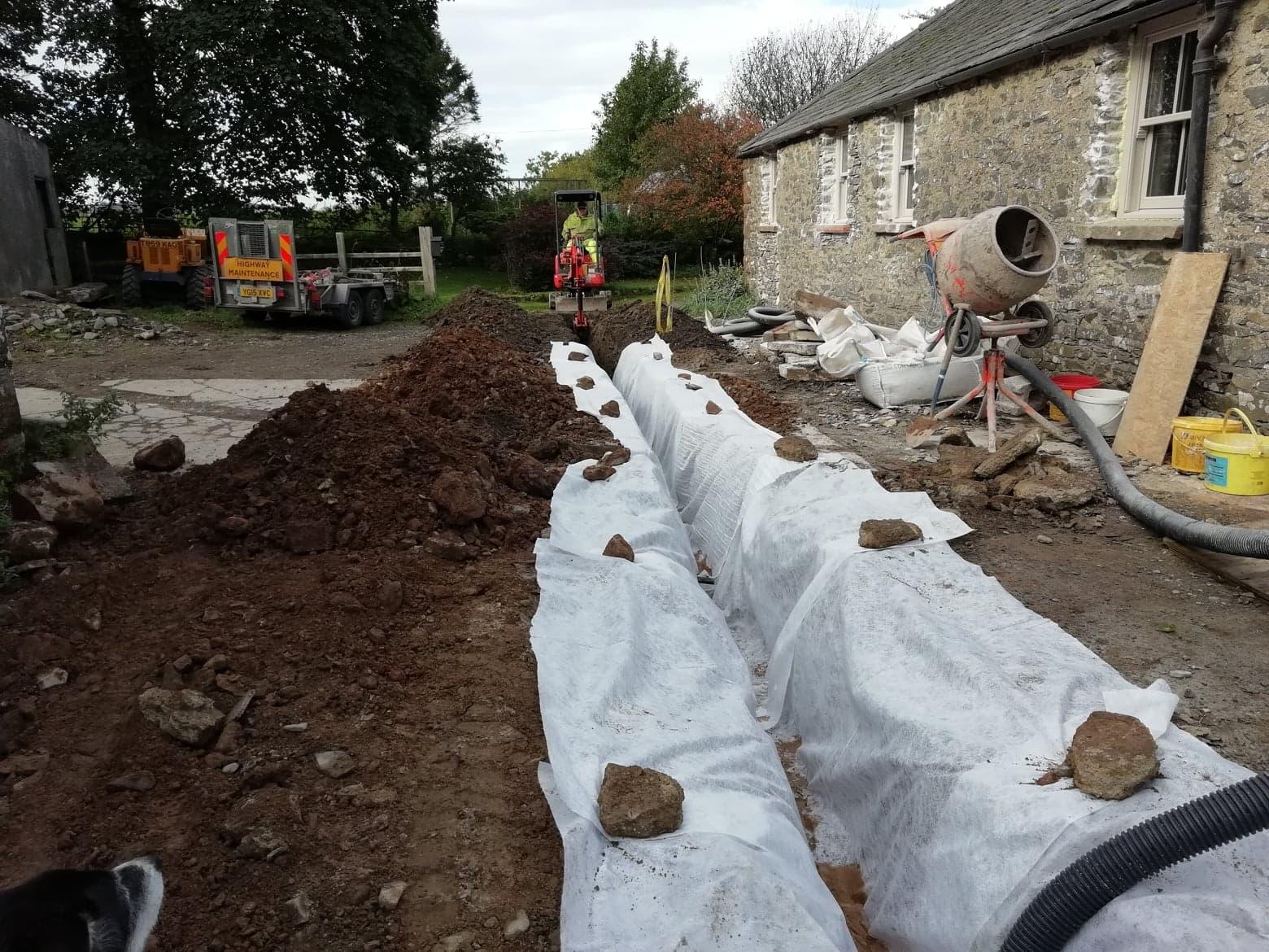

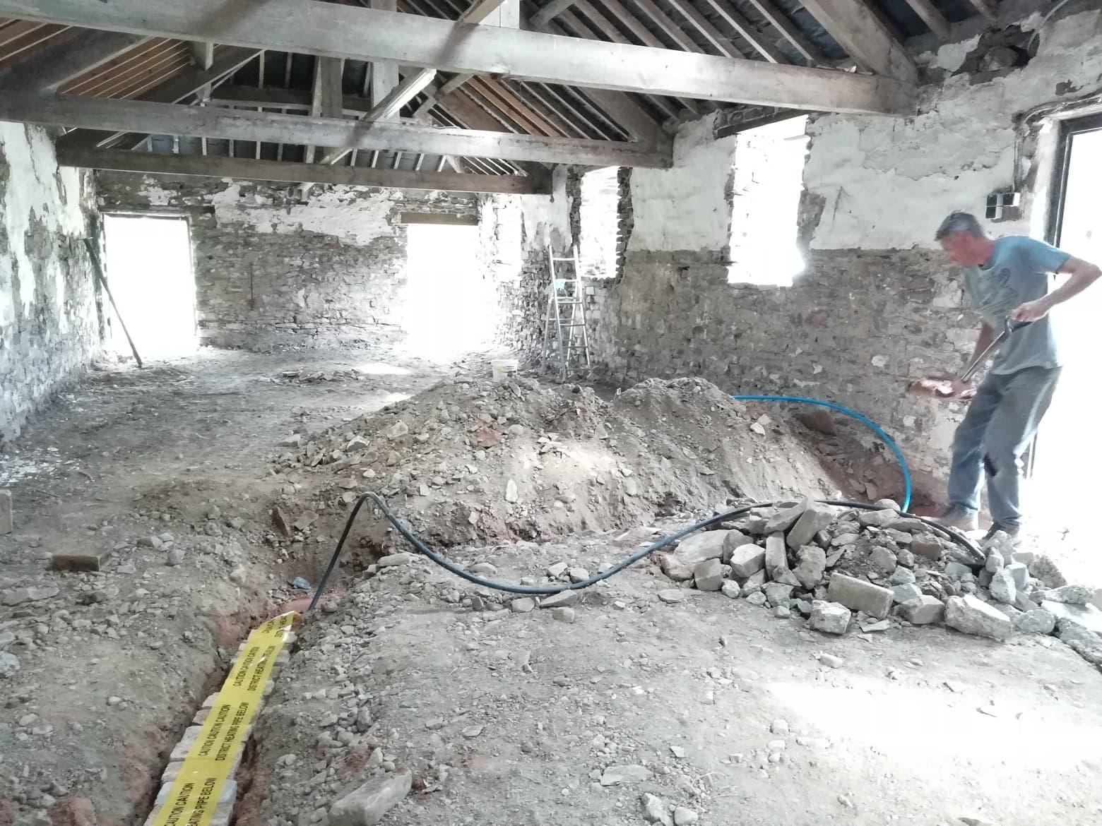

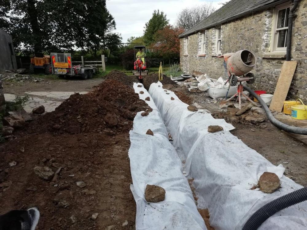

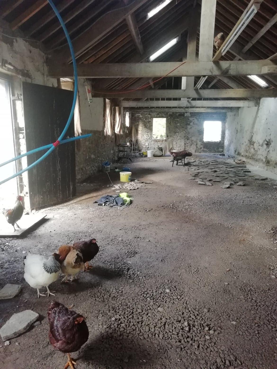

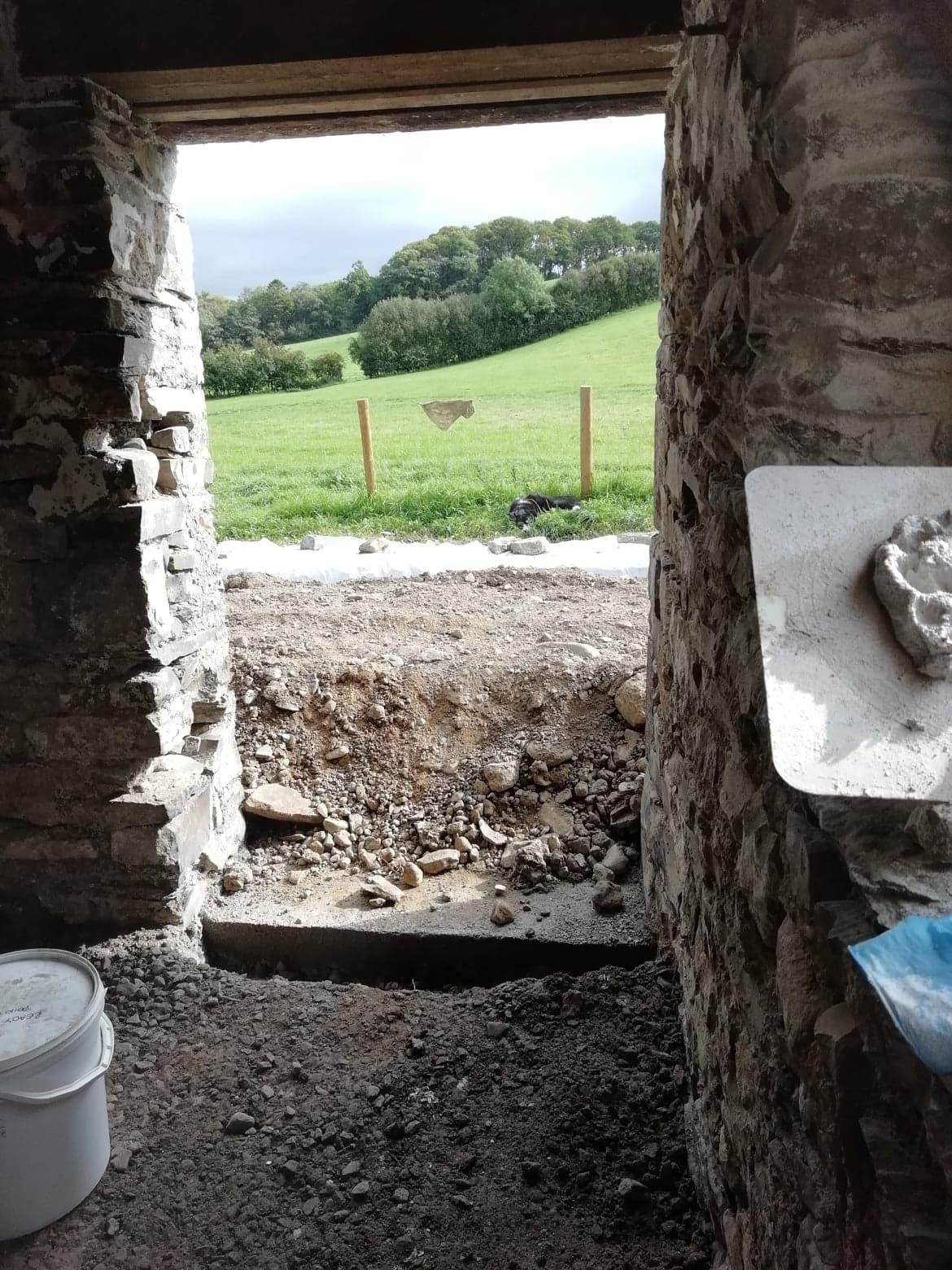

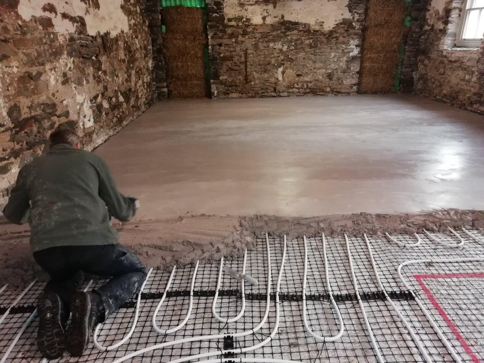

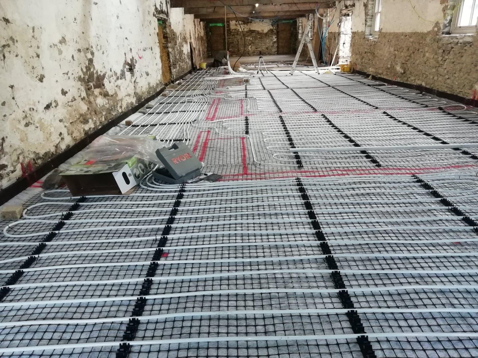

Snowbeetle Posted January 8, 2019 Share Posted January 8, 2019 Greetings, Just checking in with a bit of an update. Our four walls and a roof has moved on a bit. We are doing the work ourselves, used only one tradesman (to construct stone wall) and with small two kids to raise, as well as building and various 'interesting' events such as having to replace the roof on our temporary accommodation, I haven't been on here as often as I would have liked. We have: cleared the internal space of animal stalls, rooms and concrete render embedded our water and electricity supply pipes levelled the earth inside the building, put down Geocell foamed glass insulation enveloped in a terram, put in UFH system and lime screeded on top. Lime pointed our window reveals and installed wood framed windows raised the door lintel heights to allow for floor level coming up dug lots of trenches to put in land drain, civil drainage and oil feed pipe scrubbed the roof down ready to spray with woodworm treatment. millions of all the in-between stuff that uses so much time but doesn't make the headlines We did the lime screed ourselves and it has gone fine, it was a big job but we are pleased with the result as no problems with it despite finishing at half an hour to November and lime being temperature sensitive - we were running a risk with that - but the winter has been kind enough. So much has gone on there isn't any point going into technical detail on it all in this post, but I am happy to discuss any aspects anyone might find interesting/relevant to their own project 4 Link to comment Share on other sites More sharing options...

MarkyP Posted January 8, 2019 Share Posted January 8, 2019 the lime screed looks good. What sort of mix did you use and what was your approach to installing it? Link to comment Share on other sites More sharing options...
Snowbeetle Posted January 9, 2019 Author Share Posted January 9, 2019 @MarkyP - thanks. The job was epic! There was only myself and husband to do the labour. We had looked at using a firm but the cost was absolutely prohibitive for us for the full 'mix and lay screed' job. We found a firm who would come and mix the lot and leave you to lay it, but glad we didn't do that as we couldn't have laid that much quickly enough - it would have been going off before it was laid! Luckily lime is a very forgiving material so continuing the following day and successfully fusing to yesterdays work is do-able because you can just rework the edge back up and carry on. Once started you have to finish though as you wouldn't want to leave it much more than 24 hours before joining to it - that's already a tricky-ish fuse. We used two Baron forced action mixer one E90 and one E200. Keeping those two going constantly was the limit of physical capacity for mixing and laying for two people. I used NHL-5 supplied by Eden HotLime, mixed with fine sharp sand + gravel at a ratio of 1 lime to 2.5 grit. Adding short fibres too. Mixed with enough water to get a consistency similar to biscuit dough and stirring for minimum 20 minutes after the last bit of water added to make sure the lime was fat before it was laid into the screed. While the twenty minutes was ticking on the clock I would fill the buckets with the next lot of materials ready to get straight on with the next batch. So it was mix, refine mix with water until happy, set timer, fill buckets, unload and deliver... start again... ad inifiitum. We used a laser level to make sure we got the finish level correct. Each batch was pummelled into shape with a tamper then polished up with a float. Towards the end (19 days solid - 7am to 11pm in total) we were adding more water to make the mix softer as the punishment on the hands was harder with a firmer mix. This still resulted in a good floor but we got more shrinkage cracks with the wetter mix of course. Nothing some filler couldn't sort out though. We took a gamble on the temperatures - basically because we had no choice and at a few points it was 3-4 degrees while mixing (outside) which made the ingredients stick to the mixers so I had to scrape it back in by hand to make sure it was all mixed thoroughly - it wasn't ideal (and a pain in the botty) but we got away with it, we were lucky it was no colder though. Inside was warmer 5+ degrees all the time which was good as that was where it mattered more. When it rained I had to keep the mixers covered so it didn't dilute the mixture to the wrong consistency. I had wanted to mix inside an outbuilding but my cables wouldn't reach, but actually I was glad I didn't in the end, as although it would have been easier in some ways, the dust from the lime would have been worse not dispersing freely outside. 2 Link to comment Share on other sites More sharing options...
MarkyP Posted January 9, 2019 Share Posted January 9, 2019 (edited) crikey, what a job. Epic is an understatement! 16 hours a day for 19 days straight, I think that surely must be some sort of build hub record. I've done some big DIY stints on my project but nothing to match that. I guess it's one bit of your project you'll never forget. Well done. I hope you'll forgive me for saying, I do wonder if you might be slightly insane (just very slightly) ? what do you plan to lay as a finished floor covering? It's almost a shame to cover something up that was such a labour of love. Could a lime screed be polished and sealed? Edited January 9, 2019 by MarkyP Link to comment Share on other sites More sharing options...

Snowbeetle Posted June 11, 2019 Author Share Posted June 11, 2019 Nwgear Thanks for asking - sorry for delay in reply, I didn't get the notification for whatever reason. Floor structure = compacted earth floor + 200mm Geocell (insulation and water ingress control) + 100 mm lime screed. Final floor covering is not done yet but is intended to be stone flags to conduct the UFH into the living space and also breathable to complement the chosen techniques. Drainage - moisture control has been brilliant - building is the driest it has been in decades. Hope that helps. Link to comment Share on other sites More sharing options...
