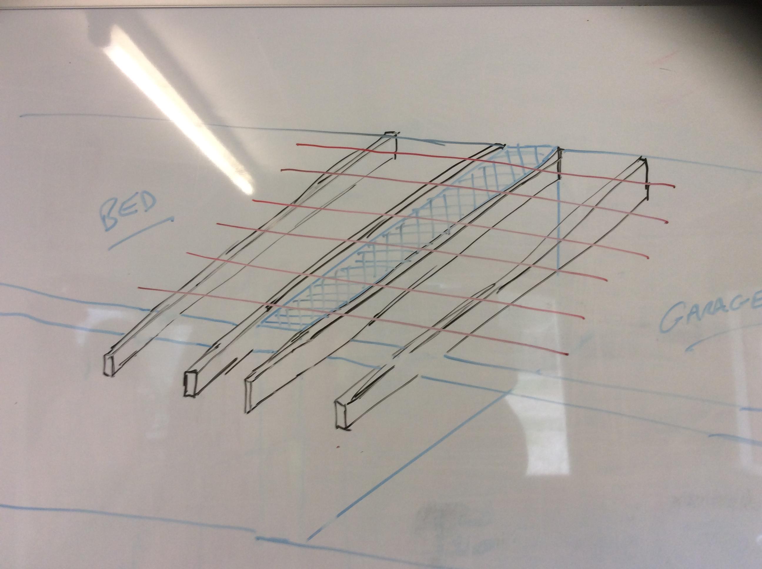

Russell griffiths Posted January 6, 2019 Share Posted January 6, 2019 Hi, can anybody offer any comments on my rather poor sketch i have an attached garage on an icf build we are currently working on at the end of the garage is a gable wall, on the other side of the gable wall is a bedroom so looking at the sketch we have a solid concrete wall running up to the underside of the roof covering, the top of the wall will be covered in rockwool insulation my question. Is there a risk of fire traveling along the roof battens, should the battens be stopped in The middle of the wall and some sort of fire stop installed between the batten ends. Hope that makes sense. Black things are rafters blue shaded thing is the top of the wall red lines roof battens Link to comment Share on other sites More sharing options...

Mr Punter Posted January 6, 2019 Share Posted January 6, 2019 In reality if you have rockwool above the dividing wall compressed by the battens, fire will not travel along the battens. Make sure there is no free air space, as air is what fire likes. Link to comment Share on other sites More sharing options...

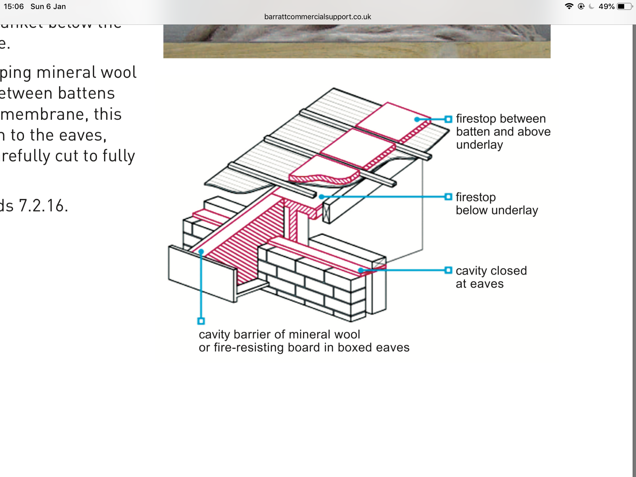

Russell griffiths Posted January 6, 2019 Author Share Posted January 6, 2019 (edited) if You look at this pic for two separate dwellings it shows a fire stop under the breather membrane and over the top, but the tile battens are still bridging over that area. Seems a bit pointless doesn’t it or do they think the spread along a batten is very small. What ya reckon. @Mr Punter Edited January 6, 2019 by Russell griffiths Link to comment Share on other sites More sharing options...

ADLIan Posted January 6, 2019 Share Posted January 6, 2019 Normally plastic = combustible! Above details look ok and in accordance with appr doc B. Link to comment Share on other sites More sharing options...
Mr Punter Posted January 6, 2019 Share Posted January 6, 2019 It won't hurt to put a bit of rockwool in there but if you have a 1 hour ceiling I don't think it is crucial. You can get the stuff in a plastic sleeve and you can run the battens over which holds it in place. Often you get living space above garages anyway. Fit a smoke or heat detector in the garage interlinked to the house. Actually, fit a smoke detector in every room (heat in kitchen), as the most important thing if a fire breaks out is that everyone escapes unhurt. Link to comment Share on other sites More sharing options...
ProDave Posted January 6, 2019 Share Posted January 6, 2019 Surely the double plasterboard ceiling and walls is the fire barrier? Between our garage and the (plant) room above it the fire barrier is just the double plasterboard ceiling. Link to comment Share on other sites More sharing options...
