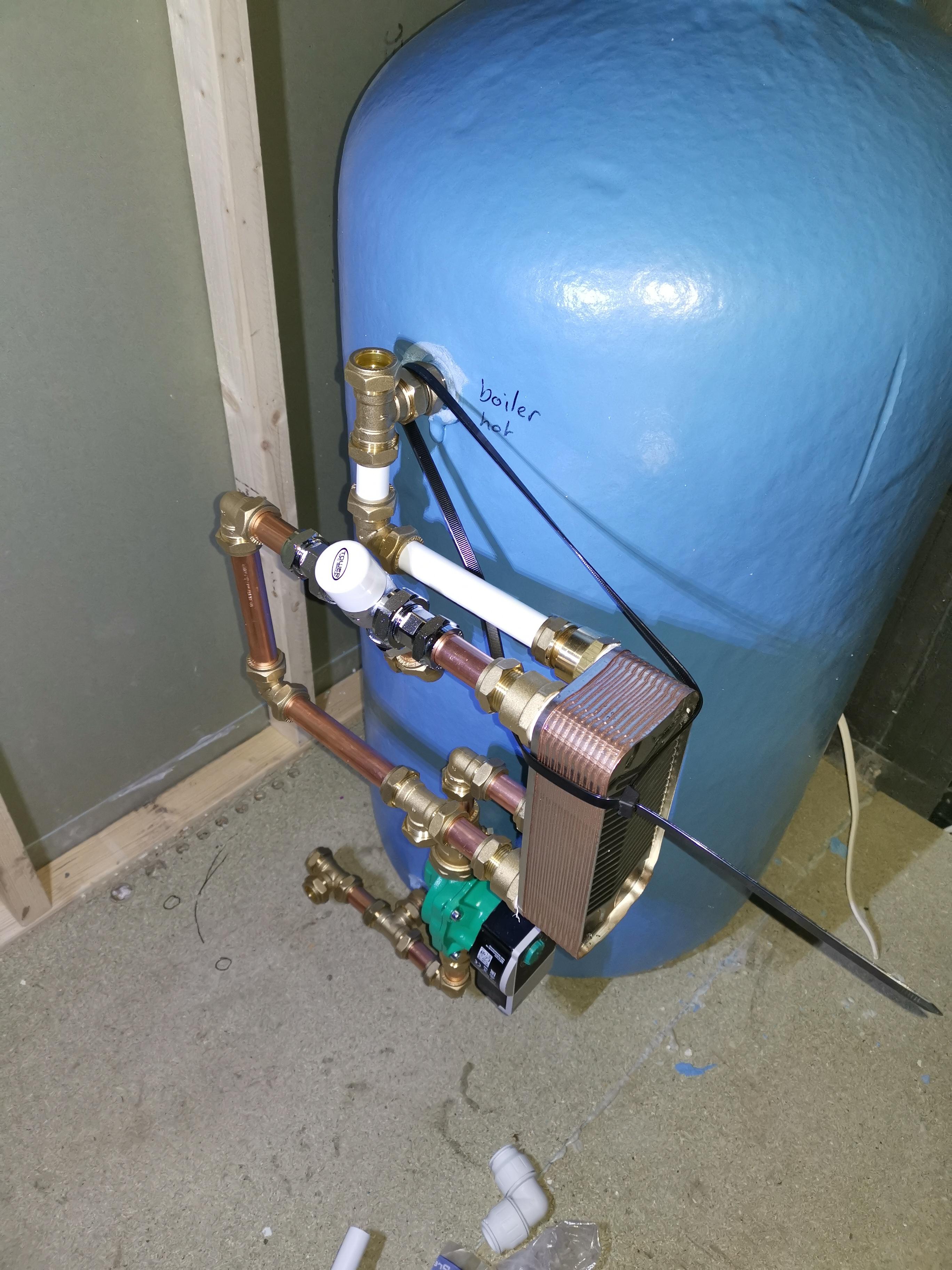

Nelliekins Posted January 5, 2019 Author Share Posted January 5, 2019 (edited) OK, so I have made a start on putting this all together... The PEX pipe adjacent the TMV is a placeholder until I get more check valves, at which time it'll be replaced with copper. Still waiting for flow switch to be delivered, and connections made to boiler which lives in the room below... The series of holes in the floor are for the pipes to go up to the hot water manifold, which will be supplied from the TMV. So, a couple of questions : 1. Should I use a Y strainer in the cold input? I had thought about a magnaclean as an option too, but not sure I would see much if any benefit from it? 2. Any ideas on placement of (and recommendations for make/model of) PRV? 3. Am I right in thinking that the F&E tank needs to be 1m+ above the top of the cylinder, and needs to have at least 5% of the volume of the system it is connected to? Realistically that's about 8L I think. 4. The boiler doesn't appear to have an internal pump, so I have bought a 3rd Wilo Pico pump (one for DHW, one for UFH and one for Boiler)... Sound OK? 5. For the UFH side of things, am I going with a set of 3 position valves (one per manifold)? Where do I position the pump and non return valves so that I can bypass the coil and still circulate water to distribute solar gain? Edited January 6, 2019 by Nelliekins Clarifications Link to comment Share on other sites More sharing options...

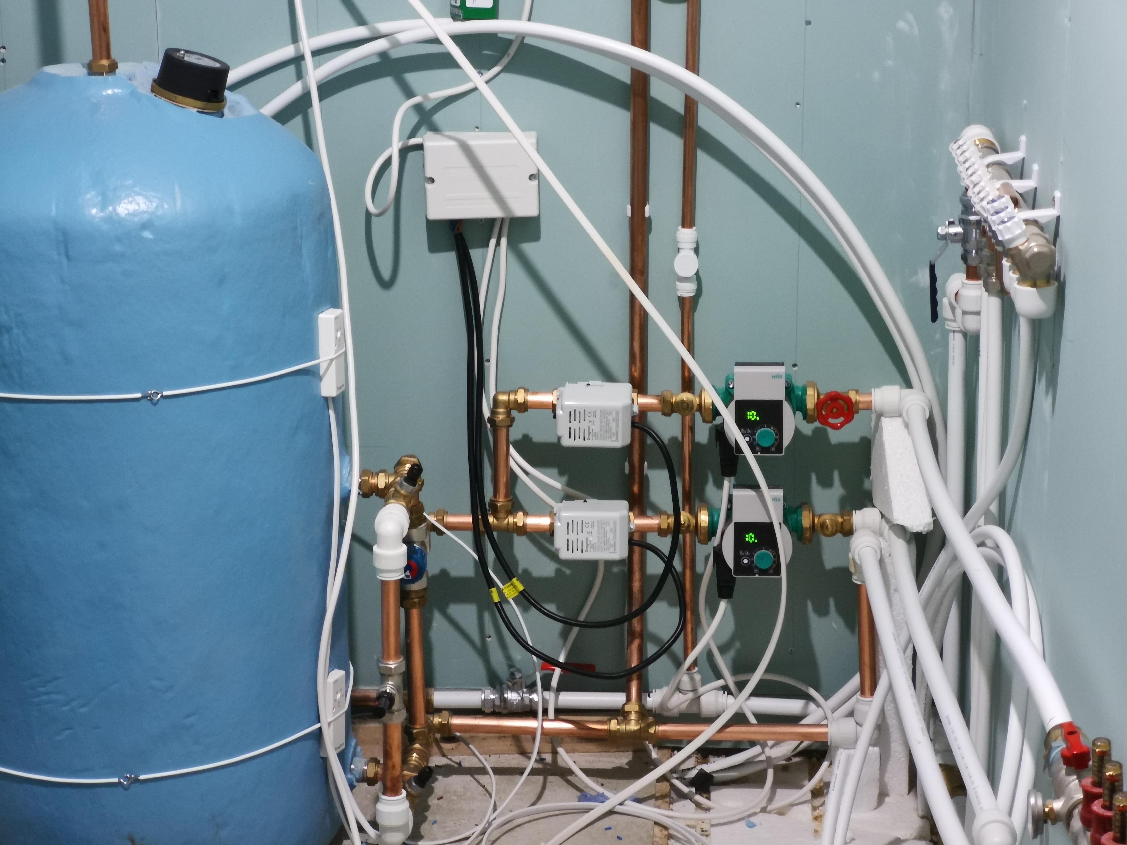

PeterW Posted January 26, 2019 Share Posted January 26, 2019 You need a mixing or blending valve not a 3 way here as otherwise you will get whatever temperature the tank gives you and that’s not a good idea. Modulating pump speed to make the temperature differential won’t work. Pump per manifold circuit Single blender on the output from the tank coil zone valve per zone. Easy to set up and should work fine. 1 Link to comment Share on other sites More sharing options...
Nelliekins Posted March 5, 2019 Author Share Posted March 5, 2019 On 26/01/2019 at 09:40, PeterW said: You need a mixing or blending valve not a 3 way here as otherwise you will get whatever temperature the tank gives you and that’s not a good idea. Modulating pump speed to make the temperature differential won’t work. Pump per manifold circuit Single blender on the output from the tank coil zone valve per zone. Easy to set up and should work fine. @PeterW ok I have fitted 2-port valves to each of the circuits, and pumps inline with each valve (driven by the valves). Here's a photo : (ignore the wiring and plumbing chaos - there's a rainwater distribution manifold and 2 wiring centres yet to fit!) So, what we have is coil going to tee on both flow and return. One loop formed by bypass valve set at 2 bar (little black thing by cylinder stat) . Other loop formed by Reliance mixing valve rated for 25-50C output, which then gets split to go into the circuits for UFH pumping. It all seems to work, except for one detail... After 30 minutes of running, the flow on the manifolds was 20C and return 12C. Fine, but after 24 hours of running the flow was still 20C with return up to around 17C. Clearly 20C isn't quite warm enough for the UFH - the spreadsheet from @JSHarris said 25C was the goal for our house. With one pump knocked off (thereby getting all the heat from the coil into just one half of the floor) it still stayed at 20C. My guess is that I have a few options: 1. Increase the cylinder temp from 55C to around 70C to see if that gets more heat into the coil 2. Impede the flow rate somehow so that the water travels through the coil slower (pumps already at minimum rate though!) 3. Replace the cylinder with one that has a more useful coil Have I missed anything? Going to put some DS18B20s into the thermowells all over the system tonight to see if I am missing anything simple... Link to comment Share on other sites More sharing options...
PeterW Posted March 5, 2019 Share Posted March 5, 2019 If that is a standard hot water tank then the coil won’t be big enough to give heat to the UFH loop at 50c. I would up it to 70c and see how the UFH reacts. Link to comment Share on other sites More sharing options...
ProDave Posted March 5, 2019 Share Posted March 5, 2019 That coil looks to be at the bottom suggesting it is a heat input coil in an ordinary indirect tank. A heat output coil in a thermal store would be at the top of the tank. Link to comment Share on other sites More sharing options...
PeterW Posted March 5, 2019 Share Posted March 5, 2019 5 minutes ago, ProDave said: That coil looks to be at the bottom suggesting it is a heat input coil in an ordinary indirect tank. A heat output coil in a thermal store would be at the top of the tank. Not necessarily coil at the top is normally for DHW so needs to be in the 60c zone. UFH can be lower but that tank won’t hold that much heat capacity so needs to be hotter. Link to comment Share on other sites More sharing options...
Nelliekins Posted March 5, 2019 Author Share Posted March 5, 2019 10 hours ago, ProDave said: That coil looks to be at the bottom suggesting it is a heat input coil in an ordinary indirect tank. A heat output coil in a thermal store would be at the top of the tank. It is indeed an ordinary indirect cylinder, 140L stainless steel RM Aquastel. 10 hours ago, PeterW said: Not necessarily coil at the top is normally for DHW so needs to be in the 60c zone. UFH can be lower but that tank won’t hold that much heat capacity so needs to be hotter. Jeremy's spreadsheet said 25-26°C floor temp was what we were aiming for. Mixing valve is good for 25-50°C, and was set at 3/10. Flow was steady 20°C and return around 17°C. I boosted the cylinder temp from 55°C to 65°C by turning up the wick a bit on Mr Boiler, and then went to look at the mixing valve... I set it midway (5/10) at 5:30pm today. By 7pm, flow was up from 20°C to 28°C and return was 22°C on concrete floors and 26°C on 1st floor. So fiddling with the mixing valve and giving the boiler a bit more gas seems to have sorted the UFH temps... ? Still suspicious that it won't cut the mustard if it gets properly cold outside, but for now we have heating! 1 Link to comment Share on other sites More sharing options...
Nelliekins Posted March 5, 2019 Author Share Posted March 5, 2019 @PeterW I am beginning to wonder if the 2 port valve were the best idea... How will we circulate the water without taking in heat from the cylinder, e.g. to distribute solar gain from the kitchen? Am thinking that a 3 way diverter (not mid-position) valve would either connect a circuit to the flow from the coil or "short across" to the return. Thinking about it, we would need a 2 port valve as well as the 2no. 3-port valves, to close off the return that goes to the coil, correct? Link to comment Share on other sites More sharing options...
dpmiller Posted March 6, 2019 Share Posted March 6, 2019 9 hours ago, Nelliekins said: @PeterW I am beginning to wonder if the 2 port valve were the best idea... How will we circulate the water without taking in heat from the cylinder, e.g. to distribute solar gain from the kitchen? Am thinking that a 3 way diverter (not mid-position) valve would either connect a circuit to the flow from the coil or "short across" to the return. Thinking about it, we would need a 2 port valve as well as the 2no. 3-port valves, to close off the return that goes to the coil, correct? What about using a bypass valve (tee'd between pump and motor valve) to open if the pump's running with the 2-port closed? That would give you circulation without flow through the coil. 1 Link to comment Share on other sites More sharing options...
Nelliekins Posted March 6, 2019 Author Share Posted March 6, 2019 1 hour ago, dpmiller said: What about using a bypass valve (tee'd between pump and motor valve) to open if thepump's running with the 2-port closed? That would give you circulation without flow through the coil. Hmmm... That might work you know! Good idea! Just have to work out how to fit 2 into the same part of the return... ? Link to comment Share on other sites More sharing options...
