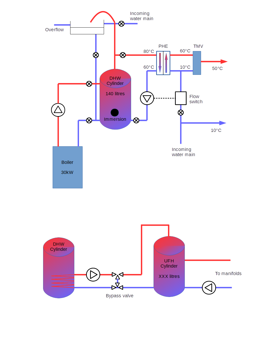

PeterW Posted December 30, 2018 Share Posted December 30, 2018 (edited) 41 minutes ago, Nelliekins said: Now see that's the kind of thinking I like. ? I presume this would work using the original design of the buffer tank leeching heat via the coil from the DHW system, too. A question then - would this still facilitate distribution of solar gain heat from the kitchen to the entire house, or only the ground floor? I guess the answer is actually down to how well the valves are controlled in this situation. I think I / you need to draw this out as I’m still not sure where the connections are going. Can you get the KW rating for that coil ..? I am just concerned that even on full chat, that 30kw boiler won’t kick enough high grade heat into the tank for a pair of showers plus the UFH but could be wrong ... Edited to add : the answer is no on the recirc of heat to other floors as the three way would be stopping recirc other than of the manifold it was supporting. Edited December 30, 2018 by PeterW Link to comment Share on other sites More sharing options...
Nelliekins Posted December 30, 2018 Author Share Posted December 30, 2018 13 minutes ago, PeterW said: I think I / you need to draw this out as I’m still not sure where the connections are going. Can you get the KW rating for that coil ..? I am just concerned that even on full chat, that 30kw boiler won’t kick enough high grade heat into the tank for a pair of showers plus the UFH but could be wrong ... Hi Peter. I did most of this in the PDF included in the OP. Here's a better labeled PNG version... Please excuse the lack of correct symbol for the bypass valve! ? FYI, the "DHW Cylinder" shown on both parts of the drawing are the same cylinder - the drawing was simply drawn as 2 separate diagrams to explain it to a mate! I'll have to check re the coil capacity, but that coil only has to cope with (part of) the UFH load anyway. Regarding the boiler capacity, I would assume that since we are heating the DHW cylinder directly (ie not using the coil), we can get the full beans out of the boiler, i.e. 30kW give or take. I would expect 30kW to be more than enough to drive 2 showers, would you agree? If the DHW cylinder only copes with with the DHW demand at peak but not the leeched UFH demand as well, it doesn't matter one jot. This is because a 15 minute hiatus for the UFH will have near-zero impact on the house or floor temperature anyway. It's no different than a combi boiler that can only do DHW or CH, but not both... but the fabric of the house and the "constant running" of the UFH heating system makes the effects of the switch from UFH to DHW undetectable to the occupants (I think!), because of the inherent/latent heat capacity of the fabric. Remember also that if we used the same style of (el cheapo) cylinder for the UFH buffer tank, that too would have an immersion port if it were needed, which would be able to supplement / replace the leeching of heat from the DHW tank (and completely separate the 2 systems if that were desirable). That would also free up the DHW coil for uplift of the DHW incoming mains water, potentially (although I suspect there is then the risk that the cold mains gets heated well above 50C if left standing in the coil - so maybe that's a stupid idea, cos the TMV won't work!) Link to comment Share on other sites More sharing options...
PeterW Posted December 30, 2018 Share Posted December 30, 2018 You’re basically turning your boiler and tank into the same sort of setup that you get on an oil boiler here - a stored water combi. Putting aside the issue of filling loops and venting for a minute, I’m trying to come up with any downsides to not even bothering with the UFH buffer as the DHW tank is working as that anyway. Is the UFH pipe 16mm PEX..?? And it’s 2.2km long ...??! How many manifolds and loops ..? Link to comment Share on other sites More sharing options...
Nickfromwales Posted December 30, 2018 Share Posted December 30, 2018 So, to clarify, your cylinder has the 4 individual tappings as shown, plus the 2 for the coil ? Link to comment Share on other sites More sharing options...
Nelliekins Posted December 30, 2018 Author Share Posted December 30, 2018 1 hour ago, PeterW said: You’re basically turning your boiler and tank into the same sort of setup that you get on an oil boiler here - a stored water combi. Putting aside the issue of filling loops and venting for a minute, I’m trying to come up with any downsides to not even bothering with the UFH buffer as the DHW tank is working as that anyway. The biggest one I can see is that the flow into the manifolds would be too warm unless we get really lucky on a combination of flow rate and coil efficiency. By separating the two into their own cylinders i can have whatever temp I like in both at all times. 1 hour ago, PeterW said: Is the UFH pipe 16mm PEX..?? And it’s 2.2km long ...??! How many manifolds and loops ..? It's 16mm PEX-Al-PEX, 2.2km over 3 manifolds and 28 loops. Basement manifold has 6 loops set in concrete. Ground floor manifold has 12 loops set in concrete. First floor has 10 loops set in EPS70 (sat in top of router'd 50mm panels) with 18mm chipboard going over. Link to comment Share on other sites More sharing options...
PeterW Posted December 30, 2018 Share Posted December 30, 2018 Just now, Nelliekins said: The biggest one I can see is that the flow into the manifolds would be too warm unless we get really lucky on a combination of flow rate and coil efficiency. By separating the two into their own cylinders i can have whatever temp I like in both at all times. Irrelevant - just set a blending valve to 38c and leave it alone. Just one off the coil will be fine. Link to comment Share on other sites More sharing options...
Nelliekins Posted December 30, 2018 Author Share Posted December 30, 2018 48 minutes ago, Nickfromwales said: So, to clarify, your cylinder has the 4 individual tappings as shown, plus the 2 for the coil ? No, it has 2 for coil, 2 for top/bottom heat/return and 1 for overflow. I would have to tee the bottom fitting (not the coil, obviously) or fit a new flanged fitting. Link to comment Share on other sites More sharing options...

PeterW Posted December 30, 2018 Share Posted December 30, 2018 Ok - so you’ve got around 350 litres of water in that system, and would need an expansion vessel of ~40 litres to cope with the loops, but you could drop the pressure to 1 bar and it would be fine. If you are still planning on using that PHE setup then you’re going to need to be careful with the pump positions and also double check the boiler doesn’t have an internal pump also. Do you already have the flow switch ..?? BIG TIP - fit a non return valve before the switch and after you have tee’d off for any cold supplies - assume you’re also fitting a PRV..?? Link to comment Share on other sites More sharing options...
Ed Davies Posted December 30, 2018 Share Posted December 30, 2018 Part of why I was so confused by earlier bits of this conversation is that the “DHW Cylinder” doesn't actually contain DHW; it just happens to be used to heat DHW (via the PHE) amongst other things. Much better to call it a (small) thermal store, I think. Link to comment Share on other sites More sharing options...

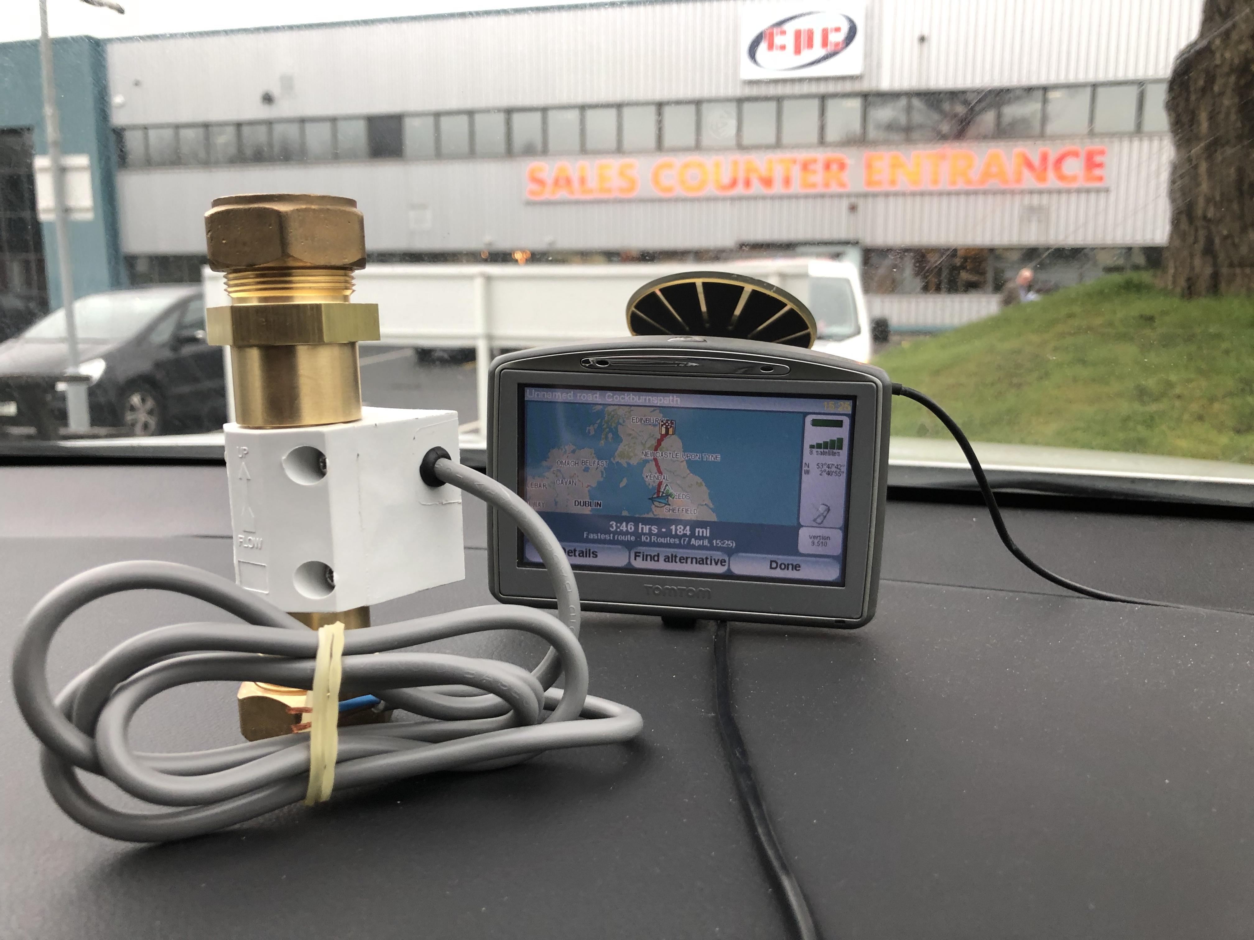

PeterW Posted December 30, 2018 Share Posted December 30, 2018 14 minutes ago, Nelliekins said: don't have the flow switch yet - that's next on my list of purchases once I identify the correct model. CPC sell them and if you ask @newhome nicely, she will probably drive 7 hours to get you the right one..... ? 1 Link to comment Share on other sites More sharing options...
Nelliekins Posted December 30, 2018 Author Share Posted December 30, 2018 1 hour ago, PeterW said: CPC sell them and if you ask @newhome nicely, she will probably drive 7 hours to get you the right one..... ? Private joke? So something like this? Link to comment Share on other sites More sharing options...
newhome Posted December 30, 2018 Share Posted December 30, 2018 14 minutes ago, Nelliekins said: Private joke? So something like this? Not very private, it was on here lol. ?. @PeterW had me drive 7 hours in a round trip from Edinburgh to Preston to collect one! That’s the one I got from there anyway! 1 Link to comment Share on other sites More sharing options...
Nickfromwales Posted December 30, 2018 Share Posted December 30, 2018 5 hours ago, Nelliekins said: and 1 for overflow Do you mean it has an auxiliary tapping 2/3 of the way up on one side ( which is a hot return tapping ) ? A regular cylinder has cold in, side mounted at the very bottom x1, combined hot and vent out of the very top x1, and nowt else other than the coil tapping's which are hydraulically separate. 1 Link to comment Share on other sites More sharing options...
PeterW Posted December 30, 2018 Share Posted December 30, 2018 They are very sensitive switches and I would suggest you look carefully and find one with a low flow rate of 2+ l/m. 1 Link to comment Share on other sites More sharing options...
Nelliekins Posted December 30, 2018 Author Share Posted December 30, 2018 2 hours ago, Nickfromwales said: Do you mean it has an auxiliary tapping 2/3 of the way up on one side ( which is a hot return tapping ) ? A regular cylinder has cold in, side mounted at the very bottom x1, combined hot and vent out of the very top x1, and nowt else other than the coil tapping's which are hydraulically separate. Hmmm you have got me wondering now! There is definitely 2 for coil, 2 on opposite side (top and bottom) and vent out at top. 2 hours ago, PeterW said: They are very sensitive switches and I would suggest you look carefully and find one with a low flow rate of 2+ l/m. Roger wilko. I have CPC account(s) and frequently pop into the sales counter to grab bits and pieces. I get 3 sets of mailshots every weekend ? There are a couple of brass models sold by CPC - one is AC and one DC. Failing that, BES sell brass ones as well. Link to comment Share on other sites More sharing options...
PeterW Posted December 30, 2018 Share Posted December 30, 2018 (edited) You cannot wire the pump direct to the switch ..! Have to put a relay in as otherwise you will fry the contacts, irrespective of what the MIs say about current rating ..! Edited December 31, 2018 by Nickfromwales fry Link to comment Share on other sites More sharing options...
